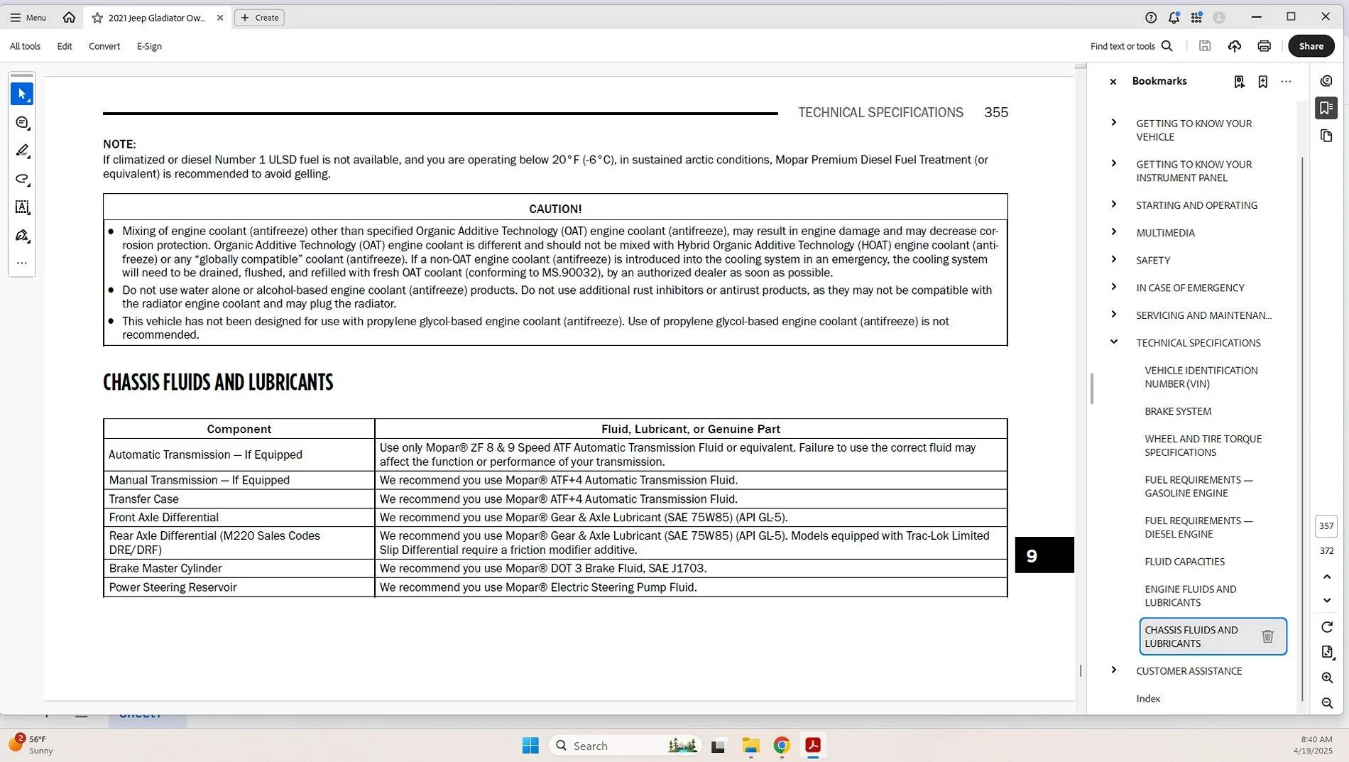

Ok, so I have a 2021 diesel Jeep Gladiator Rubicon. It doesn't have a two package per-se, but it is able to tow up to 6,000 and comes standard with a hitch receiver and electrical connections. Everyone on here says 75W140 for the rear axle, but my owner's manual only calls for 75W85, it doesn't even mention the M200 sales code for the rear axle.
Where is everyone getting the 75W140 for the rear axle from?
You will not find it in the owners manual. It is mentioned in the Techauthority service data the dealerships use for vehicles equipped with the tow package. DANA also calls out that grade when their axles are rebuilt and is what they ship their aftermarket sold axles with.
Owners manual is only going to list the fluid grades they obtained their MPG certifications with and nothing else.
