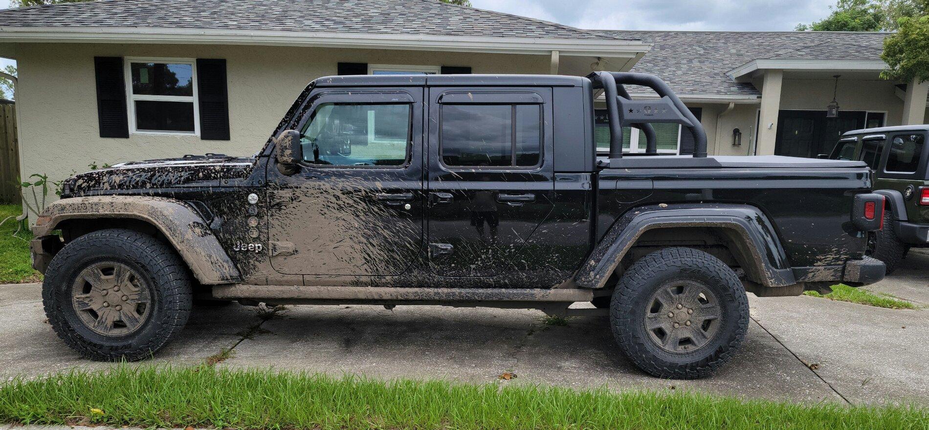

Wheel and Rim upgrade for Sport S. What size?
TinyTink
Feb 16, 2020
Louisiana
2020 Jeep Gladiator Sport S with Max Tow
So, I'm convinced that these tire stores don't know jack after getting different answers from each. I have the 2020 Sport S with Max Tow, so I have the wide Dana 44 axles. I live in Louisiana and went to go help my mom after Hurricane Ida. She had a tree blocking her entire driveway and I got stuck in a ditch trying to get around. Needless to say, it's definitely time to upgrade to some bigger rims and tires. I'm thinking 20 inch rims and 33 inch mud tires. I also want to get a slight lift, but that will come later. Just want some verification that this will work for the time being, or if it will rub with the stock lift. Thanks in advance guys.

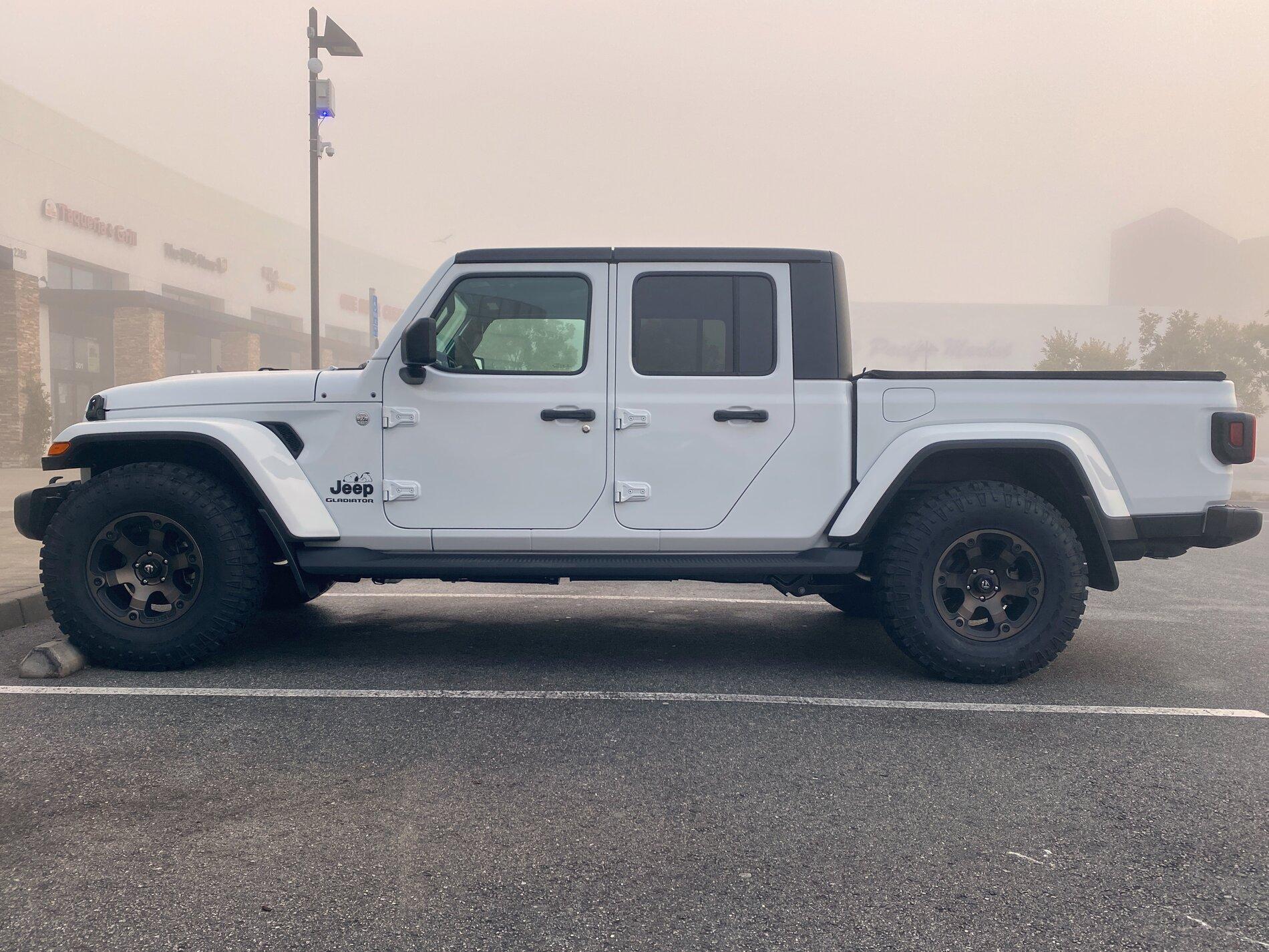

U can always do what I did, grab some mojave take offs. Fit perfect on my sport S Max tow.Tow. They are 33s
Jeep Gladiator Wheel and Rim upgrade for Sport S. What size? 20210814_142130

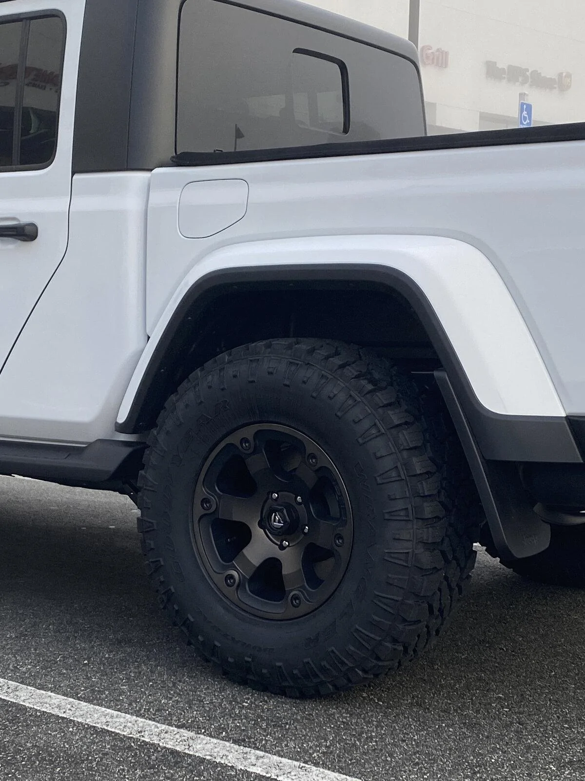

37x12.50’s on Rubicon wheels. Added some height over the stock setup. No lift yet but no issues so far. I work in construction and usually end up on job sites with no roads and need for some clearance.

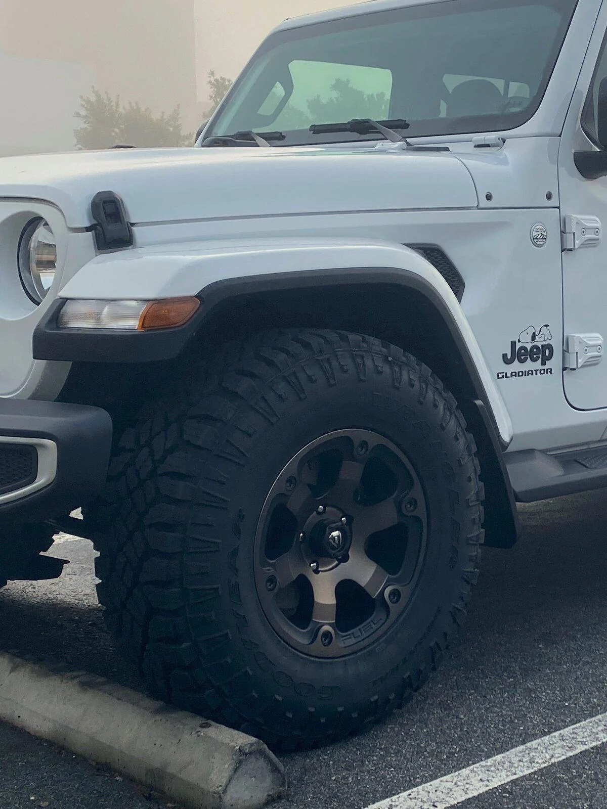

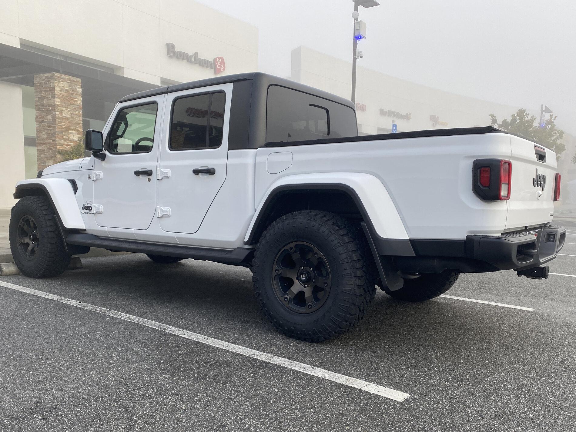

XraytecH
Bernie
Jan 14, 2021
212
1,914
2,824
South San Francisco
2021 Jeep Gladiator Sport
Xraytech
Fuel Off Road, Beast 17x9” +1 Wheels
Goodyear Wrangler DuraTrac 35x12.5x17
No Lift, No Rub
Sport S, Non-Max Tow
Jeep Gladiator Wheel and Rim upgrade for Sport S. What size? B6246429-2C2F-4182-8CEA-5A5E9A56F5A2
Jeep Gladiator Wheel and Rim upgrade for Sport S. What size? 2754F375-5EBA-40D7-8009-A821A4493D32
Jeep Gladiator Wheel and Rim upgrade for Sport S. What size? 6A4A06A1-4C32-48E3-9B06-D7E1CE0D59DB
Jeep Gladiator Wheel and Rim upgrade for Sport S. What size? 835CD0B7-29E2-4B77-8E7D-FC6F24892214
Jeep Gladiator Wheel and Rim upgrade for Sport S. What size? A178D1FF-7DA8-4078-BC99-3F180AC9C0F3

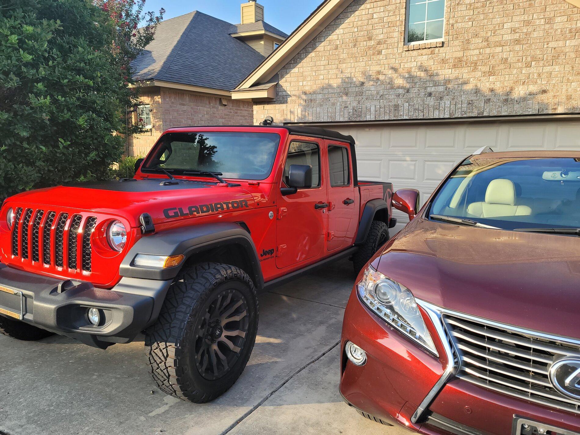

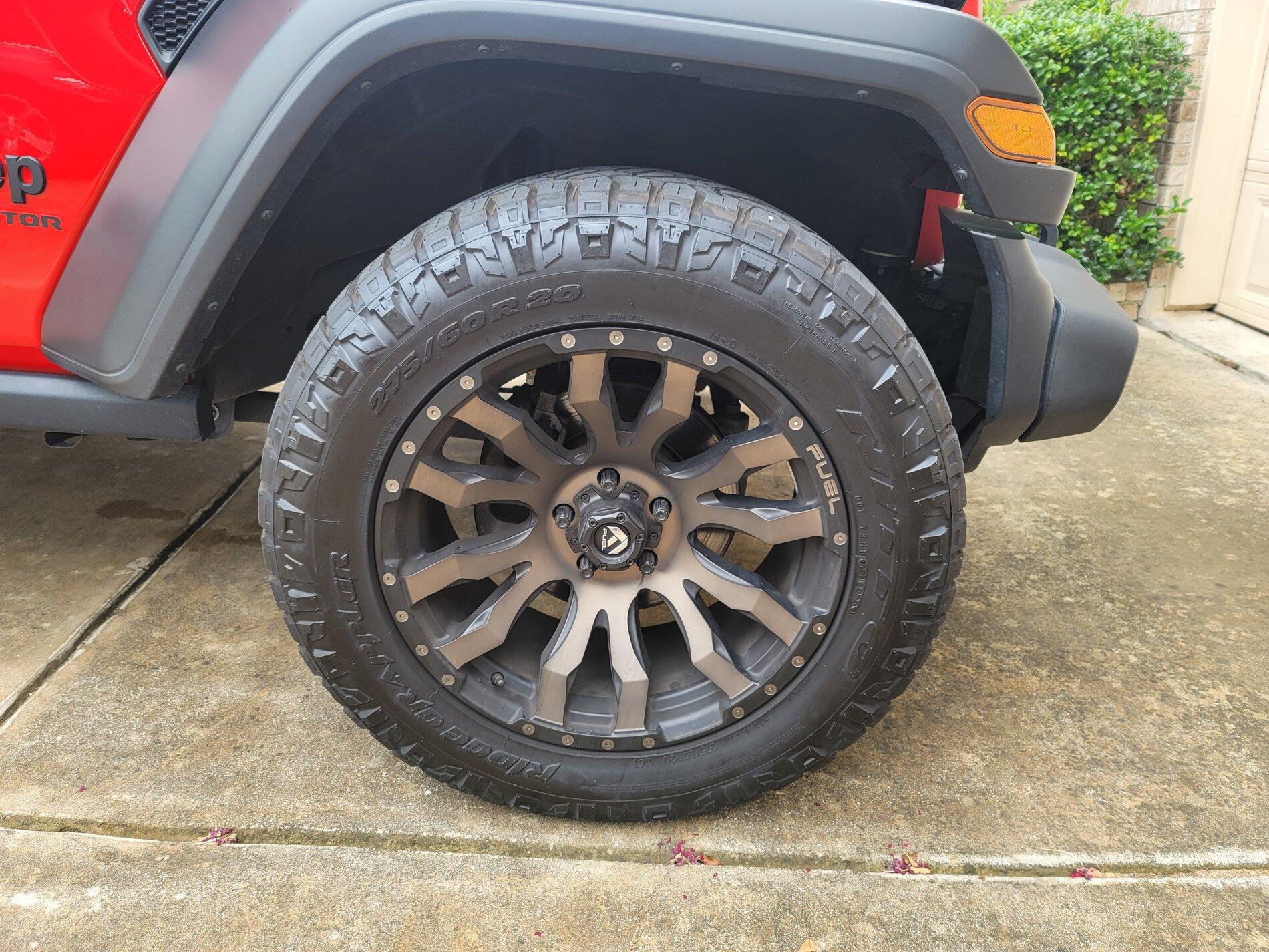

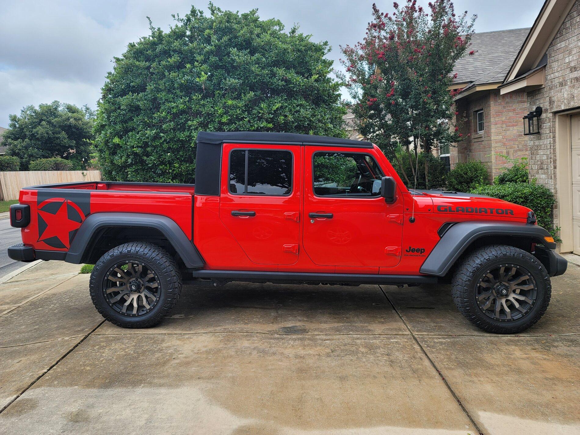

I have 20" rims with 33's. Personally, I love the way it looks.
Jeep Gladiator Wheel and Rim upgrade for Sport S. What size? 20210801_081508
Jeep Gladiator Wheel and Rim upgrade for Sport S. What size? 20210802_142618
Jeep Gladiator Wheel and Rim upgrade for Sport S. What size? 20210802_142600
