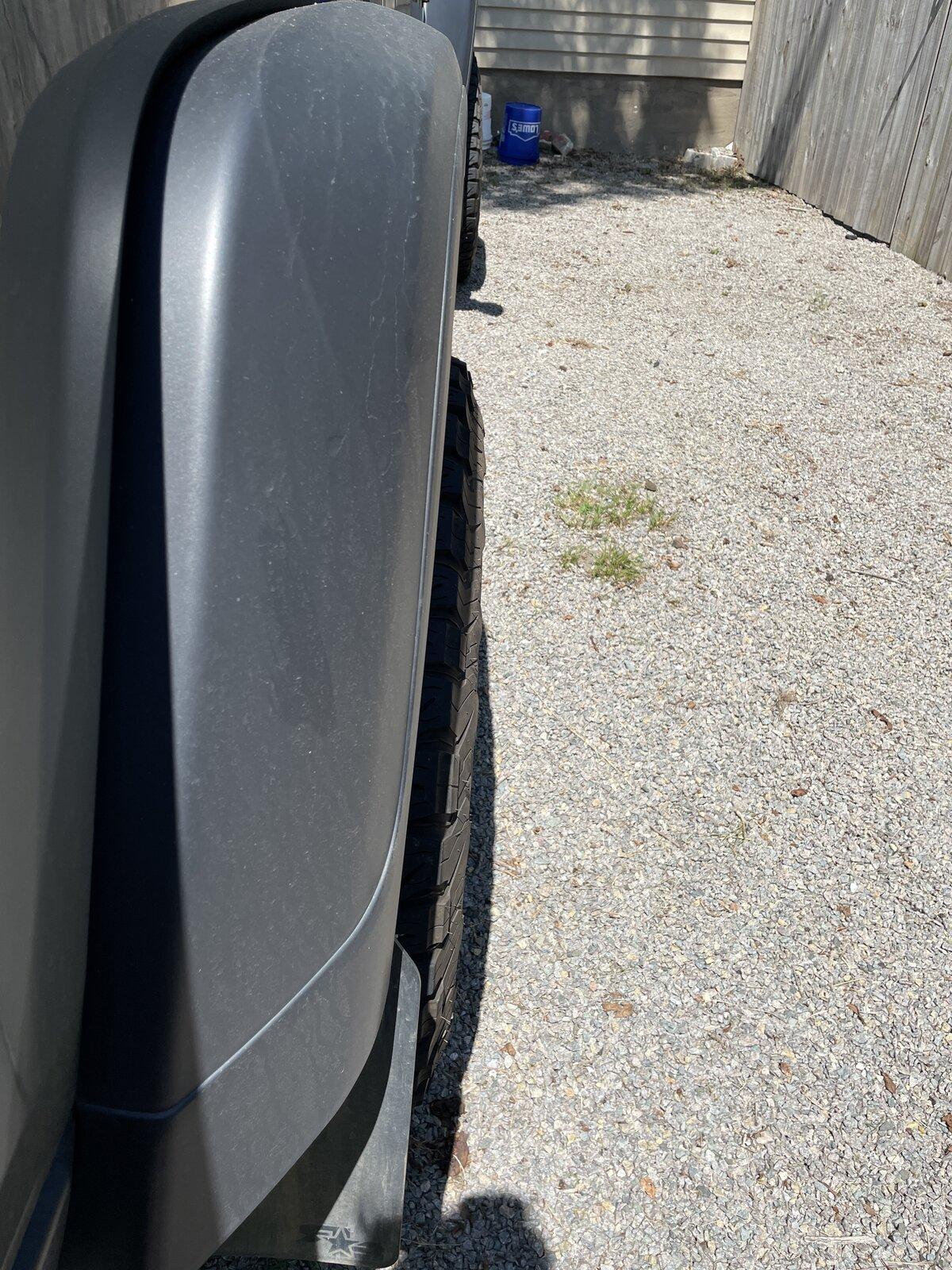

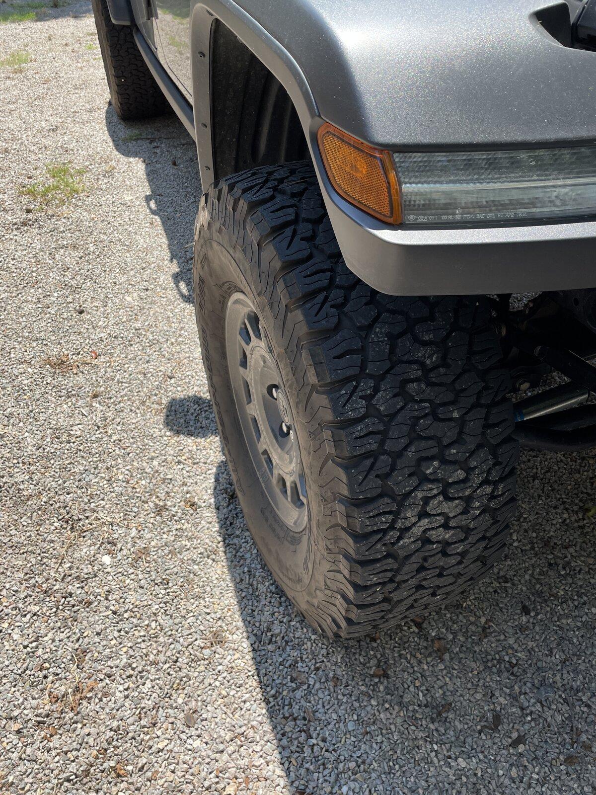

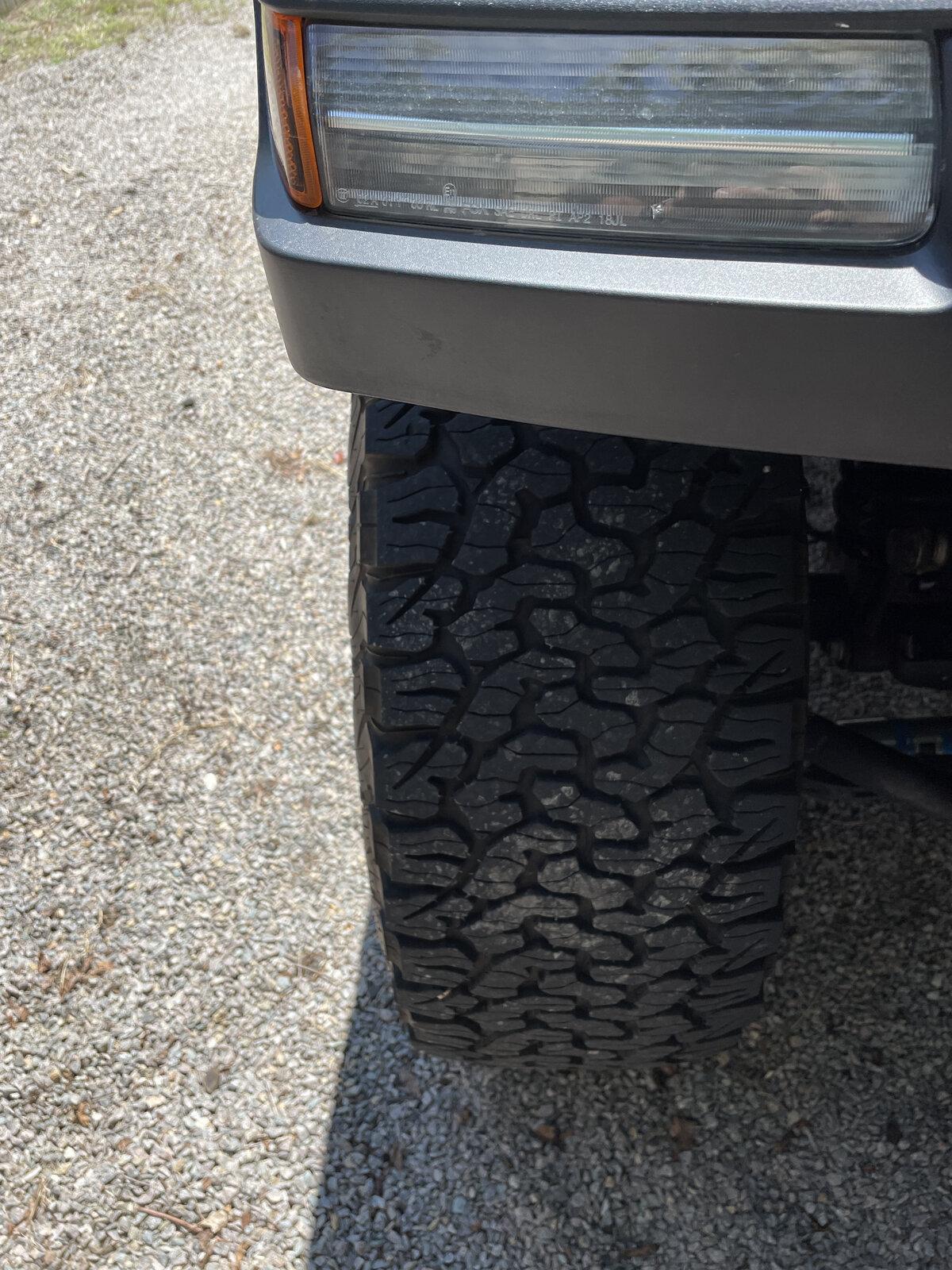

Aev wheels would answer the mail on your desire to keep the wheels inside the fenders. I have the salta xr’s and the side wall just poke out a little and the tread is all under the fender.
What size tires are you running?
