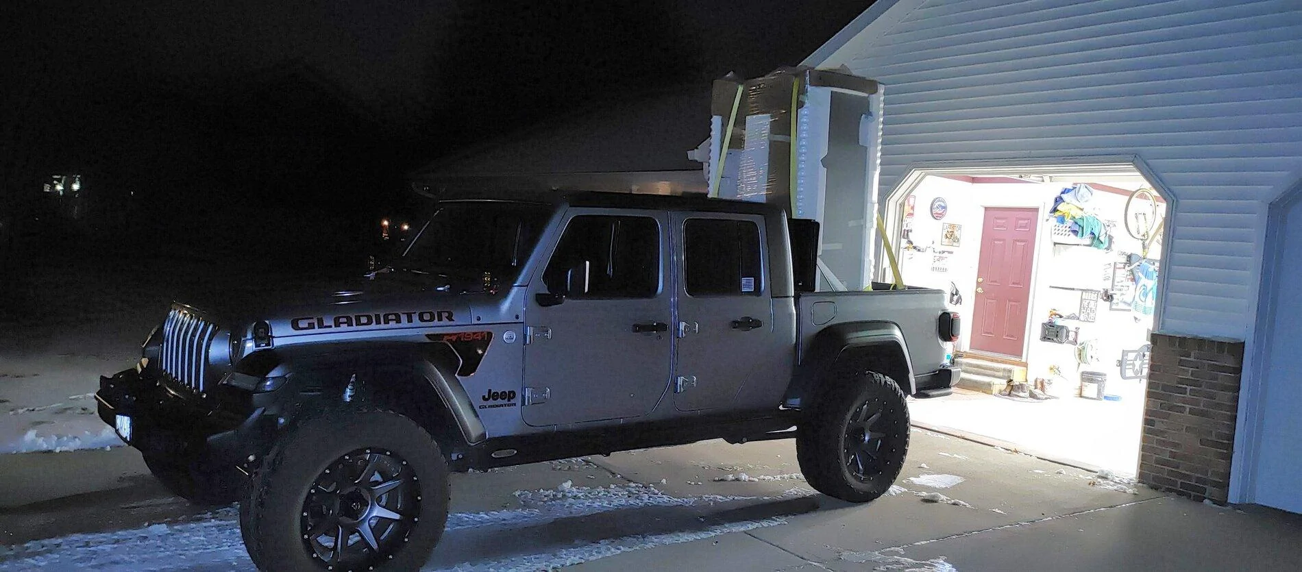

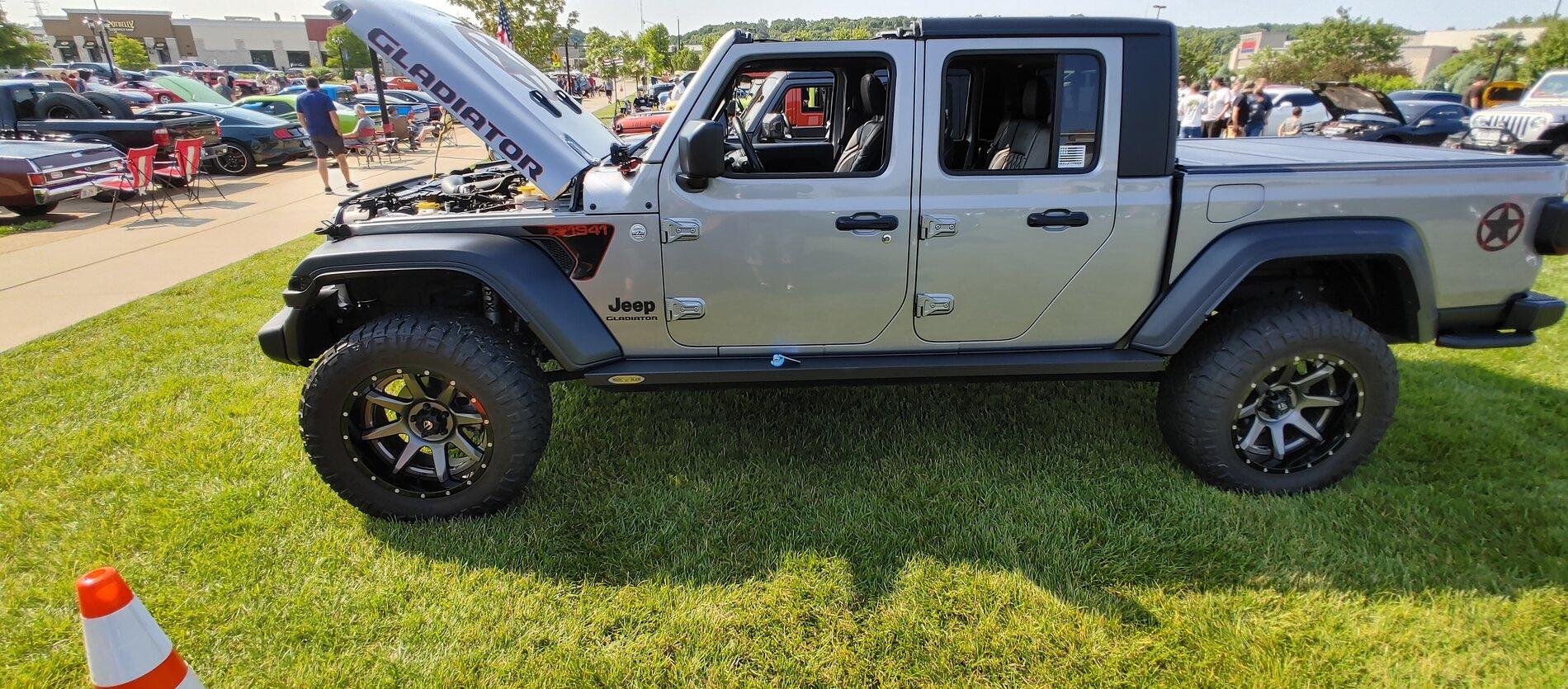

I lifted my max tow a little bit. I have front springs from a Rubicon which were 340 and 343 they raised the front 1”. I also have Daystar 1.5” front spacers and correction pads to prevent spring bow. Rubicon Fox shocks all around with Rubicon Express extensions in the front. Mopar LCAs and Daystar .75” rear spacers. I am happy with the setup, I frequently tow a couple small boats that are both around 3500lbs with around 300lbs of tongue weight and it does fine, also haul stuff in the bed frequently but nothing super heavy usually just bulky. The Fox shocks are okay but could use more dampening. I am running 285/75/17 Toyo ATIII tires LR C on stock wheels.
