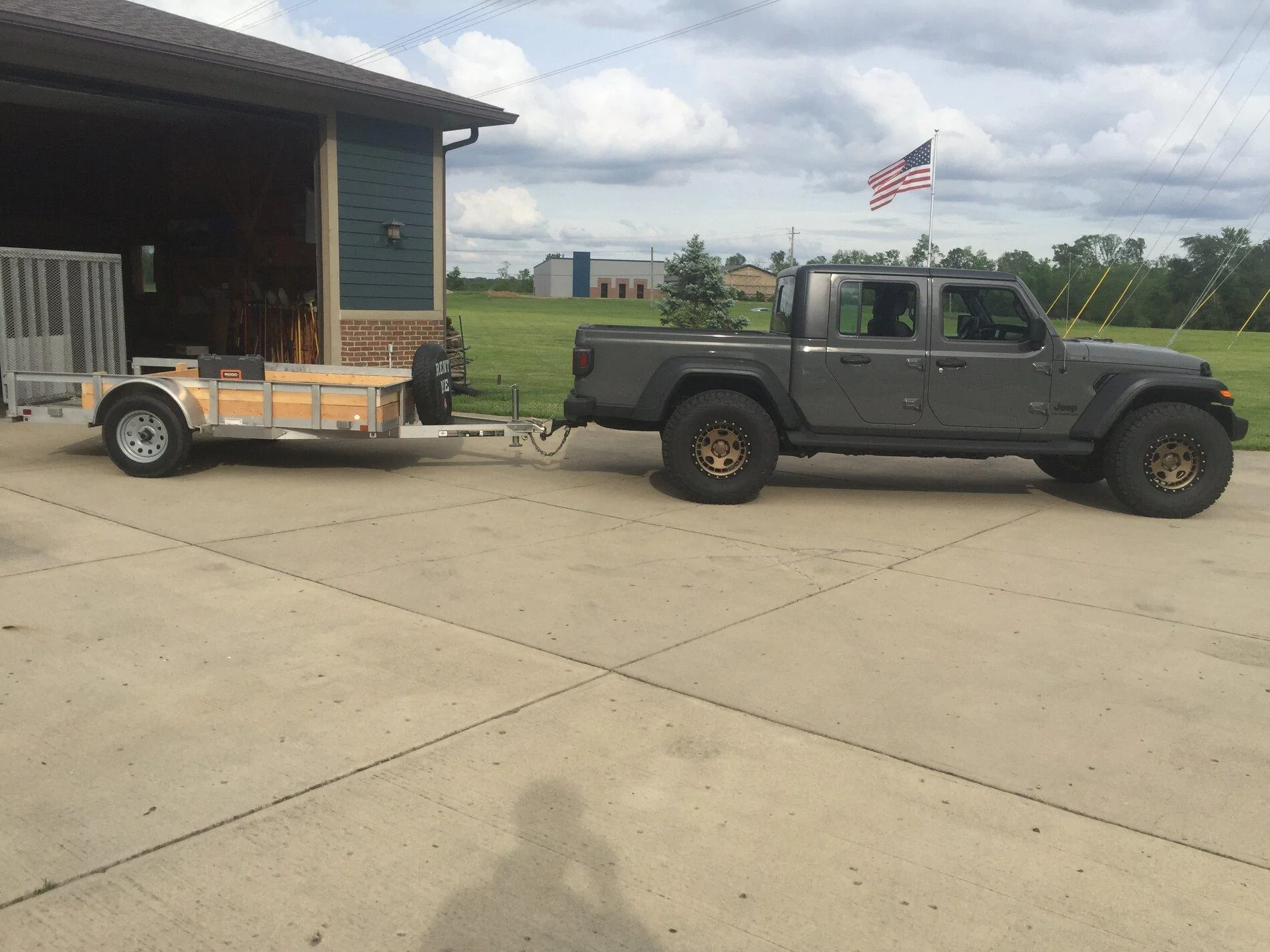

I too like the look of open fenders like you. Just finished up doing this, you would have to talk to the manufacturer on the lifts as been mentioned on this thread. I went with the Rock Krawler Adventure 3" lift. actually 4.25" front/3" rear over stock Overland suspension. This image is 295/70/18 (34s) with approx. 700lbs of weight on the rear, onboard water tank etc. Still has a slight rake. Quad rate springs in the rear. handles the interstates through the mountains with no issues keeping up with traffic. I too sometimes load a small enclosed trailer filled with scoots. stock 373 gearing for now but absolutely no issues towing and simply locking tranny into 6th gear.
Jeep Gladiator Max towing and lifts PXL_20210218_222120823
Did you put spacers with the springs to get the 4.25? That's a good looking setup
Very nice stance.

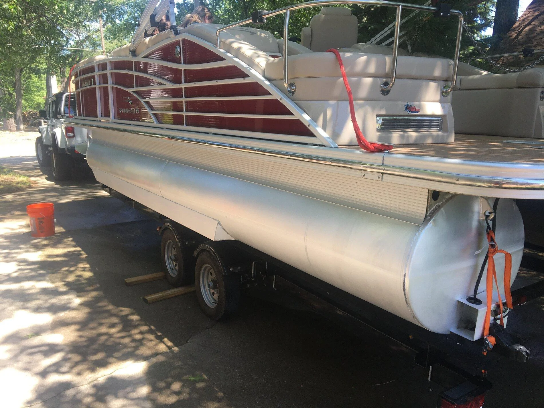

I'll throw my $0.02 worth. I went with the Max tow basically so I could have all the benefits as most people have stated (wider axles, lower gearing, hd cooling etc). I tow a couple of 24 foot pontoon boats a couple times a year and not very far (less then 20 miles 1 way). SO the max tow was overkill for that but wanted a nice stance and room to put 35's and have enough clearance to still do some mild off-roading. I went with the mopar kit for the fox shocks and the ease of rolling into the payments (yes, there are lots of opinion on it not being a complete kit and others that are better for less money, but that was MY choice). I did the adjustable front track bar (another item that is questionable by some if needed for only a 2" kit). But I got about 3' total lift and my front axle was off an 1 /2 inch and I wanted it centered. Rear axle was still centered so I didn't bother with anything in rear. I have a daystar 3/4" puck for the front when I get around to installing my winch bumper (still in the garage since last October when I bought it :-( ....
I also thought about just doing Ruby fender flares and not doing the lift, but it rides really nice with the fox shocks and fox steering stabilizer, so I am happy I went this route.
I knew once i did the mopar lift, I didn't have a max tow anymore, but again I didn't need that capacity to begin with, so I am pretty confident I'm not over taxing the truck with whatever I am towing or hauling.
As ShawdowsPapa says, know what you want to do with it and know that any mod you do on ANY trim level you end up with, will detract from the overall factory rating.
Hope this helps
T
