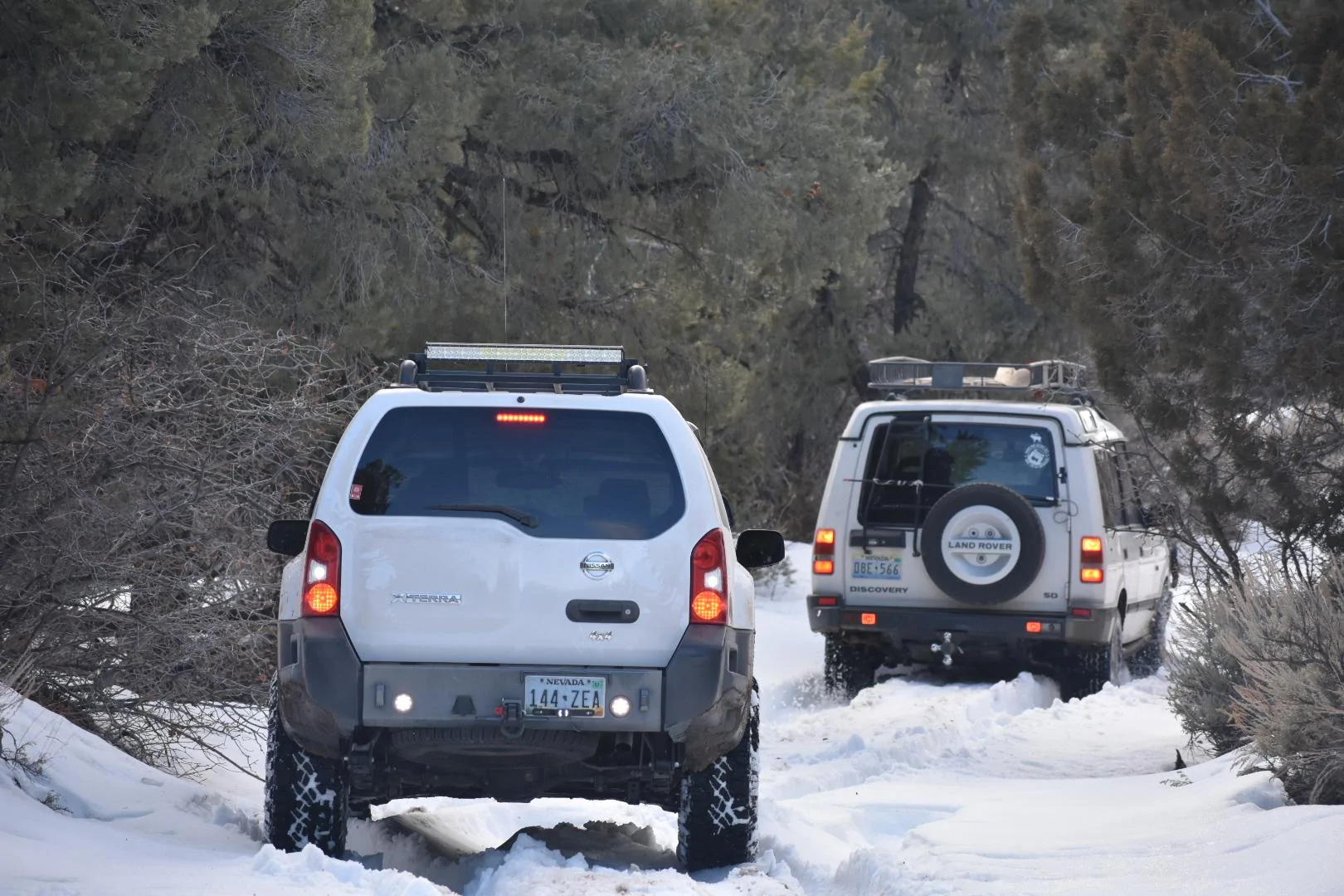

Not sure if you were referring to my post, but here is some reference for the only time I’ve done it. Fresh powder with ice beneath it. We were moving a few feet at a time.
I don’t remember who’s post it was, but I like your Xterra. I had a Silver 2010 several years ago. It was a really good vehicle for me and I like that rear bumper. I didn’t do a lot of snow wheeling. I had a super scary experience on a shelf road when I ran into an unexpected snow storm and I was done. I wasn’t sure if we were going to make it off the mountain that day.
