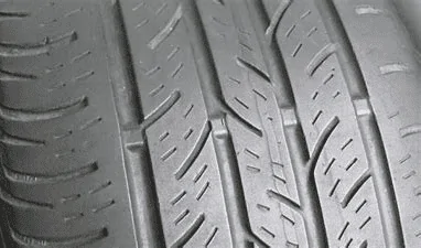

Yes there is a tire gauge, Every tire store has them, you can purchase at any auto parts store.. it measures in 32's of an inch or mm.. in Pa the state min for passing inspection is 2/32s.. tread wear bars are on passenger tires LT tires .. As for the brakes, you should pull the wheels and visually inspect the pad thickness.. again 2/32s thickness is the min. .. replace before wear gets to the metal backing plate and requires rotor replacement. IMO at 56K the rear pads might be close if they wear like those on a JKU..
here is a picture of tread wear bars:
