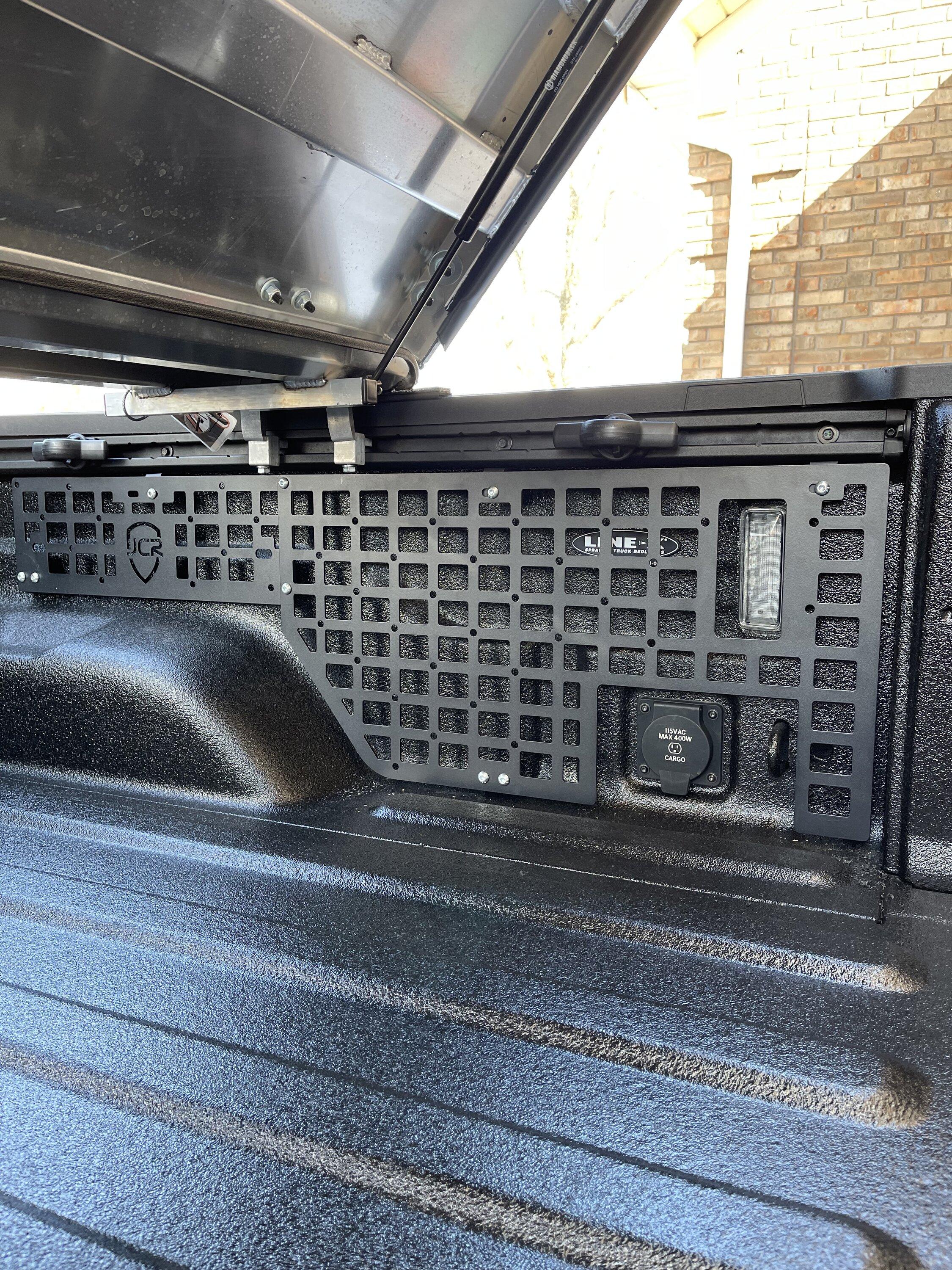

Monstaliner. I rolled it in but it can be sprayed. 67 colors and they claim 100% uv protection. I have a tonneau cover, so I'm not too concerned about any fade. It is rolled with a very textured roller which allows you to lift the product to a heavier texture as it sets. I went with a medium finish, which seems to be holding stuff in place. It feels "soft" to the touch, unlike the painted metal bed, but it's an epoxy and is definitely tough.
Awesome job!
Can you see any lines from the roller? Doesn’t appear to have any in pictures.

Awesome job!
No lines at all. The finish is very consistent. I went with a mild texture, waiting to roll it again as the epoxy "gels up" would give a rougher texture.

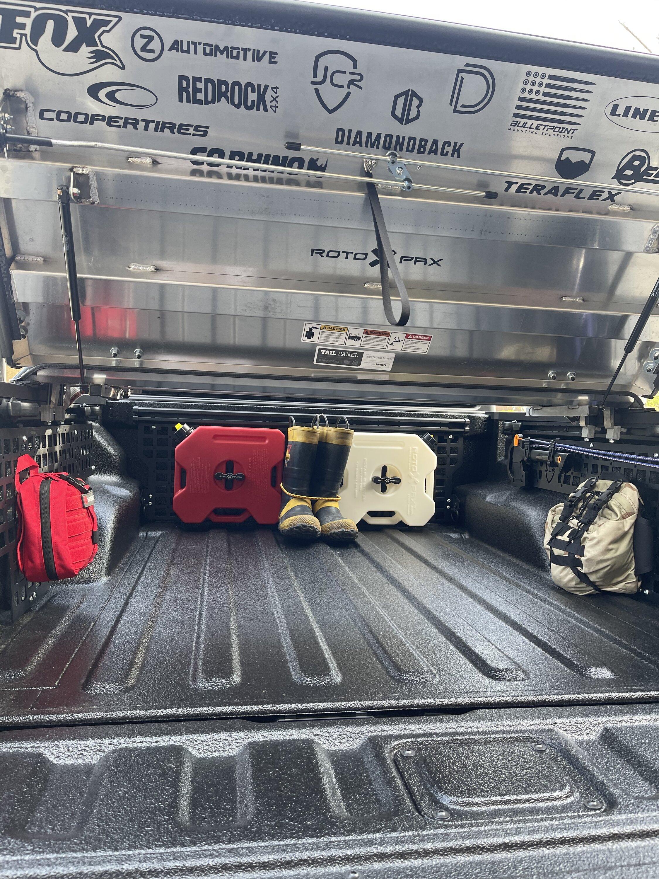

Is that one coat or two - I do like the texture you ended up with!
Two coats. I rolled out the first coat then waited until it was dry to the touch, about 3 hours before rolling on the second coat.
