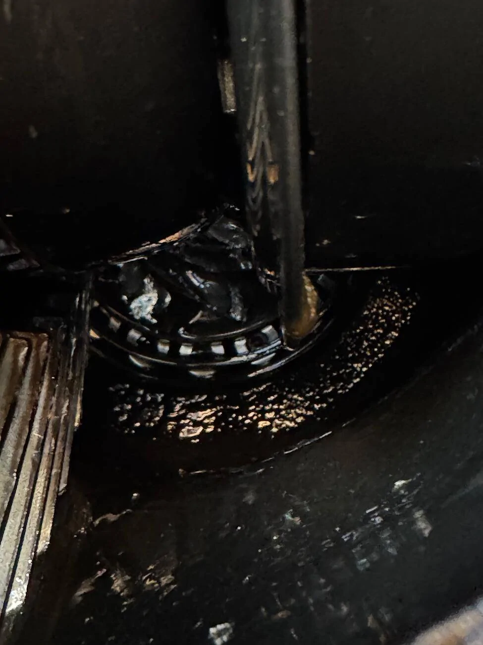

good luck. I hope you have good experience I did, until I didn't, yesterday. My Yukon gears just failed on the highway with no warning - about 3.5 years ~ 40k miles (50k on the Jeep). They were professionally installed by a real pro with a ton of experience and a great reputation, broken in properly and inspected. The pinion gear disintegrated. I'm going with Spicer
Jeep Gladiator Which manufacturer for 4.88 gears and where to buy? tempImageymKXyN
Jeep Gladiator Which manufacturer for 4.88 gears and where to buy? tempImagejXci3Q
