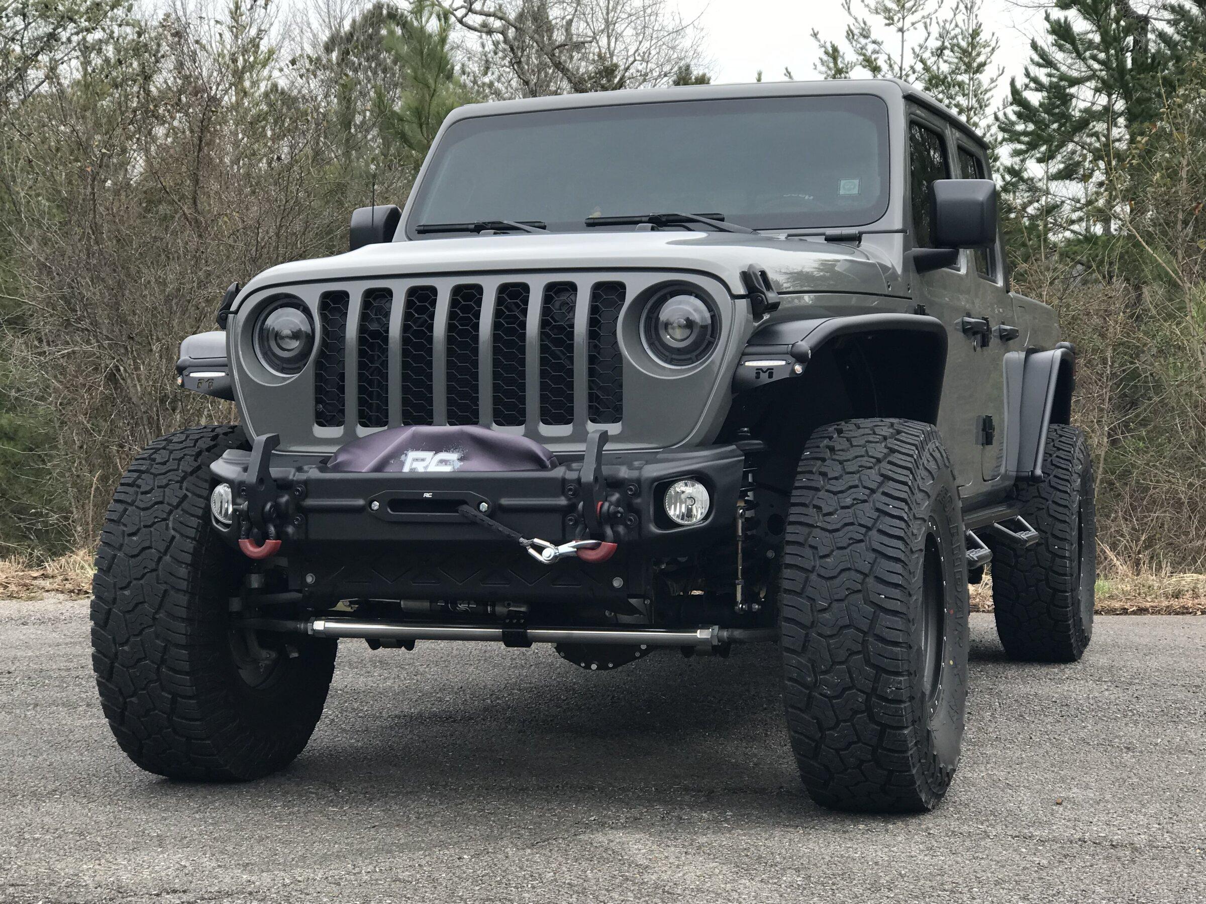

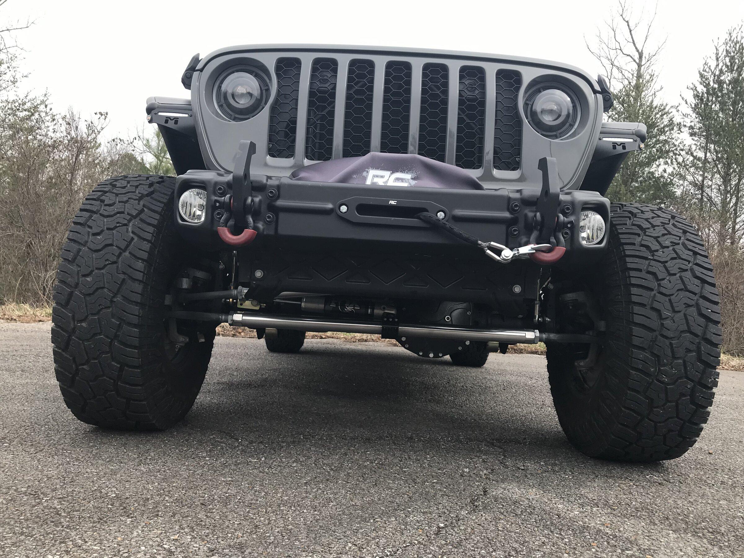

I got the clayton track bar installed along with my rpm 2.5 ton steering. Very nice pieces from both companies.

Looking good!
I know you already purchased and installed but if anyone else is looking Core4x4 requires no modification. I have about 15k on the one in my JL and no issues. Just saw last night they are making a steering setup now.
