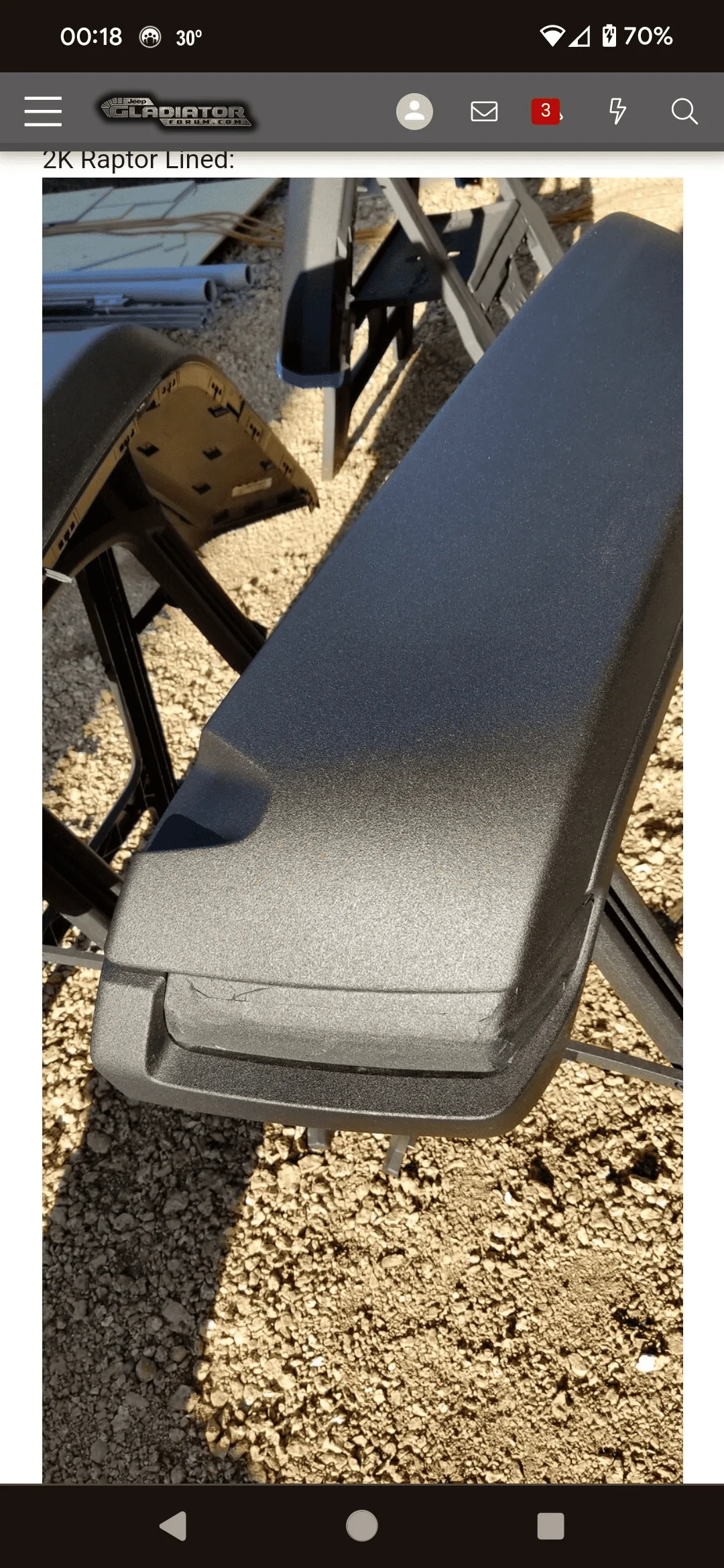

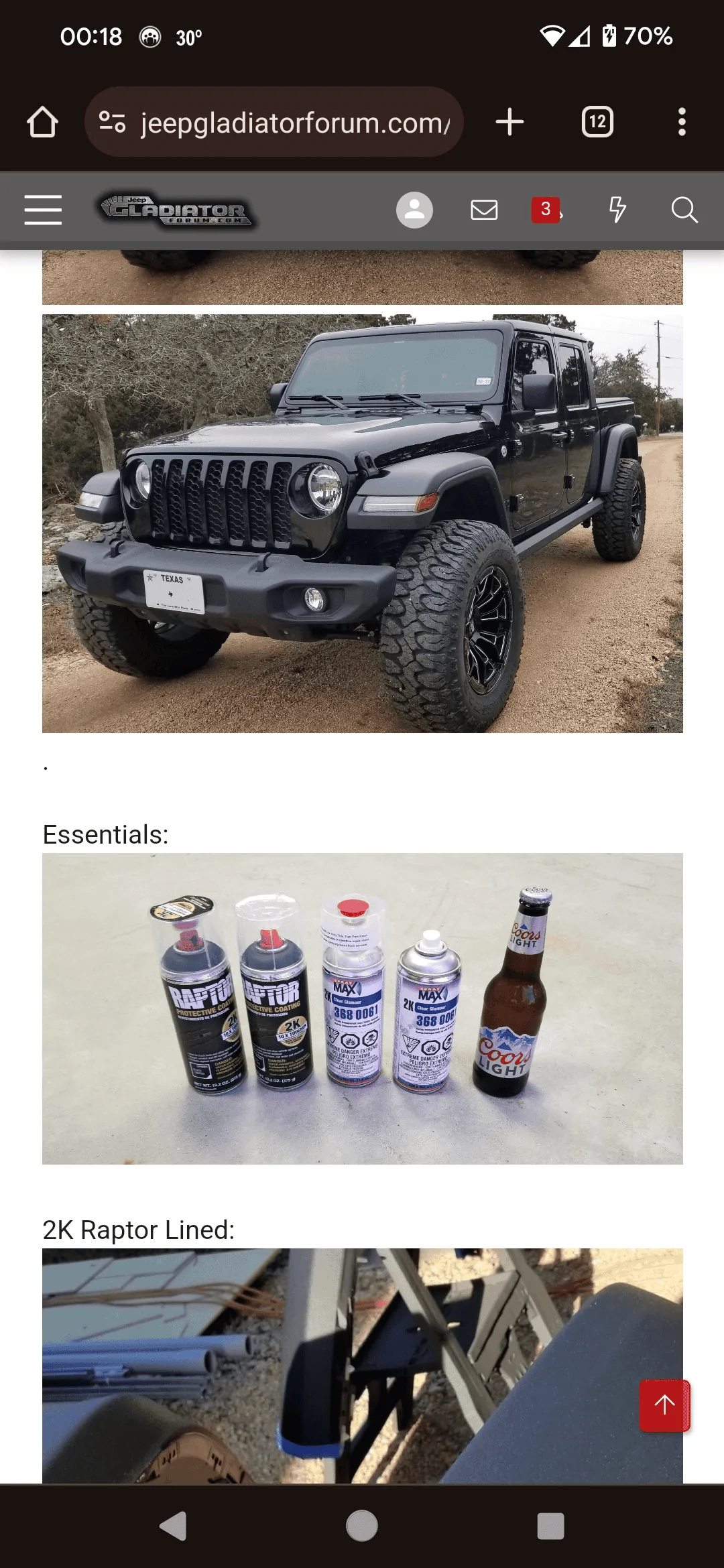

I saw a thread on here before that the guy used the black spray on raptor liner and it turned out looking great.

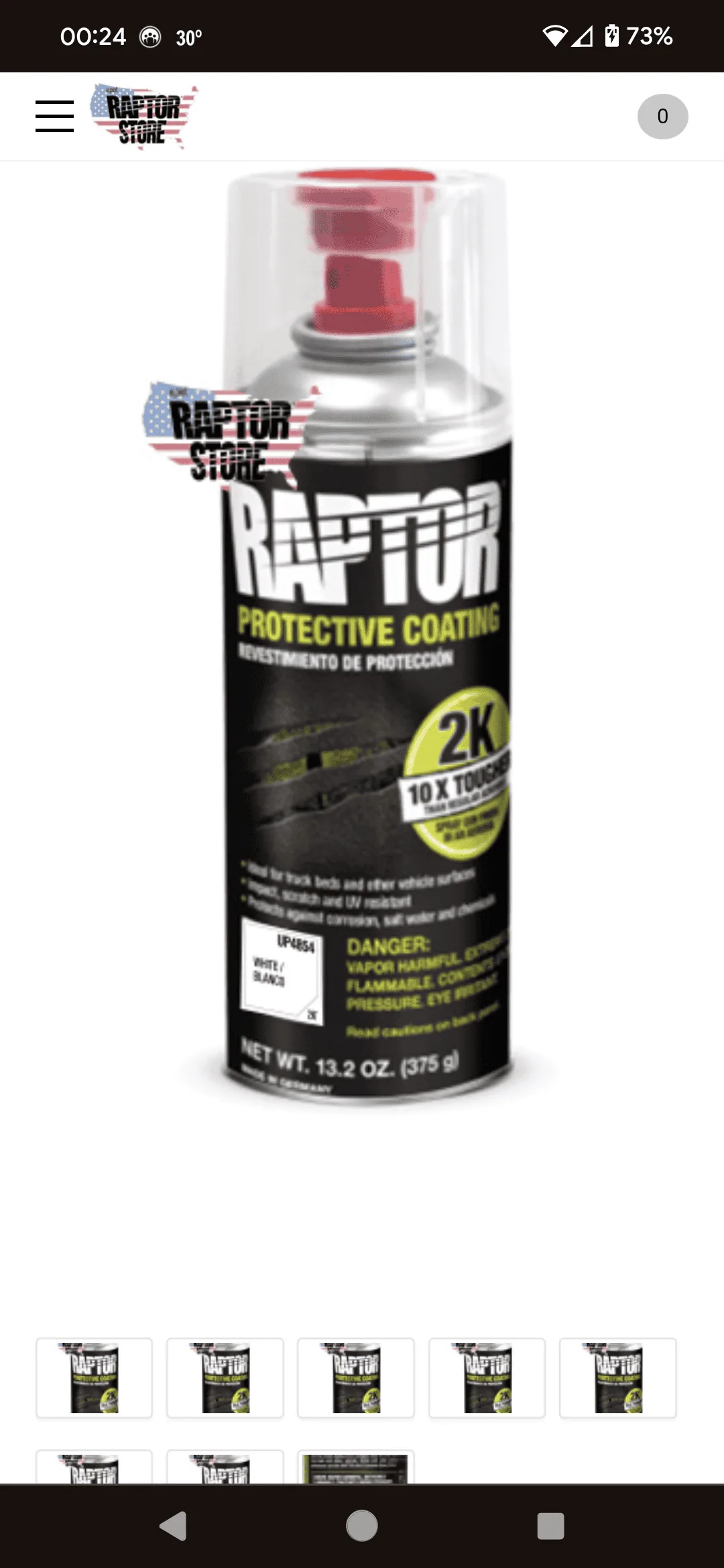

I like the look of the painted flares I currently have and was thinking about using the white raptor liner on the textured rubi flares. Just seeing if anyone has used the white Raptorliner and how did it turn out.

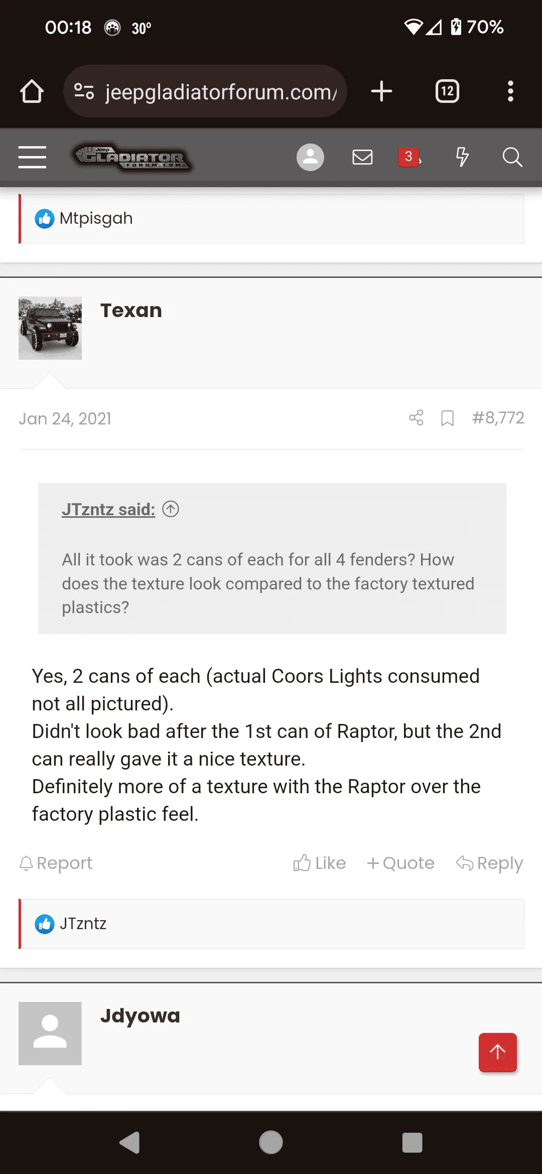

I am going to sand down prep and all that, but instead of using black raptor liner, I was wanting to use the white. I was seeing if anyone has used the white spray on and how it comes out rather than black... See the screen shots.

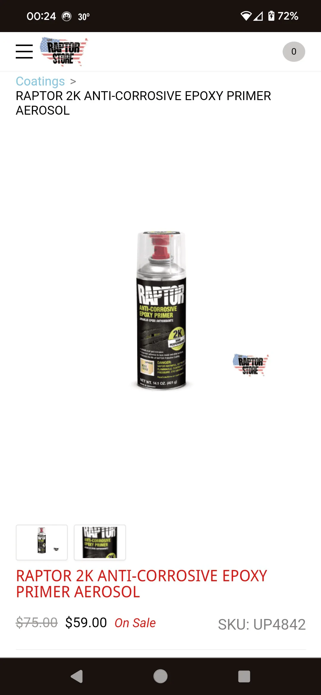

I’ve done this on my last rig’s grill. Albeit, in black. I can’t see why it wouldn’t turn out okay as long as you take your time and aren’t stingy with the primer, don’t cheap out on the primer.

My caution to you before you jump off the cliff is this.
Have you ever seen white spray in bedliners after they have been exposed to weather & the UV from the sun? Sooner or later, most end up looking more piss yellow than white.
Just a thought.

White is not like Black. Lets forget about what it will look like down the line and think of what it will look like as soon as you are done.
Black is the only color that doesn't have to be matched, black is black - except for those black Chryslers in the 80s, they weren't true black and had to be color matched.
White can have a blueish undertone or a yellowish undertone, etc. so if you use a white out of a spay can, odds are it won't match. Easy test, do a test panel with the Raptor Coat white and see how it looks next to the truck. Being a couple shades off looks really bad...
As Toytech01 said, you can get the tintable Rapter Coat and get the bodyshop to match your white paint and go that route.
Assuming you get the white to match by whatever method, then you have to consider what they will look like after getting dirty and being exposed to UV rays, a whole nother discussion if you get past the color matching part.

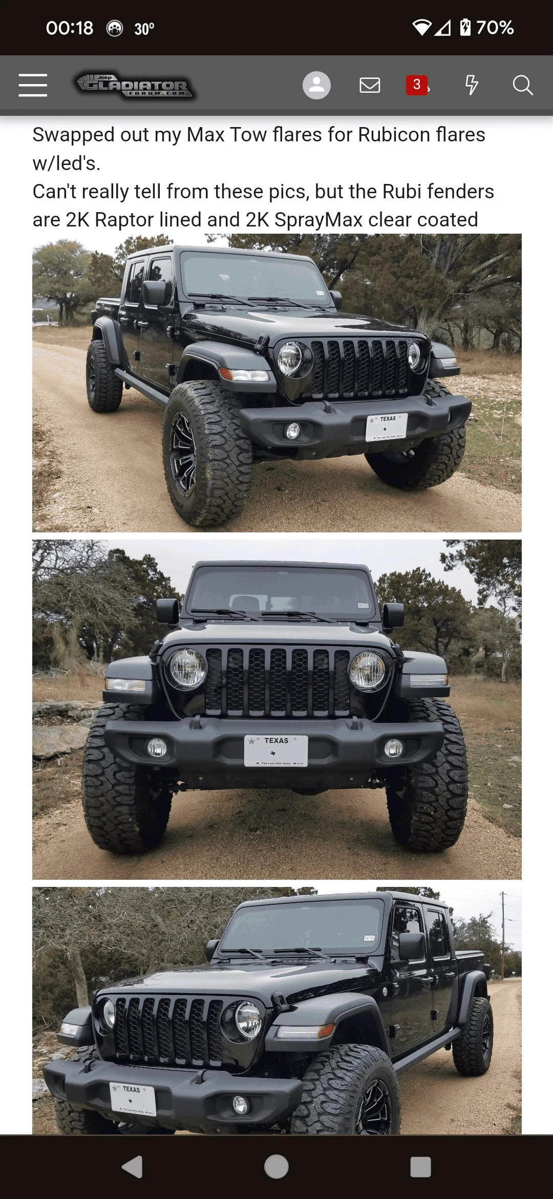

I get what you're saying. I had seen the post before (screenshots in this post) of the guy that used the black raptor liner for his fender flares.
