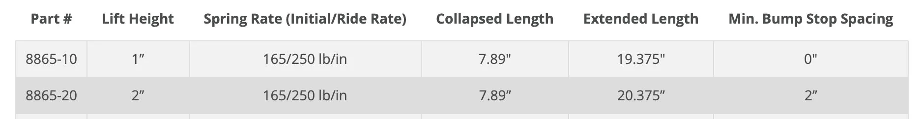

I went with new Synergy springs front and rear on my JTM... steel bumper with winch up front, and Decked plus another 150lbs in the bed, roof rack and inspired overland soft top RTT on the cab. PLUS my Rockslide Engineering sliders aren't exactly lightweight lol...
Rides great, little firmer, but that was the goal. It does sit slightly higher than OEM, but with my 37s, it's perfect. I will probably swap the front springs again for an inch taller... to level it out. Right now I've got a rake since I wanted to be more level while towing, but I think it'll only slightly sag while towing rather than riding on my rear bump stops like before.
You DO need to have a bump stop spacer in the rear with this set up (and the front if you go to the next taller spring) AND a shock relocation bracket (moves the axle side mount upward to keep the shock length similar to OEM). I need to find a shock relocation bracket for the front when I go with the taller front springs.
Springs carry the weight, shocks control the bounce... I think going this route would work great for you, and save you a lot of money.

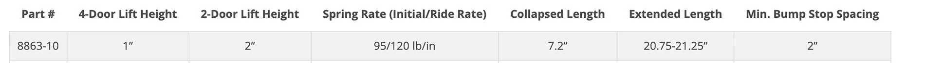

Current front set:
Jeep Gladiator Who Re-valves Mojave Fox Shocks ??? Screenshot 2025-02-06 at 10.16.46
Rear set (2" row):
Jeep Gladiator Who Re-valves Mojave Fox Shocks ??? Screenshot 2025-02-06 at 10.17.47

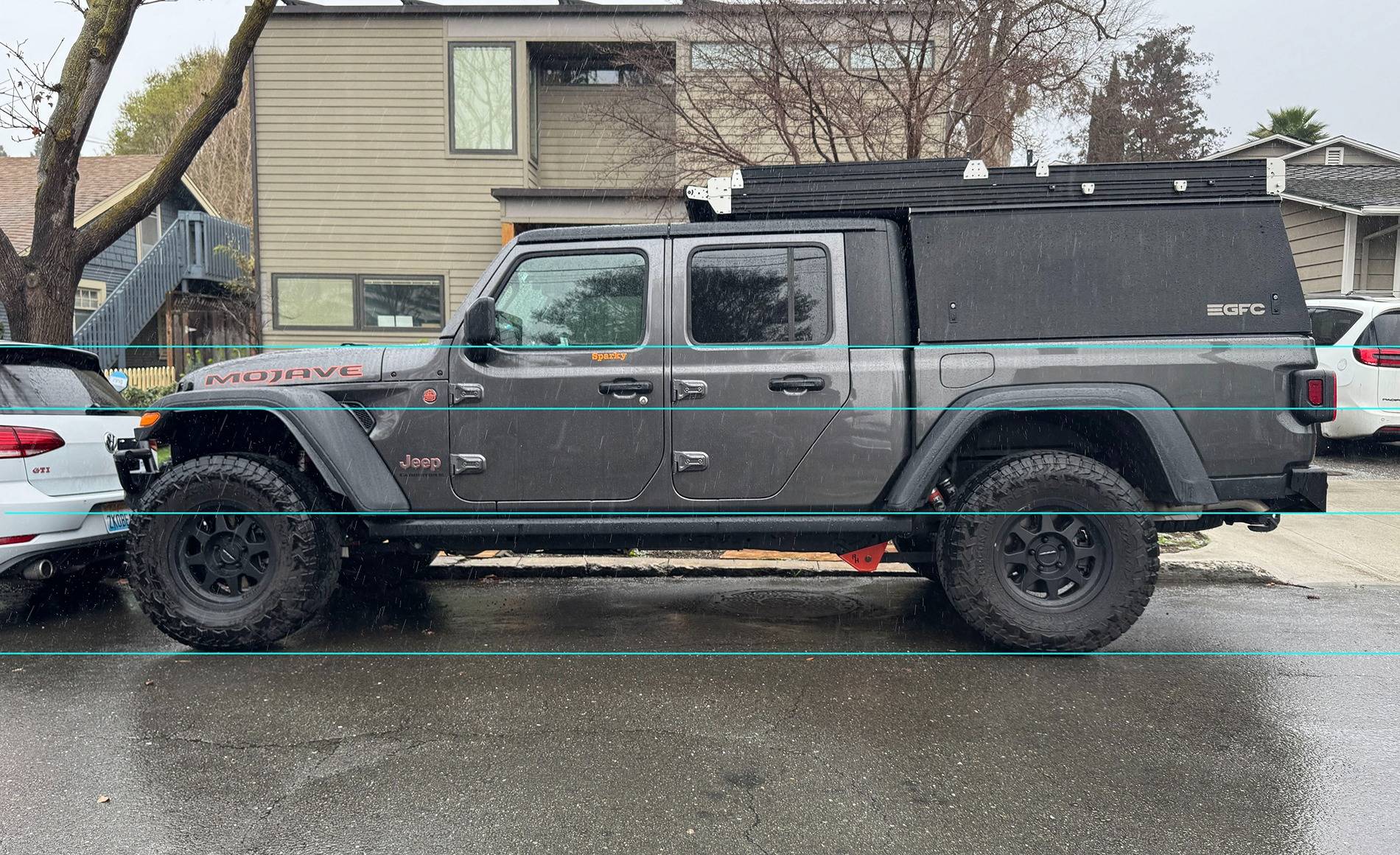

Okay the rain finally let up...
There is (approximately) 4.5" of shaft exposed and the eye-to-eye shock length is (almost exactly) 22.125".
My JTM is sitting very very close to factory ride height. This is with stock springs and 1.5" spacers at all 4 corners, GFC camper on, & a full tank of fuel. No passengers, no extra camping gear.
Note sure how relevant this is, but visually the truck appears to me to be level.... no rake, no squat. in the photo below I did my best to take the shot level and square to the Jeep. I added the cyan reference lines (all parallel to each other) to help me get a sense for "how level does it look".

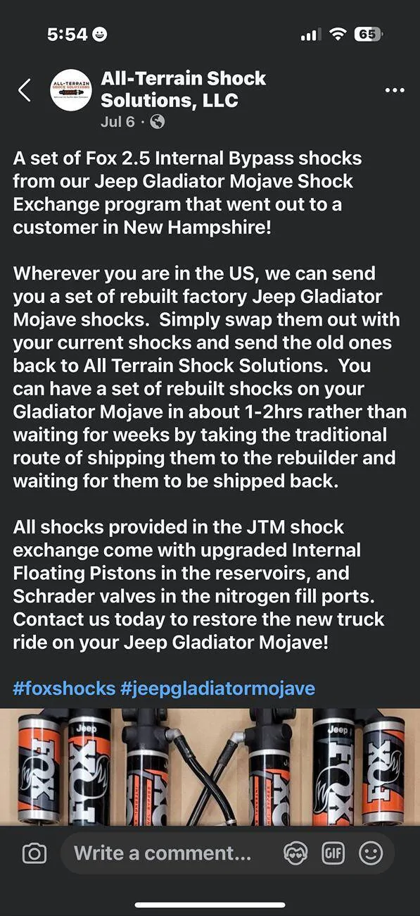

All Terrain does rad stuff and their Mojave shock swap program is brilliant! However they do not offer re-valving service for the Mojave shocks..

So I talked to the Fox reps at King of the Hammers last weekend... remembering THIS thread, I asked about them rebuilding AND/OR revalving our OEM Fox Mojave shocks... They said they do!!!
I'll find the card they gave me for contact info, but I'd think you can find contact info online pretty quick.
