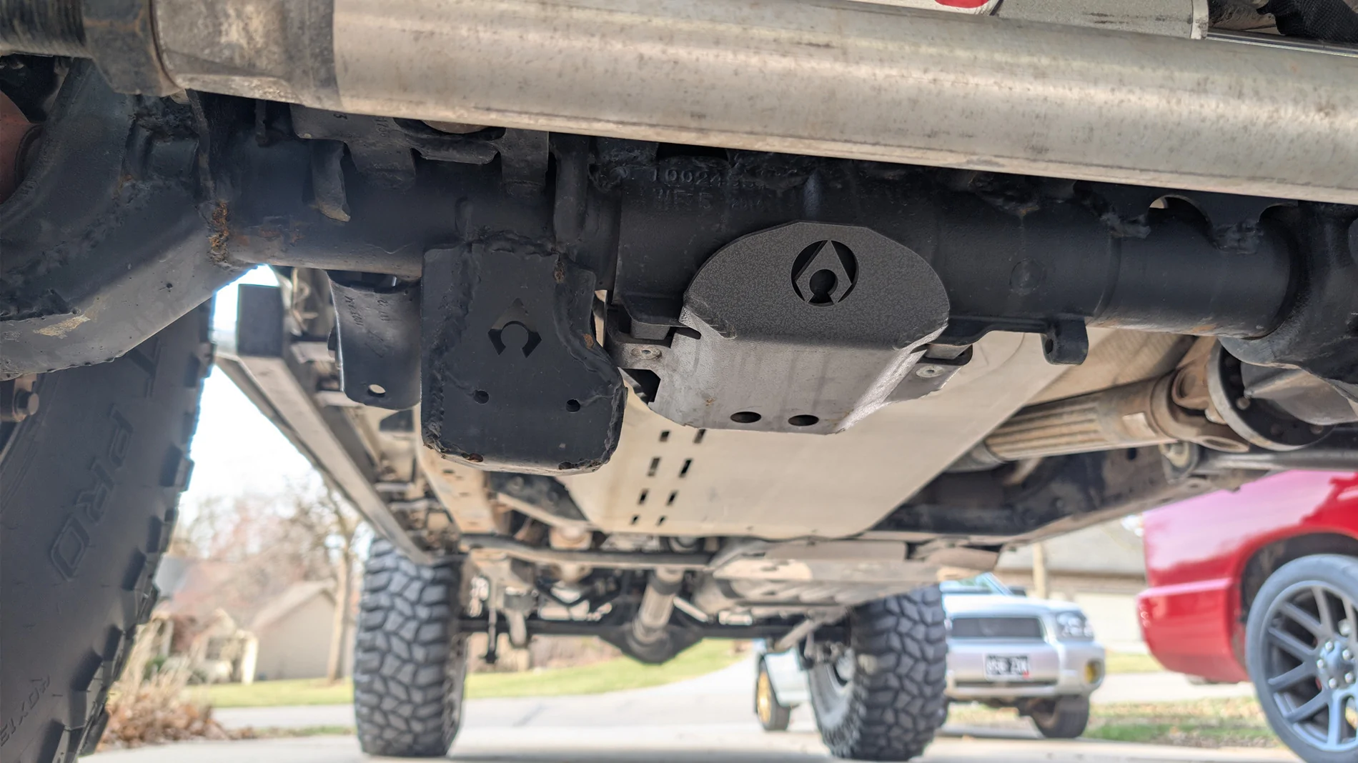

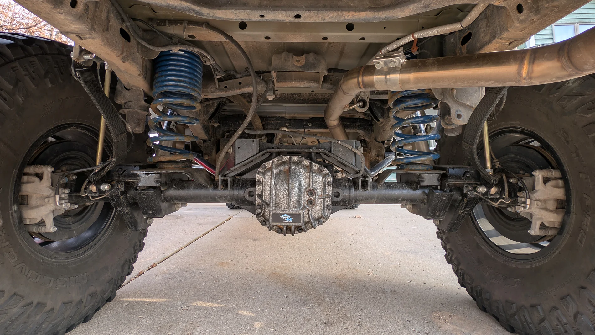

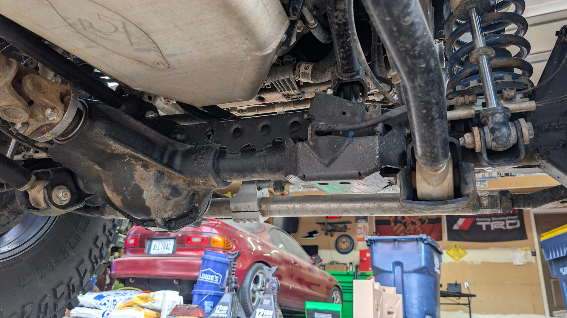

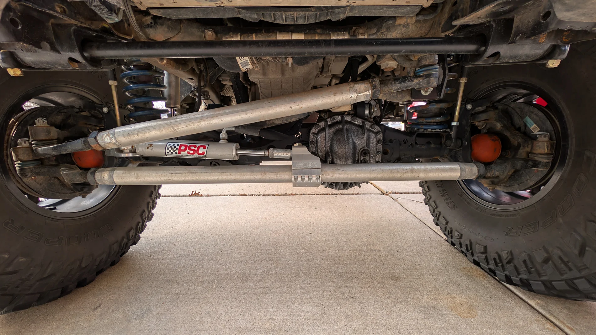

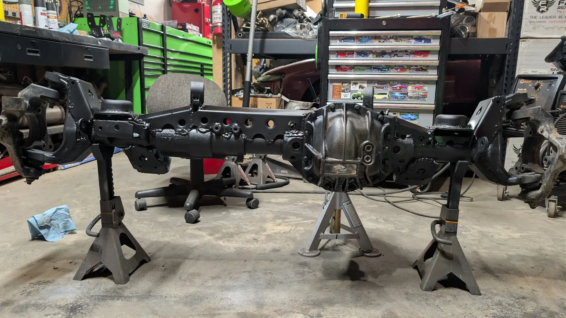

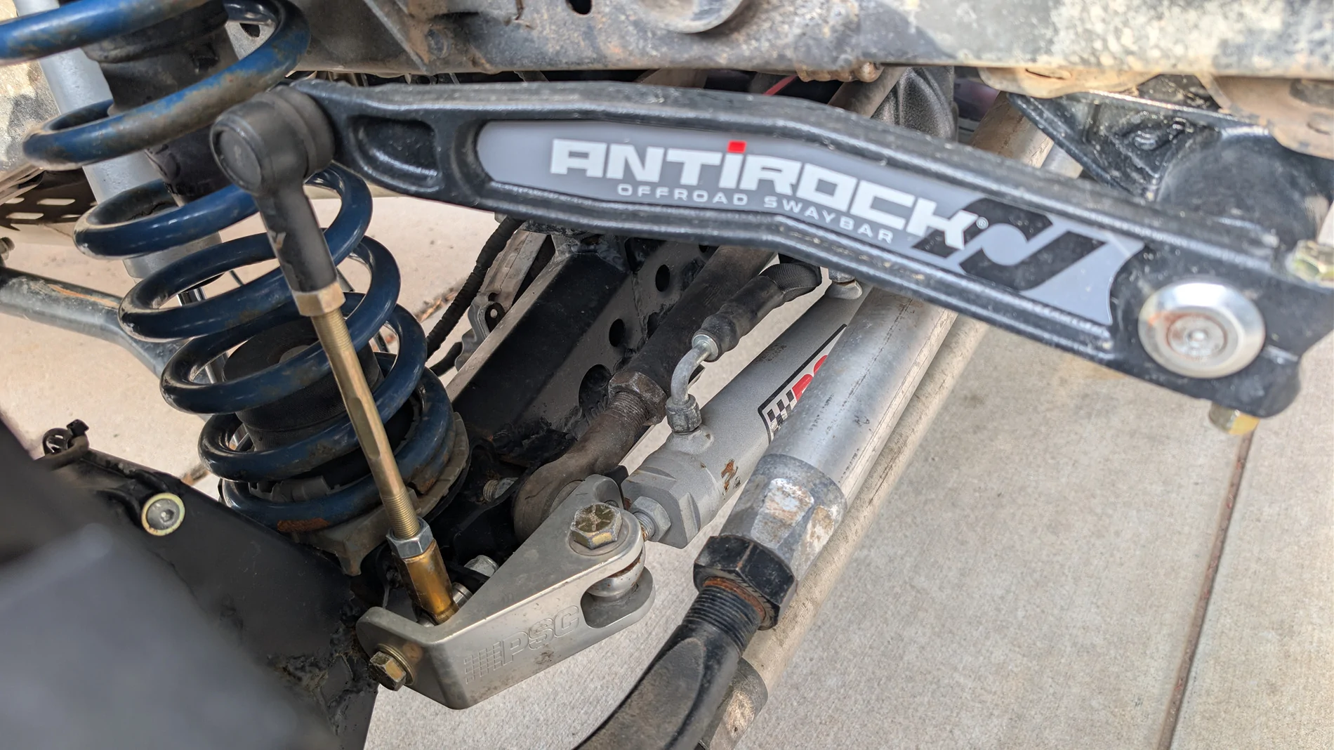

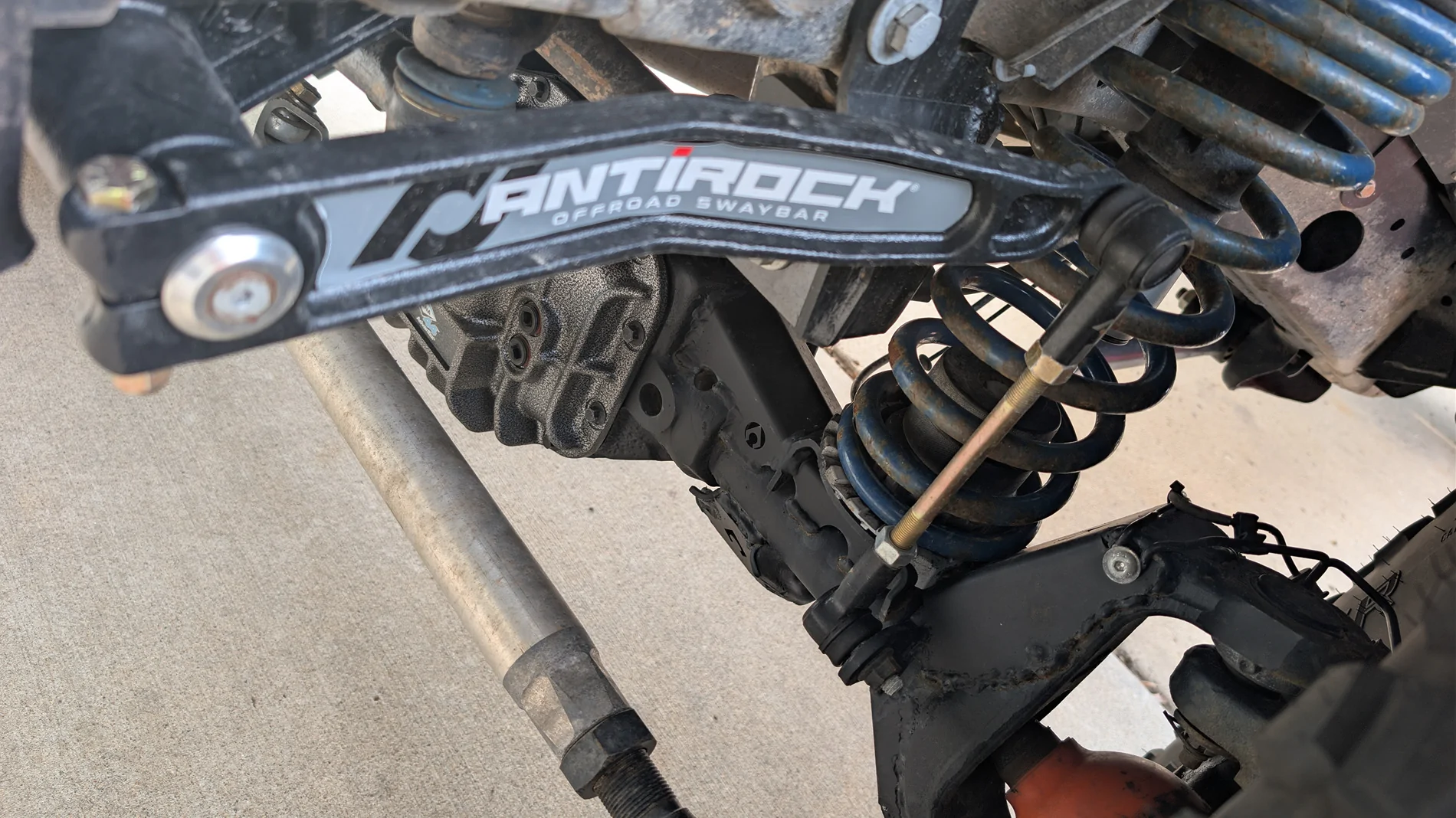

Probably repeating a lot that you already know and maybe dancing all around your question without a really helpful answer but this is a forum, so fuck it, these are my general experiences and thoughts having gone down this path recently.
I did Moab last fall, tackled the trifecta, Hell's Revenge, Fins, Elephant hill, etc, but skipped Pritchett since we were solo. That was on 40s, 3.73s, RCV fronts, Dynatrac ball joints, Spicer Chromo rears, and PSC hydro assist. Those trails are so grippy though, it was really very drama free. Either way, no problems.
This winter I did some more upgrades, as I was planning a longer wheeling trip that includes the Rubicon this spring.
So since then I've installed 4.88s, trussed and gusseted the front, front lower control arm skids. The front axle is as built as I think it can be, within reason. The rear axle I've gone with an off-the-shelf triangulated upper setup, so it's not quite a proper truss. I already had this in Moab as well. It's welded onto the tubes on each side of the center section but it just bolts into 4 existing stanchions you drill and tap in the upper part of the center cast section. So it probably helps with axle flex overall but a proper truss would be better. If you're keeping it 5 link in the rear a proper weld in truss would be the way to go. In fact, I've got one in my garage I purchased before I decided to go 4 link. I might still weld up a custom truss at some point so I can install straight upper arms in the rear but then I'm shaving the frame side brackets as well. Just didn't feel like getting into that right now. But pretty good chance that'll be happening soon.
For the RCVs in the front I opted to retain the FAD functionality, I think the street benefits outweigh the cons given the axle already has the cast FAD section. Not having a FAD housing at all would be preferable but since it's there I'm going to make use of it. The Artec front truss fully bridges the FAD housing, and the RCV kit comes with the inner shaft and a new stronger collar as well. I installed an Artec FAD skid as well just to prevent direct impacts to the casting.
I think bolt on control arm skids are kind of stupid but several people make weld-on lower skids for the front control arms where it matters, that tuck into the existing mounts and don't hurt clearance. Huge fan of those on any rig I wheel.
IMO the factory twin piston brakes are enough for the 40s. If you really want to upgrade to anything worth upgrading to you really need wheels larger than 17s and that's where I think you start getting into the slippery slope of "do I just go to bigger axles, then?"
I can say I wouldn't wheel a diesel Gladiator on 40s without hydro assist. I did Mesabi Mountain Trail up here in MN with just a steering stabilizer and there were multiple points where I COULD NOT turn the wheel. With 37s it wasn't a problem. But with 40s, and especially if you're going to air down and play in the rocks, I think a hydro assist is a non-negotiable.
Lastly I did all the labor myself. I don't know if I could justify the cost of all this work if I was paying somebody else to do it. I think that's really when you need to ask yourself if it's worth it or if you should just buy some bigger axles and bolt them in in a weekend. It's a lot of money to sink into axles as a bit of an experiment. Do I think they're strong enough for what I do? Yes. Could I beat on it more with a 60 in the front and an 80 in the rear? Yes. Would the steering geometry be way better for 40s if the axles themselves were a couple inches wider? Very yes.
So you said $4100 for gears and truss, I'm guessing that's paying somebody to install them, otherwise it's really high. But also add in the ball joints you said you haven't done yet, and a hydro assist if you don't have it. (which is a bear of an installation on the diesel.) I'll assume you already have beefy steering, but if not, you need that as well. That's your real price, imo.
Last I weighed my Jeep it sat at 6150 lbs empty. That was before I've done a bunch of work and I'm swapping bumpers here soon. I suspect it's going to end up closer to 6500 lbs. 7500 is a real chonker.
