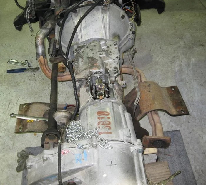

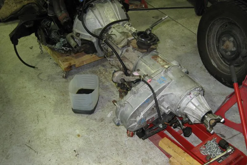

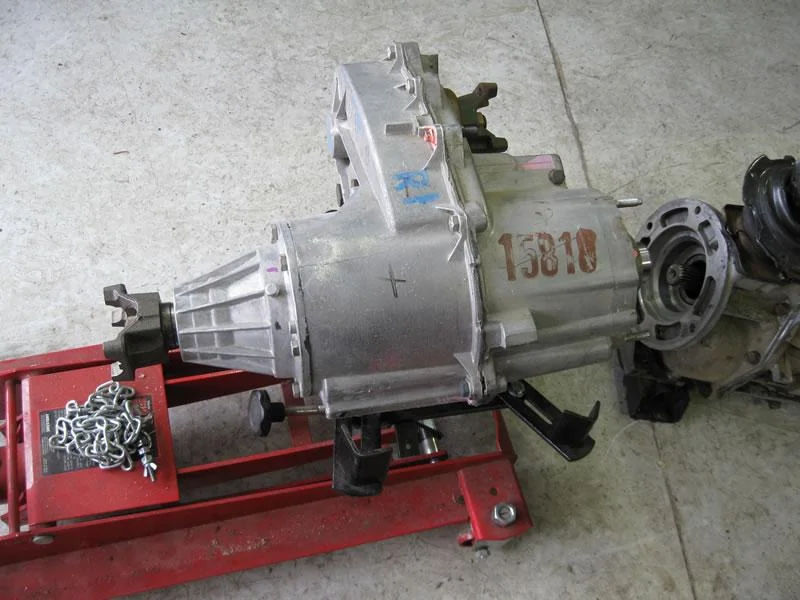

by the way, I have several NP 119 and 129 transfer cases in my shop if anyone needs one for parts or to fix up.
40,496
54,011
np transfer case?
New Process.
This is the NOS (new old stock) NP129 I put in my car.
I built the engine, then the drivetrain I assembled on the shop floor, and put it in the car from below.
I have a number of used transfer cases in my shop for some reason. Guess I am a pack-rat?!
