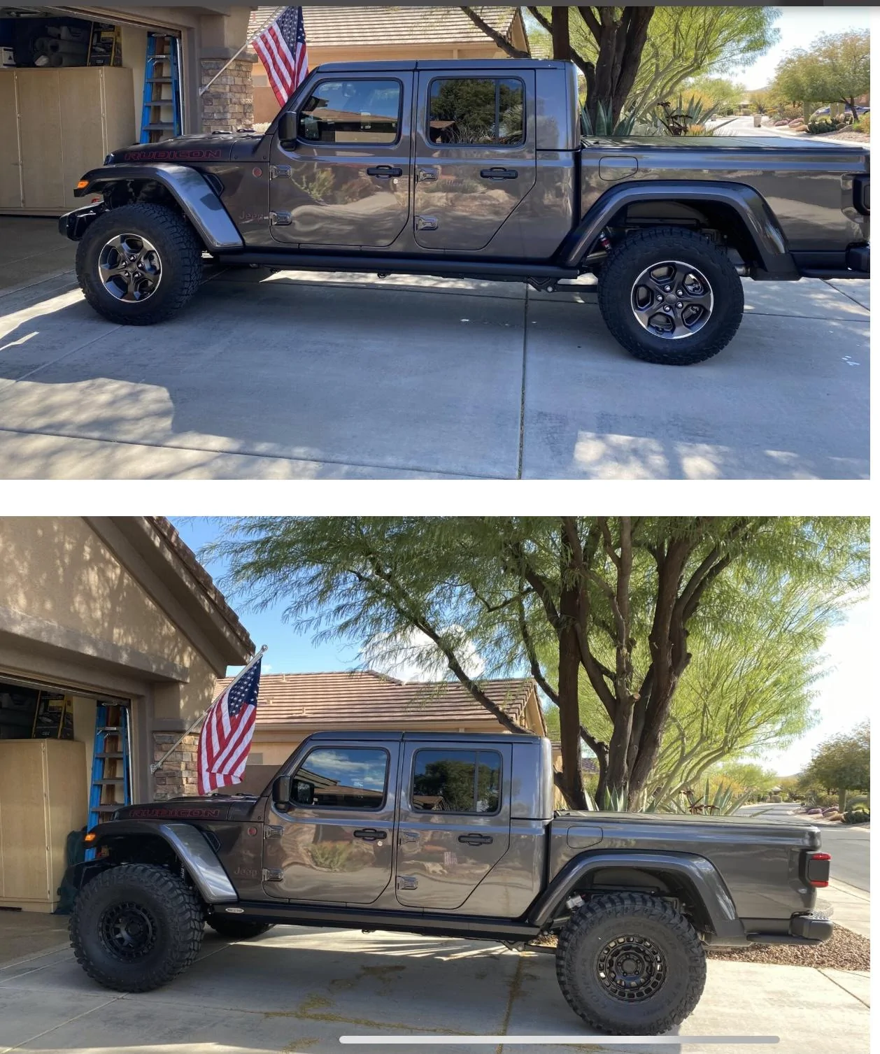

Not only 37s, but 37x13.5 here all day long and will never look back. Went with Cooper STT Pros and will do same when I replace. Yes, I did re-gear. It’s a must. Min 4:88s. 18 mpgs all day long.
I wanted the best on road manners I could get that didnt sacrifice anything for off roading.
To this day I see 35s and while they still look good, I am glad I went with the 37s. Docs comapro pics above shows it well.

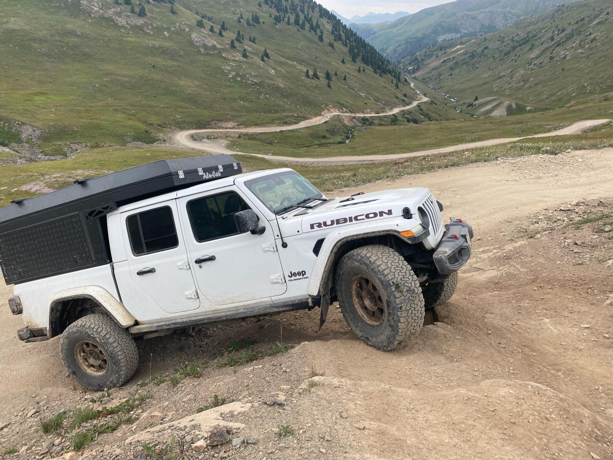

Fwiw- I run BFG KO2 37s on Mopar 2” on my JTR 8 speed
a few things to note:
1. BFG sizes run smaller than advertised
2. The 8 speed auto makes it work on the stock 4.10 gearing of the rubicon
3. We live at 10k feet in elevation
4. Regear would be nice but not mandatory
5. We wheel all the time
6. If you must have the passing pep back then 4.88 or 5.13 would definitely help, we aren’t struggling, but also realize we are pushing a brick with a camper attached
7. Our speedo didn’t need a correction with the 37s (based on the local speed cameras)
pm me if you want more details. Because of of the long wb went 37 and glad we did.

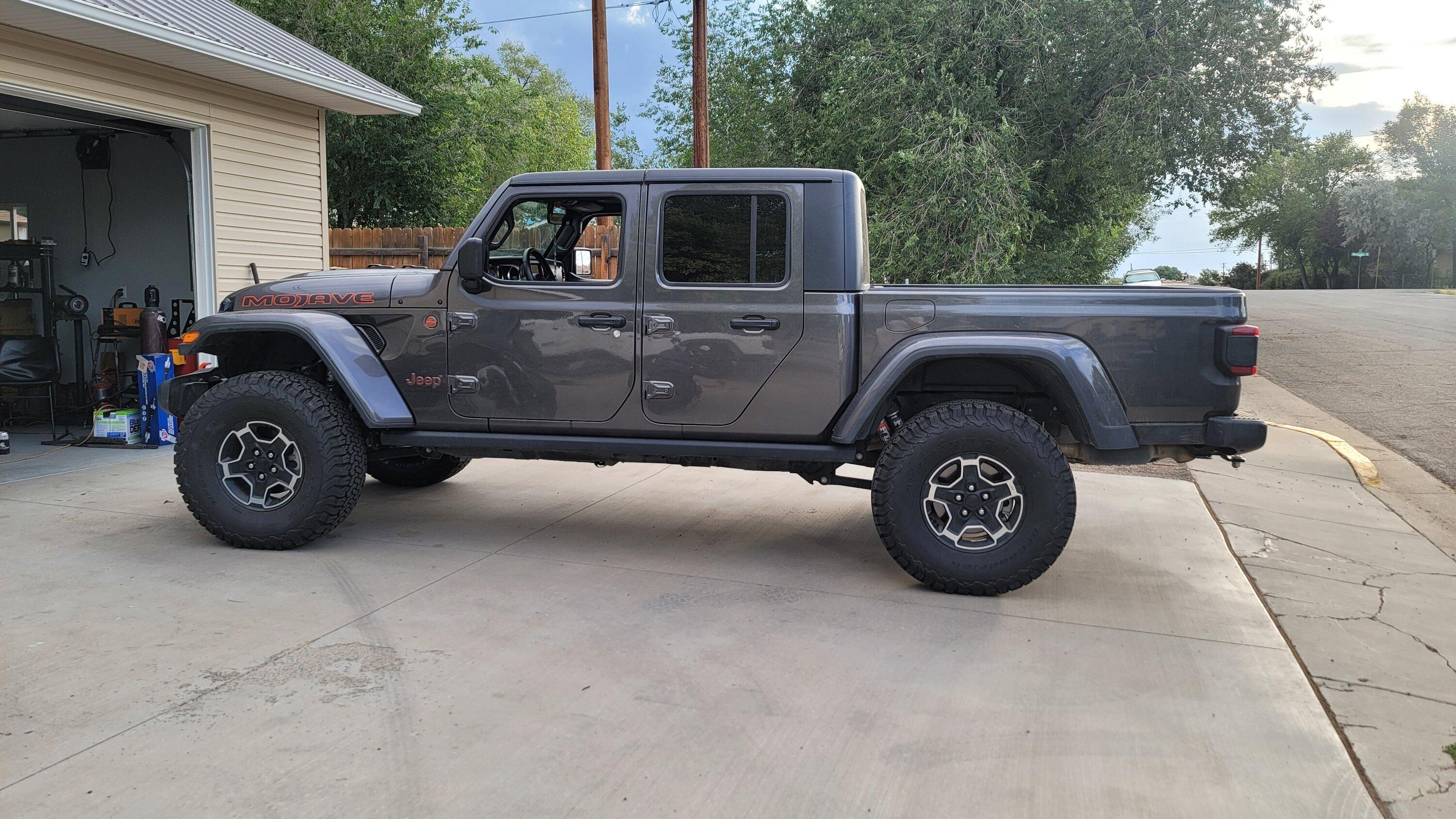

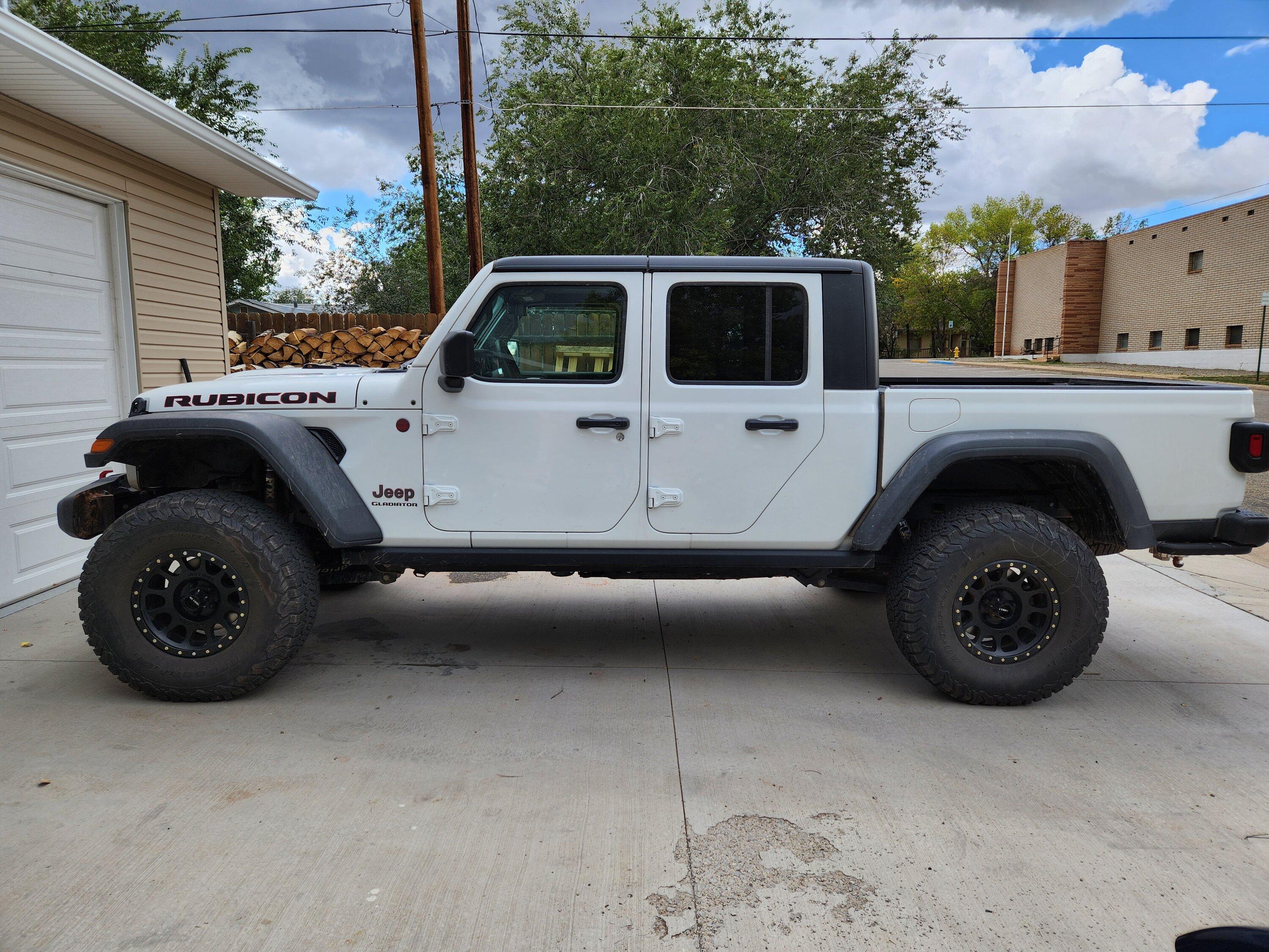

37s give a better proportion in my opinion. If you are just looking at aesthetics. My photos will really help with that.

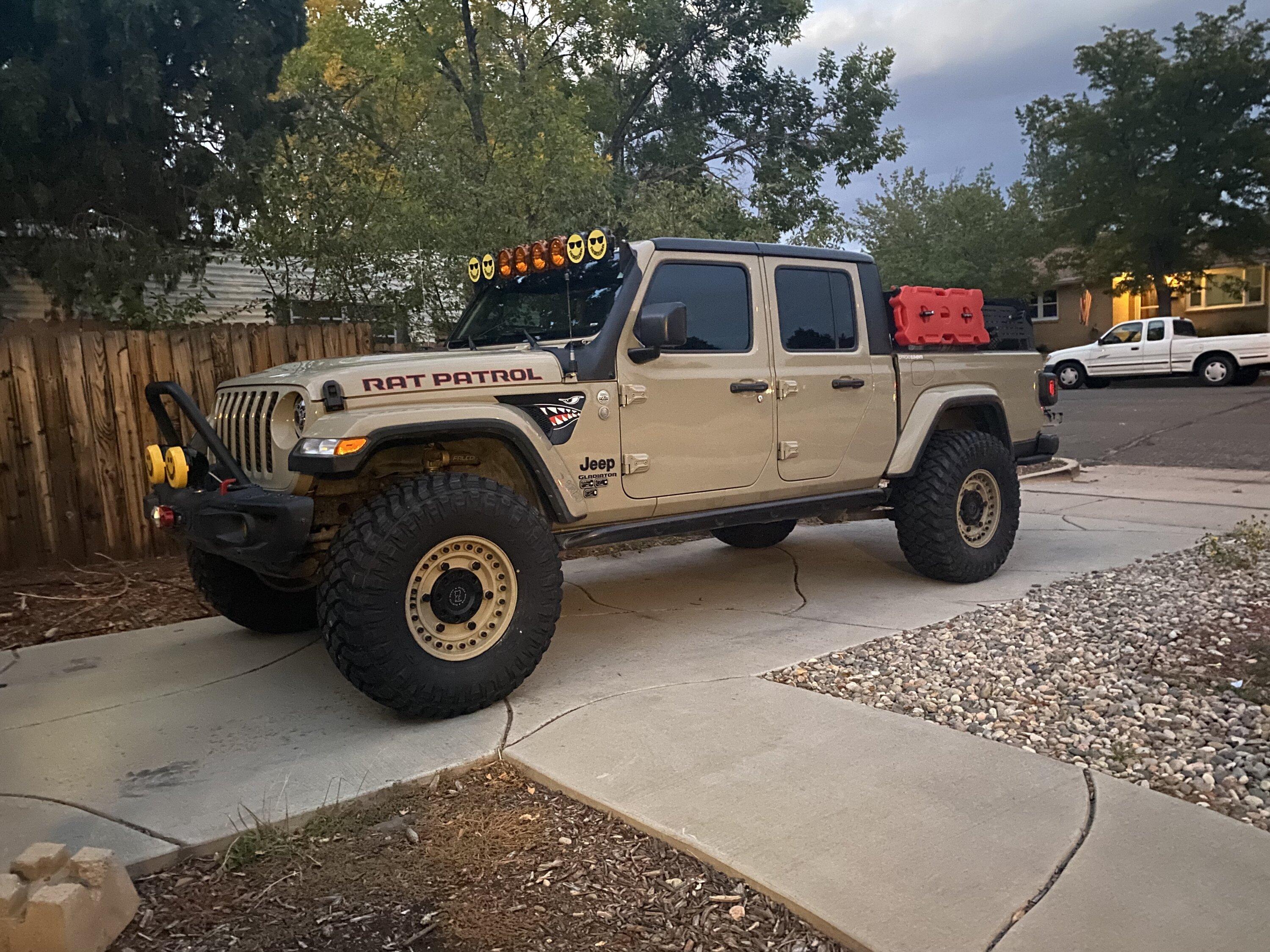

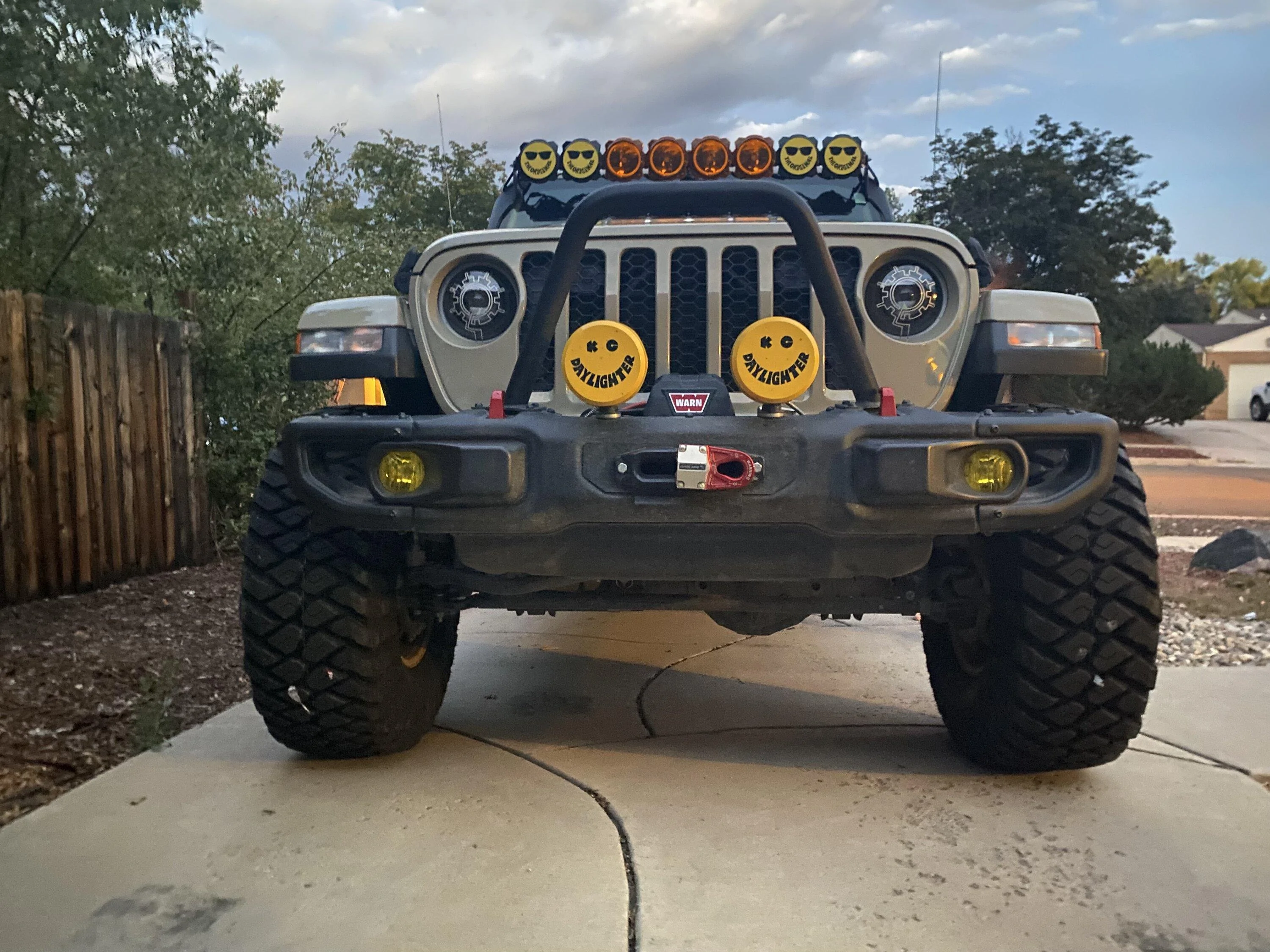

My 37s look smaller every day with my Clayton 2.5" diesel lift
Jeep Gladiator Why is picking a tire size so difficult?! 20221005_140404

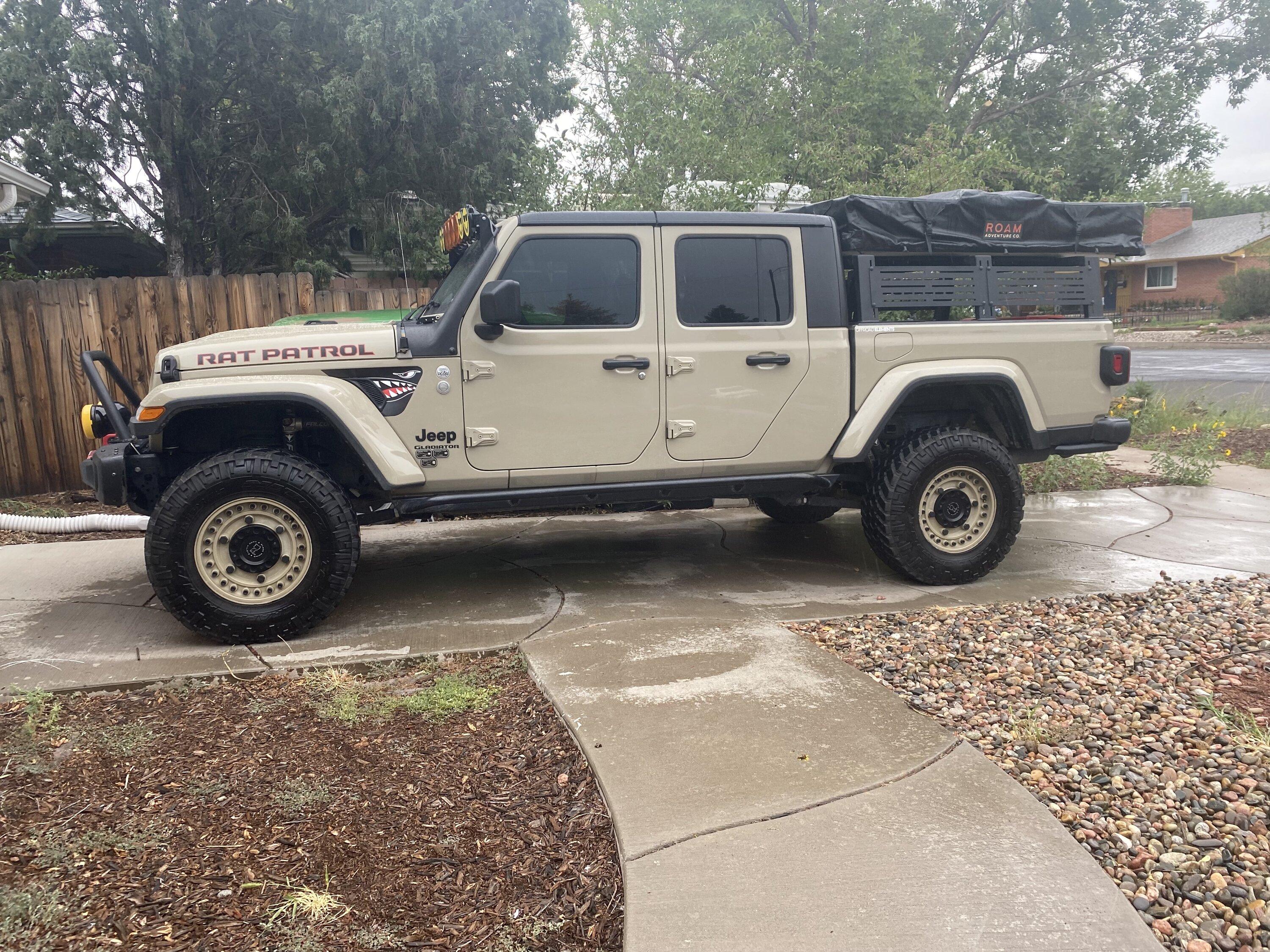

Same tires look better on the wife's Mojave with a 2" spacer lift. Her stock wheels work just fine but the Mojave wheels have less backspacing than stock Rubicon.
Jeep Gladiator Why is picking a tire size so difficult?! 20220724_192518
