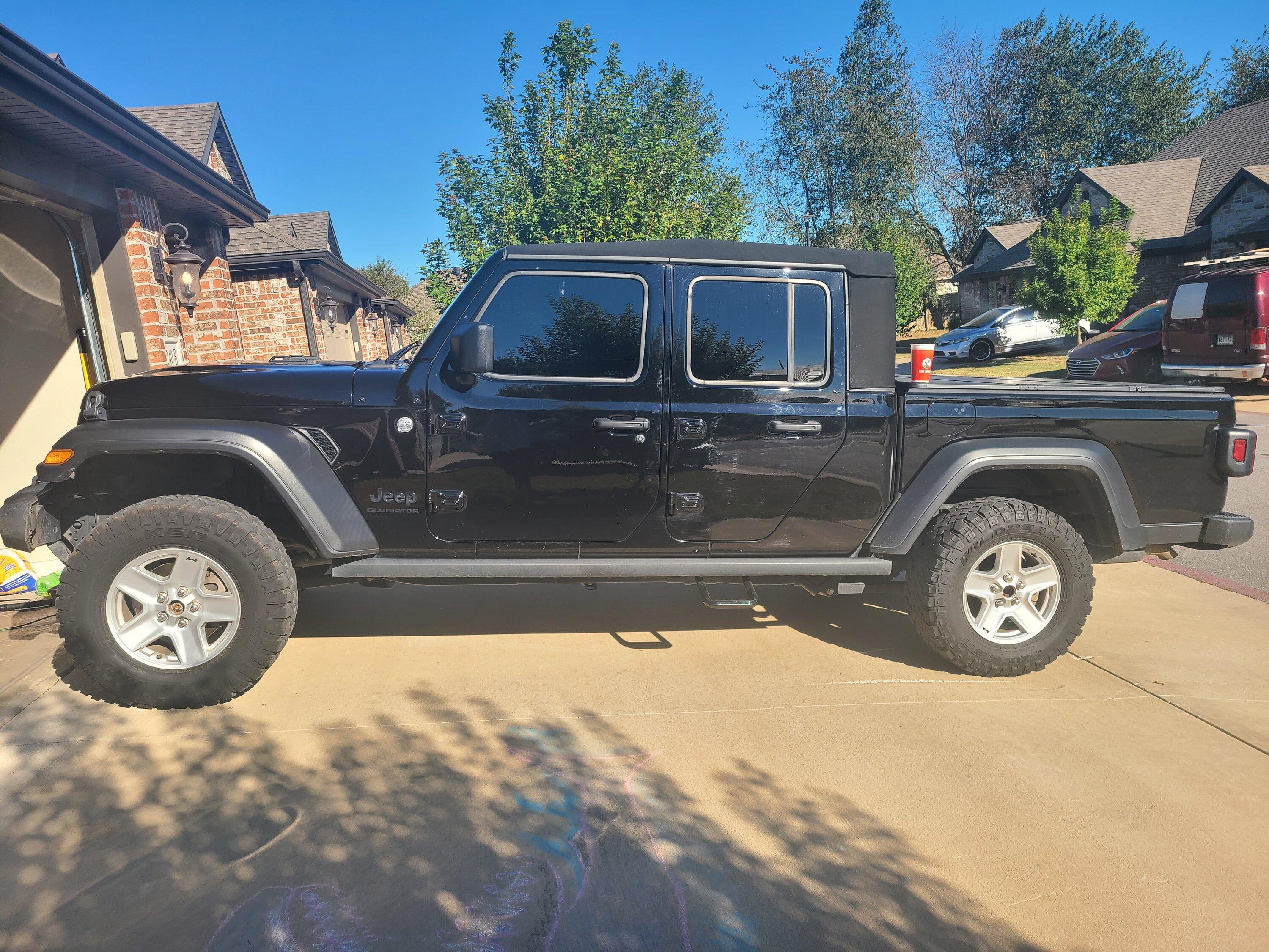

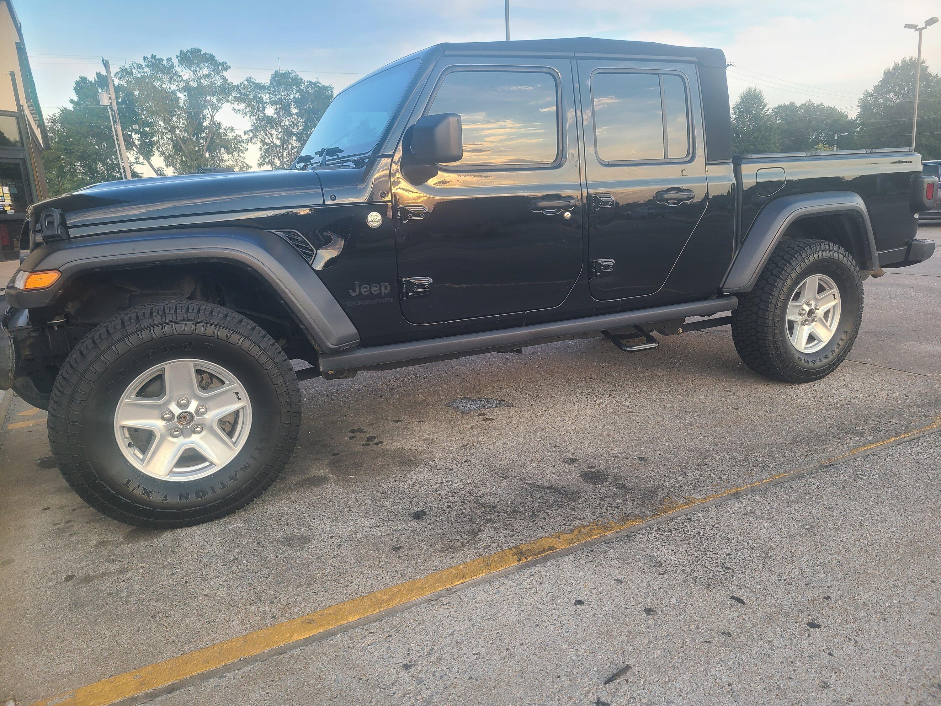

I just put 35s on my Sport S MT. Having a MT helps with gear selection. At 75 mph moderate hills (Ozark Mountains) I rarely use 6th gear, but I rarely used 6th with 33s. Top 33, bottom 35
