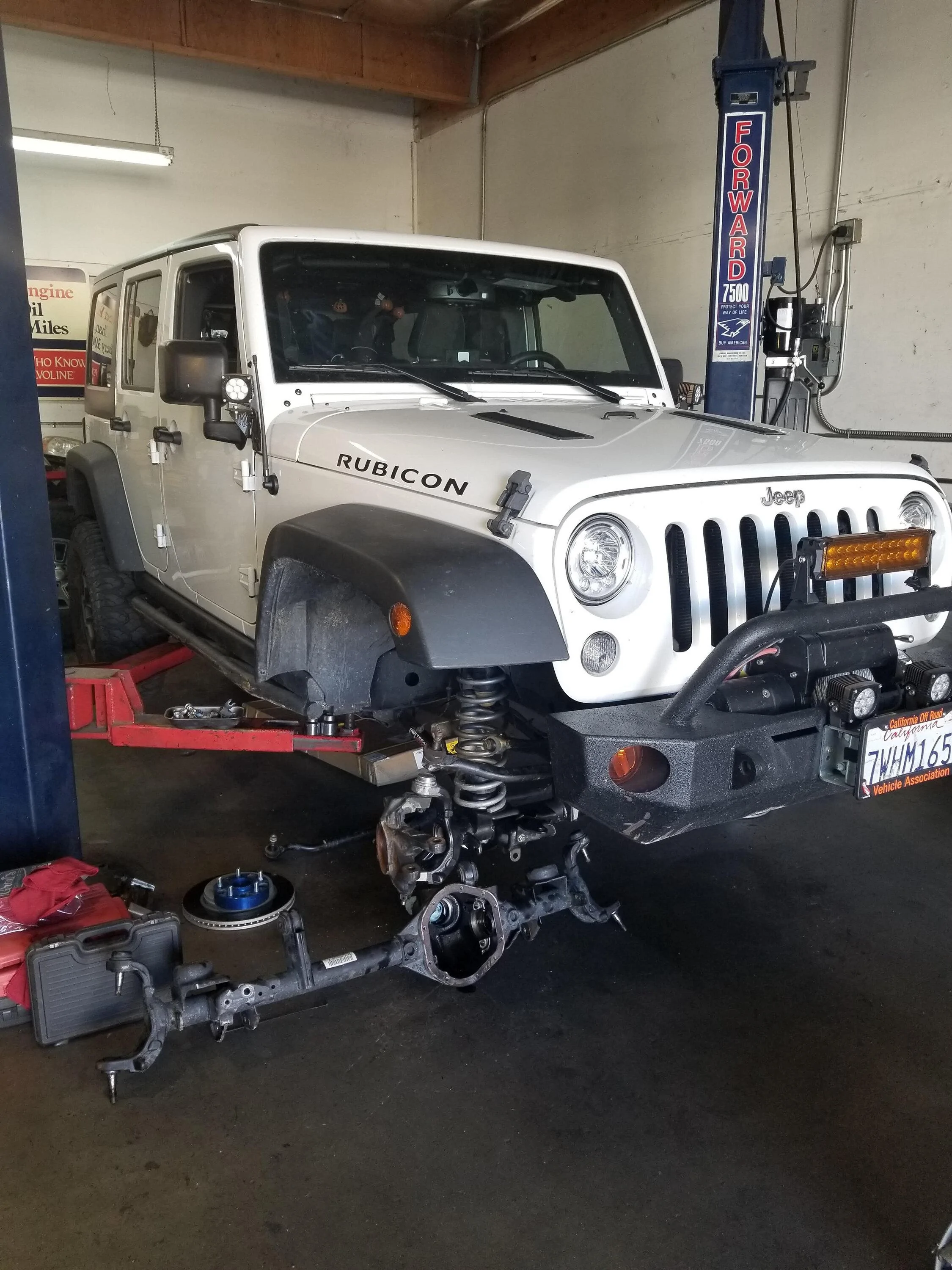

All I have is doing some of the hardest rock trails in the country, working in my family mechanic shop, building three of my own Jeeps, etc.
I'll be sure you remember your advice when I'm out there wheeling. ;)
Jeep Gladiator 5.13s or 5.38s with what tire size and why? unnamed
Bonus:

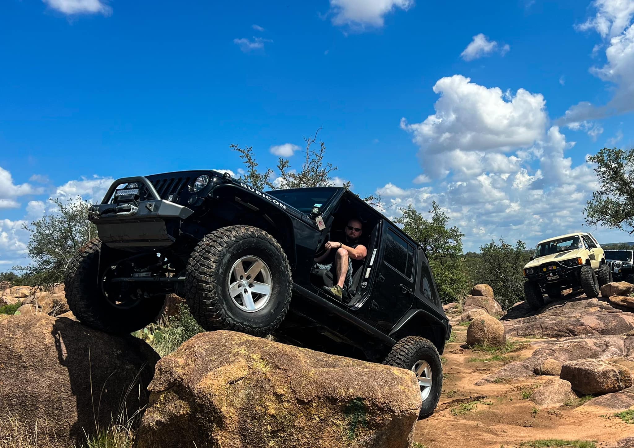

Me axle swapping my JKUR. On 4.10s!!
Jeep Gladiator 5.13s or 5.38s with what tire size and why? 1

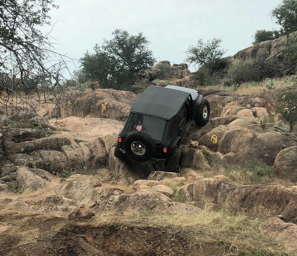

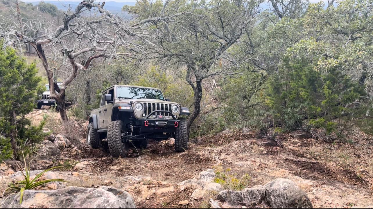

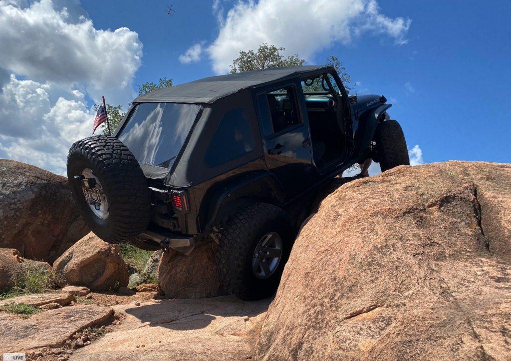

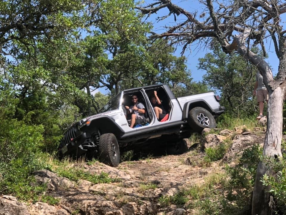

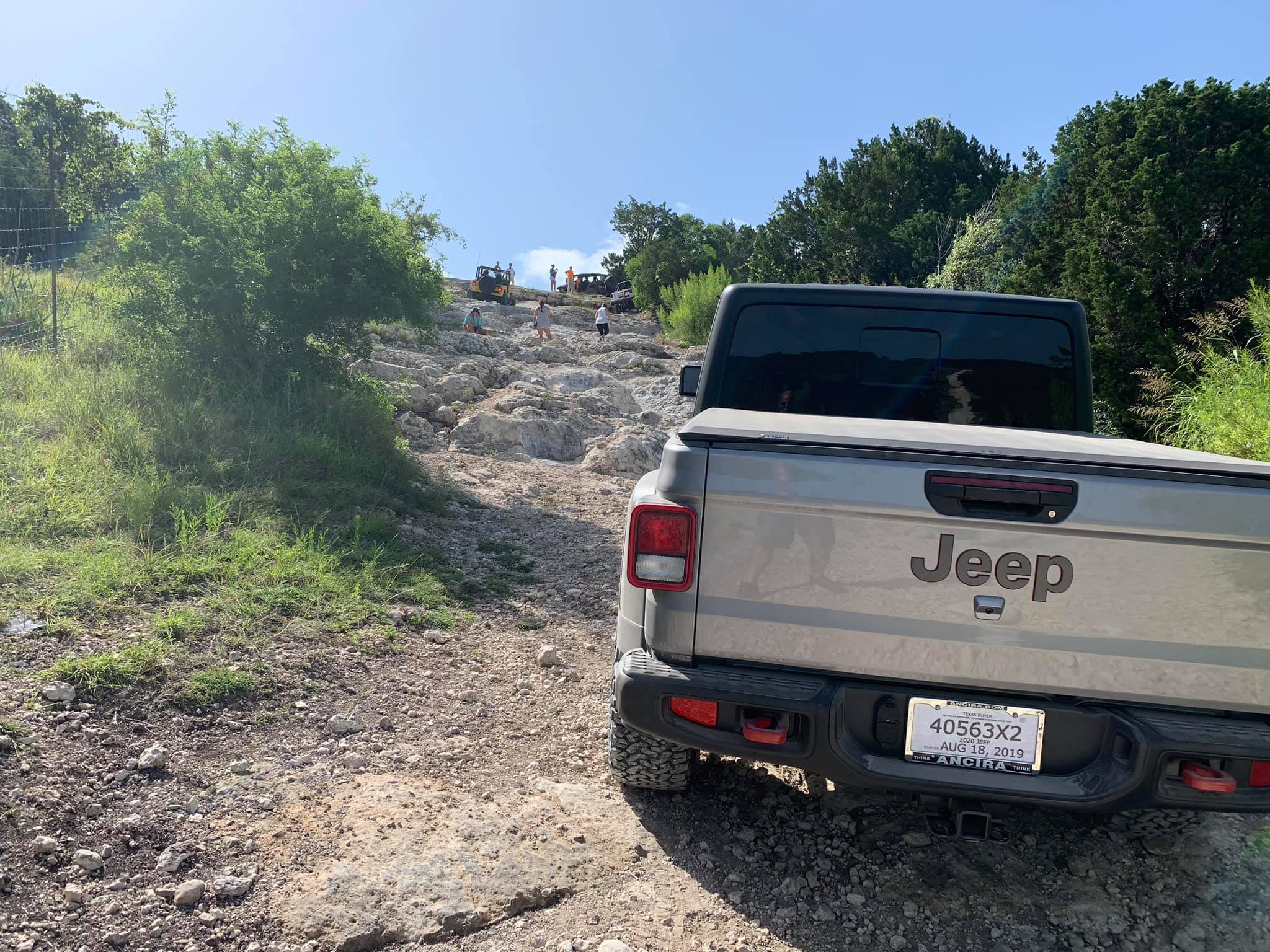

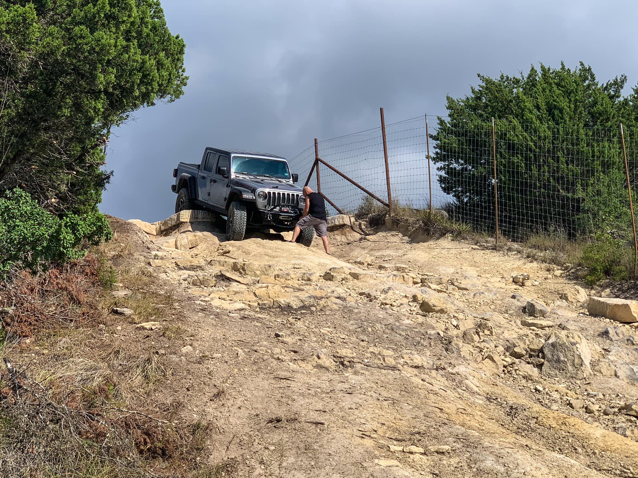

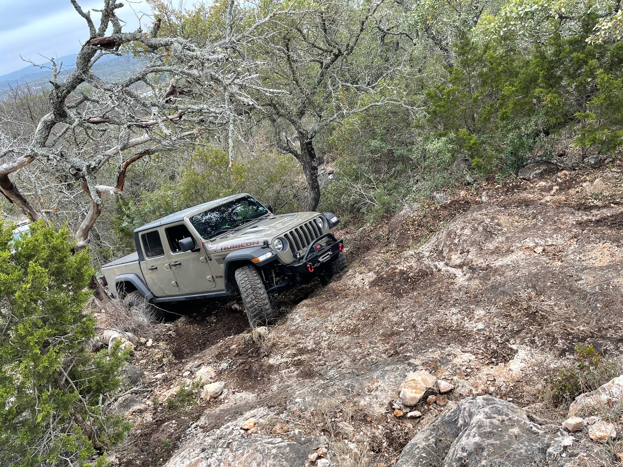

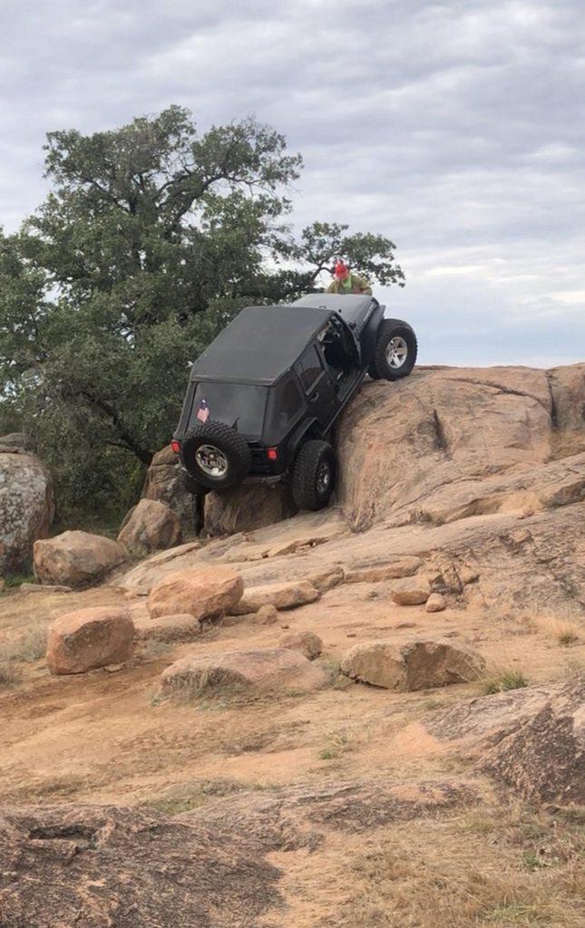

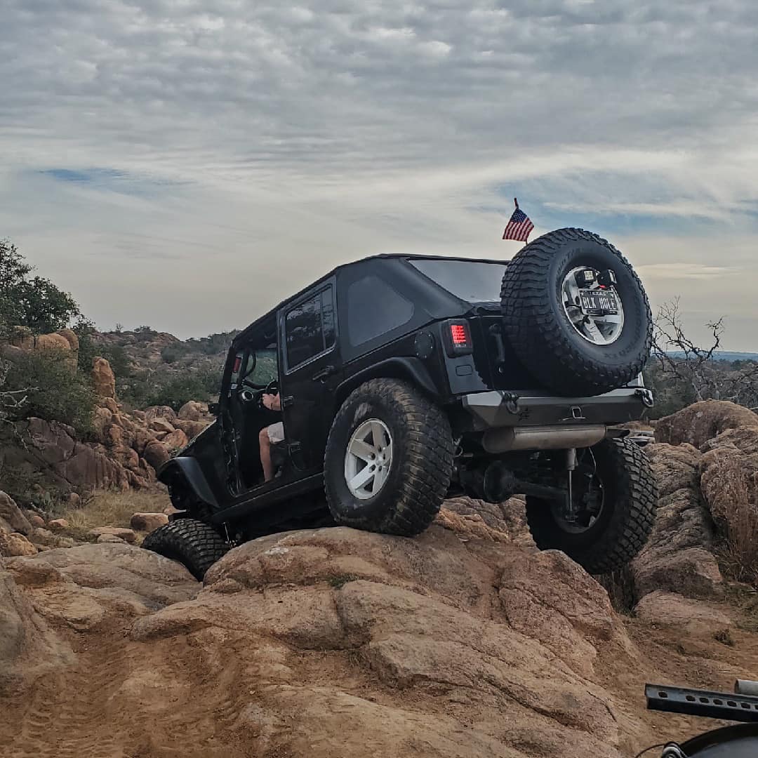

You're right...I should definitely get out and Jeep more around the country and try new terrains! Hahahaha. And most of these pics are quite recent (a couple were from this weekend)...I just didn't want to flood the thread with my pics. Your little rock mine field pics are cute and all...
I still own 2 of the 3.
And no my advice isn't to shut down activity if you haven't regeared. Altho my advice WOULD BE to add regearing into any tire change budget. Thats just proper modification form. You even said as much yourself to start this conversation. You're saying "its fine"...well yes...you CAN do it. But you really should regear. And you'll die alone on that hill arguing against it. Anyone with any real experience wouldn't agree with me.
