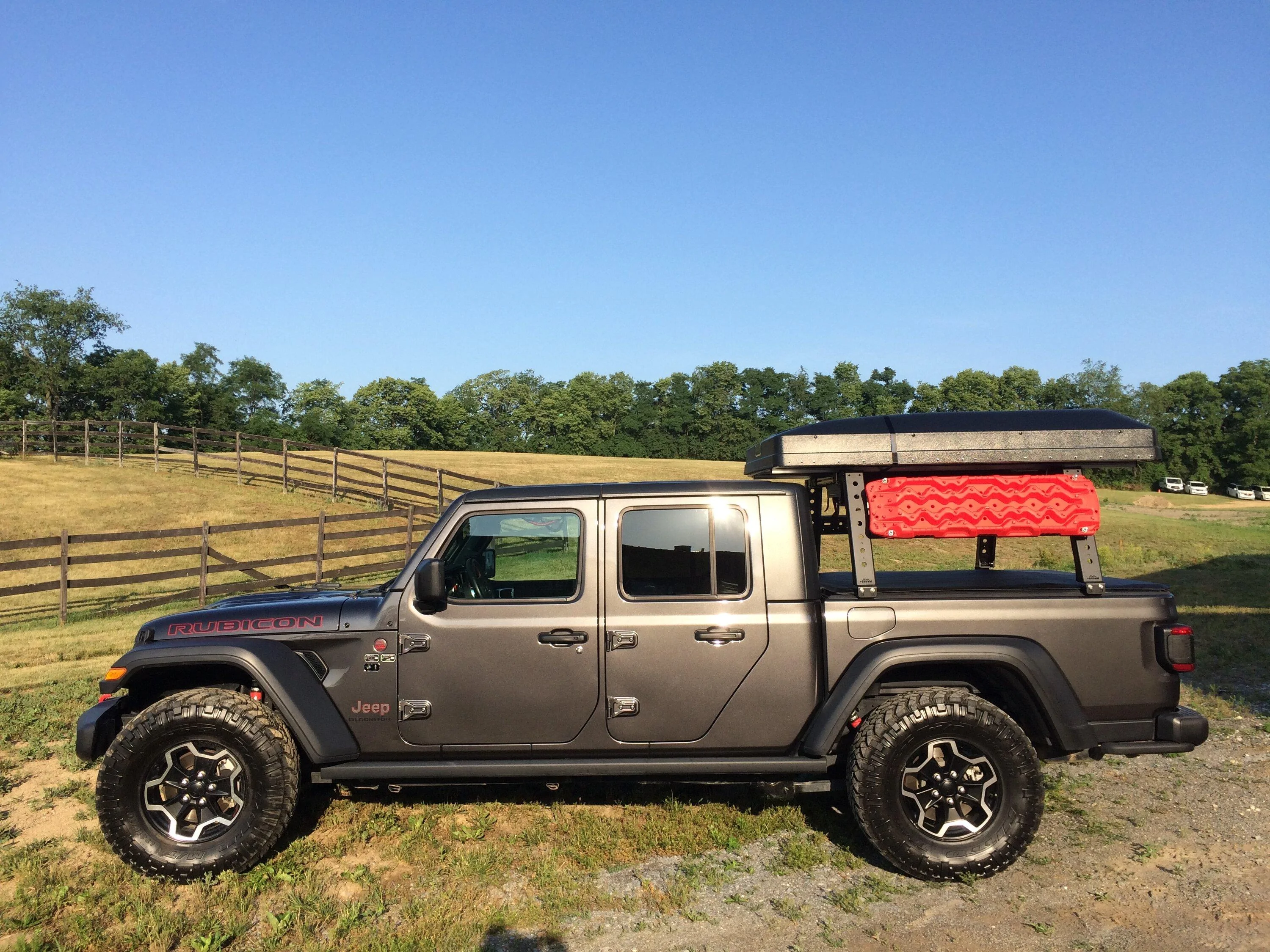

Stock JTR
Jeep Gladiator Why is picking a tire size so difficult?! A243FE9B-E7E9-4410-944F-1F88D62FCCFE
315/70/R17 Nitto Trail Grappler M/Ts
Jeep Gladiator Why is picking a tire size so difficult?! 7B286FEB-D2C4-4D8F-A9C5-5DF7ACAFDD32
Yokohama Geolander A/Ts, my highway tires. Theoretically both 35”tall About 1.5 mpg difference.
It sees some trails but is my work truck, DD, tow vehicle, family truckster. Don’t need a lift or 37s, I do need to be able to get in and out of the truck, so does my 5’2” wife.
Simply roll a set of tires next to it and see which aesthetics you like. Then consider tread carefully as well. My Yokohamas have all but paid for themselves in fuel savings……

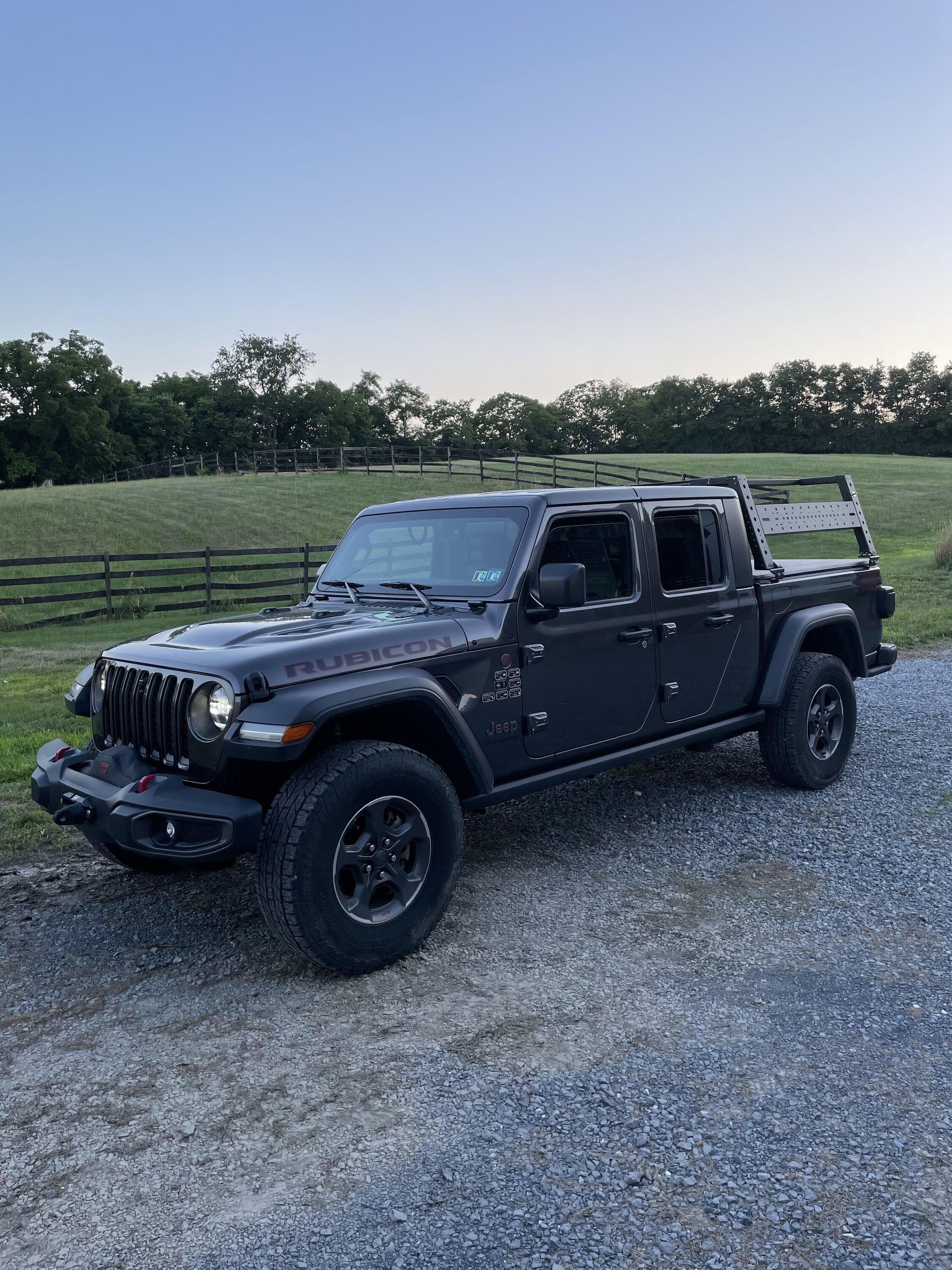

I vote jump to 37’s!
Just know that tires are the cheapest part of going to 37” tires. Anything larger than 37” tires and you can likely mall crawl for awhile. But if you wheel (and I’m not talking forest service roads) even with 37” tires you are going to wear down parts quicker than you would think. If you are not ok with replacing ball joints and other suspension/steering joints every??? 30k ish miles… go smaller… and if you are looking at bigger than 37/38’s get open a “axles account” and once you hit 20k ??? you will be set!

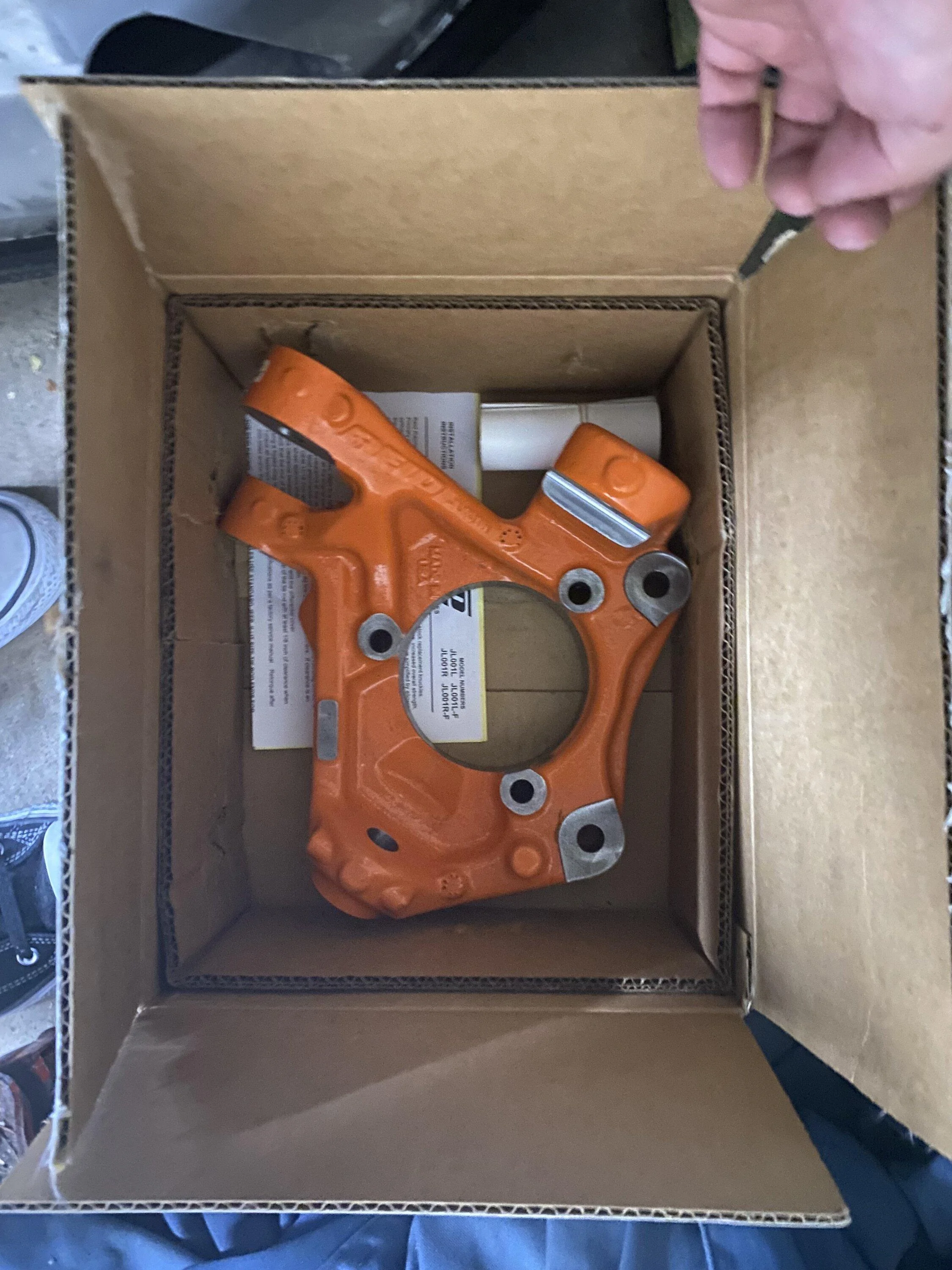

This is why I have HD ball joints and knuckles going in next week. RCV will be next. Then a 2.5 ton drag link....down the black hole I go.....

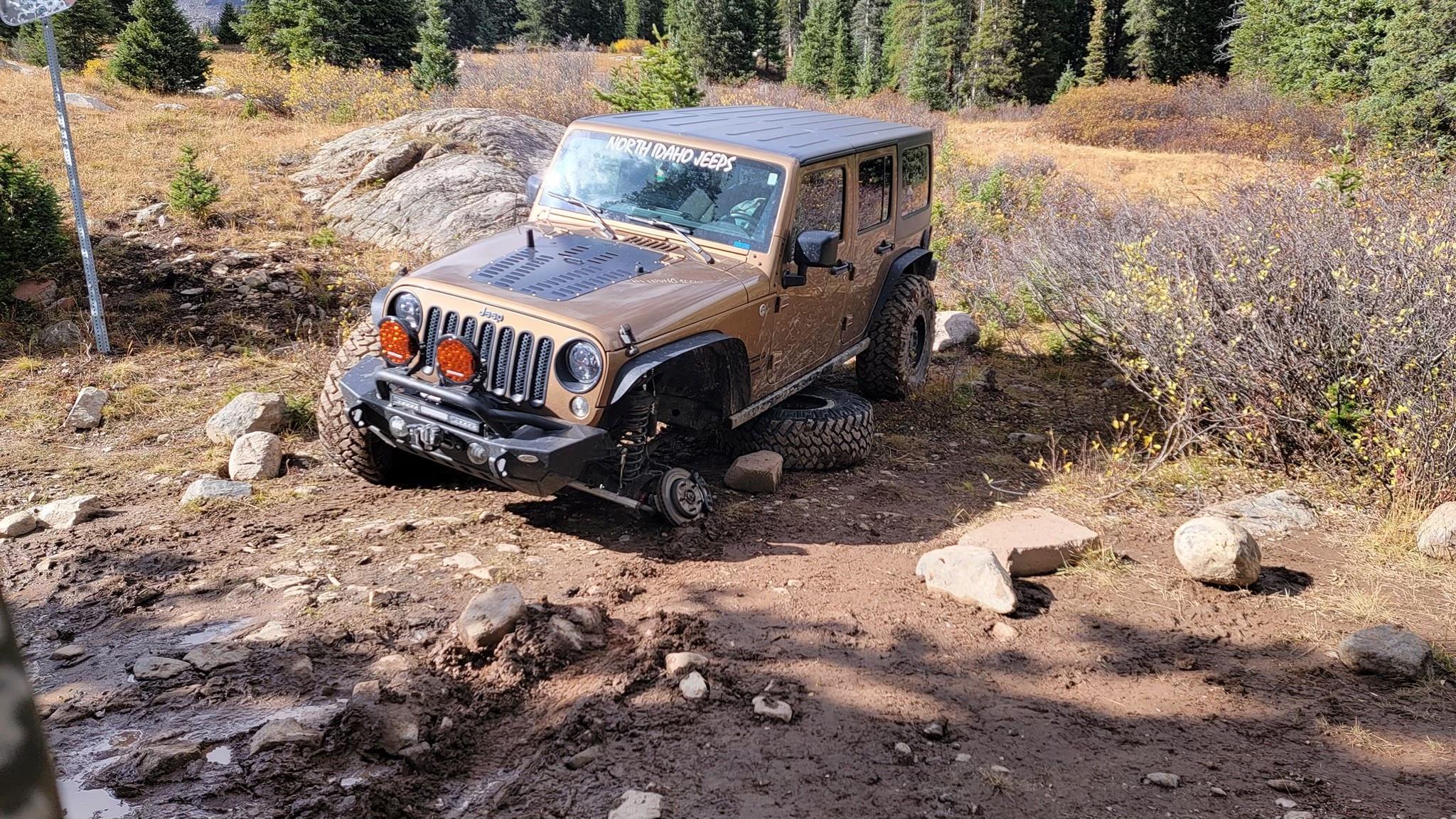

Wear and tear is real. Check the pic @Waggs took on Holy Cross.

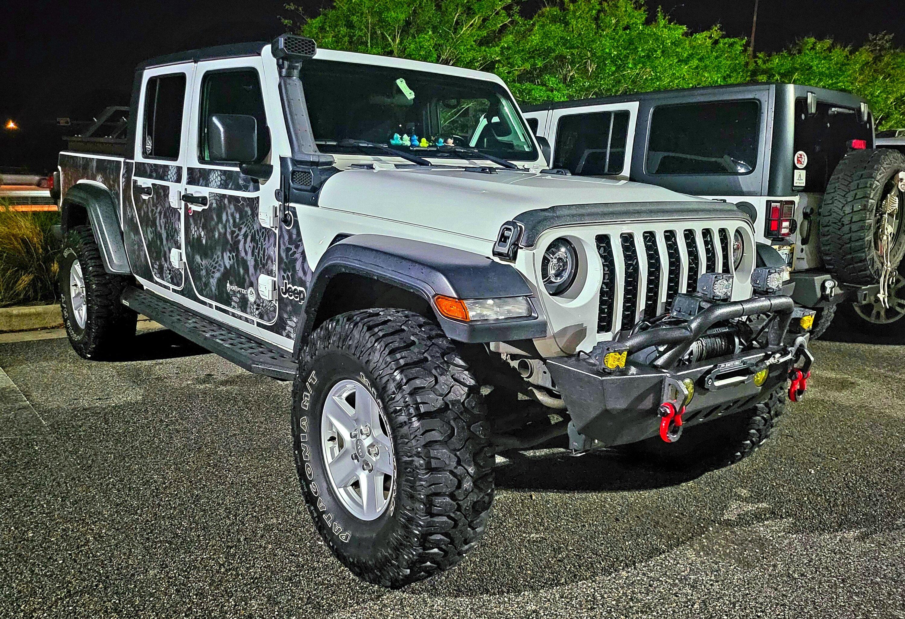

Jeep Gladiator Why is picking a tire size so difficult?! IMG_1625
Jeep Gladiator Why is picking a tire size so difficult?! 123_1
