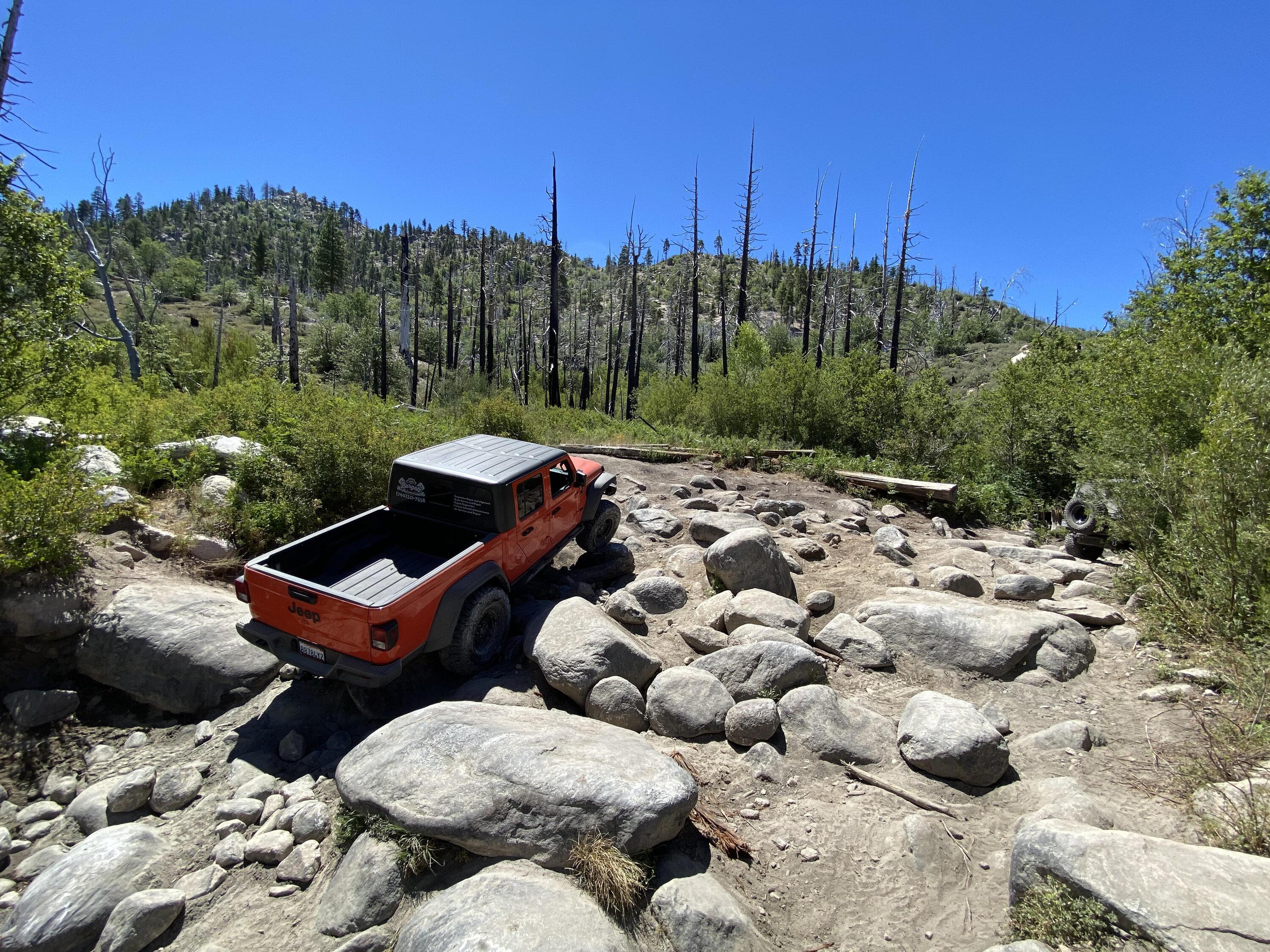

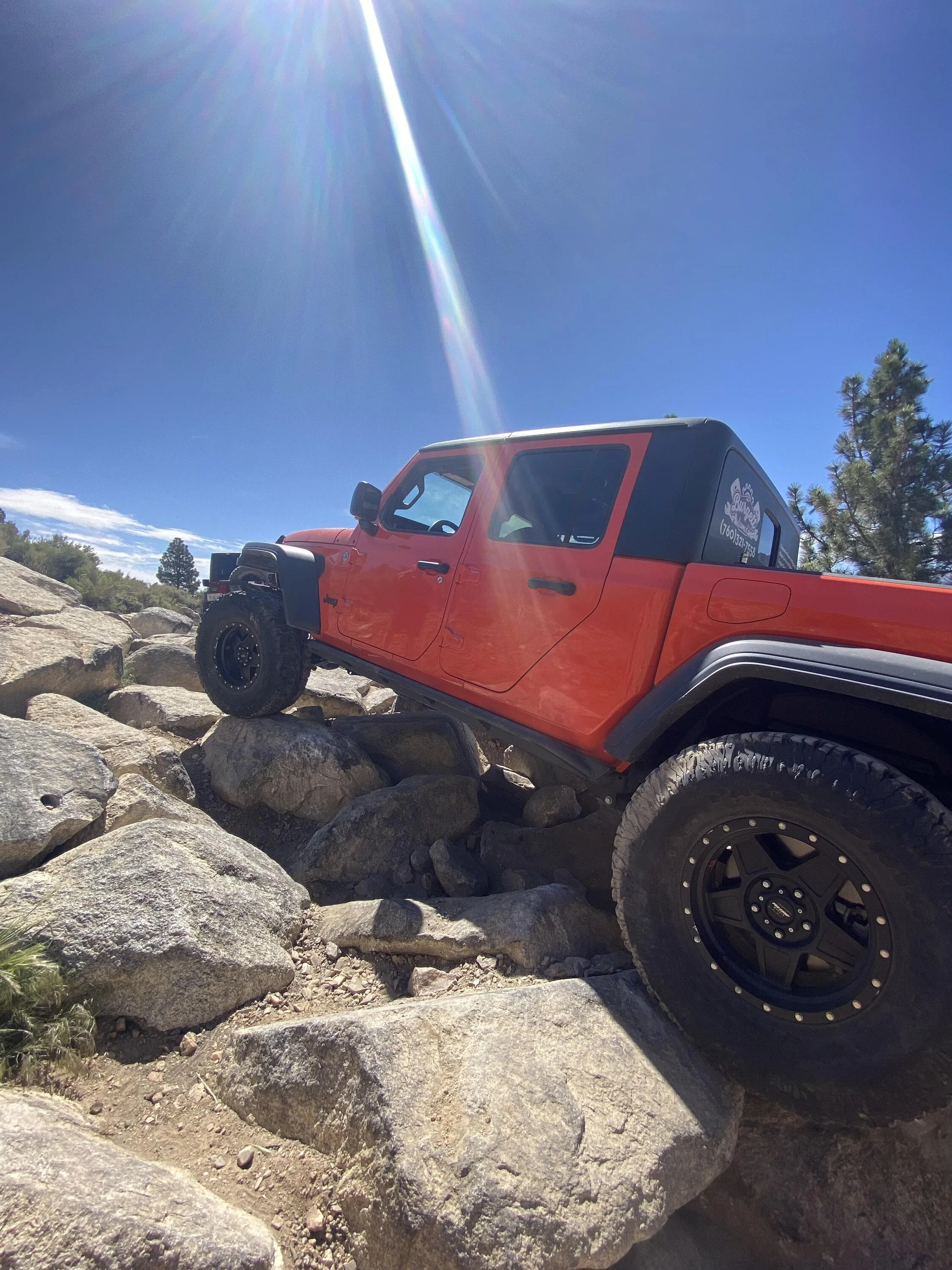

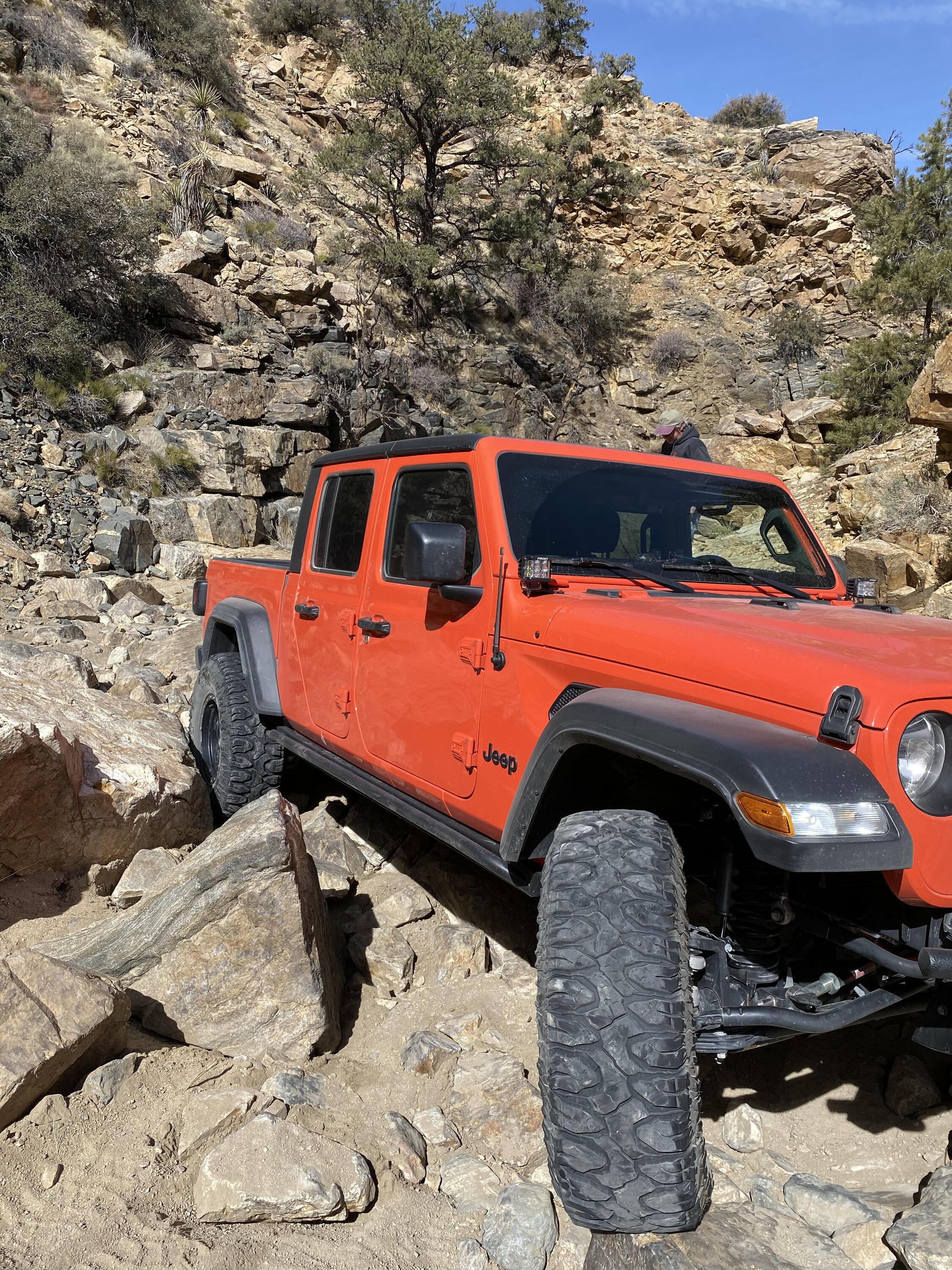

The jump from 4.10 to 4.88 has not resulted in even a tenth of an MPG increase, anecdotally. I document my results in my gear install thread. The 8 speed transmission in these are incredibly good at compensating. In a pure vacuum of "which would I choose from the factory", I'd pick 4.88 for a 37 for most needs, 5.13 for heavily loaded. But for those debating whether a regear is going to blow your minds, it simply doesn't. I would not have the same opinion in an older JK.
I did all of the below on a 4.10, with absolute ease:

Yeah I can see that you used them like that. That went without saying.
But you’re wrong. It’s not a matter of can you do it, it’s a matter of should you. And you shouldn’t. You do you tho - not my Jeep. I just care enough to make sure other people don’t follow that advice.
