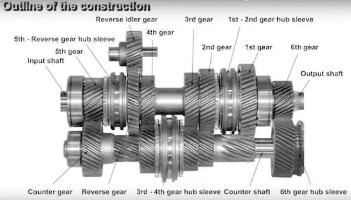

Clutch disc moment of inertia dominates synchro loads but they also have to sync the entire counter shaft and all gears meshed with it. To make it even worse 1/2 syncro torque is reduced by the gear ratios. This is why gear lightening and small clutch discs help so much.
seven30
Tom
Apr 12, 2021
681
554
central texas/ south colorado
2021 JTM 6spd, 2001 Cherokee, 1992 Comanche
Programer
Not sure what transmission this is but this layout is a lot better than typical ones with all synchros on the output shaft. Note the 3/4 and 6 clusters are decoupled from counter shaft reducing the inertia 1/2 synchros have to handle. 5th does not contribute since is straight through.

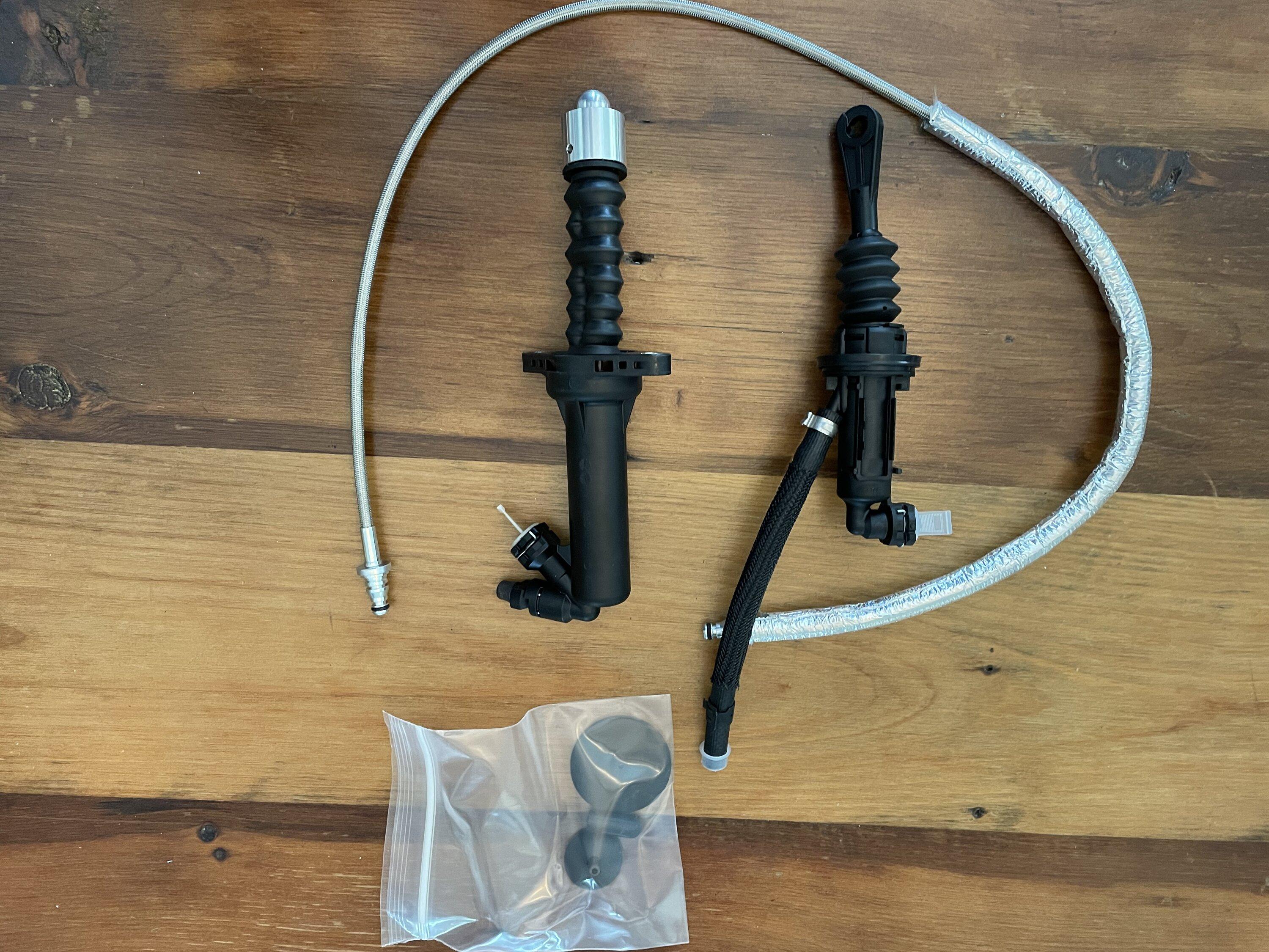

I just got notification the Centerforce clutch that i ordered back in Oct2021 has a ship date of 30 Aug 2022 with arrival on 2 Sept 22.
Nice! You are gonna love it! I just got the upgraded hydraulics last month. Haven’t had any time to install. Are the hydraulics coming with your kit? My gut tells me factory Hydraulics are part of the issue that caused a complete redesign.

yes the new hydraulics are with the kit. in conversation with Centerforce, we have been in discussion about the hydraulics for sometime and it was interesting in that i had come up with an idea the same time they did about the hydraulics being most of the problem. my intent is to do the install mid sept because i have to rebuild the front end on my mother's mini van because the wheel bearing are going bad. so i am going to replace struts, bearings, cushions, ball joints and a few other things.
