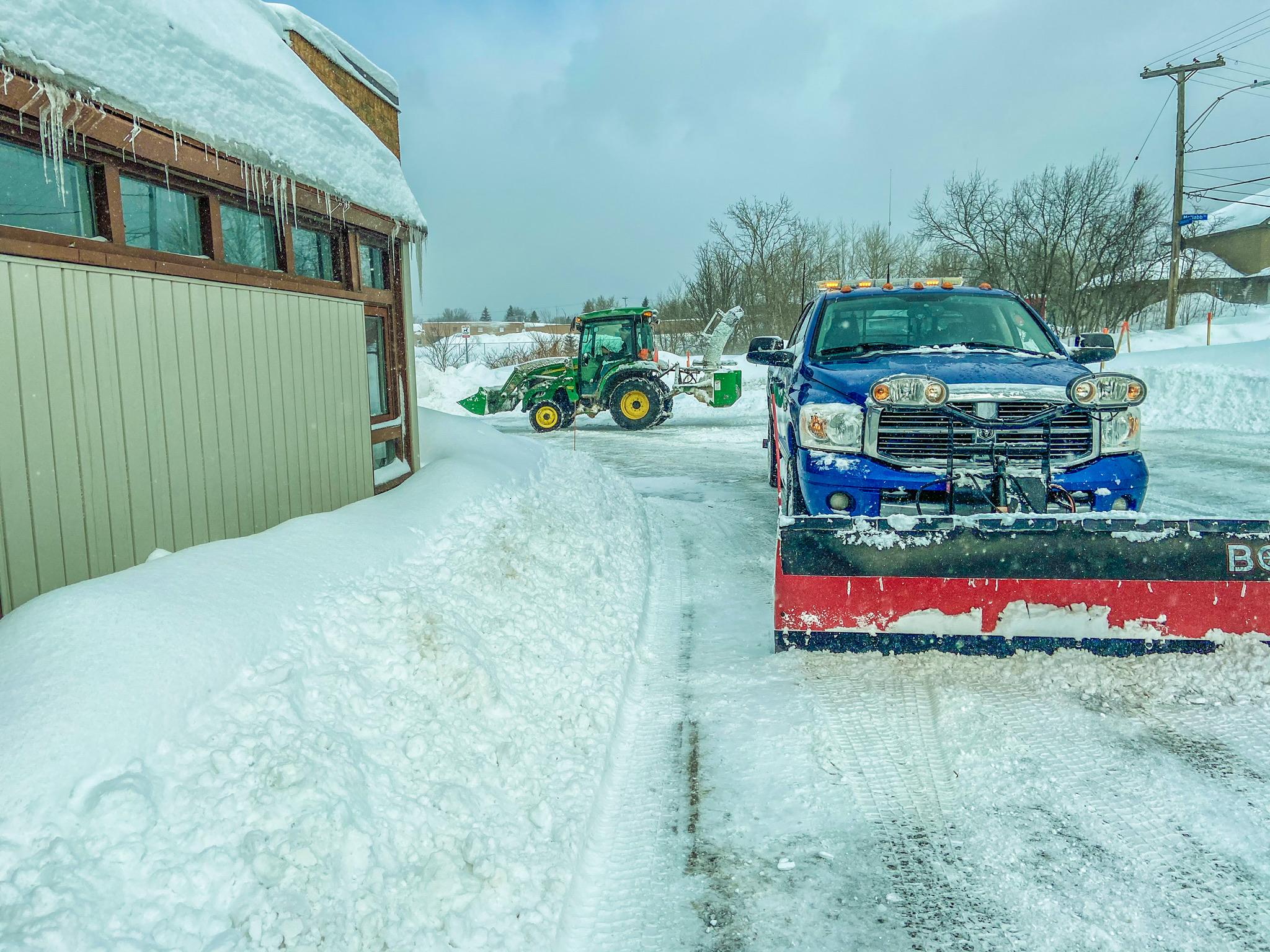

Our 08 ram 3500 plow truck grenaded it’s flywheel one morning. Thankfully it was in the driveway. Now runs a center force for the last few years, works extremely well but holy it’s hard on my bad knee (torn ACL)
