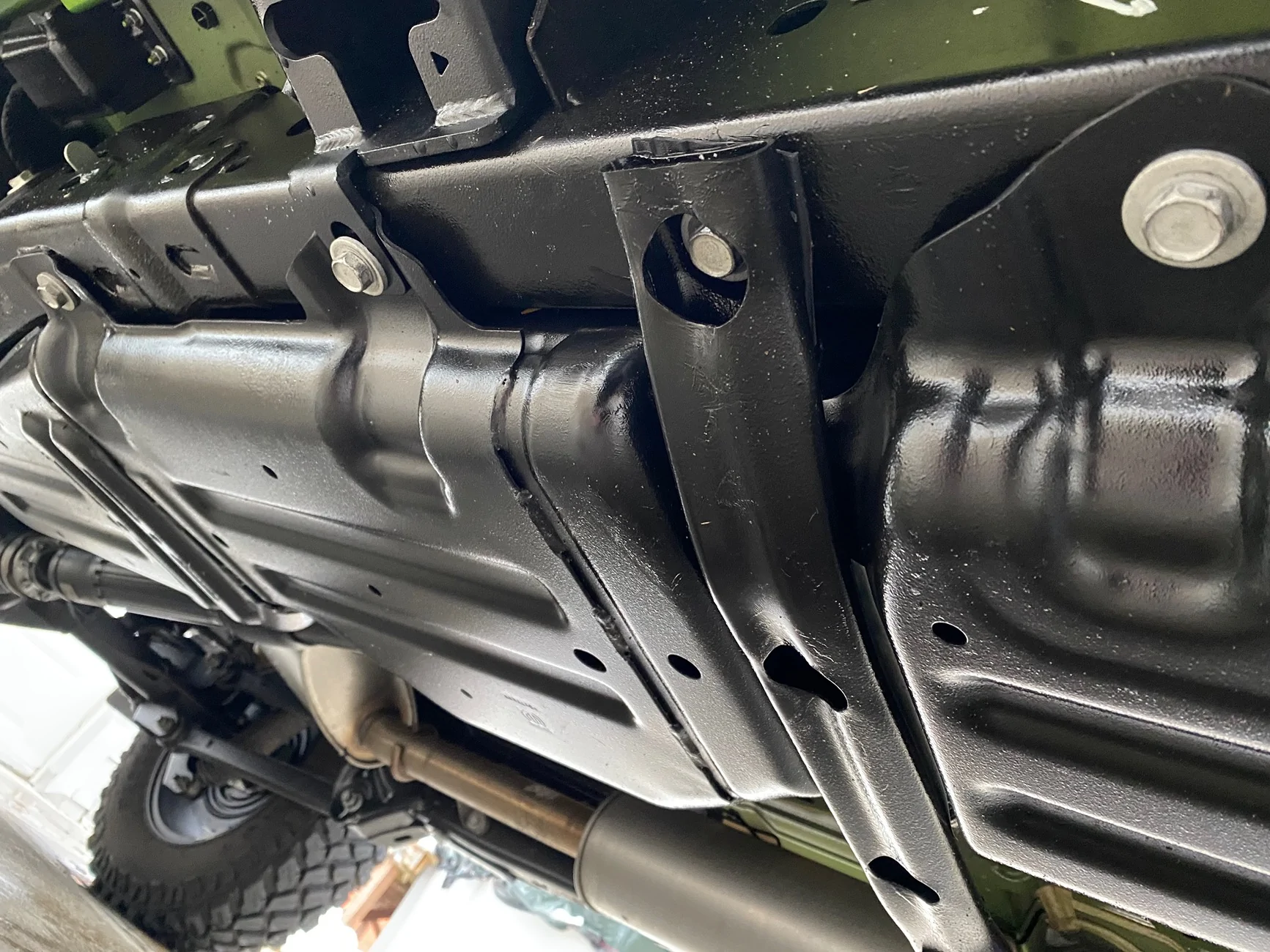

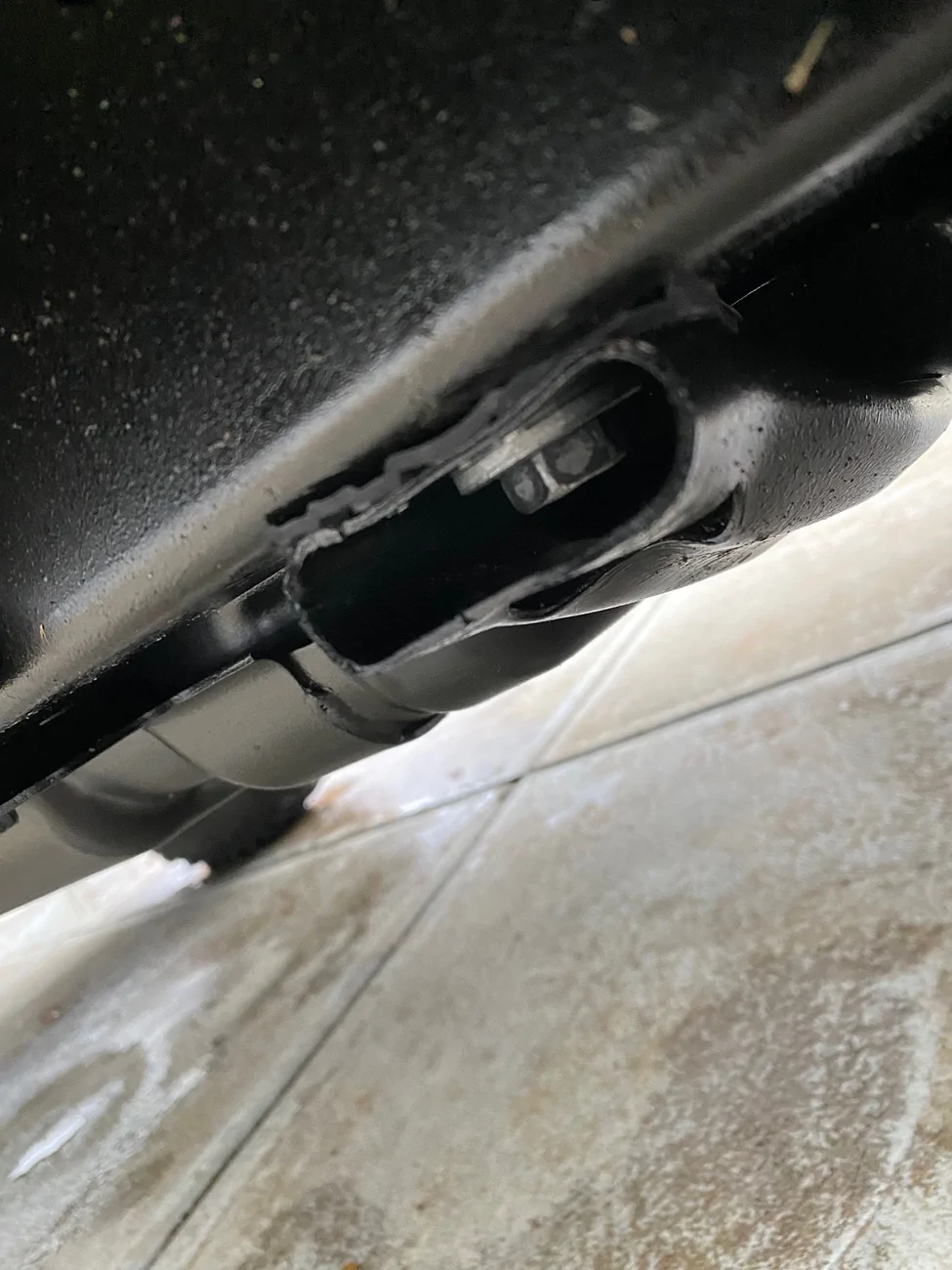

I encourage everyone with this noise to try this as I believe I already posted it. 3 different gladiators and I narrowed it down to this . The transfer case skid plate bar that comes across to the passenger side, there is a stud on the gas tank skid that this bar goes over. It has a small nut tighten that up, then cut a small piece of rubber shim (I used a spare cheap floor mat) and put between the skid bar and the frame on passenger side. Or if you want just remove transfer case skid and test drive. See pictures

Shimmed mine. Took test drive. Didn't hear any popping. Sounding good so far. Thanks.
Fingers crossed good to hear it
