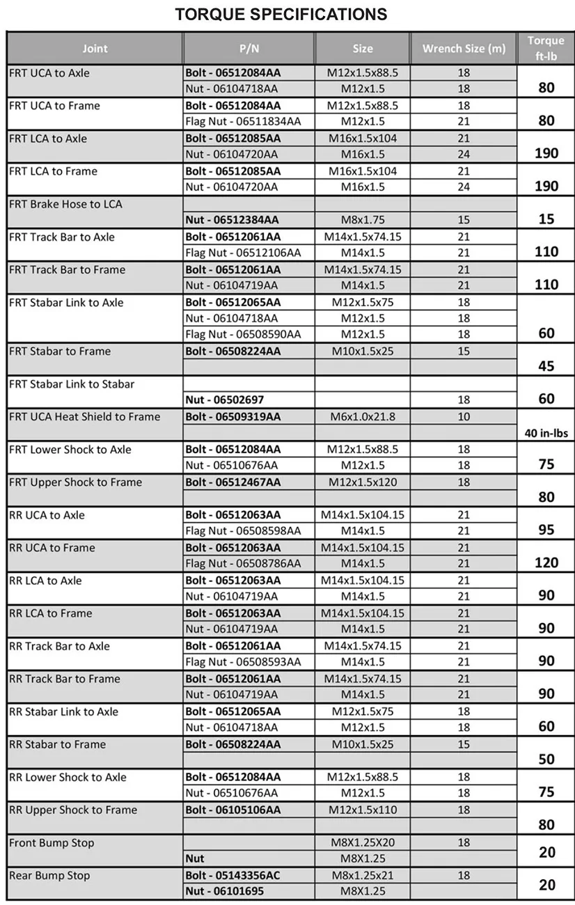

Rear track bar bushings , rear sway bar endlinks.

Thanks for torque chart. I will check track bar, rear sway bar disconnect but thanks
