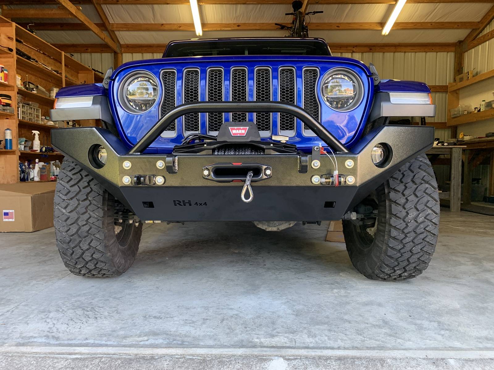

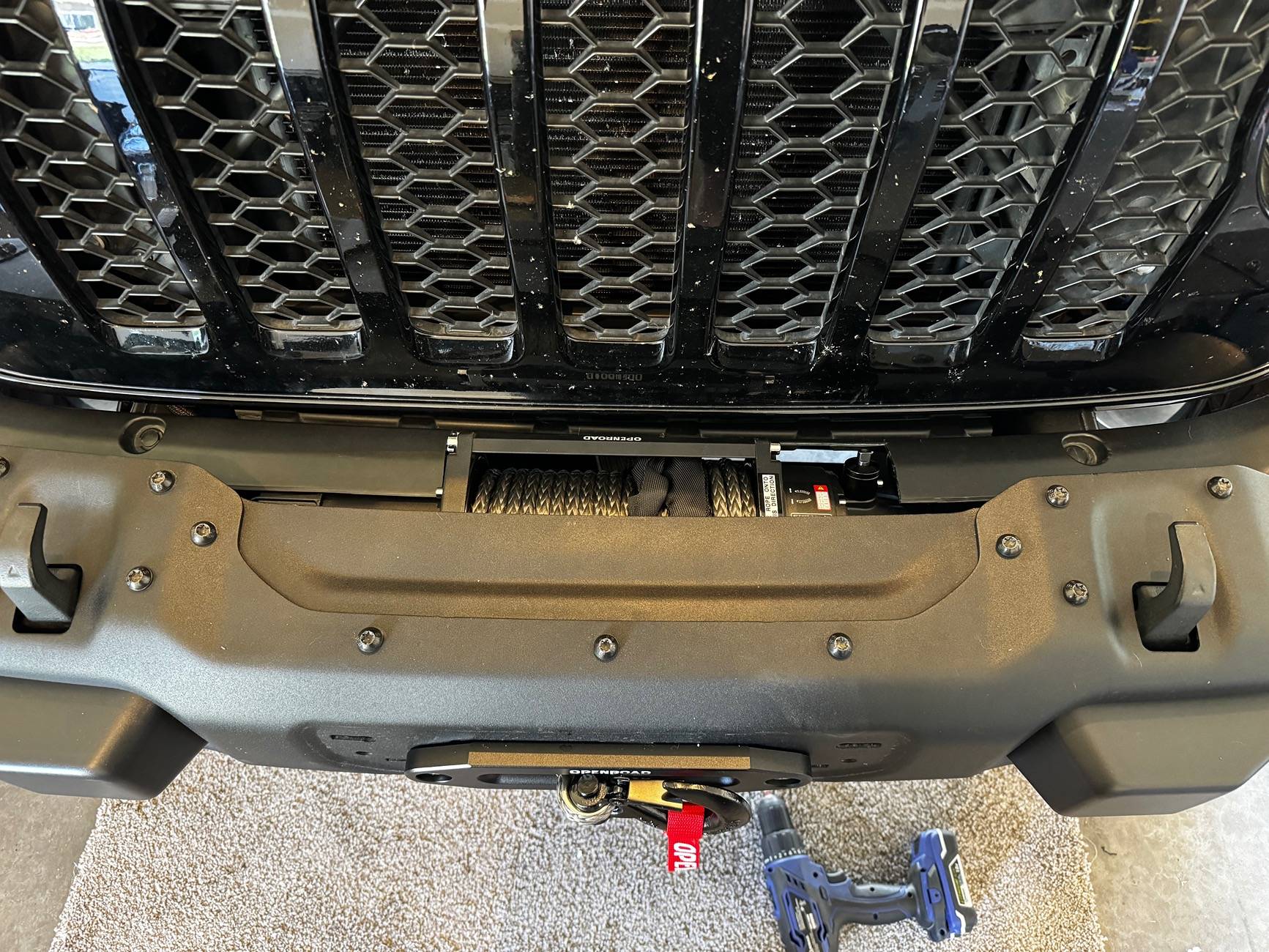

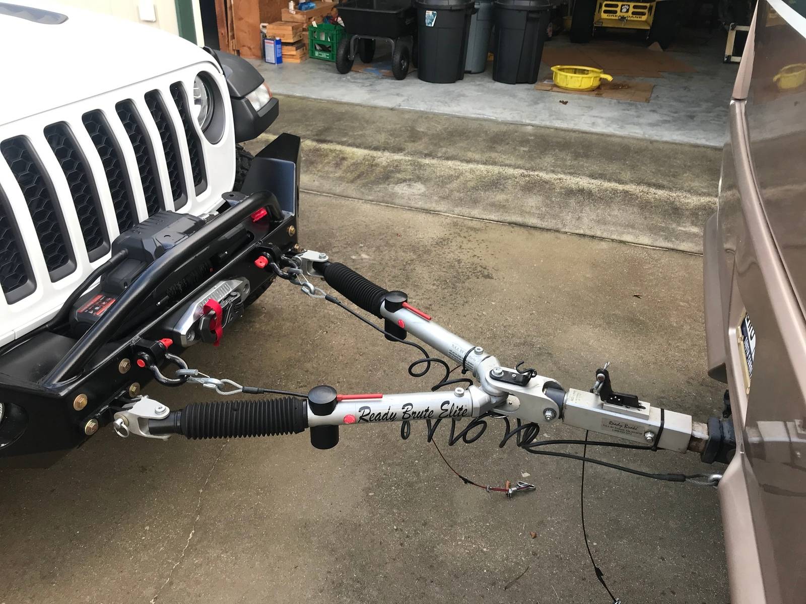

I have a Sport S with the plastic bumper and chose to go with a Rock Hard winch plate. I already had a Smittybuilt 10,000 lb winch From my prior JK. I also tow behind my motor home and had to add a base plate. Installing the winch plate on a winch ready bumper should be easy…
It’s a one beer project……
What is the winch plate attached to?

It attaches directly to the frame using pre drilled holes. They make one for a plastic bumper and a separate one for a steel bumper. No change in temperature since I put it on about 4500 miles ago. I’ve had the same setup on my last 2 jeeps without any issues.
You can look up your specific winch plate application at: https:/www.rockhard4x4.com and open their installation instructions to see your application.

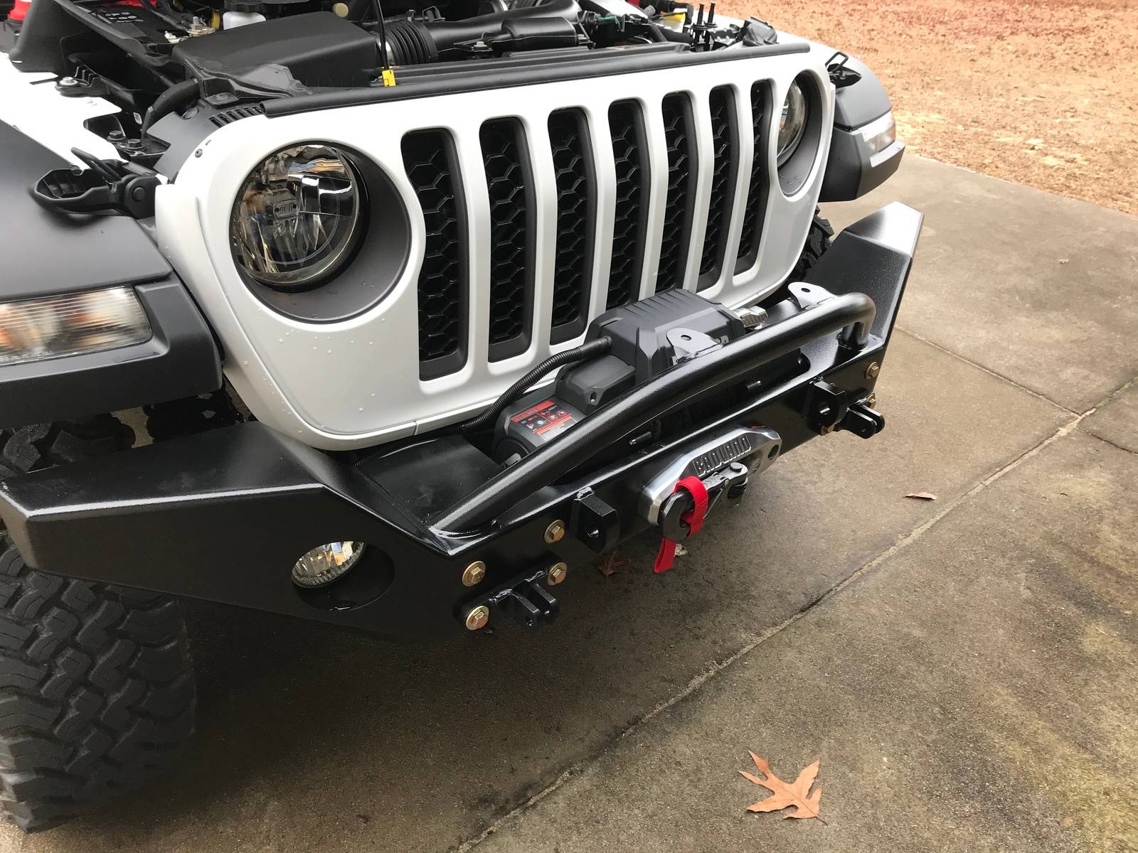

I'm partial to Rockhard Bumpers because I toe my Jeeps and Rockhard also sells tow brackets. They are pricy, buy they have a lot of choices (models plus the choice of aluminum or steel). I use the Patriot full width steel bumper on both my JT and my JL (same bumper). The bumper comes with a winch plate and the bottom of the bumper extends to replace the factory skid plate. Regarding winches, I have a Harbor Freight Badlands Apex 12,000 on the JT, a Warn VR EVO 10S on the JL. I bought both on sale and the cost was nearly the same. I bought the Warn for the JL because it has a smaller footprint. Both winches have had light use and preformed as expected.

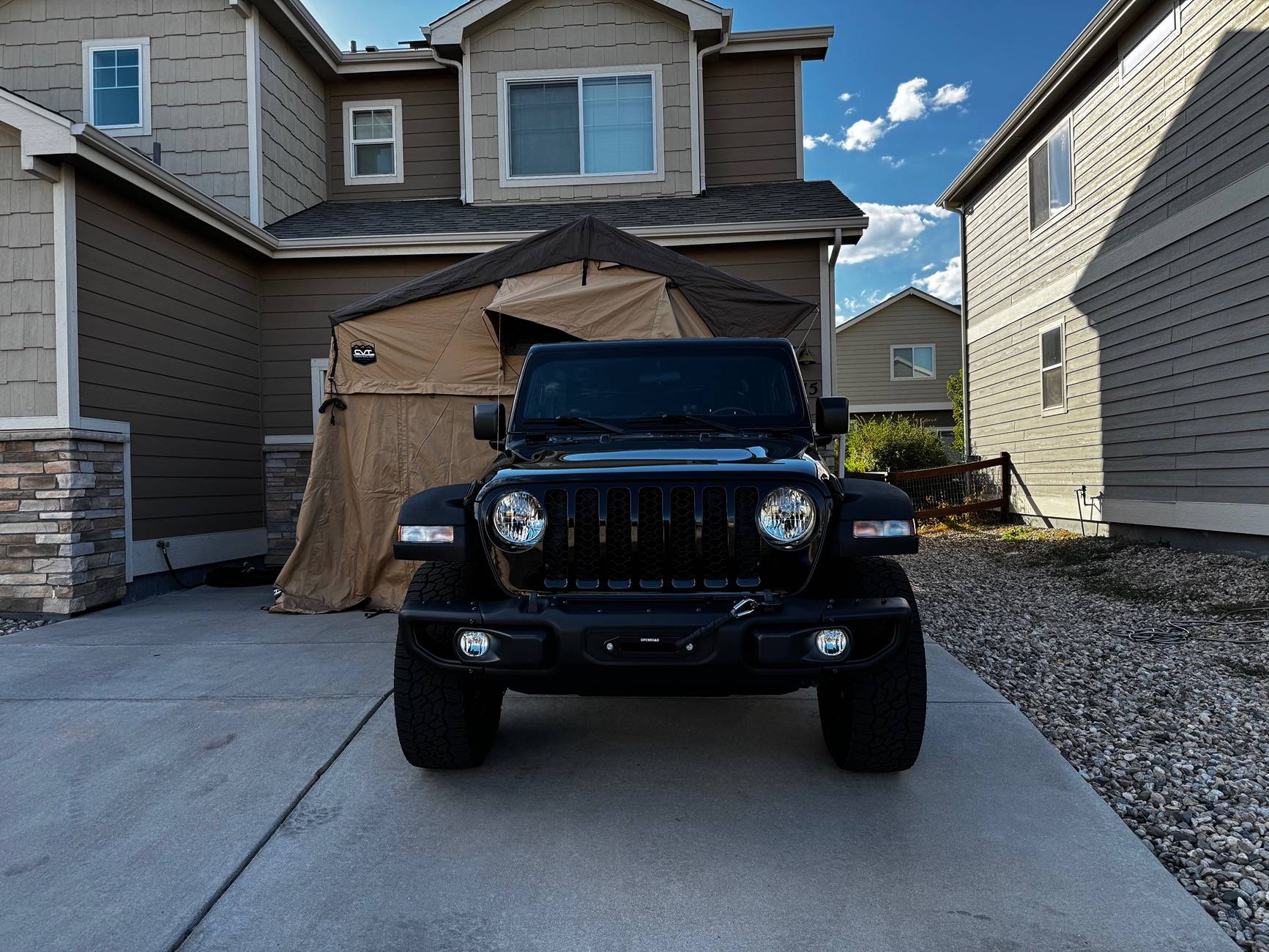

I did mine supper cheap. $50 warn winch plate from Facebook marketplace. $300 openroad 13,000lbs winch. I also bought some extra wire to relocate the control box.
Hopefully, the winch works when I need it to. Works well so fare though.
