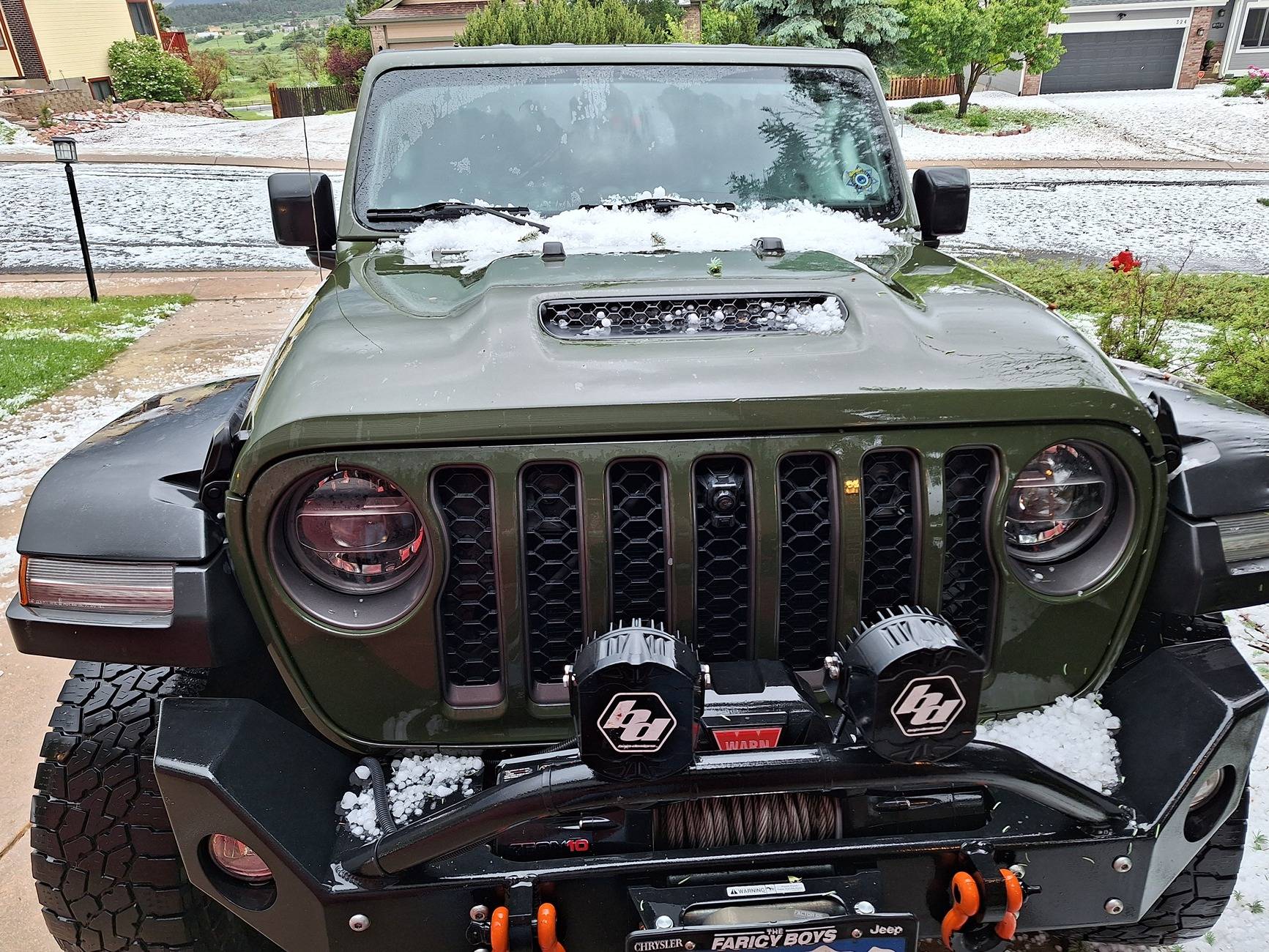

Not sure where you came up with your weight comparison. The AEV bumper weighs 118lbs. My redrock 4x4 bumper weighs 80lbs. The AEV bumper costs $2200, my lighter bumper with no plastic cost $350. I'll put it up against the AEV for strength any day, and personally I think it looks better.
Yeah, the AEV is definitely expensive. Yours is the stubby, my AEV is the full width. And different strokes for different folks! We are all individuals!:rock:

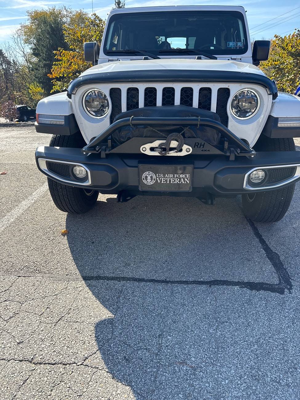

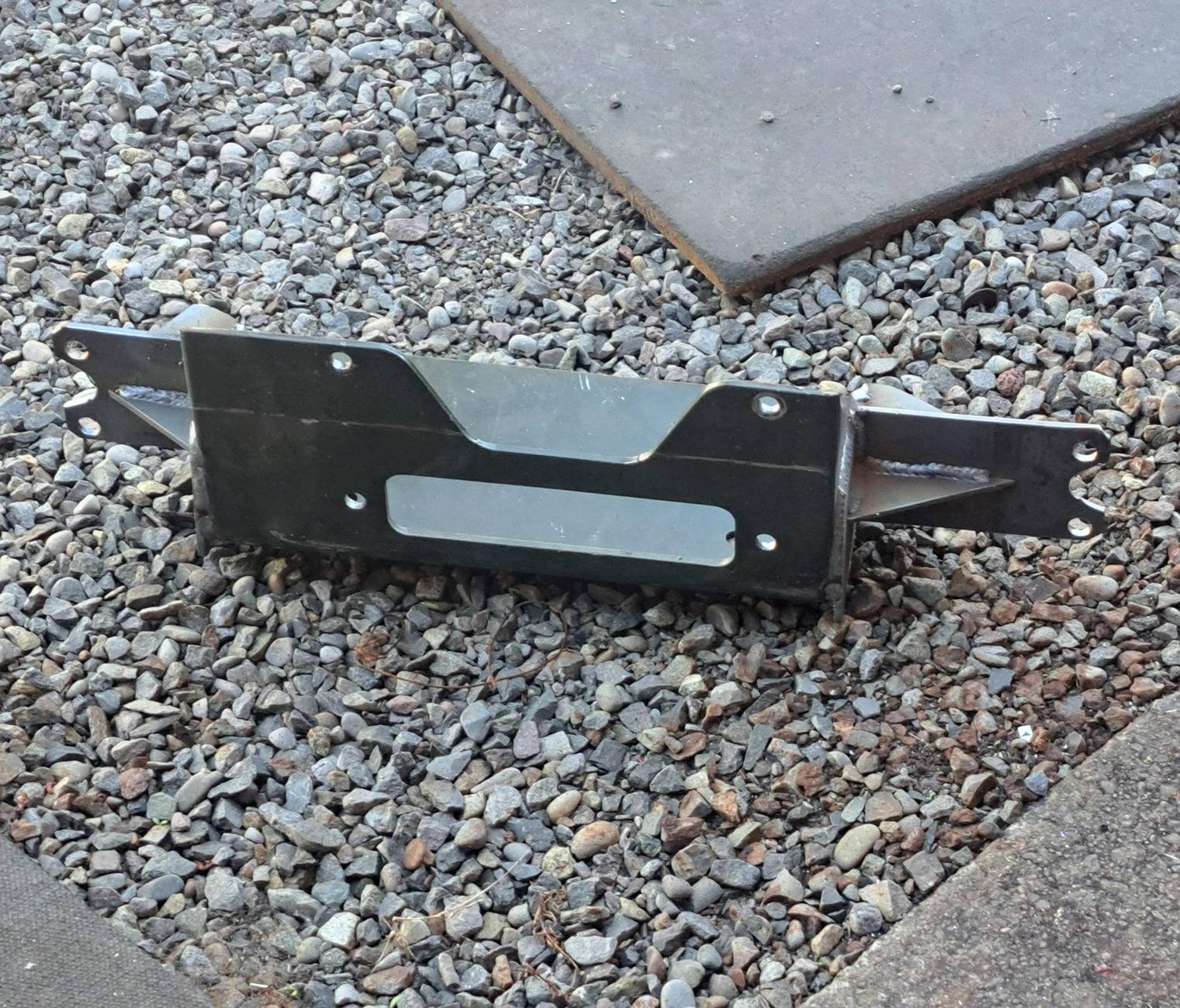

I have a Sport S with the plastic bumper and chose to go with a Rock Hard winch plate. I already had a Smittybuilt 10,000 lb winch From my prior JK. I also tow behind my motor home and had to add a base plate. Installing the winch plate on a winch ready bumper should be easy…
It’s a one beer project……
This is the route I went as well much to my appreciation! Looks good bud!

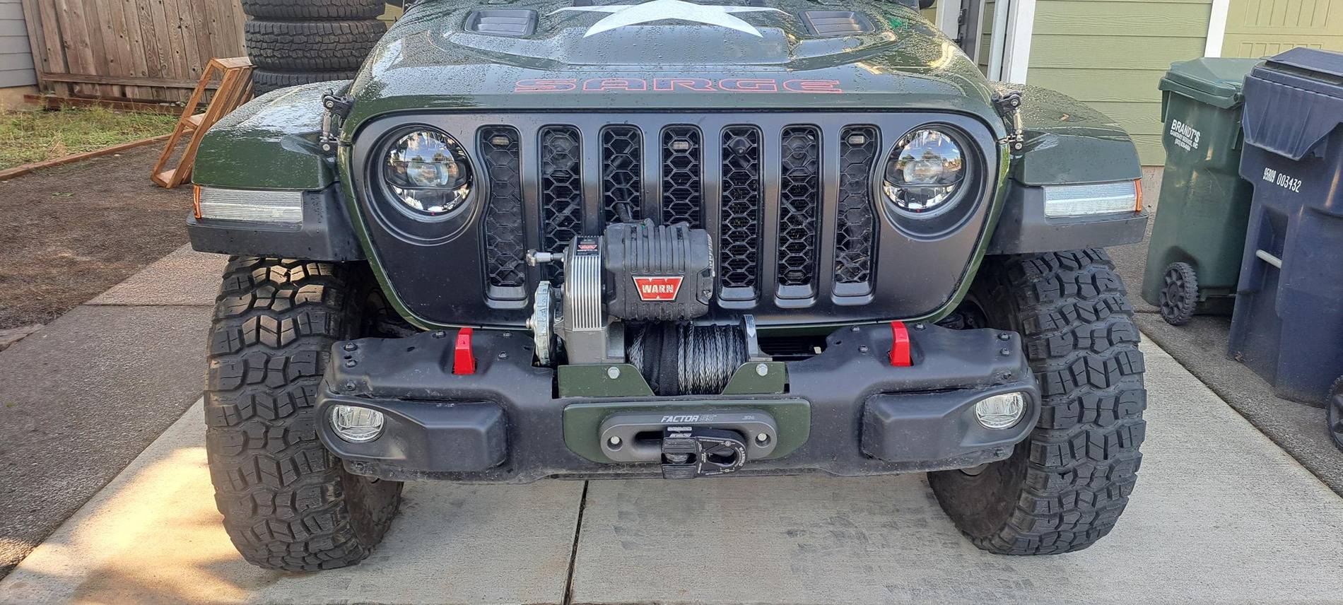

I have the factory steel front bumper and the aux switches on the dash. I checked Mopar pricing for mounting plates.. HOLY COW! Dealer wanted 10 hours labor to install and quote with winch was $4100, no thank you... I am old school so I want a Warn winch but like the idea of synthetic rope. I appreciate your feedback, ideas, and pictures. Thank you.

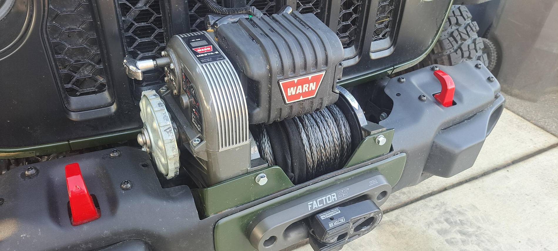

I wanted old school 8274 winch, faster, longer rope, better looking. Bought bracket off ebay, added brackets to bolt onto existing bumper bolts. Used cutoff wheel to modify bumper and this is what you get!
