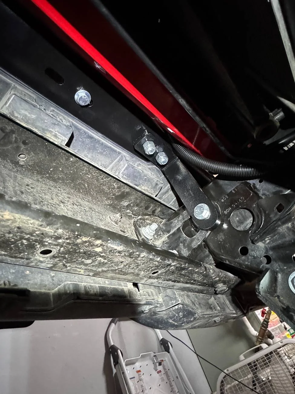

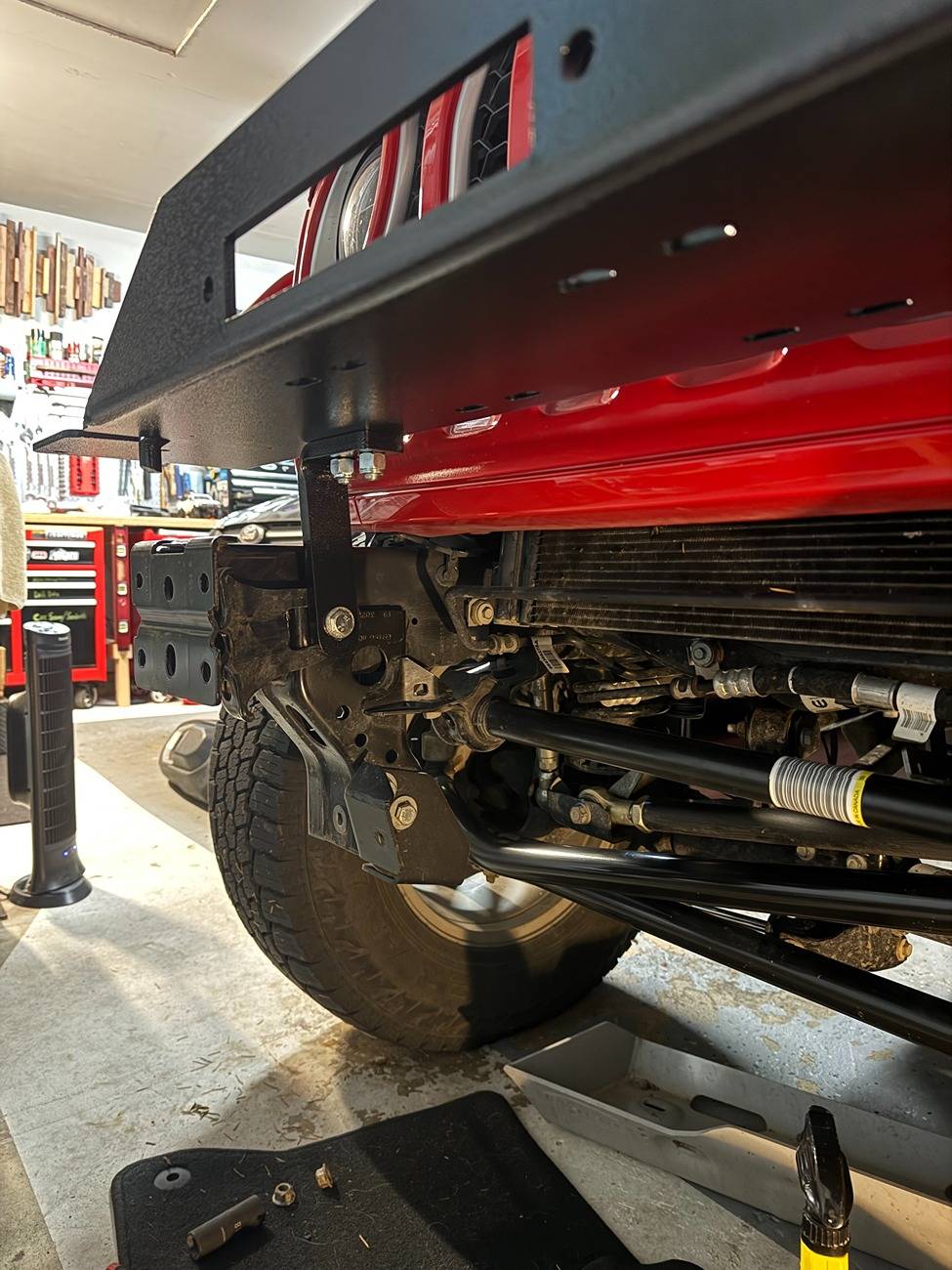

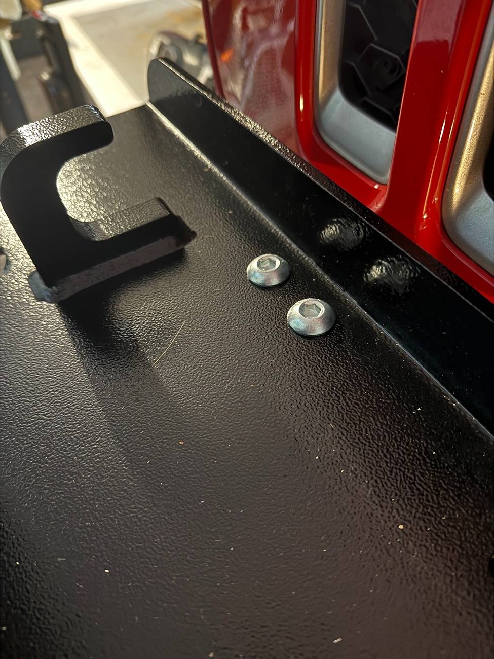

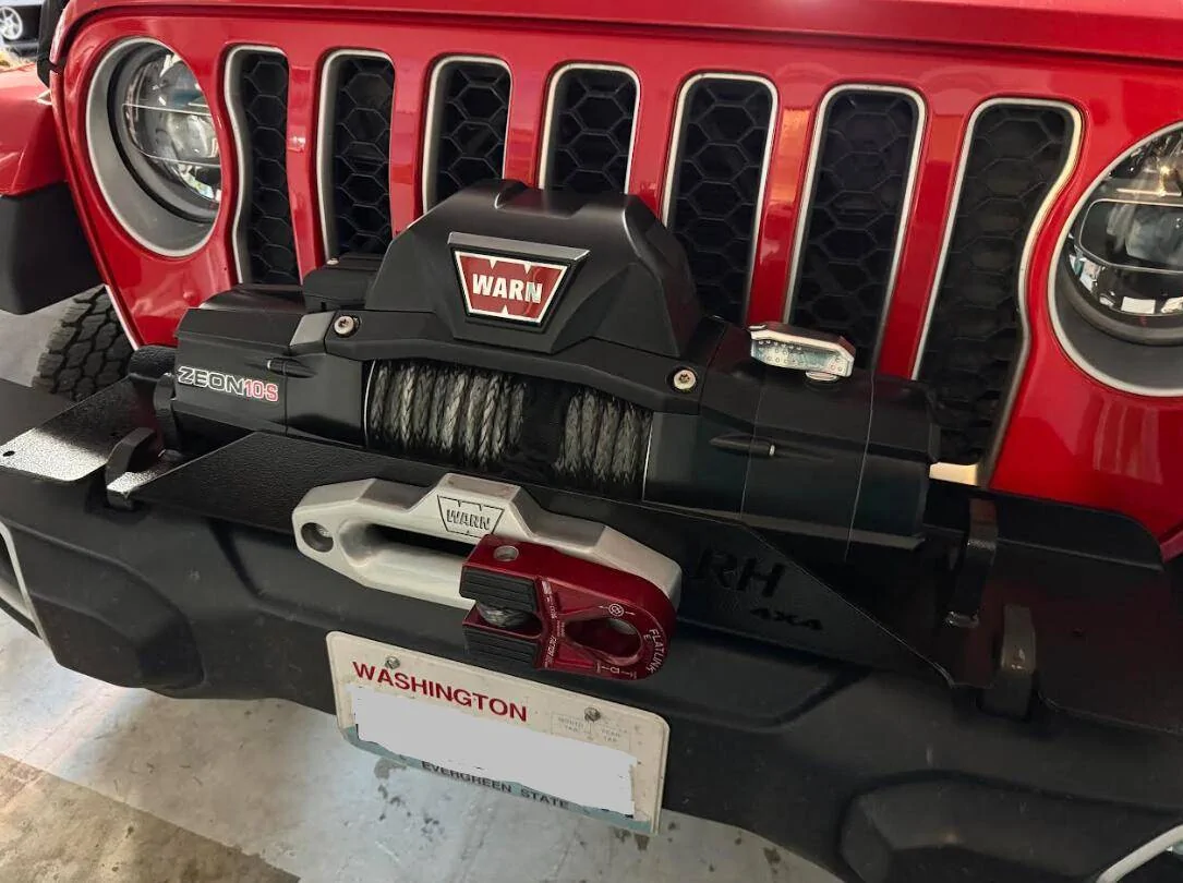

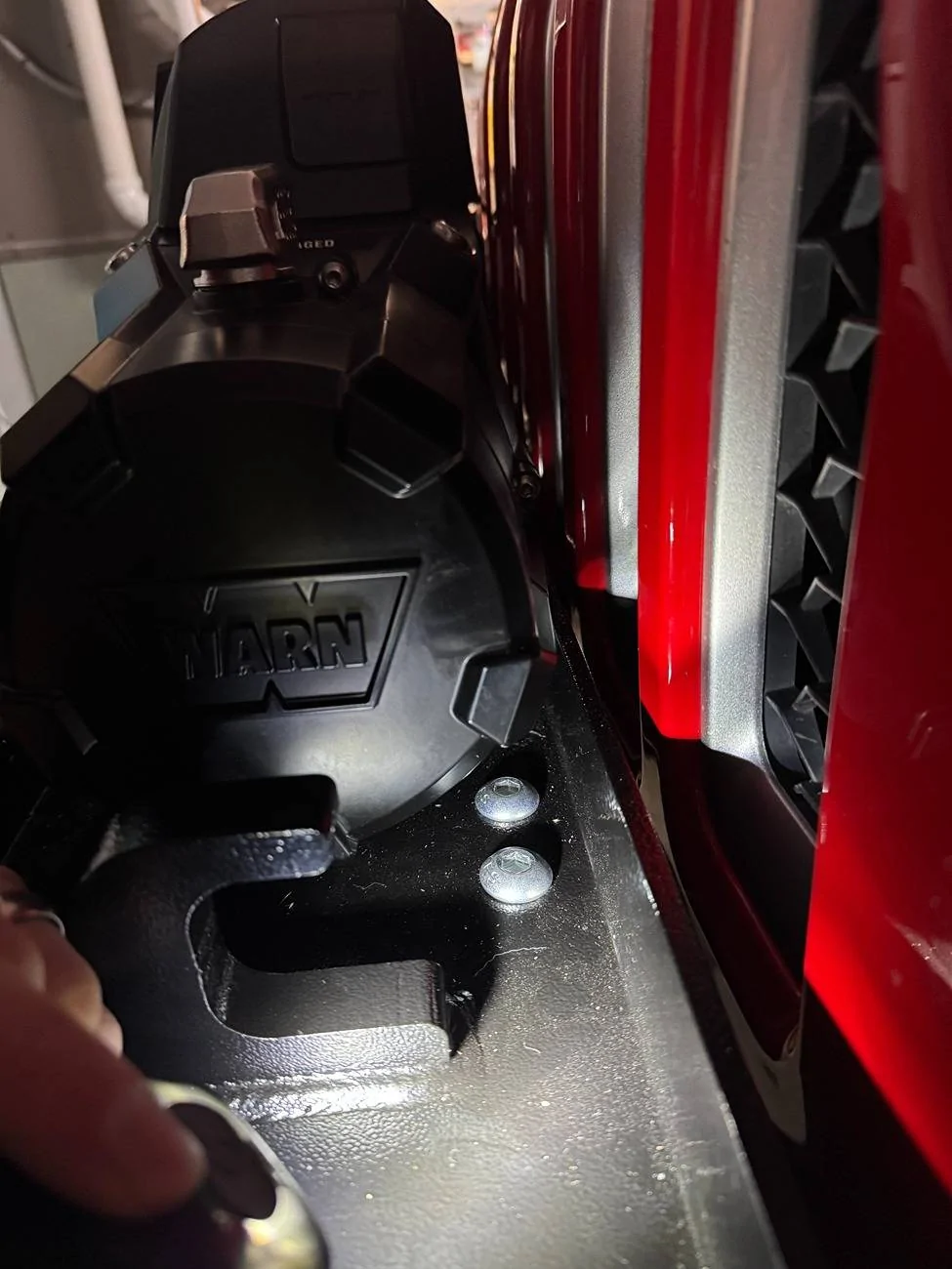

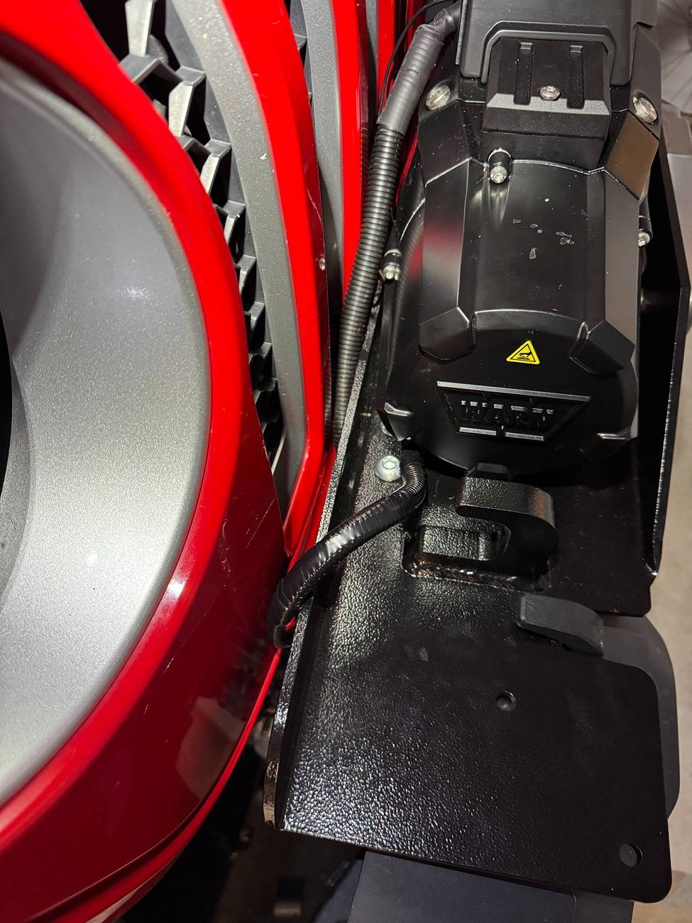

A little late to the party from the initial posts......but if anyone going forward wants to think I about it, I just installed the Rock Hard 4x4 plate on my JTO with a Warn Zeon 10s.
We'll see what happens on the first heavy pull, I will definitely be standing away from the front end lol The weight savings hanging off the front of the truck, accessibility, and cost was the lure.
Jeep Gladiator Rock Hard Winch Plate installed
Jeep Gladiator Rock Hard Winch Plate IMG_6179
Jeep Gladiator Rock Hard Winch Plate IMG_6180
Jeep Gladiator Rock Hard Winch Plate IMG_6183
Jeep Gladiator Rock Hard Winch Plate IMG_6193
Jeep Gladiator Rock Hard Winch Plate IMG_6191
-Lots of jump cuts on the RH4x4 install vid so you do not get the full picture of order to tighten/install portions
-The rear braces only tie into the frame via 1 x M10 bolt either side, and TBD on how well the tow hook compression method works
-RH hardware used SAE hex wrenches for top bolts, but metric nuts on the bottom of the mounting plate
-100% install plate super loose before replacing bumper, tolerances are extremely tight. Lots of shaking and swearing to get bumper fitted back on
-The back of the plate has a lip on it so you have to route the negative up and over depending on Winch make and edges are sharp, so I used some more cable protection where rubbing those edges
-The RH tow hooks have a sharp edge on them, will have to be very careful use soft shackles or straps if using
-The 18mm bumper nuts between the frame after you put the RH brackets makes the space for a wrench very tight, takes some patience
