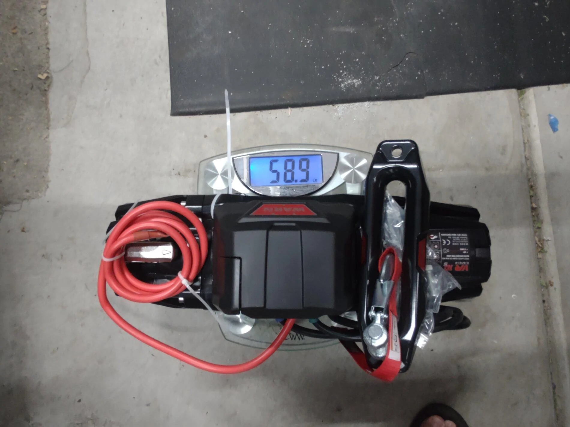

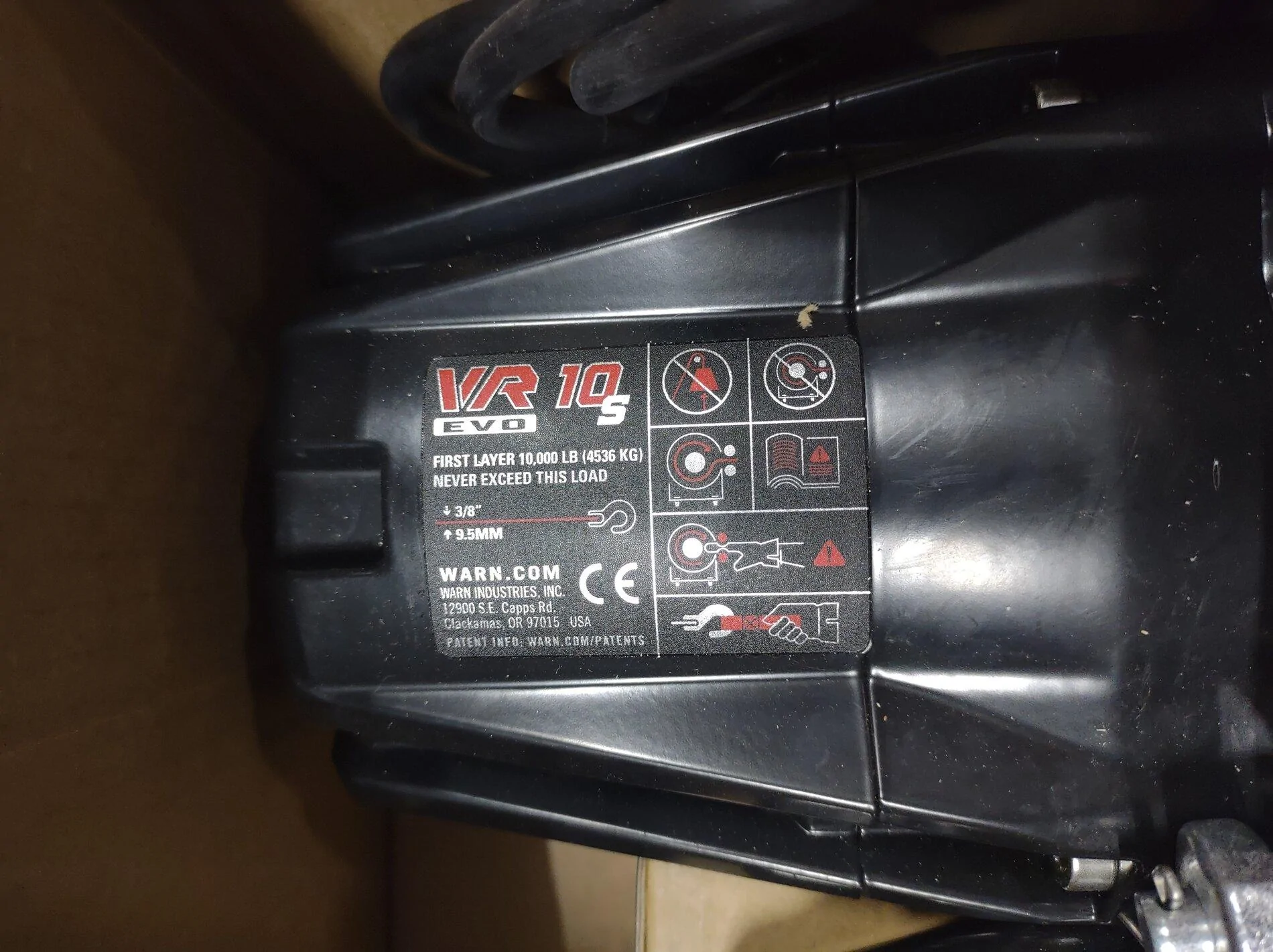

Why do the manufactures hide what there winches weigh? Warn, not on there page, Smitybuilt nope not on the spec page.
Jeeze WTH?
So I put to you all;
What's the lightest weight winches? Assume synthetic rope.
Smitybuilt 9500 S looks like it's apx 60 pounds, but that's a "ship weight".
Warn Evo 10-S 66 pounds per Amazon but is that correct?
