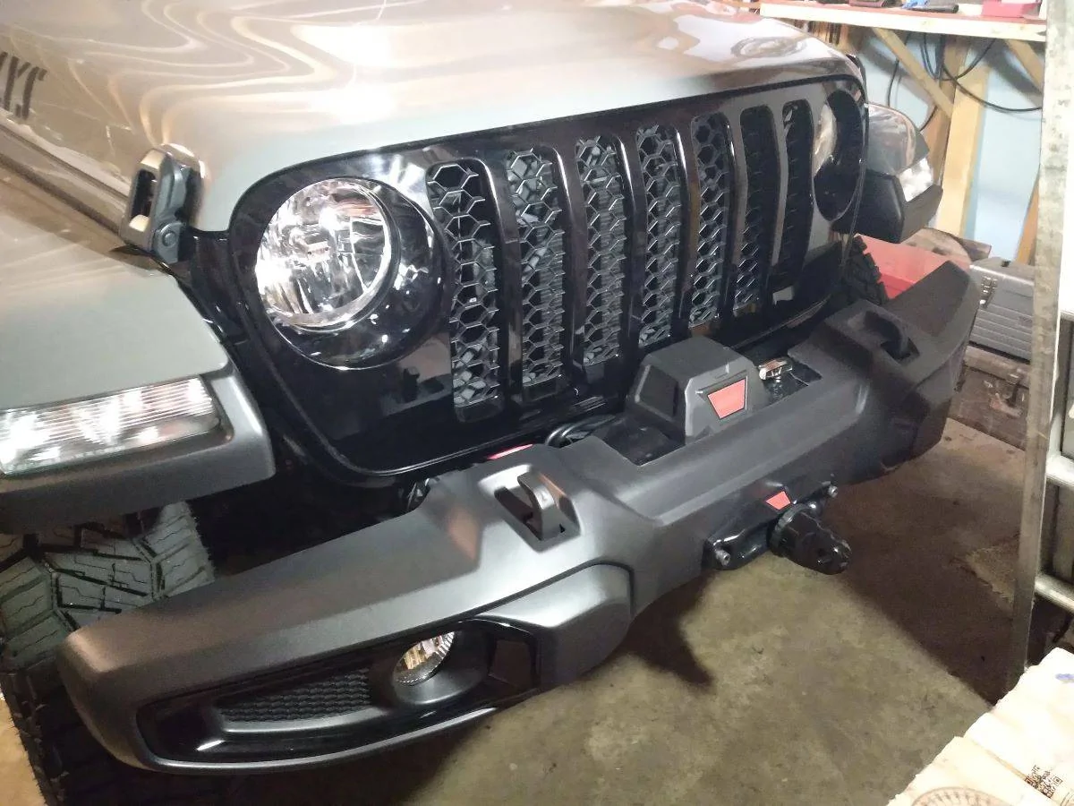

Weight was a concern for me. The stock steel bumper is heavy and when you add a winch and winch plate to it, the front end will sag a lot, probably below the safe limit for the shock valving. I got the Arcus bumper and with a 12k winch and steel cable, it added 101 lb over the stock bumper. The front end dropped 3/8 inch at the front of the fenders. It would have been less drop with synthetic rope, and if I left off the 20 lb front hooks that came with the Arcus.

I have a Warn winch and factory steel bumper with the Warn winch mount. No noticeable sag to report but I do have the synthetic rope. All I can say to add to this is that it all works together.

I have a JTR with Warn 12k winch. I used the Warn winch plate with Mopar steel bumper. I would caution you that all bumpers with builtin winch plate are not the same. Some are junk. I used the Warn plate because it is beefy and designed to carry the winch load regardless of the bumper in front of it. Just having a welded in mounting plate in a bumper is not the same in many cases. The adage that you get what you pay for is appropriate here.
