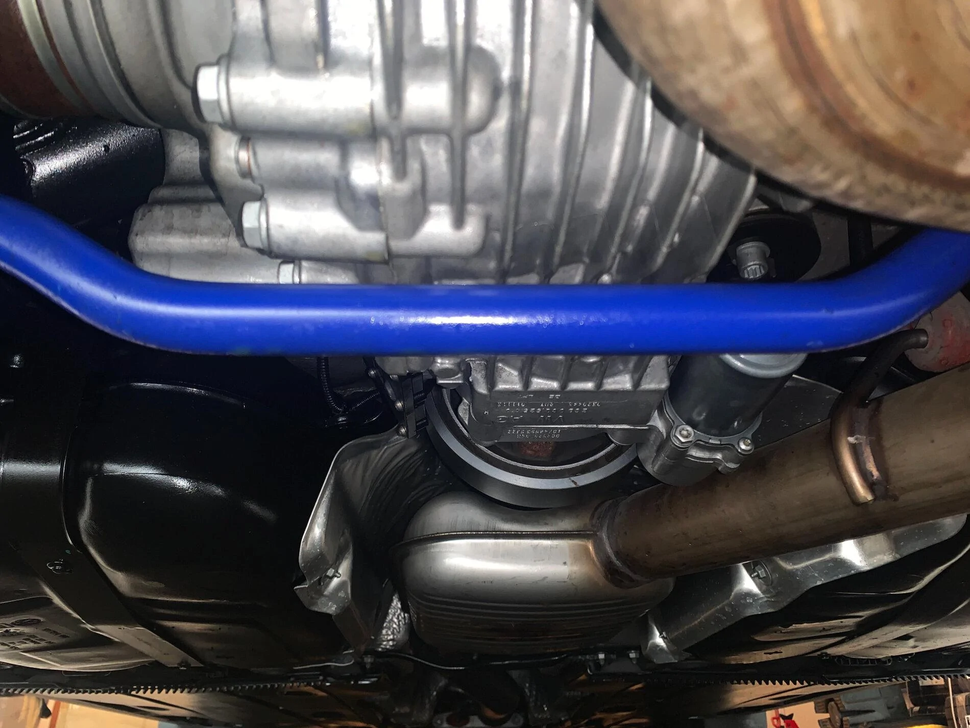

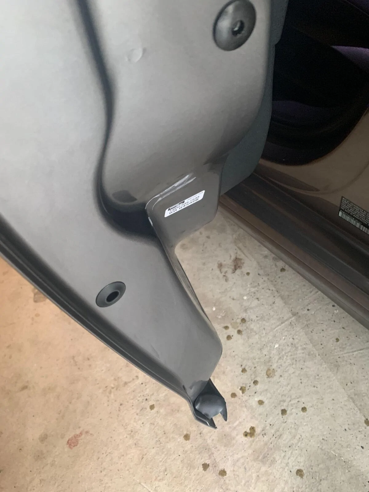

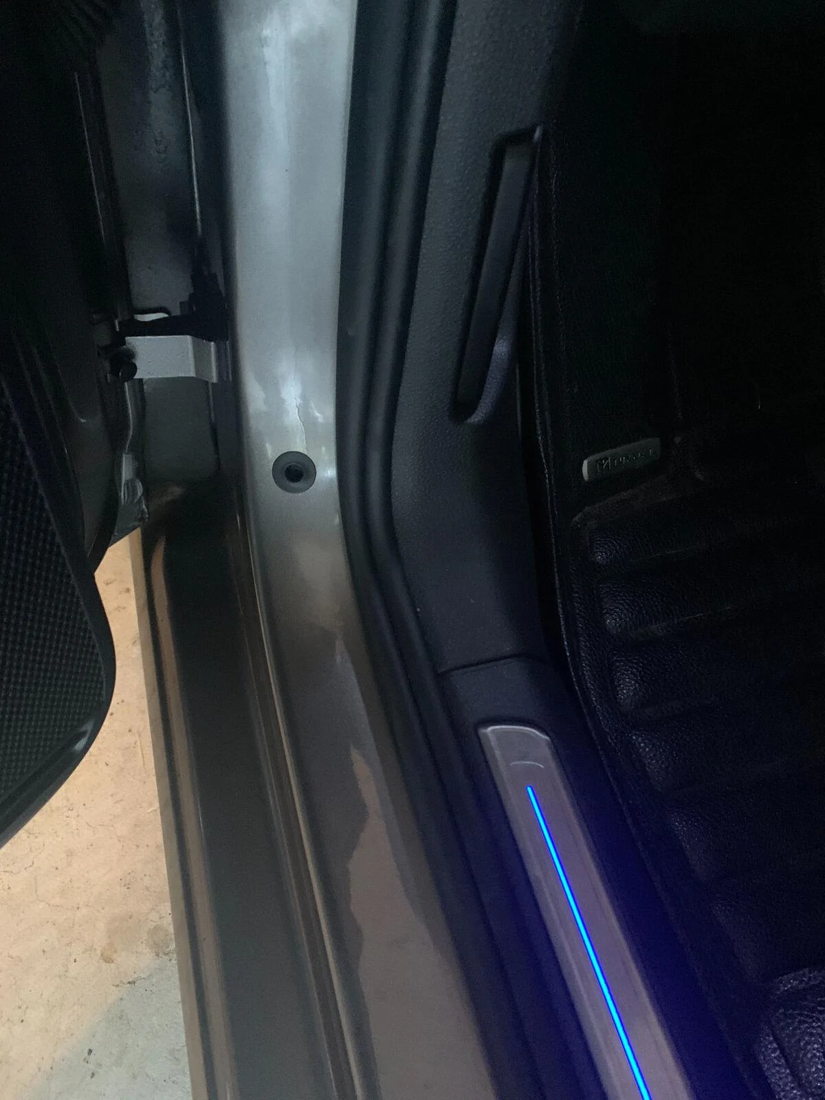

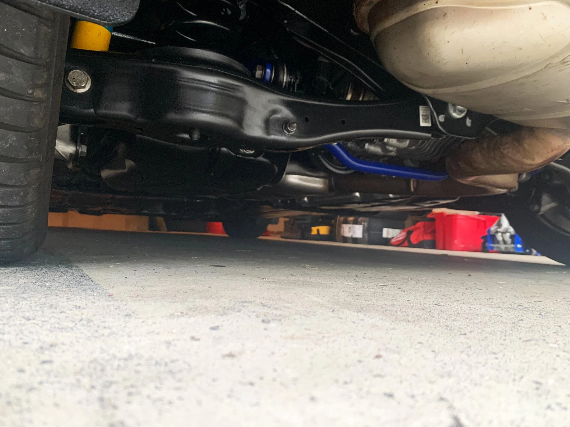

We have our vehicles Krowned every other year. They get the interior body panels by drilling and plugging, frame interior, etc. They recommend yearly but I've got a case of Krown and perform touch ups on rust prone areas every spring. We run our our SXS in the winter and the Krown has kept it looking brand new.
Here are a few shots of our 2016 Golf R from last year. We live in the Poconos and (especially on local roads) they throw just about anything they can on the roads. Salt, sand, char/anti-skid, bromine all of it.
Notice the plugs in the body panels. This prevents rusting out from the inside. They have a 360° 6' wand they use to get down in there. If available in your area, check em' out. Our vehicles are $130 per treatment and like I said, we do it every other year. Come resale time, folks are stunned at the undercarriage of our vehicles 100% of the time and it makes working on the vehicles far less painful. Nuts & bolts are never seized up and wiring harnesses are never brittle.
