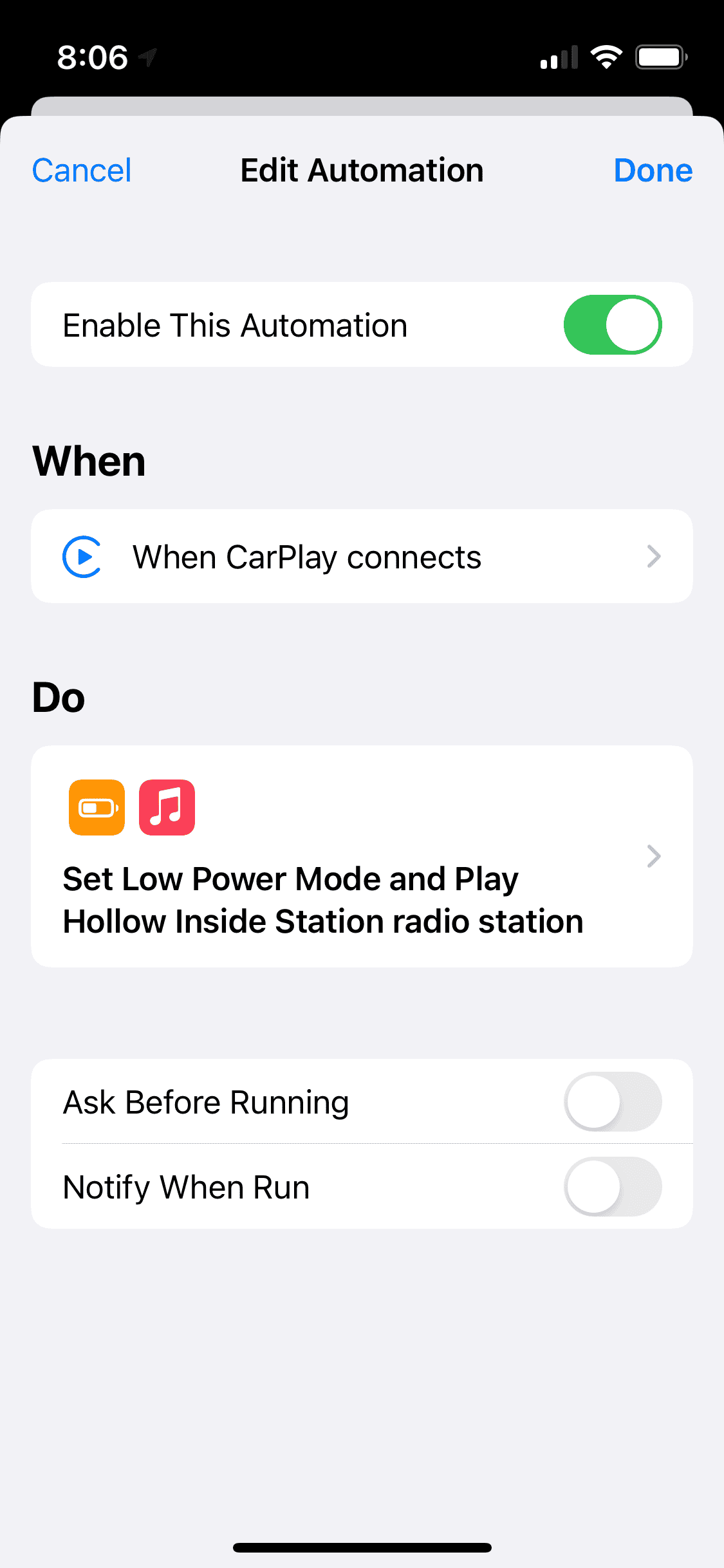

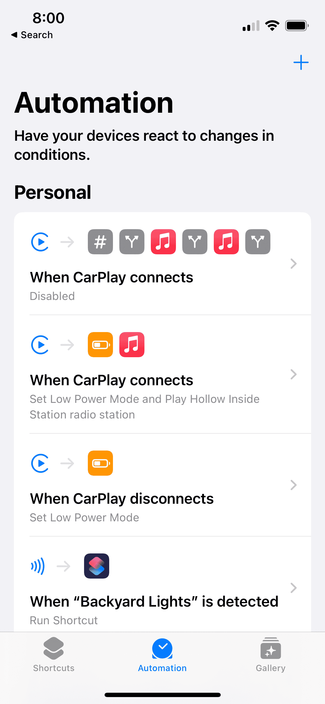

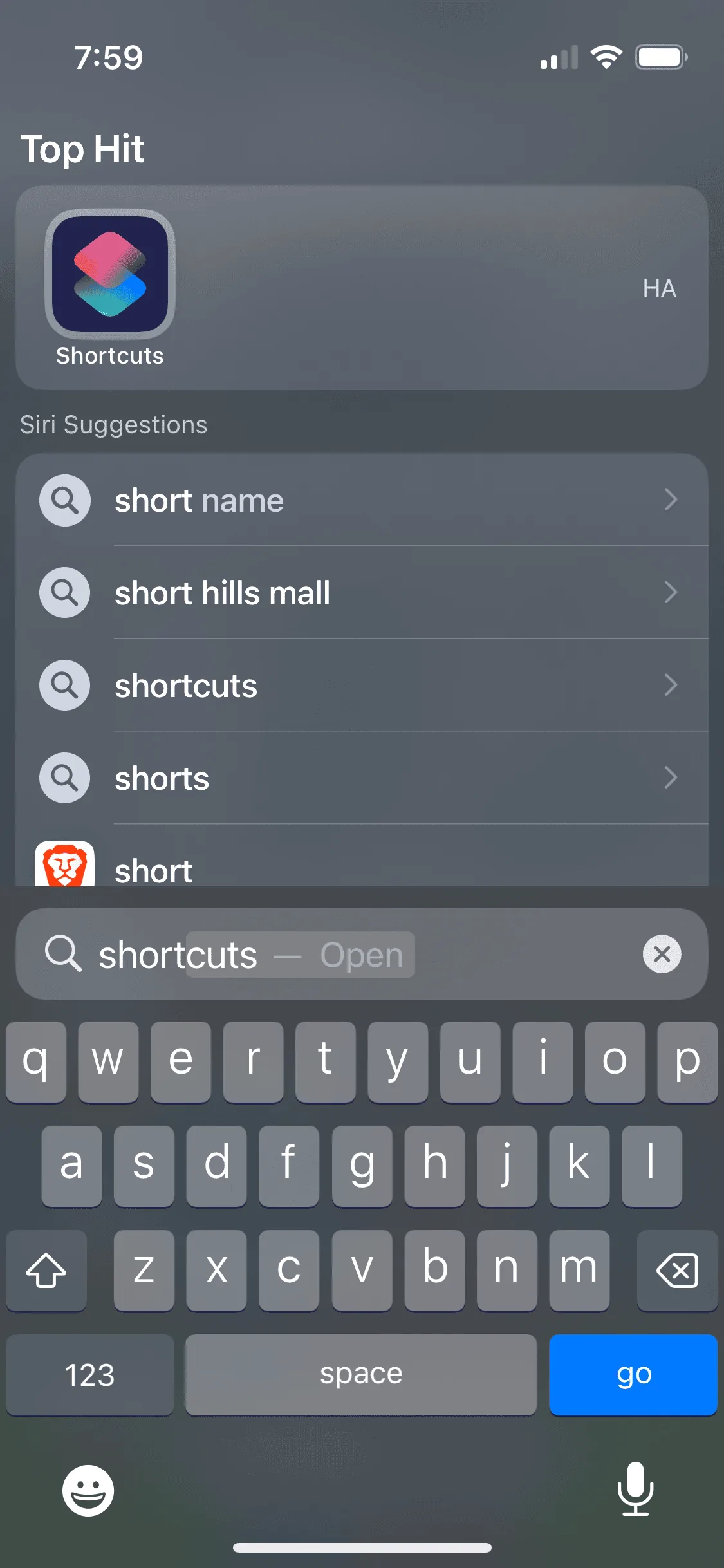

How did you set this up? I use a second hand carlinkit i got from a forum member and love it. But on longer trips the battery drain is noticeable.
Sorry I started taking screenshots to answer you but then lost the plot lol.
find shortcuts, you might have to install it, it’s by Apple now since they bought the startup.
then find automations and select personal automations
create a new one select when CarPlay connects trigger, then in the do select low power mode.
then create one that does the opposite for when it disconnects to exit low power mode.
Ty!
