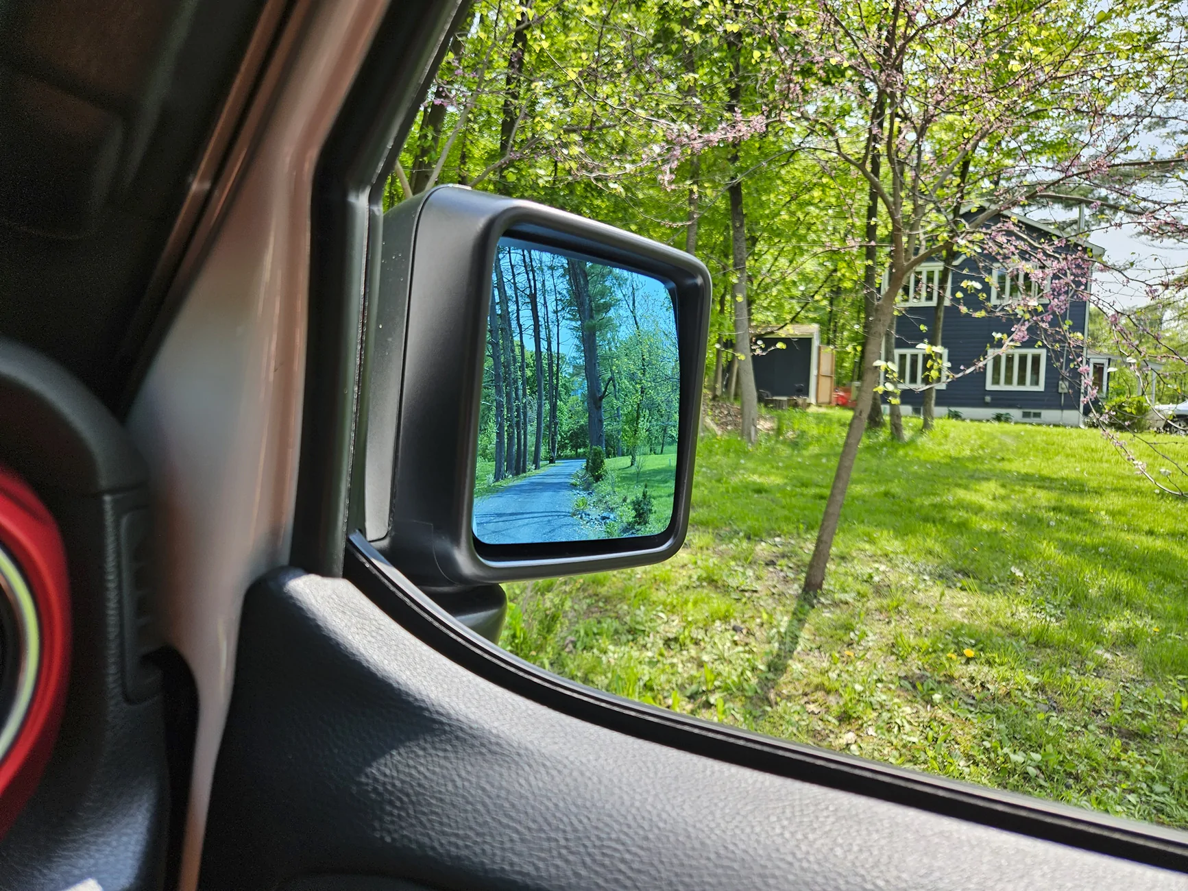

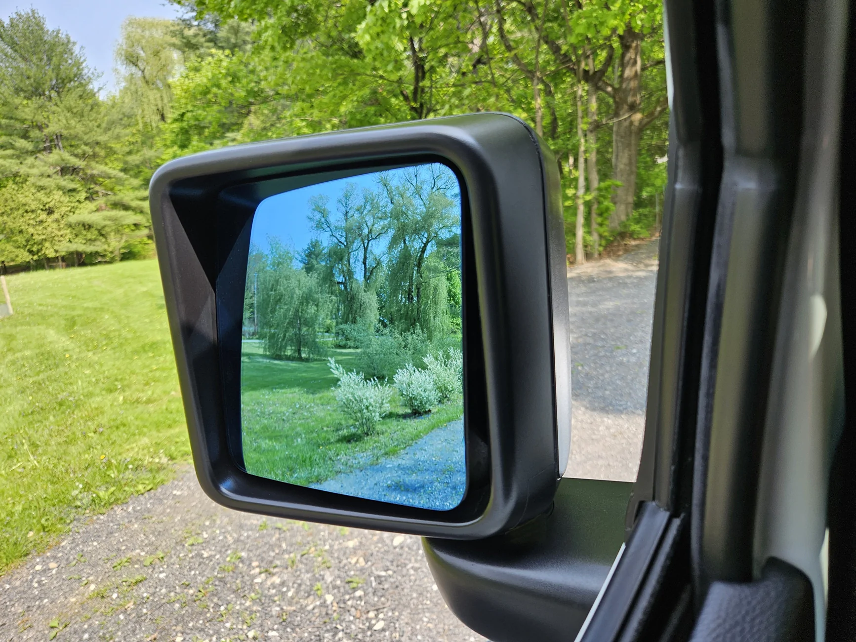

@BambiBasher
Checked out your pics of the side mirror install. Can you adjust the side mirror(s) so you don't get so much of your JT in the view?
Preferred is like in the pics below.

@BambiBasher
I can adjust the passenger side Wolfbox mirror out like this, or at least close, but I CAN NOT adjust the drivers out like that. Quite a bit of truck still in the mirror when the drivers is adjusted all the way out.
Can confirm, even fully out on the driver’s side you still get a decent amount of the JT in the frame. But . . . as they are wide angle you get a good view of the lanes beside you too! More so than on the OEM mirrors.

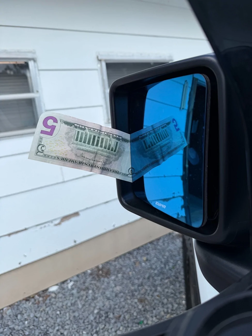

I appreciate the help but they are installed correctly. They pop solidly into place and don't move under normal conditions. I've been emailing back and forth with Suma and they said the issue has come up before. It isn't a solid hit against the housing, just barely enough of a pinch to hold a dollar bill in place. It just happens to be at the point where mine are properly adjusted. Mine have only come off twice and both times were at highway speeds in strong crosswind. I'm guessing there is enough flex in the housing that when the wind hits it just right the mirror pops off. Both times it has happened the mirror stayed connected by the wires but it is enough of a problem that I put the original mirror back in the truck just in case. My only idea is to remove a little material from either the frame or the mirror to widen the gap. I haven't looked closely at the mirror yet but I'll take it off this weekend and see if I can make a little room.

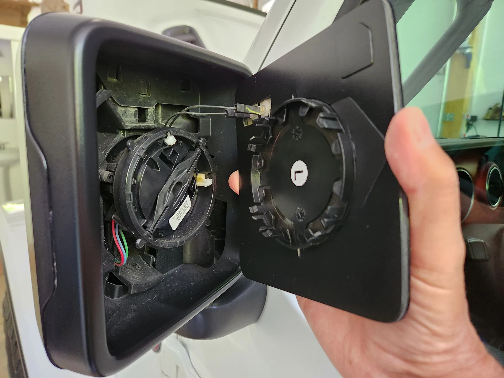

For those doing the install. Here is what you see with mirror popped. When you reinstall the mirror you need to push very very firmly on the mirror to assure all the locking tabs grab firmly.

I read that thread and have tried taking it off and reinstalling it. You can trust me when I say it is properly installed. Both sides fit very tightly even after having the driver's side on and off several times, it's not easy to remove. It snaps firmly in place every time and I have to pry the edge out with a trim tool to get hold of it to unsnap it. Everything is tight and the mirrors are excellent quality. The problem is on my particular JT it slightly rubs. They were on for several weeks before it came off the first time then it happened a few days later under similar conditions.
The first time it happened I was driving west with a south wind hitting the driver's side. According to my watch after it happened it was 20 mph wind with gust into the 30s. At 70 in the wind, you can see a little wiggle with the entire mirror housing and with the left edge of the mirror touching anyway, I figured that what caused it. I'll attach a picture I took for Suma. It's slight but it holds a bill in place. Looking at the picture now, it might be the backing behind the mirror that is rubbing and not the mirror itself. I'll take a look this evening and hopefully that is something easy that I can sand down a little.
