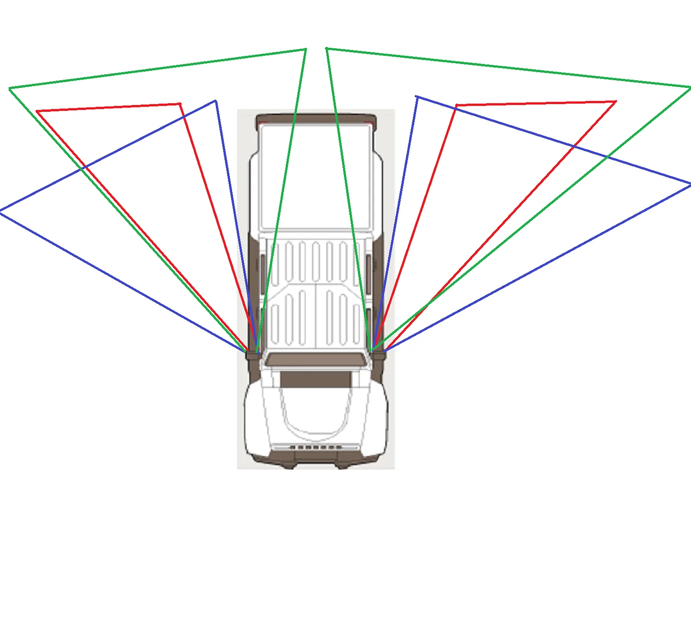

After a few days of driving the truck with these mirrors, I can say they do help. I still stand behind my statement that you don't get as much as they advertise in the marketing photos, and you don't get much from the passenger mirror.
I will also state I think it's really going to depend on what you're after, and how you use your side mirrors. Many folks adjust their side mirrors to see behind them, I adjust my side mirrors the way they are SUPPOSED to be adjusted, and thats to see your blind spots along side of you. You have a rear view mirror on the windshield to see behind you, your side mirrors are to see along side you (it's literally in the name, REAR view mirror and SIDE view mirror).
I can still adjust the passenger mirror out a little bit, but the drivers is out as far as it will go. I think if the glass was angled a tad more outwards on the mould they would be great, but as they are now you get more inwards view than you do outwards view. I don't need to see my rear doors or in my rear windows...
Best way I can explain it is through images.
Red lines were stock mirrors.
Blue lines are what I was hoping to get.
Green lines are what I did get.

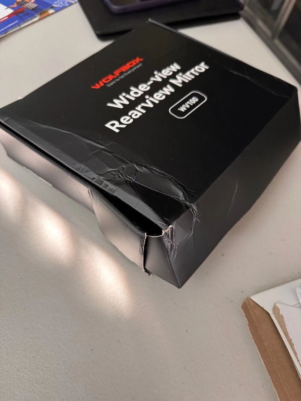

Here is my install tale! My mirrors finally arrived on the barge.
The trauma started when I picked them up at the shippers warehouse as the agent walked back to the front desk looking sheepish and asked if the box was anything delicate as it had kinda got squished in transit. 😳
I told him it was mirrors (like it said on the box) and he went a shade paler and said could we open the box there to check the contents.
Thankfully @WOLFBOX did a great job packing them in bubble wrap bags with room in the box so despite its poor shape the mirrors were fine.

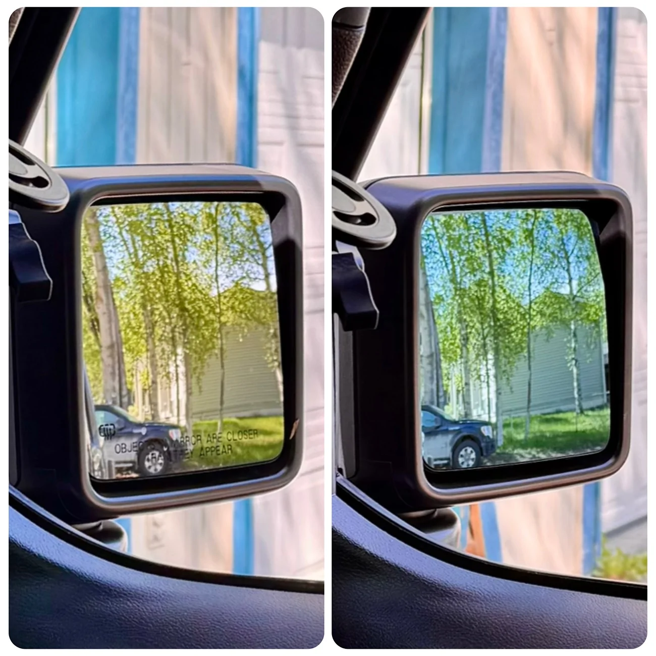

Installation was amazingly simple as WOLFBOX had indicated. Snap the old mirror off, transfer wiring connections (heat in my case) and snap the new mirrors on.
Admittedly I haven’t been driving in them yet, but the difference for the drivers side mirror was instantly apparent to me. Much better field of view.

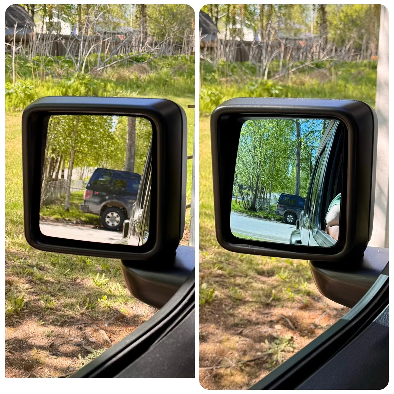

The passenger side mirror was less apparent, (as folks here already mentioned) but I did gain some extra view overall so I’m a happy camper.
Pictures below, stock OEM mirrors in the left frame and new WOLFBOX wide angle mirrors in the right frame.
Drivers side:
Passenger side:
I noticed the blue tint and look forward to seeing how that fares when conditions allow. Headed to full summer here so the sun is barely setting and I don’t do much night driving at the moment.

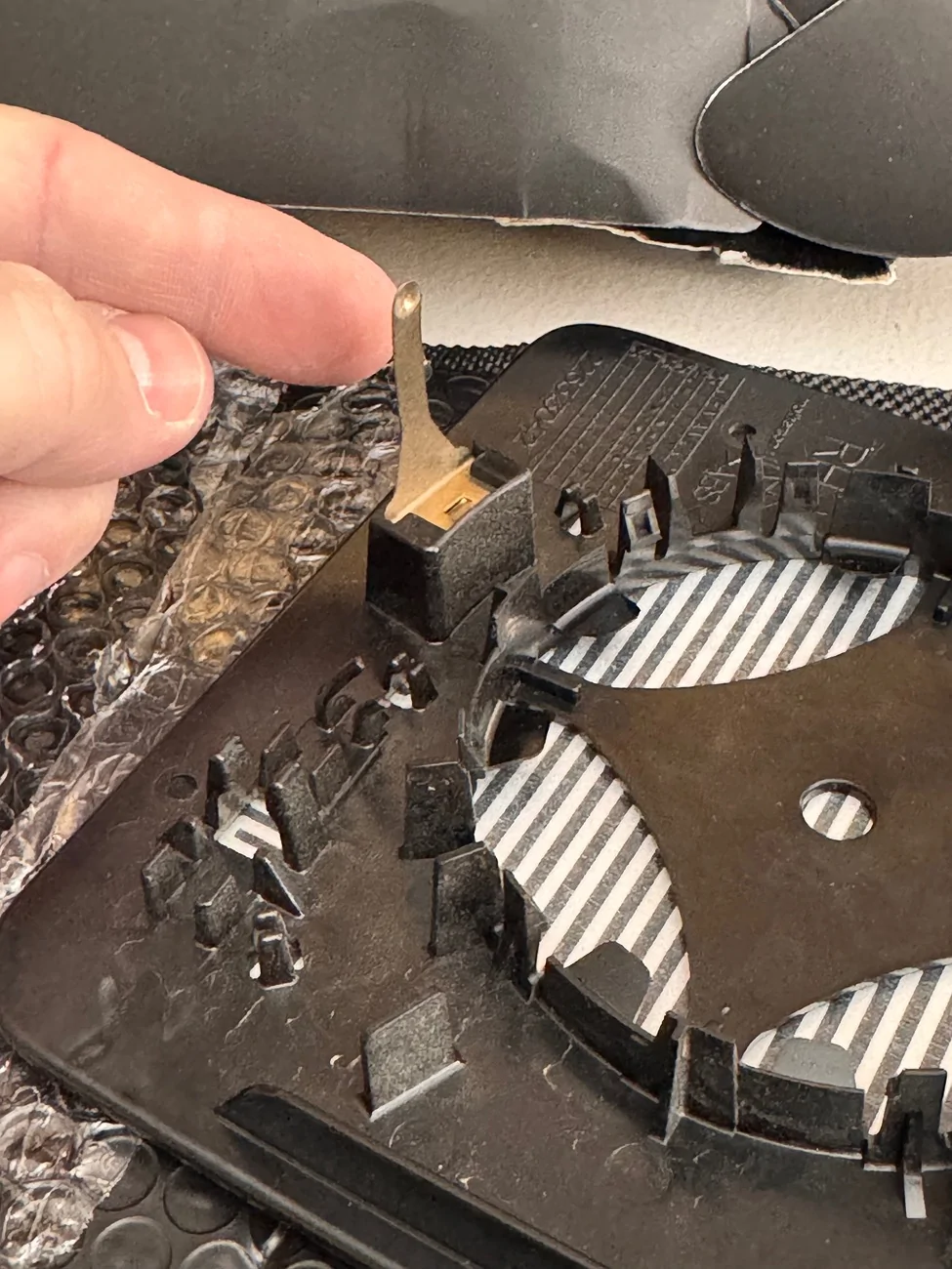

One last observation, my stock OEM mirrors had a metal clip at the bottom of them. (See picture below.) Not sure what it is for exactly, perhaps extra stabilization? But the WOLFBOX mirrors did not have it.
@WOLFBOX do you know what the metal clip on the OEM mirrors is for and how come your replacements don’t include it? Thanks.
