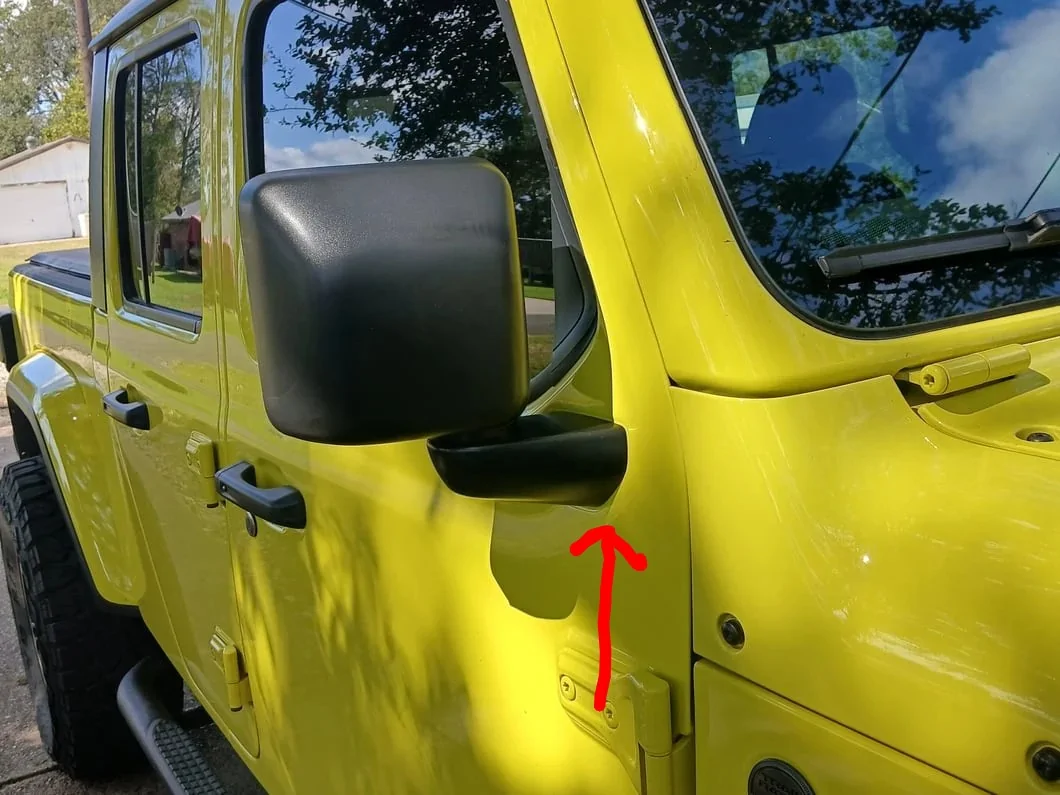

I’m surprised no one has offered a spacer adapter to push the mirrors out an inch or so.
Are you meaning to add a spacer between the mirror mount and the door? Where the red arrow is pointing?
I've been talking about it with my son. I just need to get an extra mirror for modeling.
Yes.

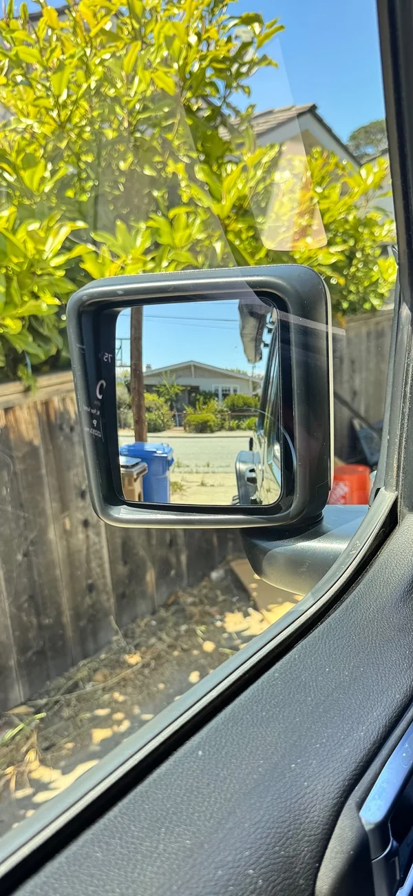

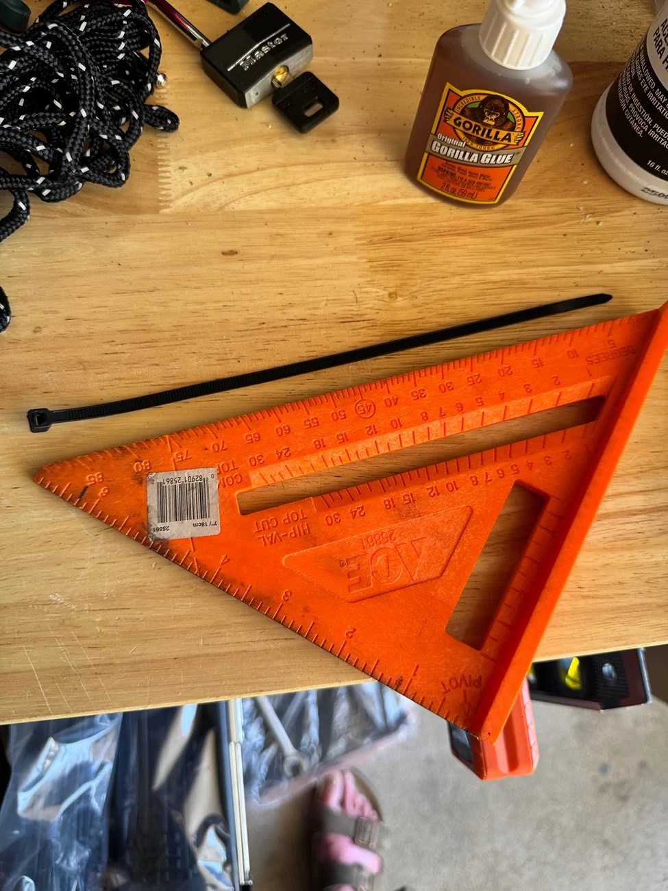

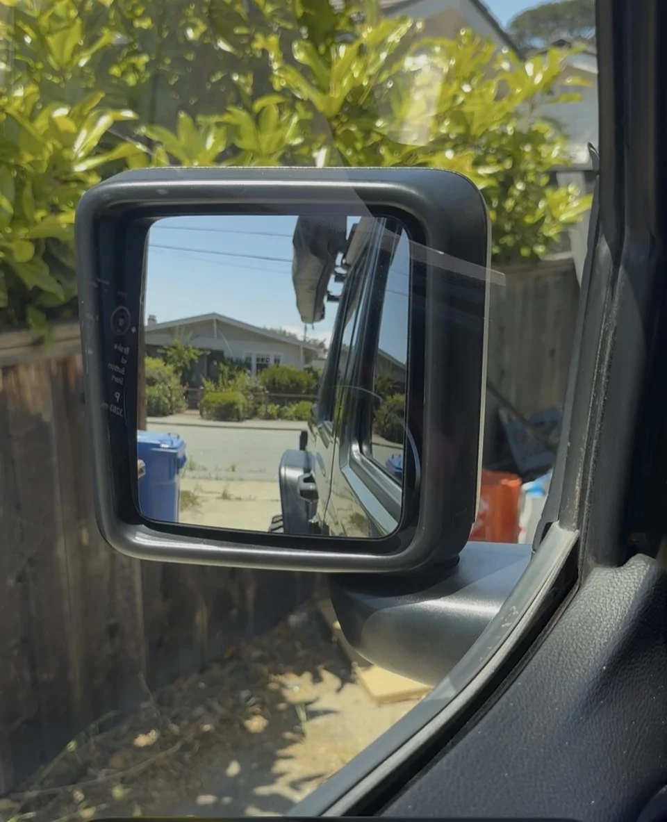

I spoke with @Rhinebeck01 this AM on the phone and he talked me through how to do the trick to make you see less of your truck and more of the road. It’s fast and stupid easy. I only needed to do my drivers side. I’ll post the pics/vid below.
Basically the mirror housing is on a spring so you pull the whole housing away from the truck which creates a gap between the housing and the pedestal. Using an approximately 1.5” piece of zip-tie you place it in the gap leaving a small tail so you can remove it if you don’t like it. Because I have an IQ of 48 the pics/vid below may not be in order but there is a before, after, size zip-tie I used to cut down and how I moved the housing to create the gap.
Feel free to hit me up with questions but the credit goes to @Rhinebeck01.
