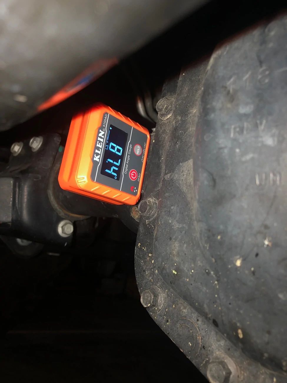

The Mopar 2" should have come with longer control arms. If not yes get them lower control arms) and get the caster out more. Usually 5.5-6.0 .

I bought it new with the 2" Mopar lift already installed along with the TIS Off-road 555s and Toyo OC 37x13.5 R17s. Just looking at what comes in a Mopar 2" lift, I didn't see longer control arms pictured. Hopefully you're right.
I used my digital angle finder on top of the new ball joints and it looks like I have about 5.4 driver side and 4.9 passenger. Now I was just checking it right where I happened to be parked in my driveway, so I need to make sure to find a good level area before I commit to those caster numbers.

IF that is IF they control arms that came with the Mopar lift were installed they are about â…ś" longer than the originals . Since you dont have the originals to measure both to see . I am suggesting that you get a digital angle finder. Find out what the caster is. If it isnt at least what I mentioned then get a set of adjustable LCA's and do One at a time and adjust that caster out more. Its easy to tell remove one of the ones you have measure center of hole to center of hole and make the adjustable a shade longer by screwing it out a half or full turn ( dont lock the adjustment yet . Count the threads match the other adjustable to the one you just did . Now install it . ( dont tighten the nuts on the rear of the LCA just get the bolts in. Measure ypur caster . If it is still to low pull one at a time go one full turn stick bolt back in and repeat for other side . Measure caster again. When its is right then put the nuts back one and tighten them down tight. I dont recall the torque . It is like 150ft. Ibs. Or some crazy high number .

Put the angle finder where this pic is showing.
According to what I learned and read.
If this measurement equals 90° ypur caster is 6°caster. As you can see in this pic this guy lacks alittle bit.
