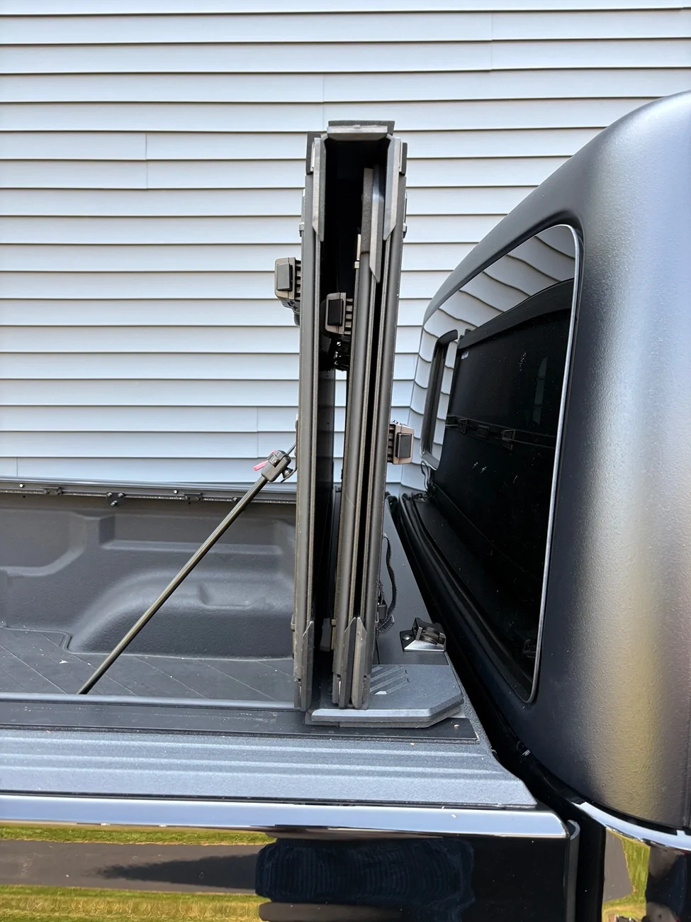

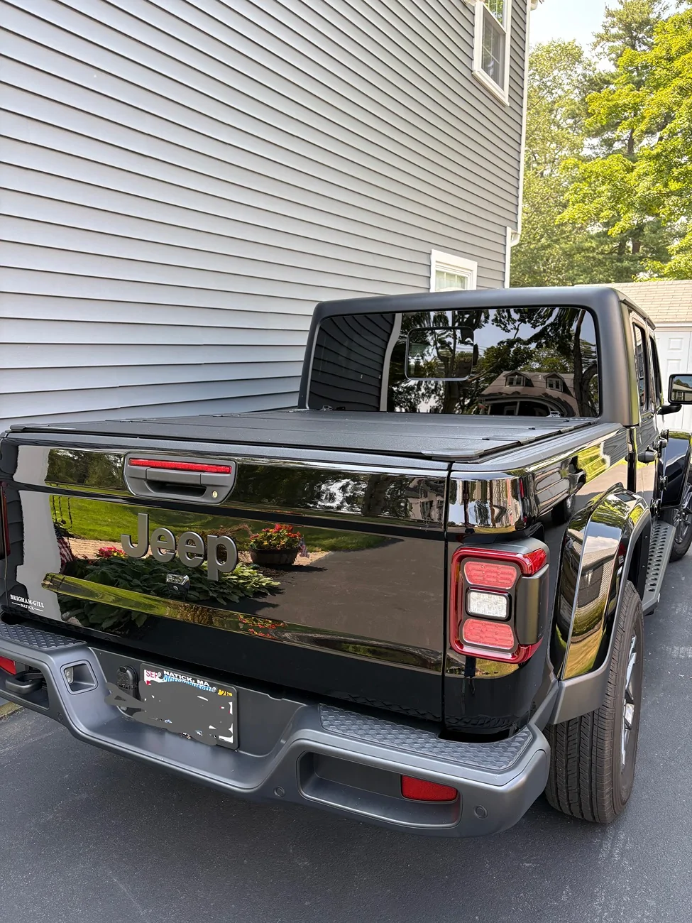

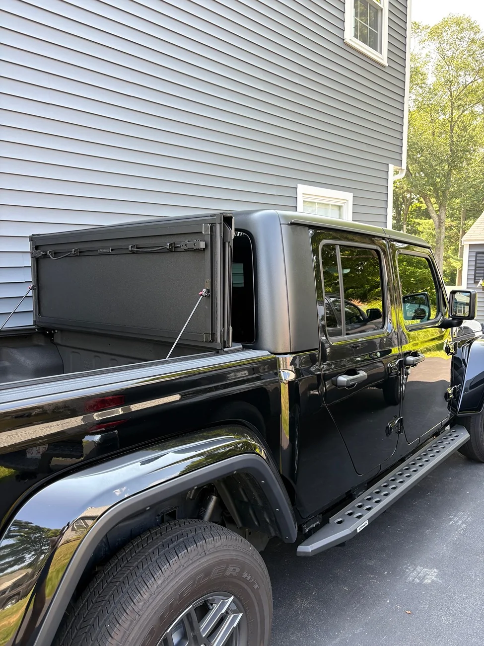

Here's some pics. Pretty impressed with the quality of this cover. Still would like to confirm whether the rail clamps are used/not used for the Gladiator install. As I stated before, the included instructions make no mention about the use of the clamps. If nobody weighs in I guess
Jeep Gladiator Worksport AL4 Tonneau Cover Install IMG_2626
I'll have to contact the manufacturer to confirm.
Jeep Gladiator Worksport AL4 Tonneau Cover Install IMG_2628
Jeep Gladiator Worksport AL4 Tonneau Cover Install IMG_2629
