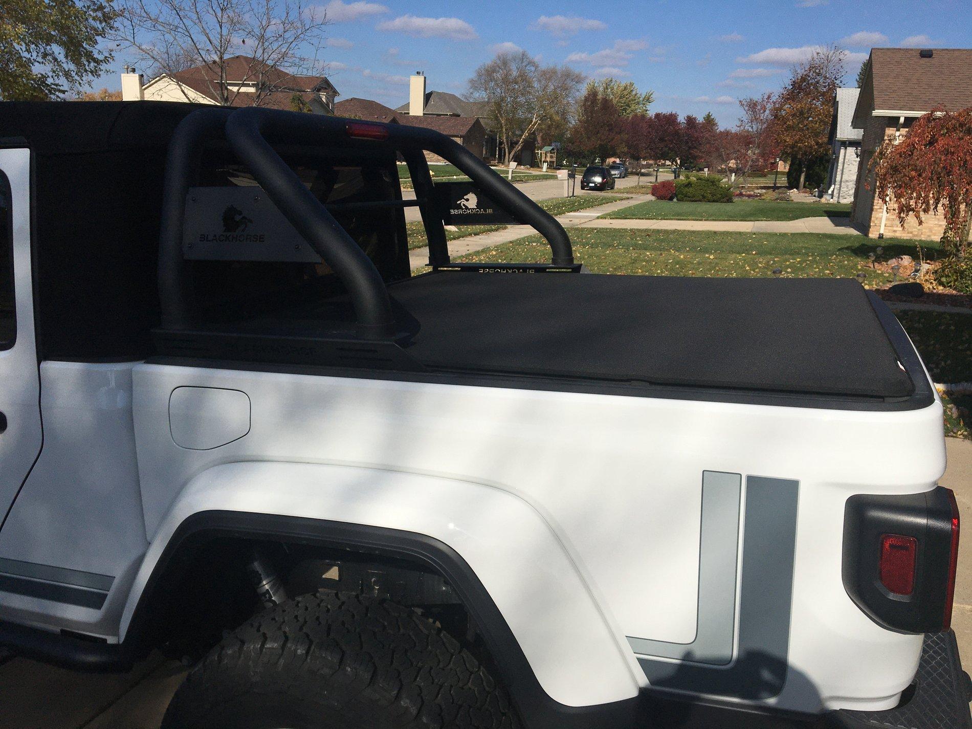

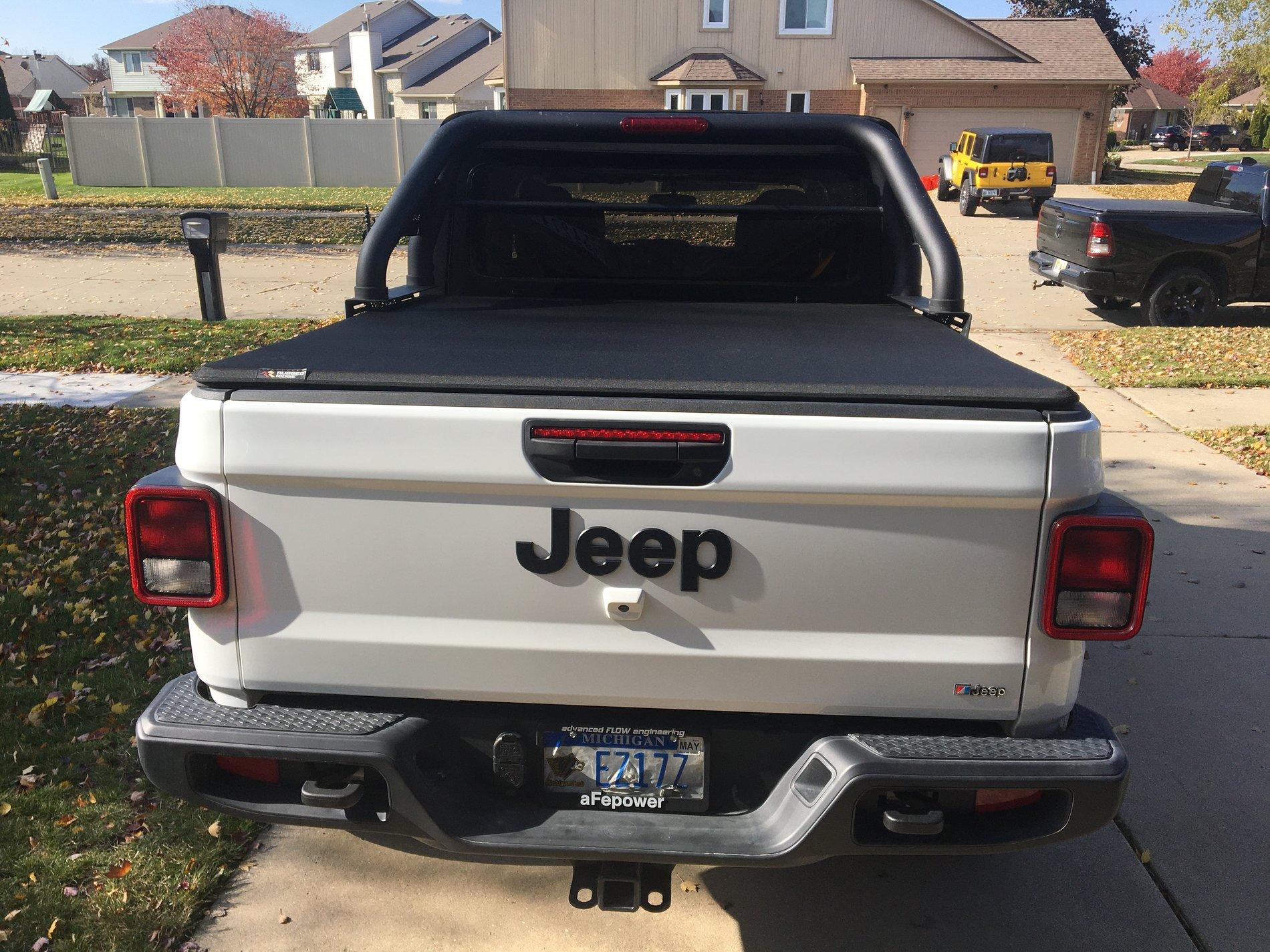

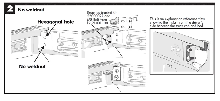

An update on the RR Tonneau cover issue. The new brackets showed up friday afternoon.. However, no instructions on what to do with them (an it wasn't very intuitive, at least for an electrical engineer :) ). Called RR and they had no idea where or how to install them, so the rep said that he would contact Extang as they make their tonneau covers for them (good to know). Not wanting to wait, I went to Extangs website and of course their instructions were the same as RR's for trucks with weldnuts. So I called them and after a few minutes, I had the new instructions emailed to me (still haven't heard from RR)
What a royal pain in the ass trying to get these brackets between the back of the cab and the front of the bed to hold the original brackets in place. Good lord. You could never install this with 1 person.
Here's the instructions and the finish product. Fits nice and fabric matches premimun soft top material vs vinyl finish

I had this challenge back when I bought my RR top, I sent the RR top back and I ordered the Mopar Tonneau Cover Part#82216371AA last week - the cover was "development" for some time, but now you can order them from/at the dealership. It appears most Jeep dealerships have a 15% off coupon for Mopar parts that expires in December 2020, my dealership honored it. Mine came in yesterday and I just dropped of my JT to get it installed.
I don't have a rivet gun, or have the patience anymore as I experience the same thing as the OP experienced. I was scratching my head as to why my JT didn't have bulkhead threading as documented in the the install instructions provided by RR (and Mopar, and ExTang). I thought I was crazy! lol
I wish Jeep would do a better job communicating the bulk head change so that way people wont waste time buying trying to install it and then packing it back up and sending it back, and wasting vendors time and resources.

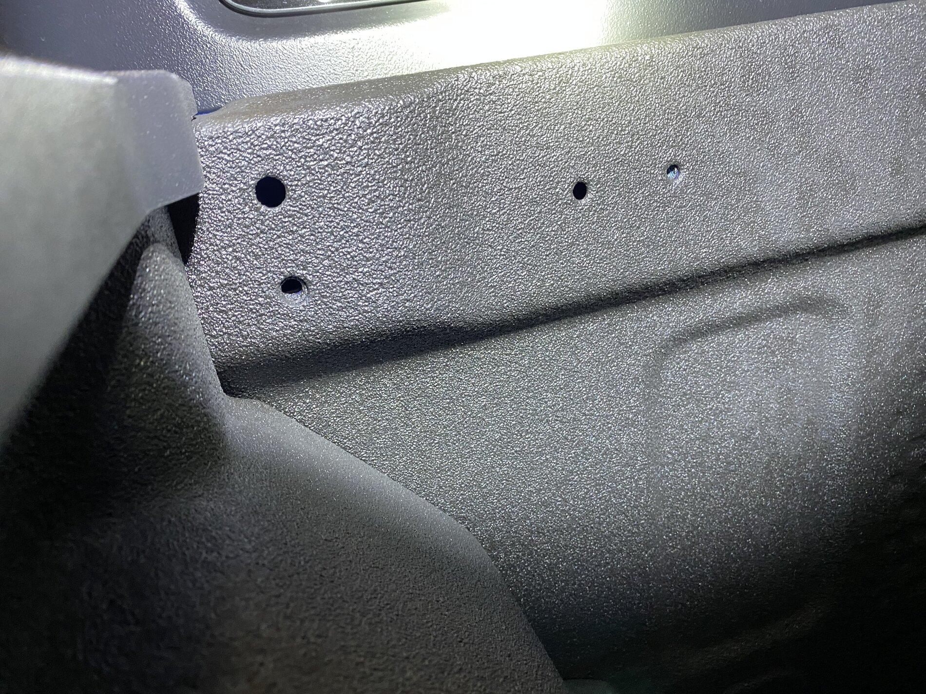

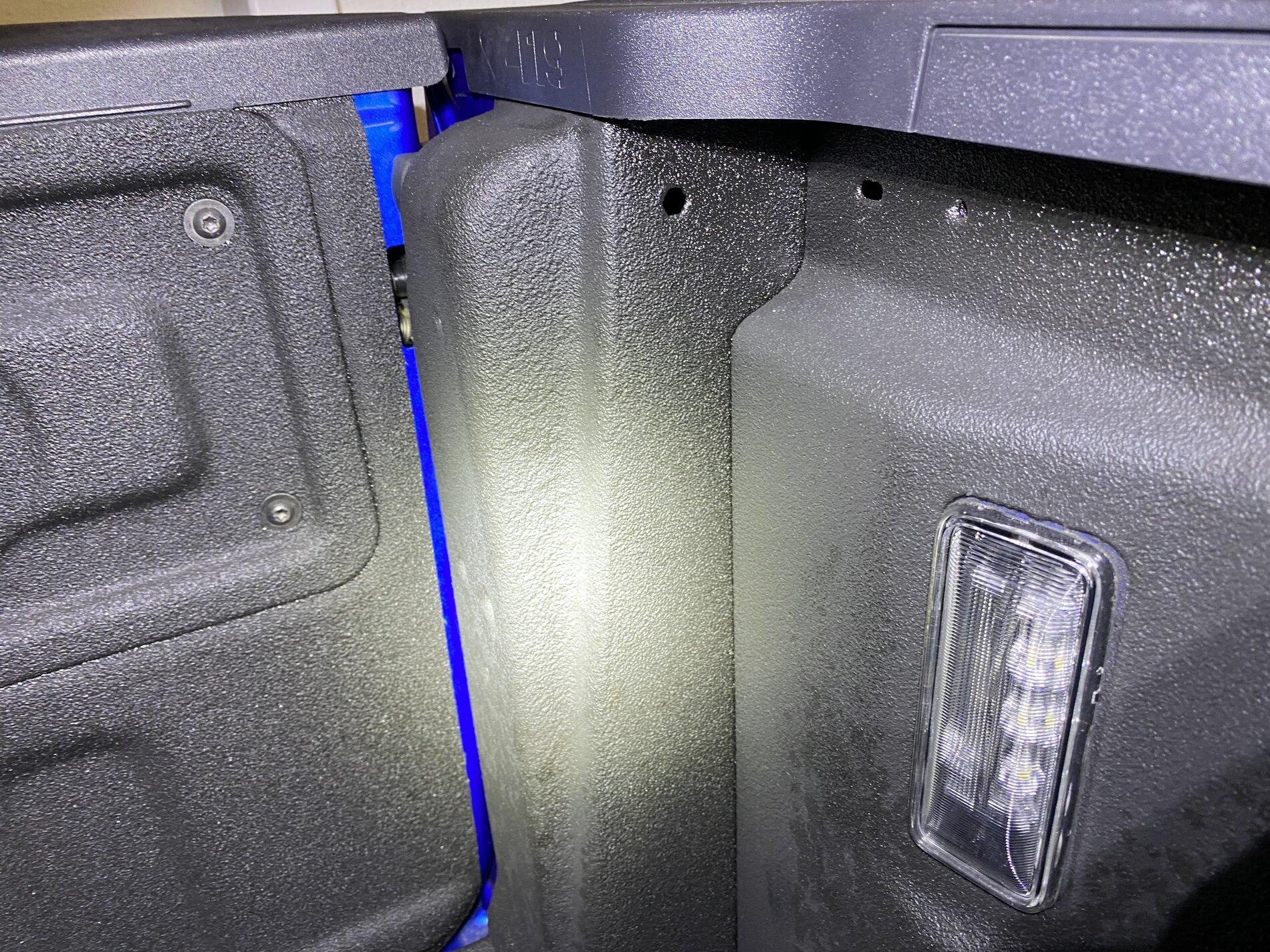

Do mine look ok for mounting? There are several holes with threads front, back, and side, just need to find out their size and use a tap to clean out factory bedliner I guess.
you have the one threaded hole in the front. You’ll be ok with the hardware that comes with the cover. You’ll only have to use the expandable nut in the top hole.
For the rear, you have to cut out those trapezoid pieces above your led light. You just trace the lines that are etched in already and it exposes two threaded holes that will mount a bracket where the lever will latch into
