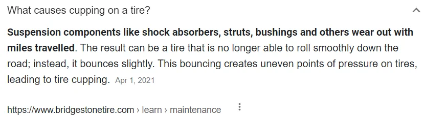

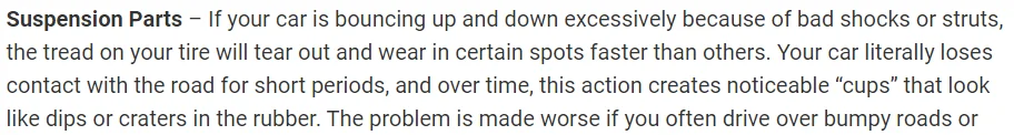

From Goodyear ->
Jeep Gladiator Worn out shocks already? 1672882307328

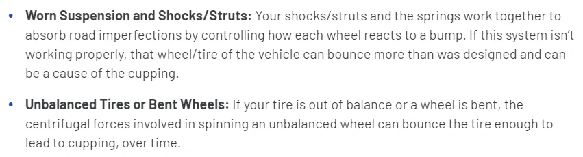

shocks are the common theme - tire sellers and tire companies -
Jeep Gladiator Worn out shocks already? 1672882486234
Shocks and springs keep the tires on the pavement. If the shocks are weak the tires can literally bounce as they travel. Of course imbalance can be a cause but bad shocks have historically been one of the top things to check.

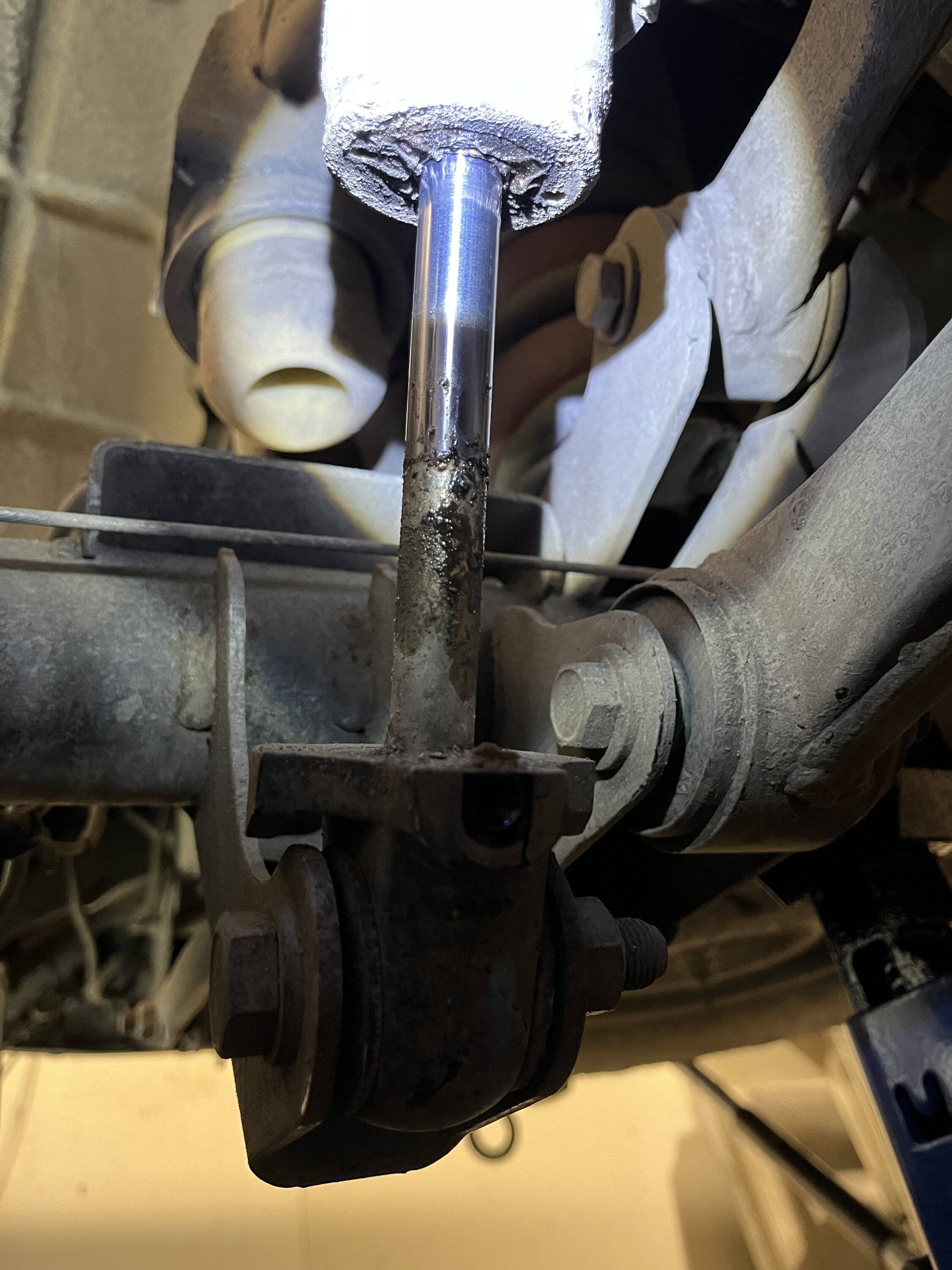

Had my JTR in yesterday. My passenger rear shock is seeping/leaking but not dripping yet. They said it has to drip before warranty will replace. Hate the bouncy ride, it’s a matter of time before I find me a set of bilsteins. Looking at the 8100’s.
Jeep Gladiator Worn out shocks already? 3CDA6E92-1ADC-4306-91D8-8410613B017E
Jeep Gladiator Worn out shocks already? 2FBF2B9F-8399-42B6-88C1-9DC437FDAD84
AstroZombie
Arthur
Aug 18, 2021
1,567
1,733
Poway, CA
Tech Support

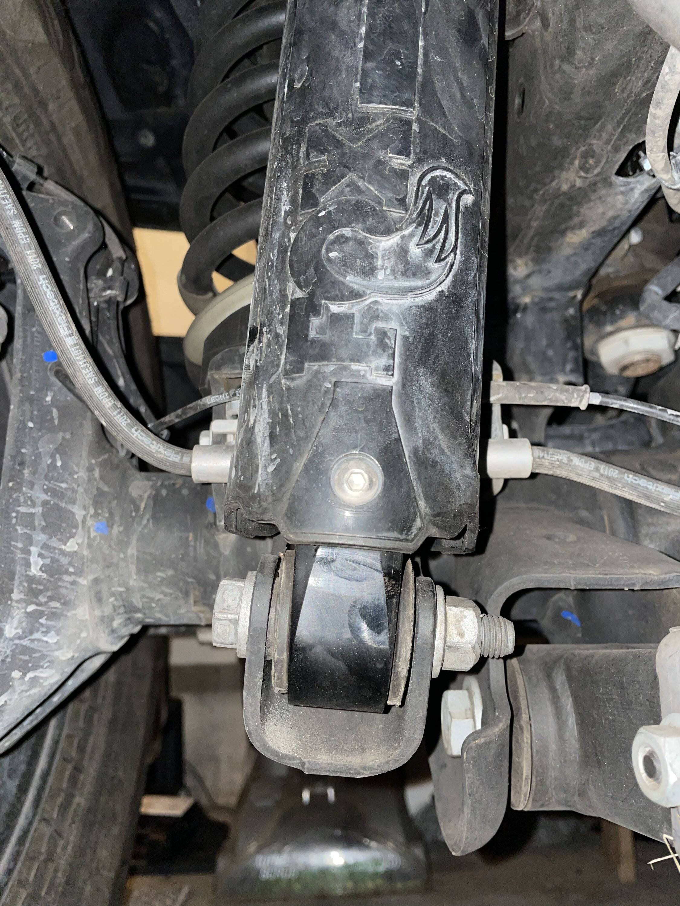

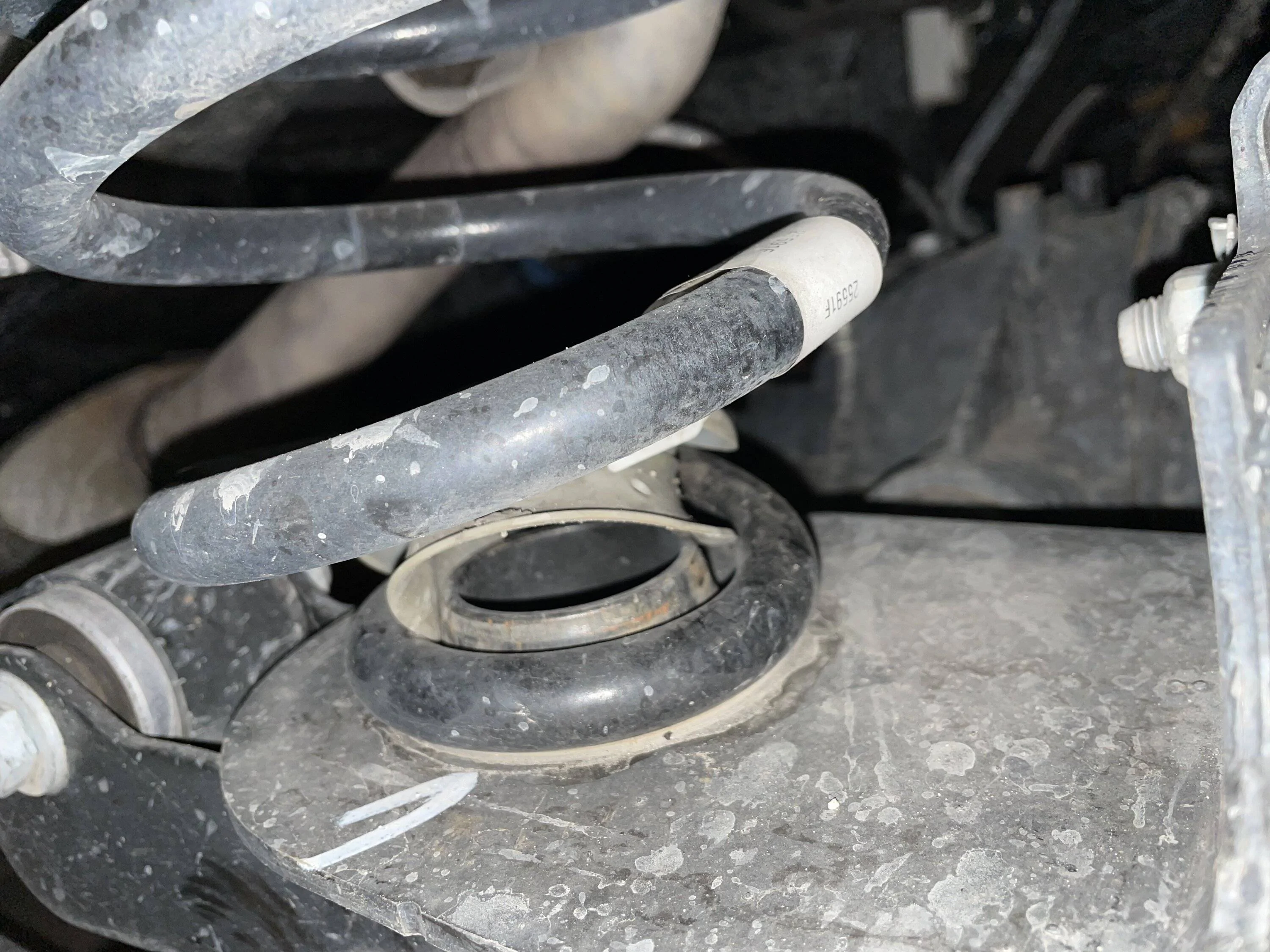

Does the truck bounce once and stay planted or give a bit of boing boing boing after a good bump? If getting nowhere with the dealer unbolt the lower mount and check yourself, take a video if they can be compressed by hand with little pressure. If still good these shocks will take some good effort to compress and bolt back on at ride height. How much sweating are you seeing at the seals?

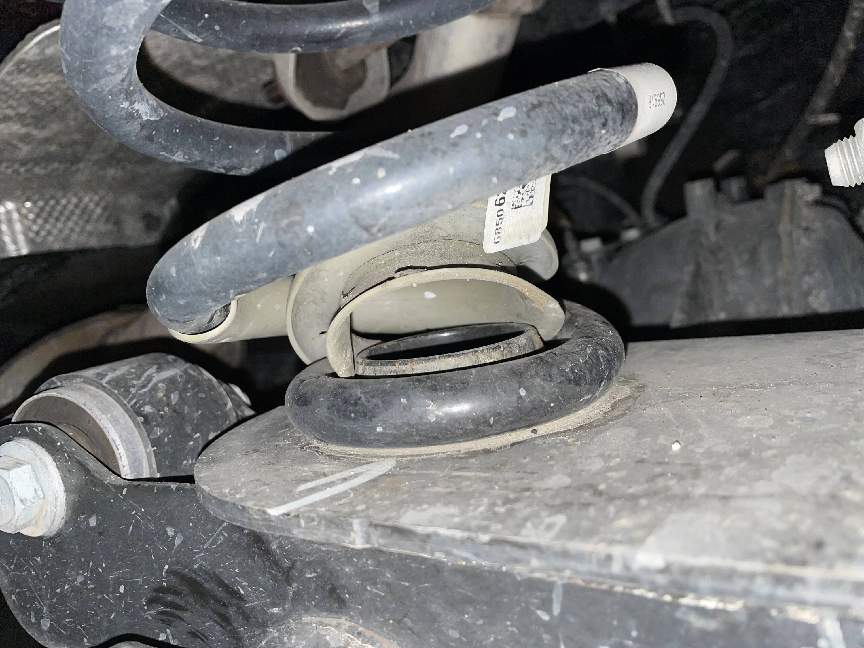

mine doesn't bounce and it only does it when it compresses and on left side from what i can tell. Dealer told me it was because the springs weren't seated on the perch. They had to loosen the suspension and reset everything.

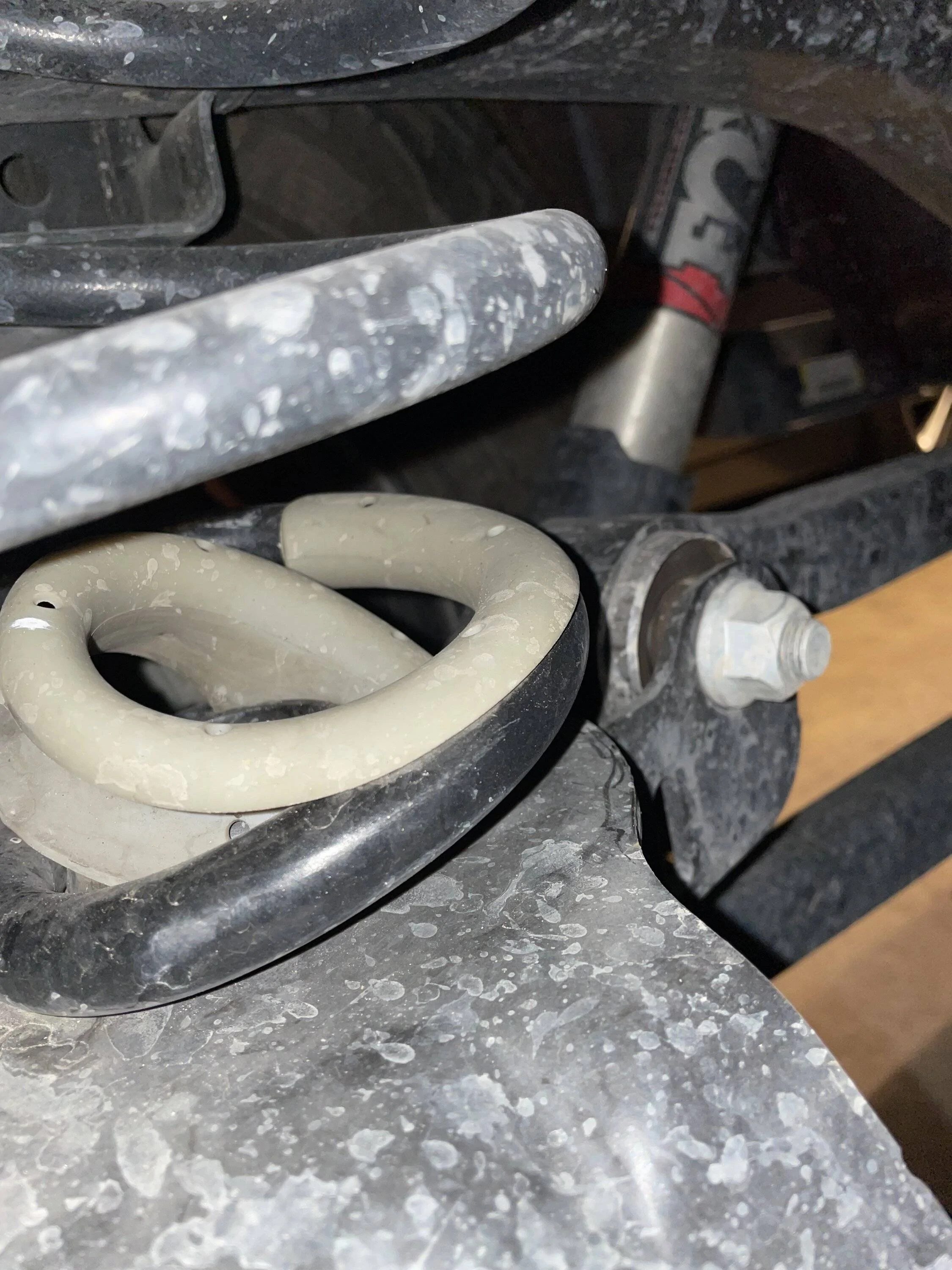

I added a video of the sound. Shock looks normal. Plus I found the plastic silencer (I guess) on the left rear spring is coming off. Any opinions?

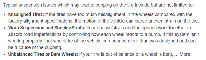

I also found this explanation on the internet when looking into the weird front tire wear I had on my 2020.
