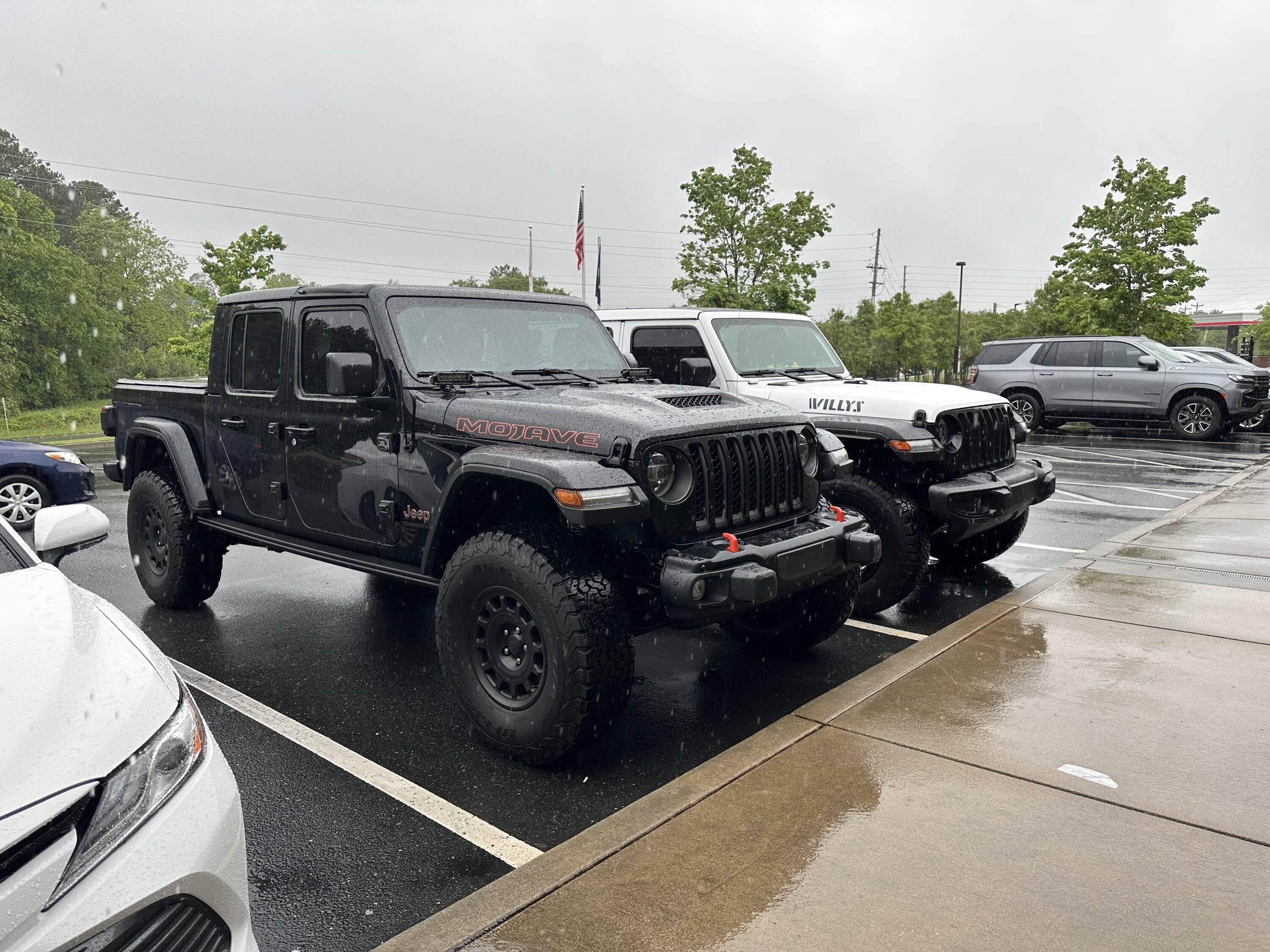

Felt steering was getting a little loose, turns out its a worn OEM drag link.
Shop said, hey as long as you’re replacing it, think about the tie rod and maybe the sector brace.
‘The truck has been perfect, should I bother with that or save the cash? I guess will I really feel a difference? Wouldn’t I also need to relocate my steering stabilizer (another $)?
Thanks all

I have no direct experience with high mile JT front ends.
Your tire size looks reasonable. The front end parts on our JTs are huge compared to our segment competitors. By a significant margin. I wouldn’t see any danger in only replacing what’s loose for the time being.

Appreciate the reply. Low, 9500mi. 37” “light” KO2’s, geo brackets, never even “wheeled” yet.
Shops said they’ve seen worn drag links on nearly brand new ones on stock everything, just a bit of a weak point and known issue.
That’s my thought as well, fix it and keep going until anything else appears as it’s been extremely good to me so far.
