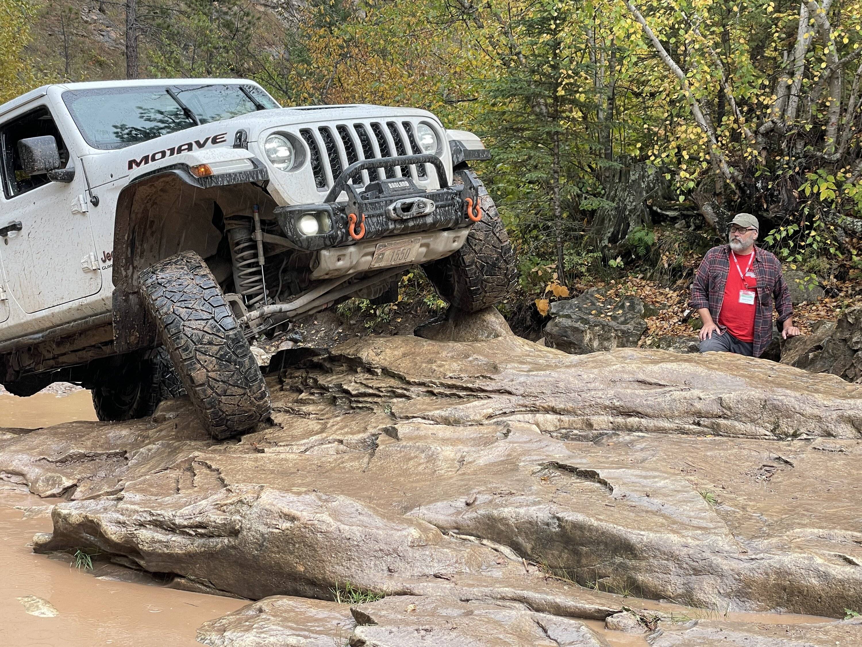

I just got to use a 10.5" set I installed on our Gladiator Mojave for the first time today. Length is perfect for our Mojave with its Mopar lift and shock extension brackets. Articulation is pretty limited on the Mojave with its Mopar lift compared to our Rubicon JL with its Metalcloak lift, so these easily allow for the full flex this suspension is capable of. And it is now a whole lot more capable of flexing than a Mojave without disconnects.
These are the neatest thing since sliced bread. They are so easy to disconnect and reconnect again. And they really improved the slow speed ride in rocky terrain for our Mojave. I like the way they stay disconnected, instead of the constant Reconnect-disconnect-reconnect-disconnect of our Rubicon JL with its electronic nanny burdened disconnect.
