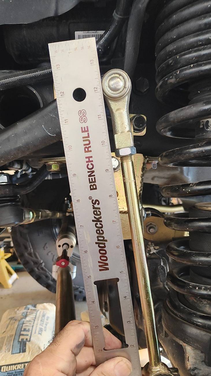

Started the install this last Saturday. This is the Metal Cloak quick disco's in place measured at about 12 1/4" center-to-center:
Jeep Gladiator X IMG_20240901_105450177_HDR

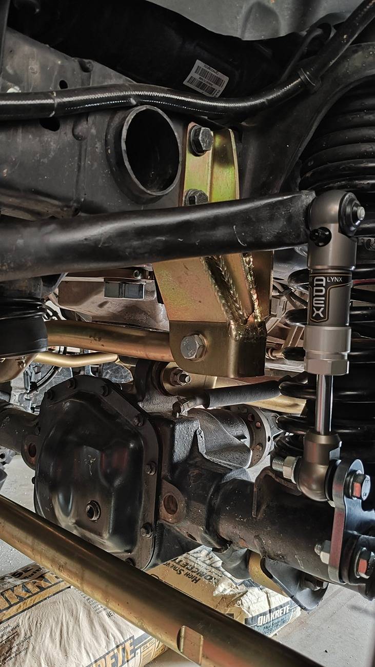

I placed the airLYNX in position and found they would place the sway bar in a parallel position in relation to the frame:
Jeep Gladiator X IMG_20240901_111724267_HDR

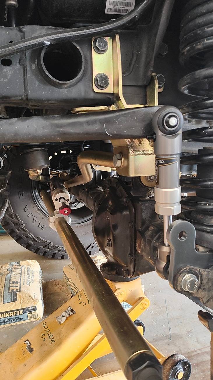

I wanted a little bit more upward angle and had a set of Synergy sway bar link relocation brackets that I bought when I was headed in a different direction with my lift, initially. Now the sway bar sits at a better angle for my liking, about 15-ish degrees:
Jeep Gladiator X IMG_20240902_135737635
As mentioned, my lift sits at 4" (Metal Cloak 3.5"). I imagine someone with a 2.5" actually lift would be in the right ballpark with only adding the airLYNX to the stock sway bar axle connection. However, if one likes their sway bar more parallel to the frame, then these would be good to around a 4" actual lift.
I have not had a chance to review offroad yet, but on for on road handling, I can't tell any difference from the solid links I had on before. I pumped mine up to 300 psi, sort of. I say sort of, because the zero loss pump I purchased still lost a small amount of air when I unscrewed the fitting from the valve stem on the airLYNX. They don't hold a lot of air, volume-wise. I estimate they are somewhere slightly over 250psi, and Apex says they need a minimum of 150psi on the street. I was testing them on the bench with my regular shop compressor and tire fill and at 80 PSI, upon disconnecting the air chuck, I measured 50PSI with my gauge, so they lost about 30psi.
