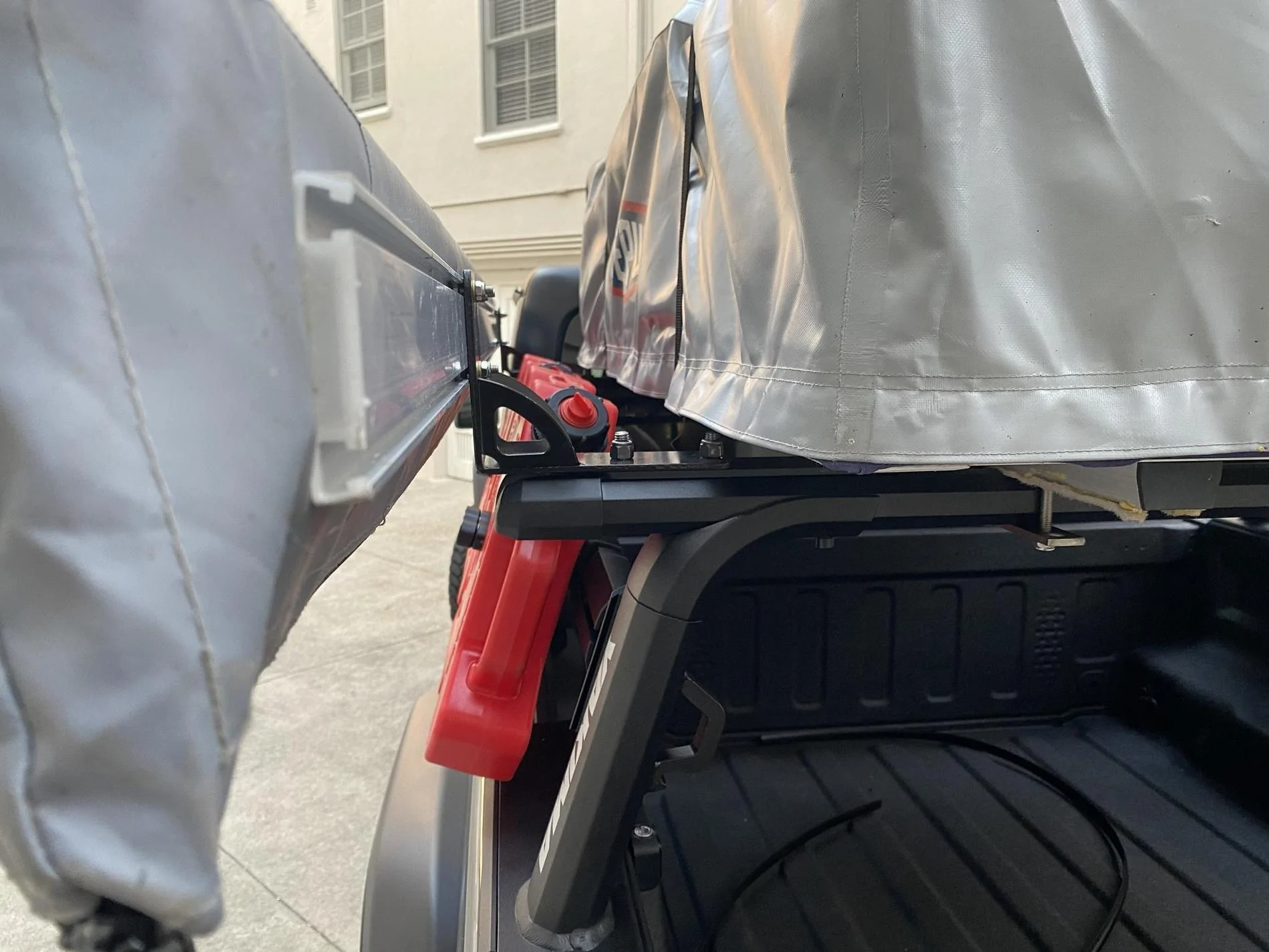

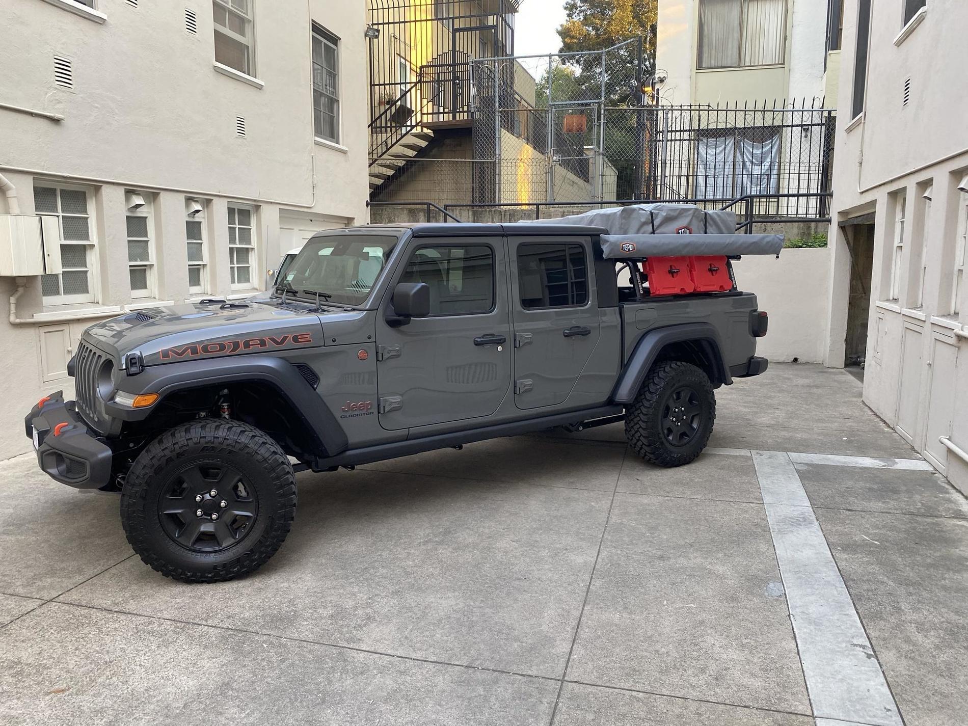

I mounted up my RTT today out of boredom, and to check how it fit on the new rack. Turns out, pretty good!
Jeep Gladiator Yakima Outpost HD with RTT, Awning, Rotopax 21TY71U
Also fit the awning, it worked out well with some t-nuts I found that fit the Yakima rails. Annoying that they have what seems to be proprietary rail/slot dimensions, but I was able to make it work. I used ARB generic awning brackets and spacer plates I had lying around. The Rotopax mounts fit just between the awning and tent, so I'm happy about that. They won't work on the tent fold-out side, they stick up too much with the mid-height rack.
Jeep Gladiator Yakima Outpost HD with RTT, Awning, Rotopax inYyJ2r
On the fold-out side I'd like to fit the recovery board mounts, but there's just not enough room to fit them on the Outpost HD and a short bed. I found a post on a Tacoma forum that has the same issue, so I'll see about fabricating up some mounts that make it possible to carry the maxtrax on the sidebar.
Jeep Gladiator Yakima Outpost HD with RTT, Awning, Rotopax 1qOw9q8
almost ready to do some serious mall crawling!

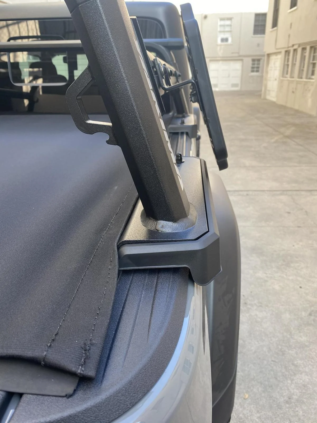

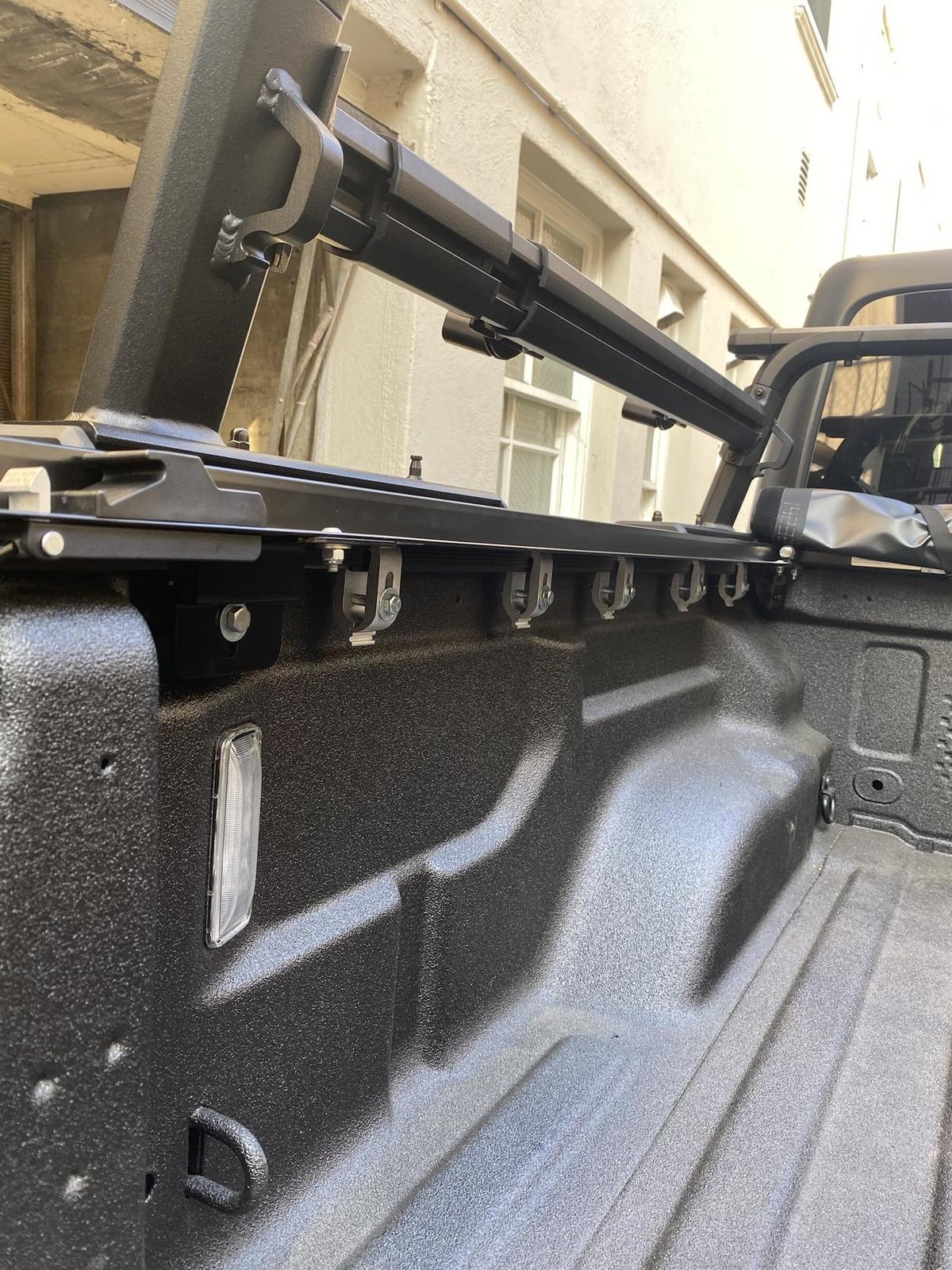

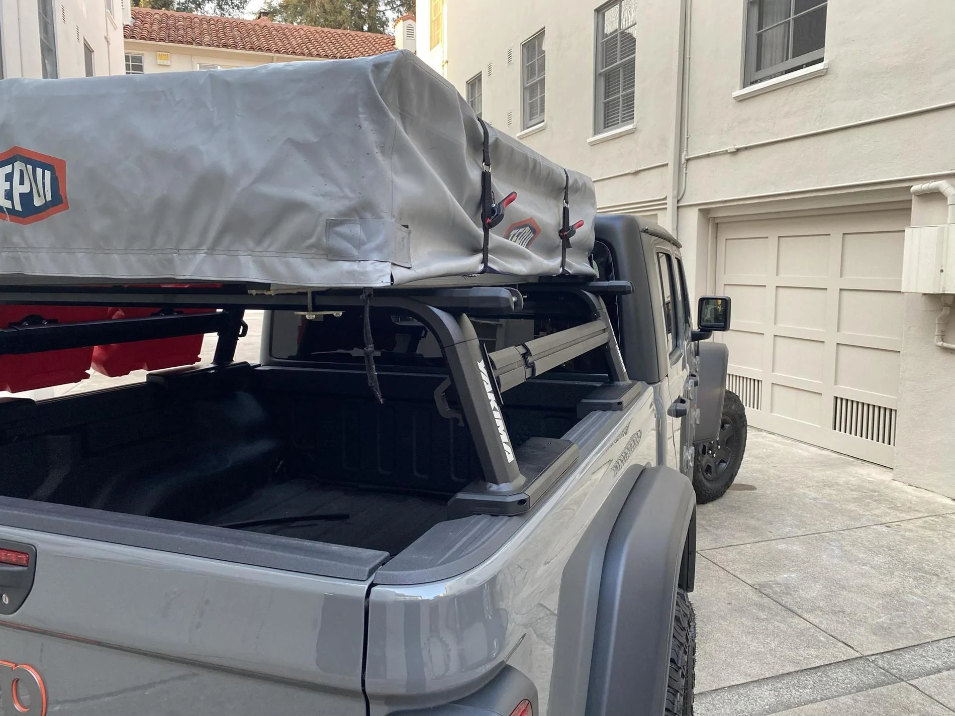

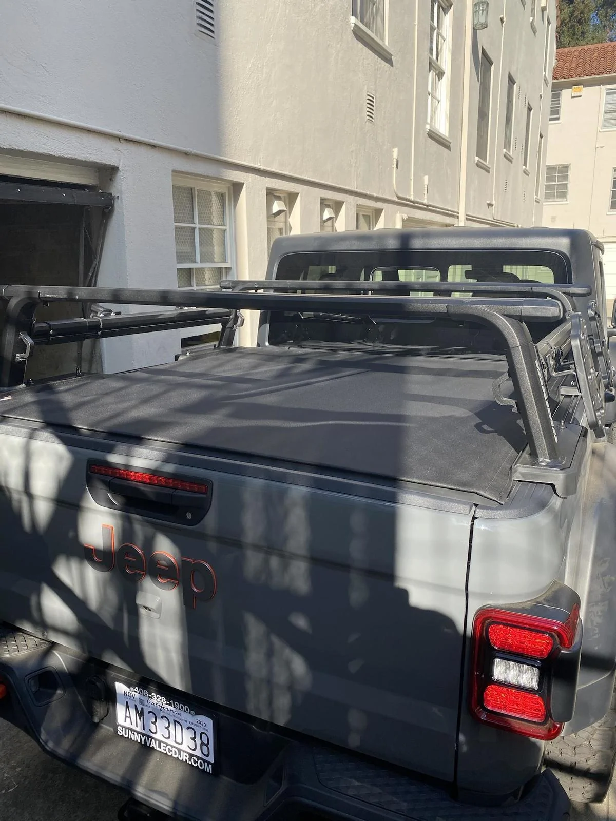

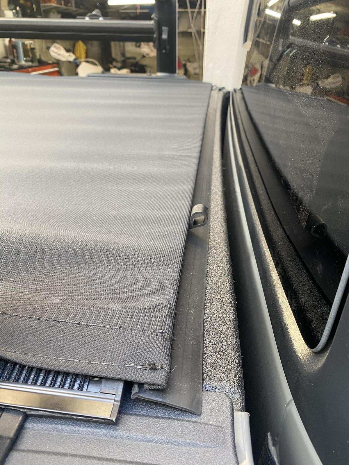

Ok so I took a bit of a gamble and ordered up a set of Truxedo rails, an X15 Tonneau cover, and the Yakima t-slot adapters. Goal was what everyone else is trying to figure out: how to have a rack and a useable tonneau cover. The results are mixed, but I'll give it a try for a while:
Jeep Gladiator Yakima Outpost HD with RTT, Awning, Rotopax HtNZDw0
Jeep Gladiator Yakima Outpost HD with RTT, Awning, Rotopax M2yWjqZ

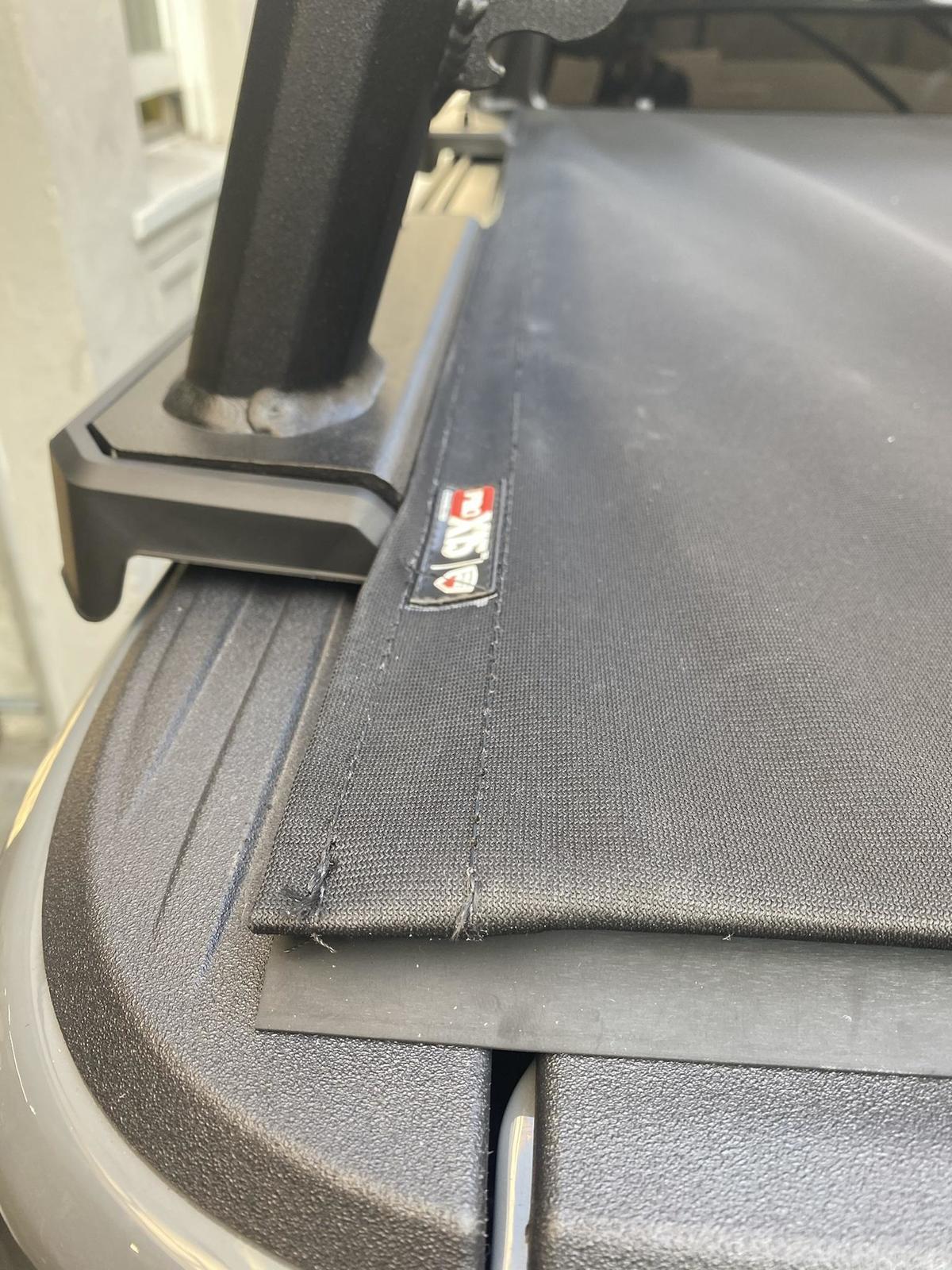

As you can see the towers for the Yakima rack don't quite clear the tonneau:
Jeep Gladiator Yakima Outpost HD with RTT, Awning, Rotopax h187dHf
Jeep Gladiator Yakima Outpost HD with RTT, Awning, Rotopax 5cCfvM2
Jeep Gladiator Yakima Outpost HD with RTT, Awning, Rotopax MQk6XRS
Jeep Gladiator Yakima Outpost HD with RTT, Awning, Rotopax 26JgB6H
Jeep Gladiator Yakima Outpost HD with RTT, Awning, Rotopax CoYG6Sf

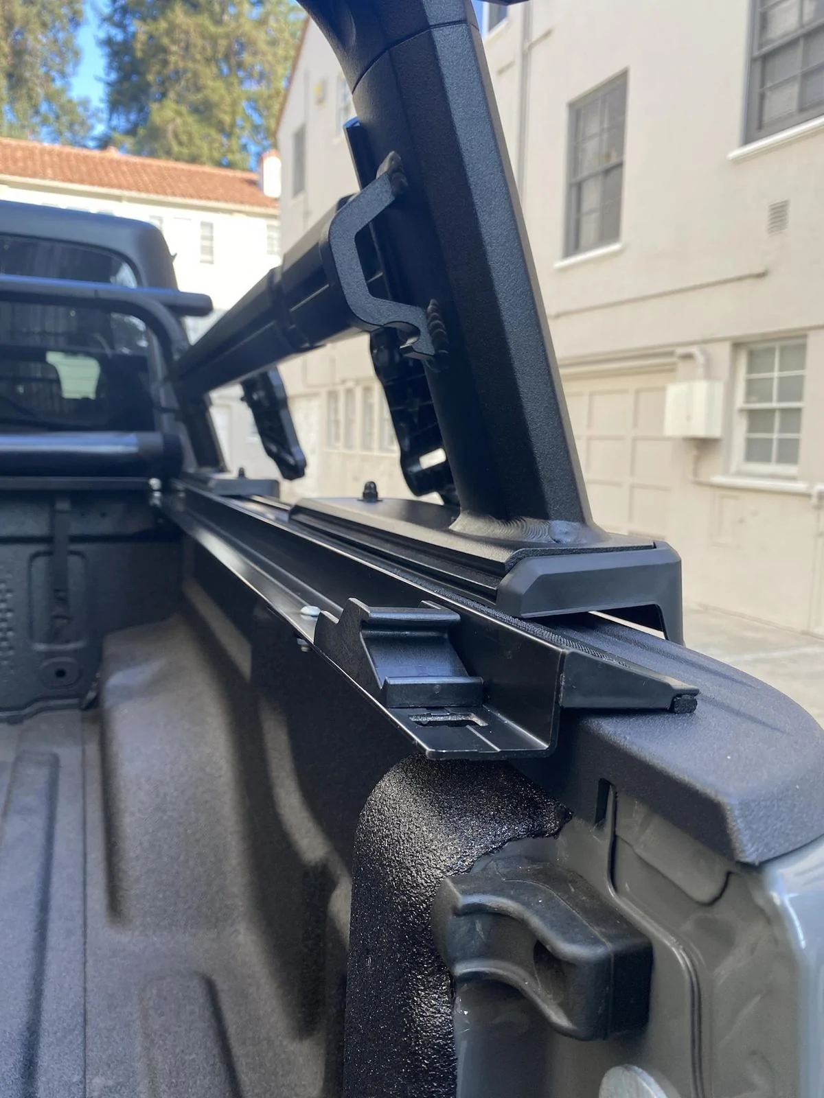

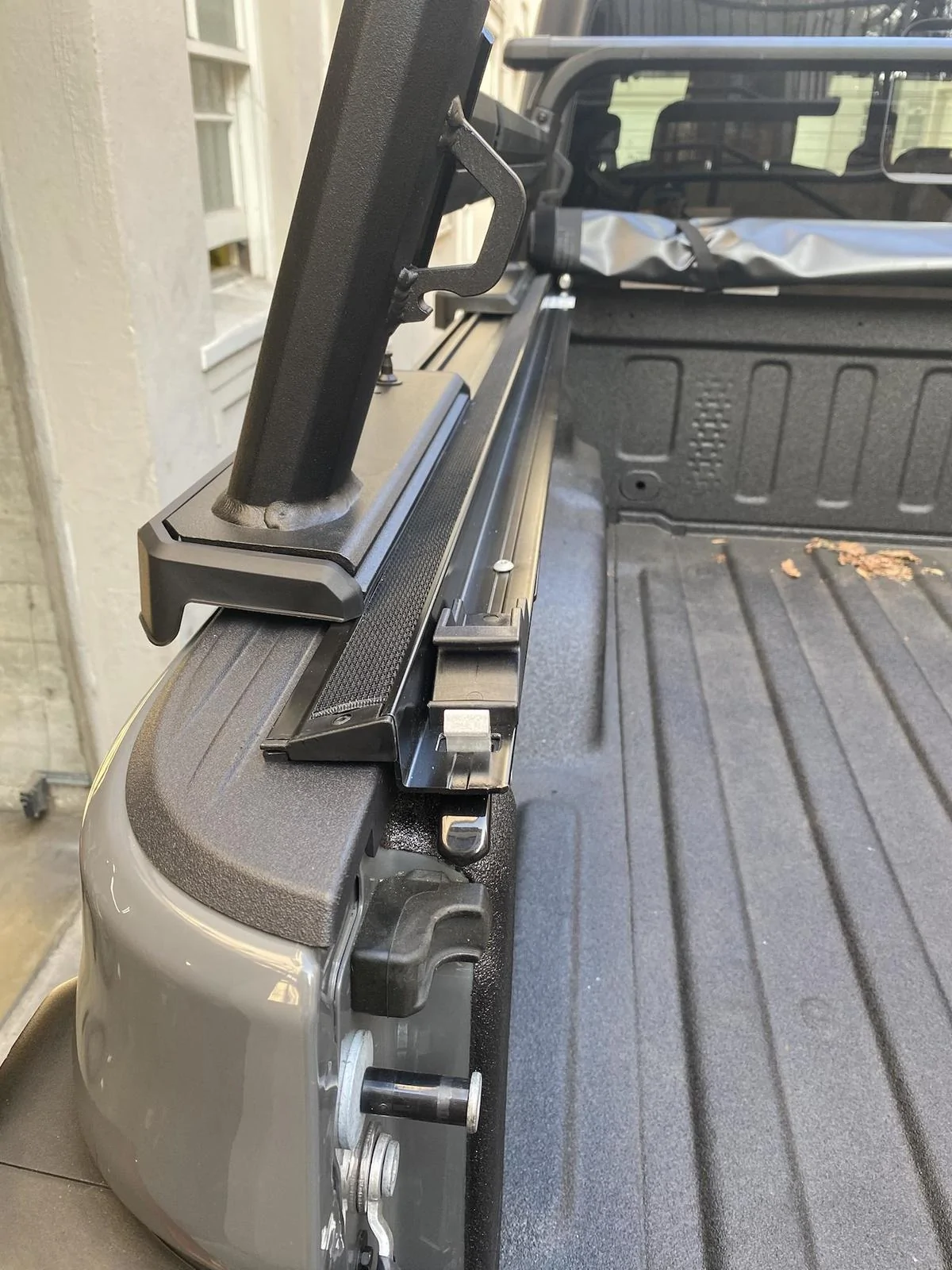

These clamps are what holds the top t-slot rail to the bed frame, the tonneau just has 2 brackets at the front and rear of the bed
Jeep Gladiator Yakima Outpost HD with RTT, Awning, Rotopax KHzzvvQ
The biggest drawback is a drastic lowering of the rated off-road weight of the Yakima rack with this setup, only 180lb according to them. It feels pretty solid, hopefully be fine for my RTT and awning.
installation was ok, nothing too difficult. With this setup the entire rack comes off with 8 bolts, so I can have full use of the bed if needed. I'm a little bummed the Gladiator version of the X15 does *not* come with the quick releases for the cover, something they advertise on their website, but this version is two bolts.

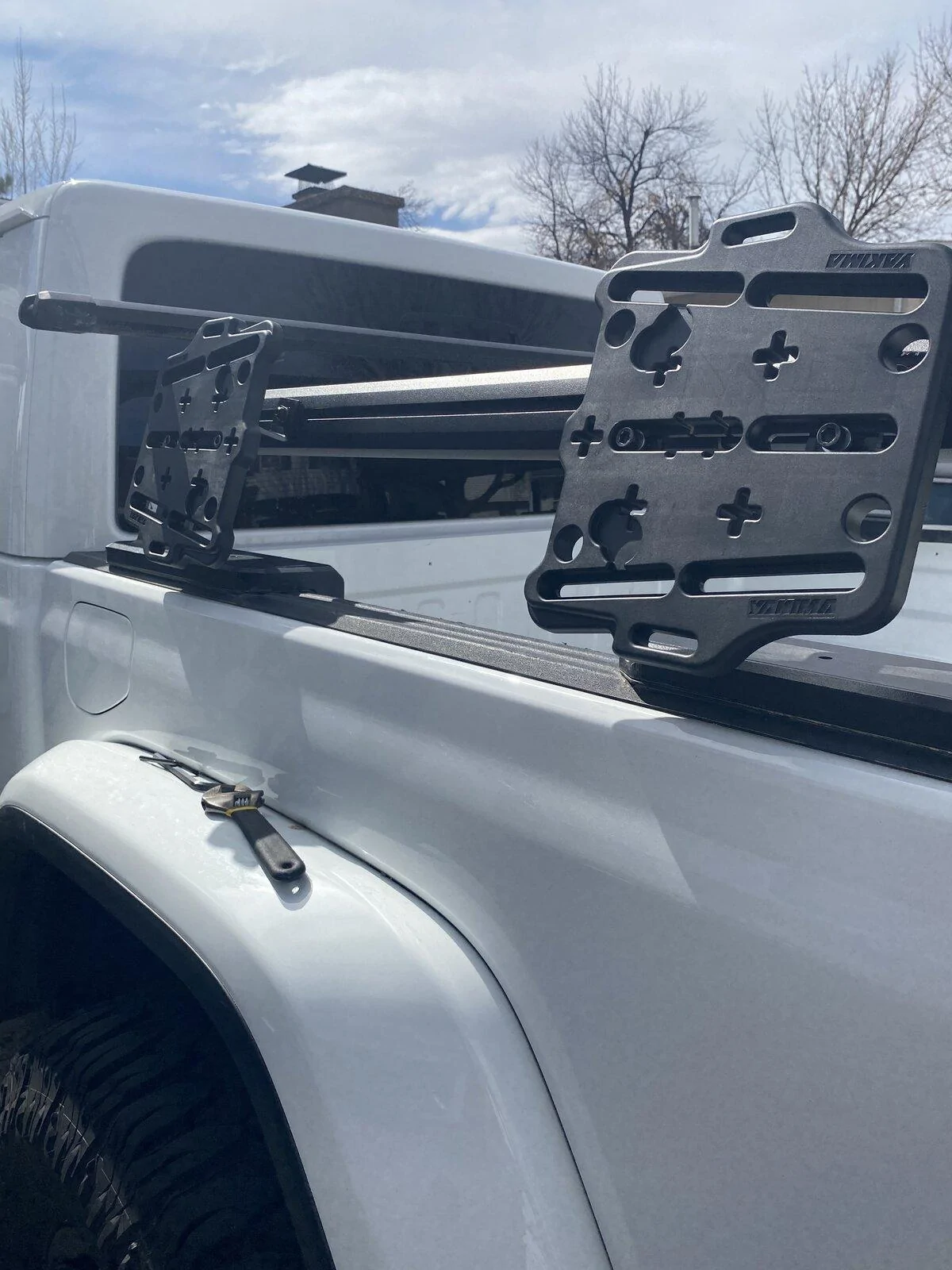

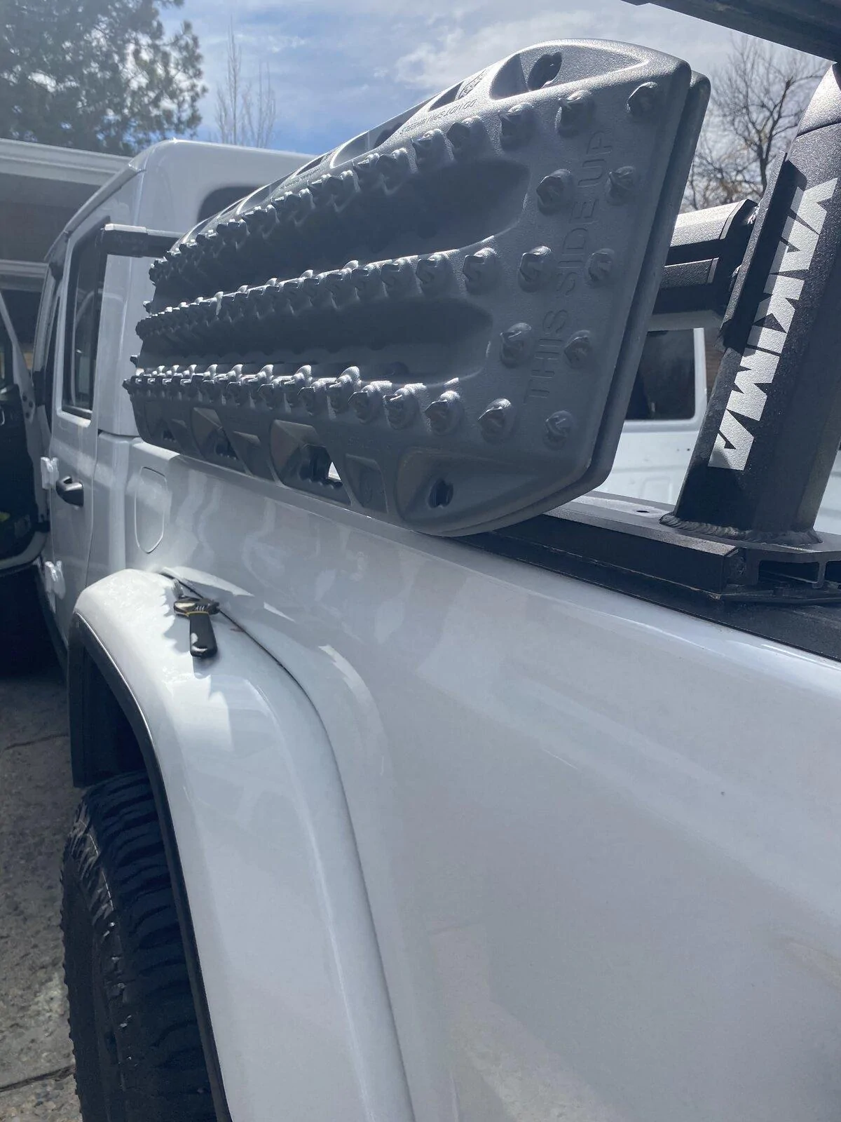

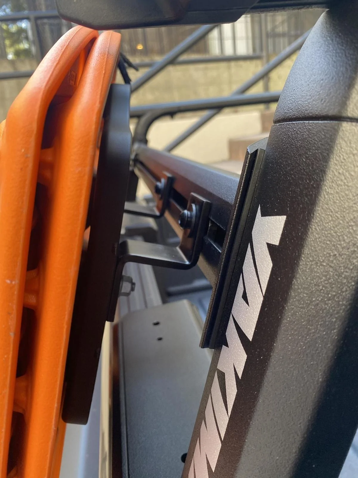

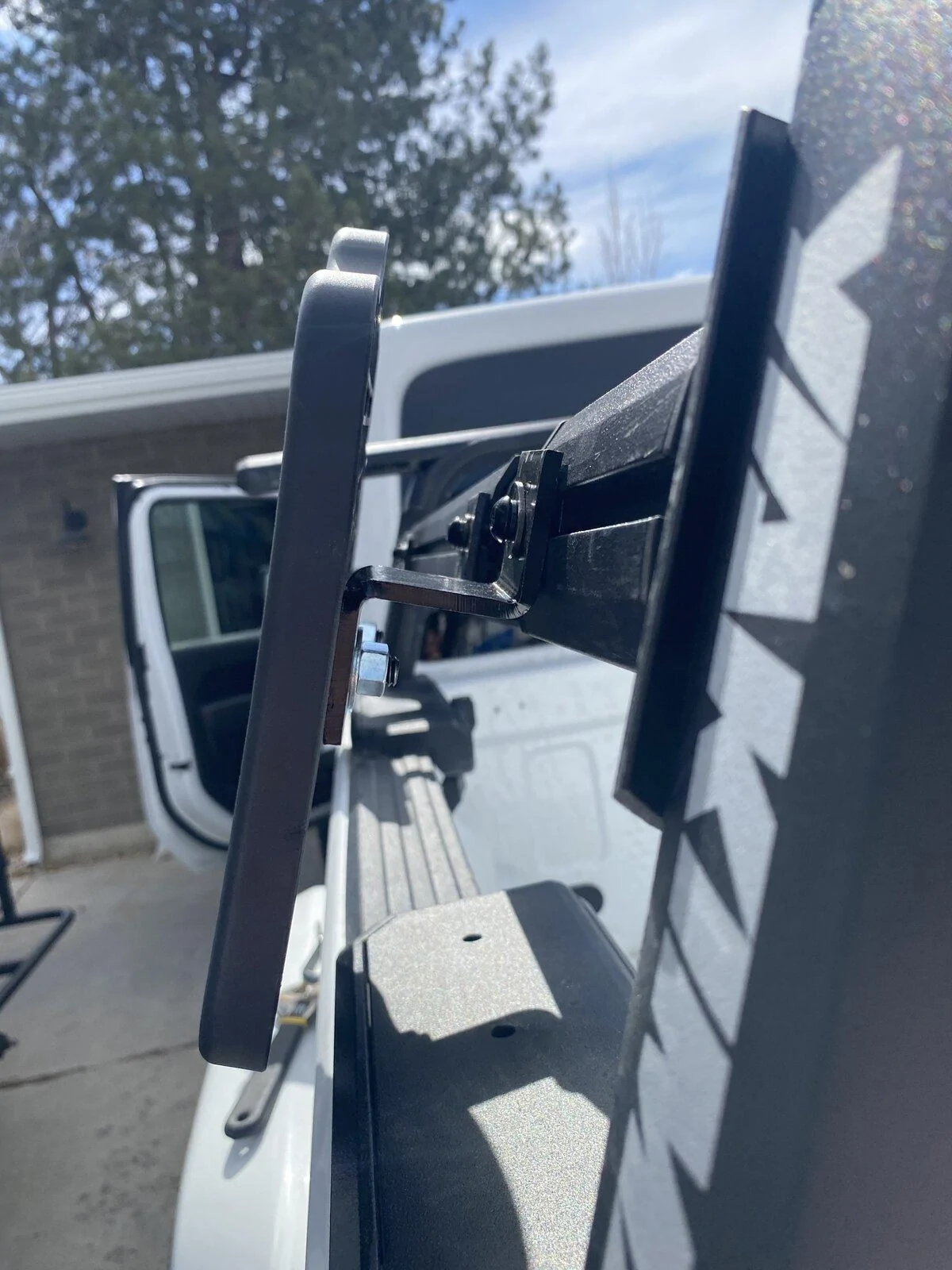

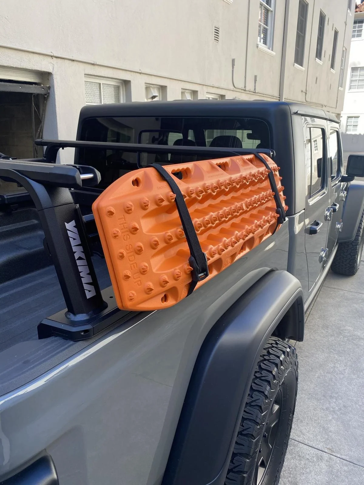

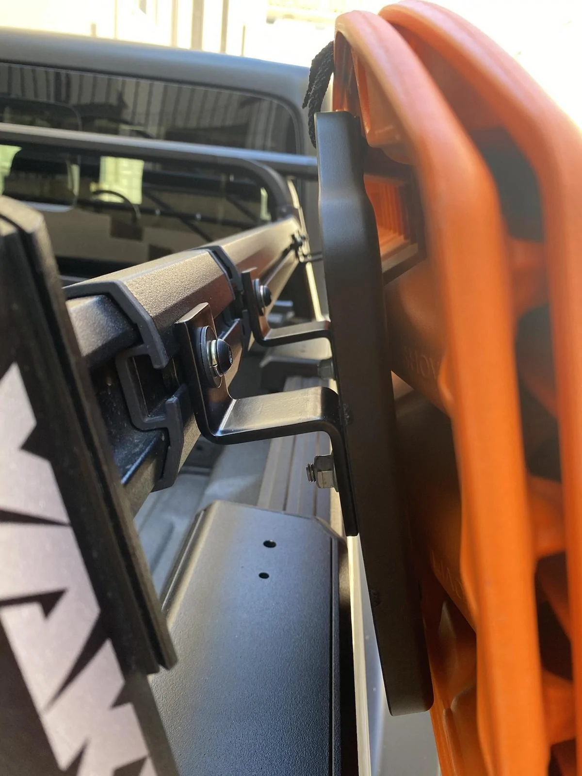

Just did the same thing today with Z brackets and maxxtrax on my yakima rack. Thanks for the pro tip!
Jeep Gladiator Yakima Outpost HD with RTT, Awning, Rotopax 28BCCFCE-A0D9-497A-8B68-DC8662196CD8
Jeep Gladiator Yakima Outpost HD with RTT, Awning, Rotopax 1342AB29-BD56-439B-85EB-83D757A0B90B
Jeep Gladiator Yakima Outpost HD with RTT, Awning, Rotopax 17F170D6-D383-49C1-A8DC-CDE6D003E206
