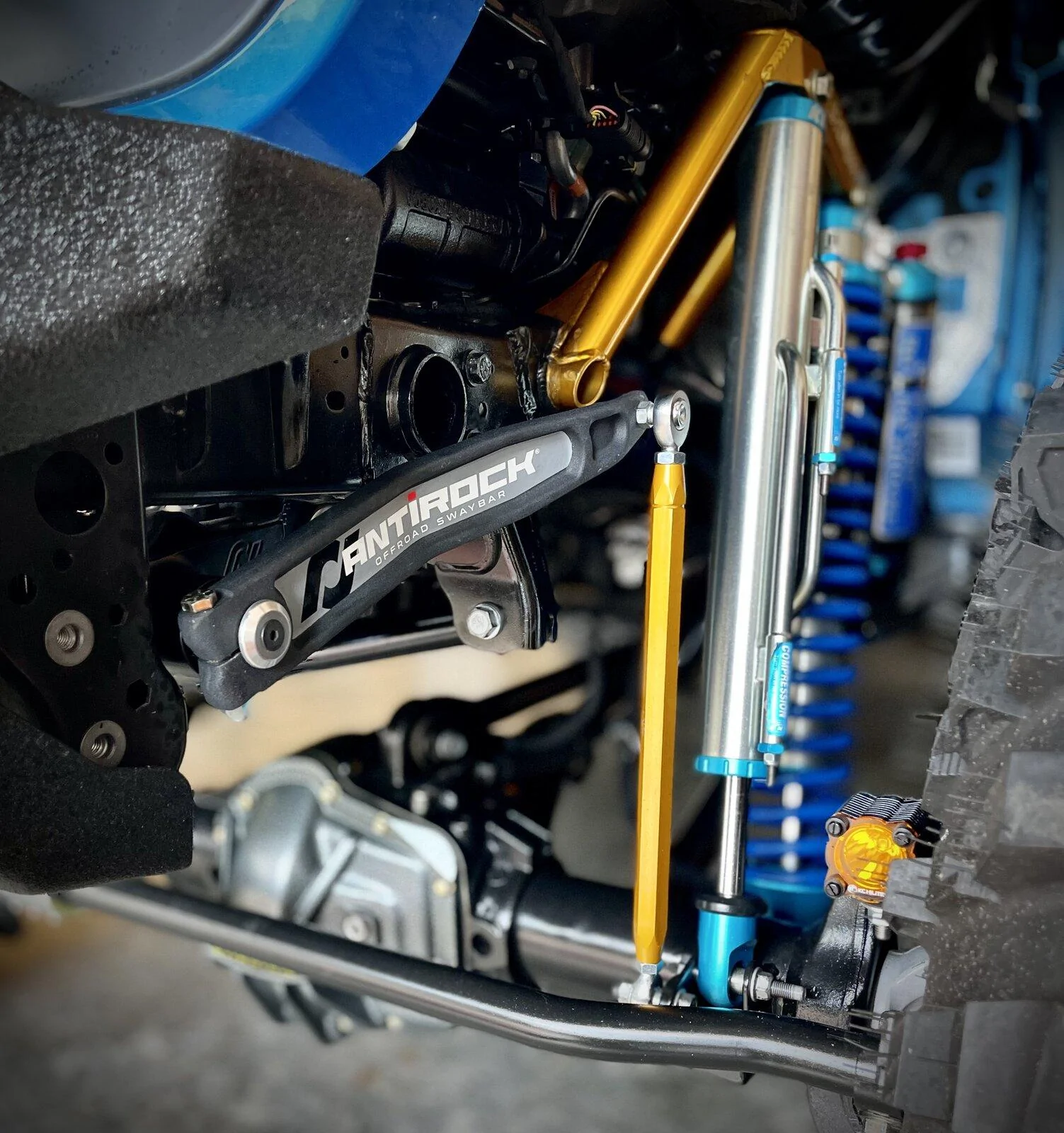

Unfortunately I haven’t had time to do much lately with our new shop being built.
I did find some quiet time to install a Antirock front swaybar.

On both builds I ordered the steering with the Axles. I forget what fusion uses, but it looks a lot like the RPM setup.
With the Dynatrac axles they included a Steersmarts Draglink and unnamed tie rod. I mounted a WTO hydraulic assist tapped into the factory box(PSC doesn’t make a setup for the Diesel)

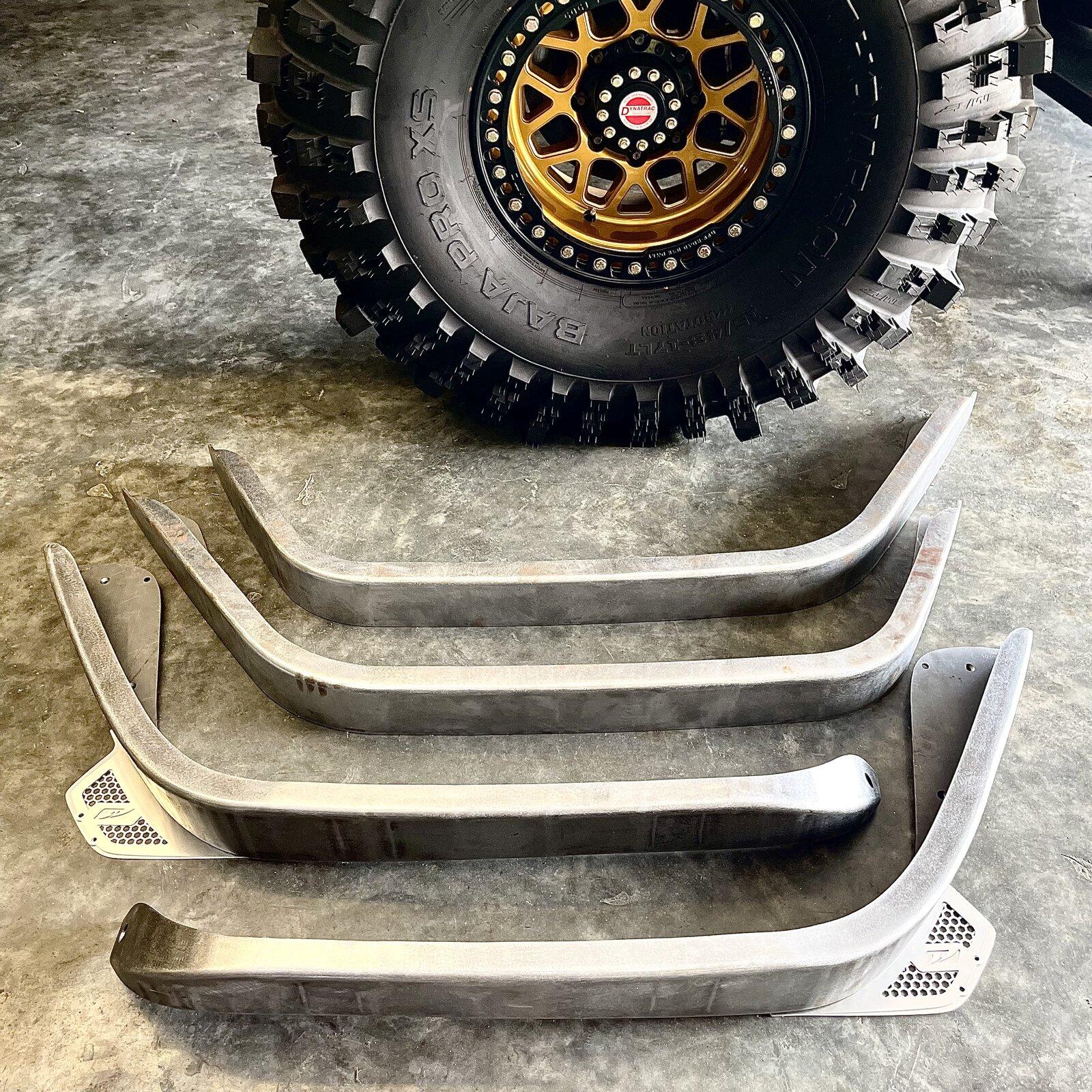

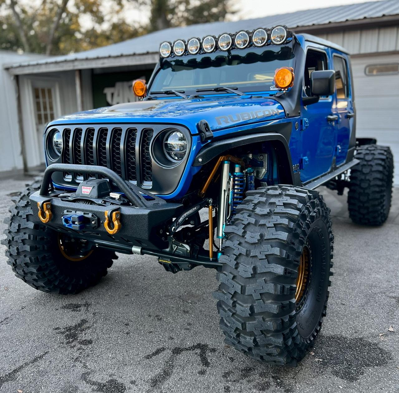

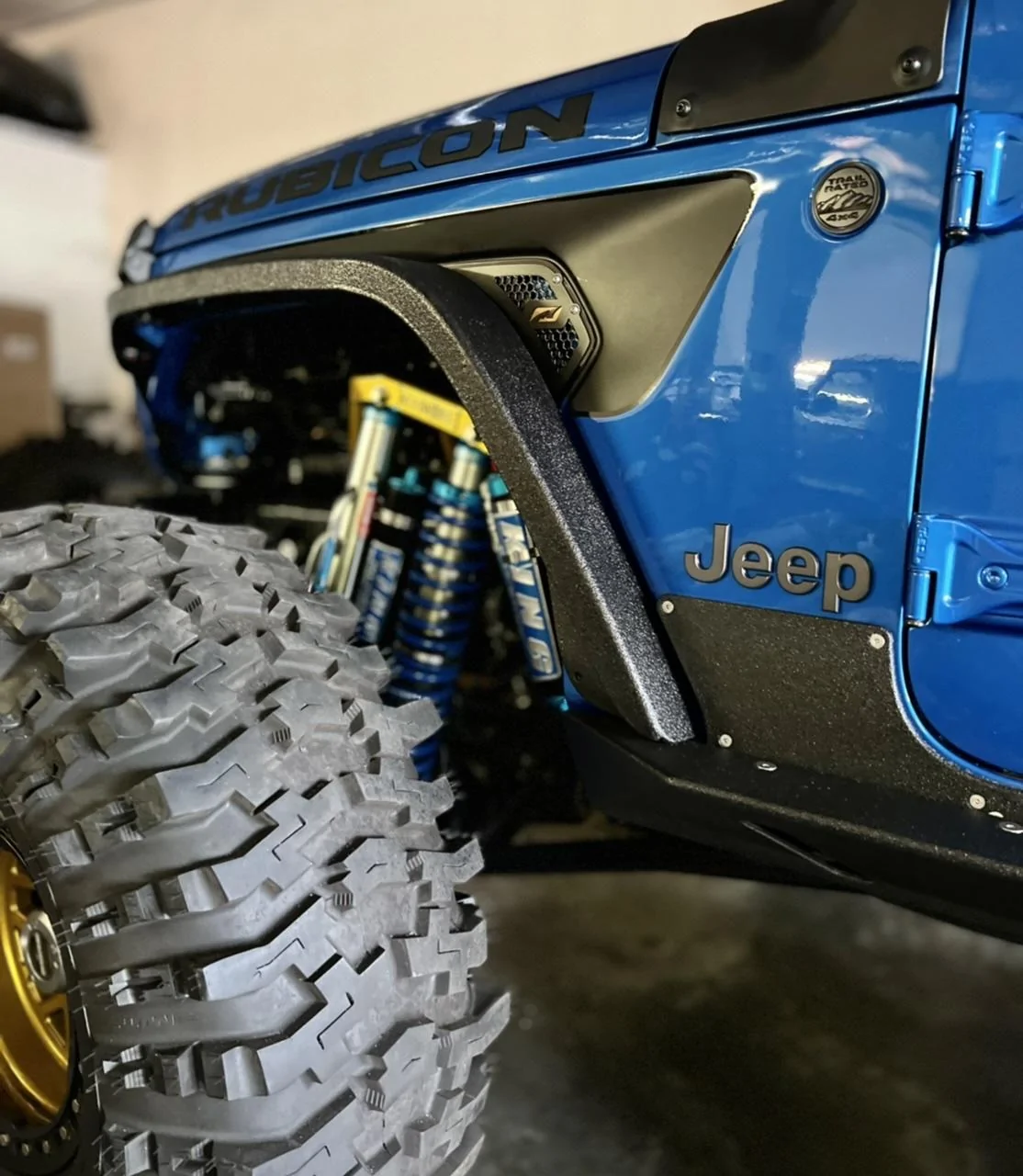

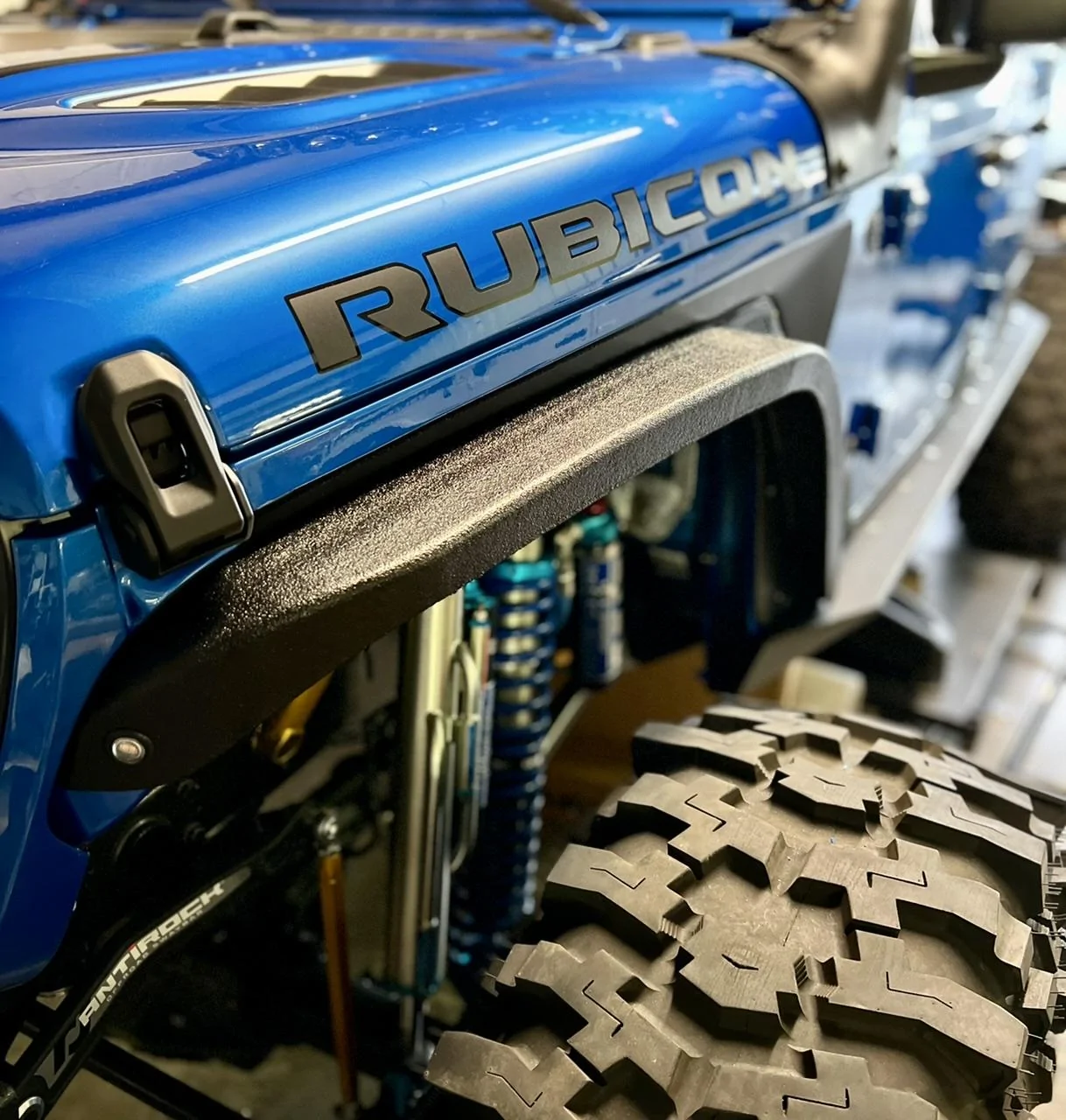

Haven’t updated in a while.
Installed a set of KBDBodykit fenders(will be switching to motobilt when the bed comes back from paint.) Fenders are nice for the price, but the lights leave a lot to be desired.
Also, Installed a DV8 bed mount carrier. While I don’t use my bed much the ability to pivot up and haul items below the spare is nice.

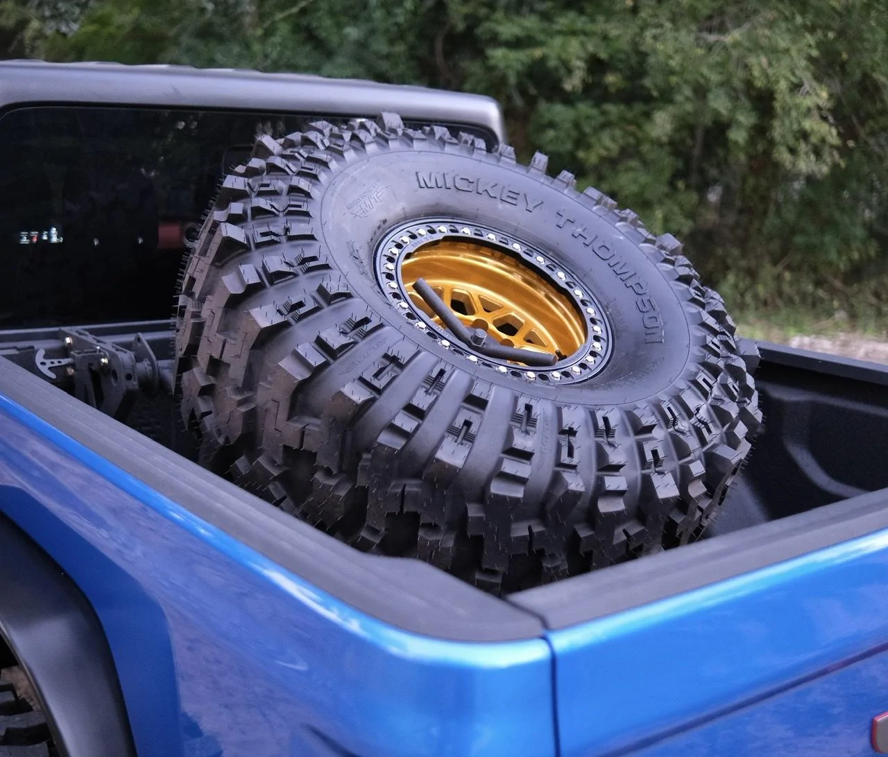

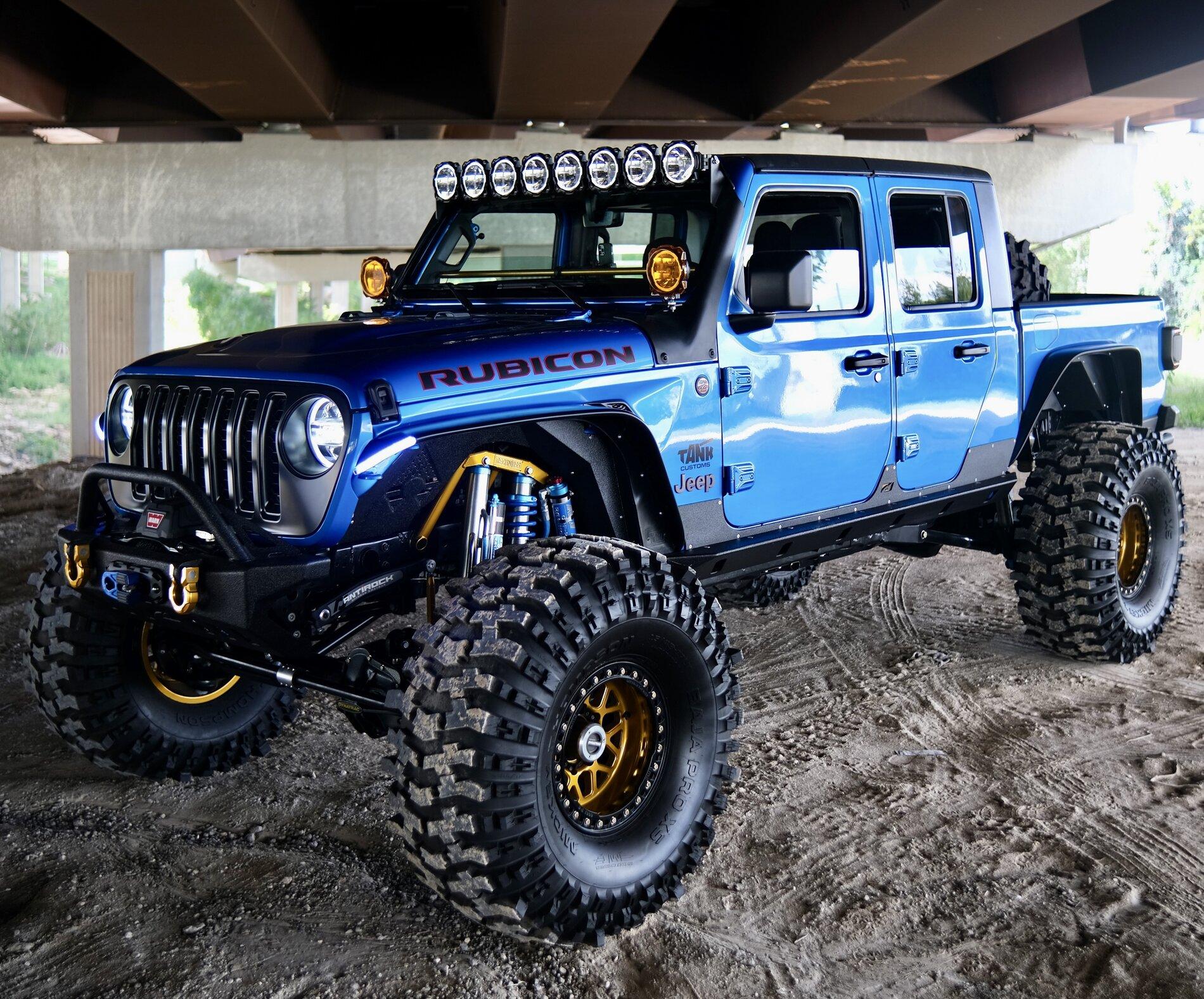

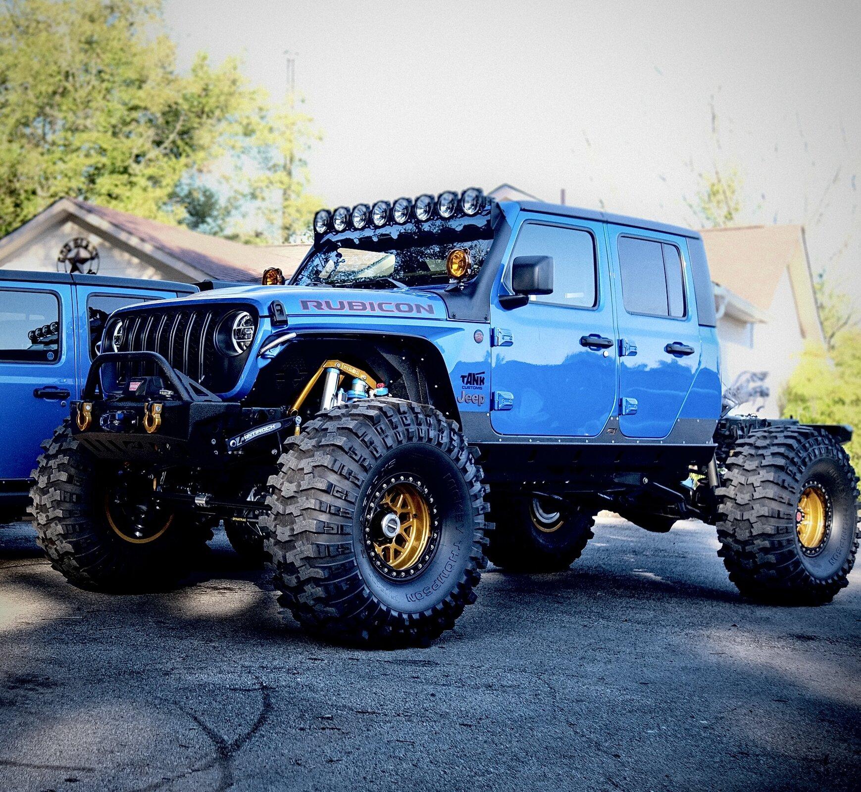

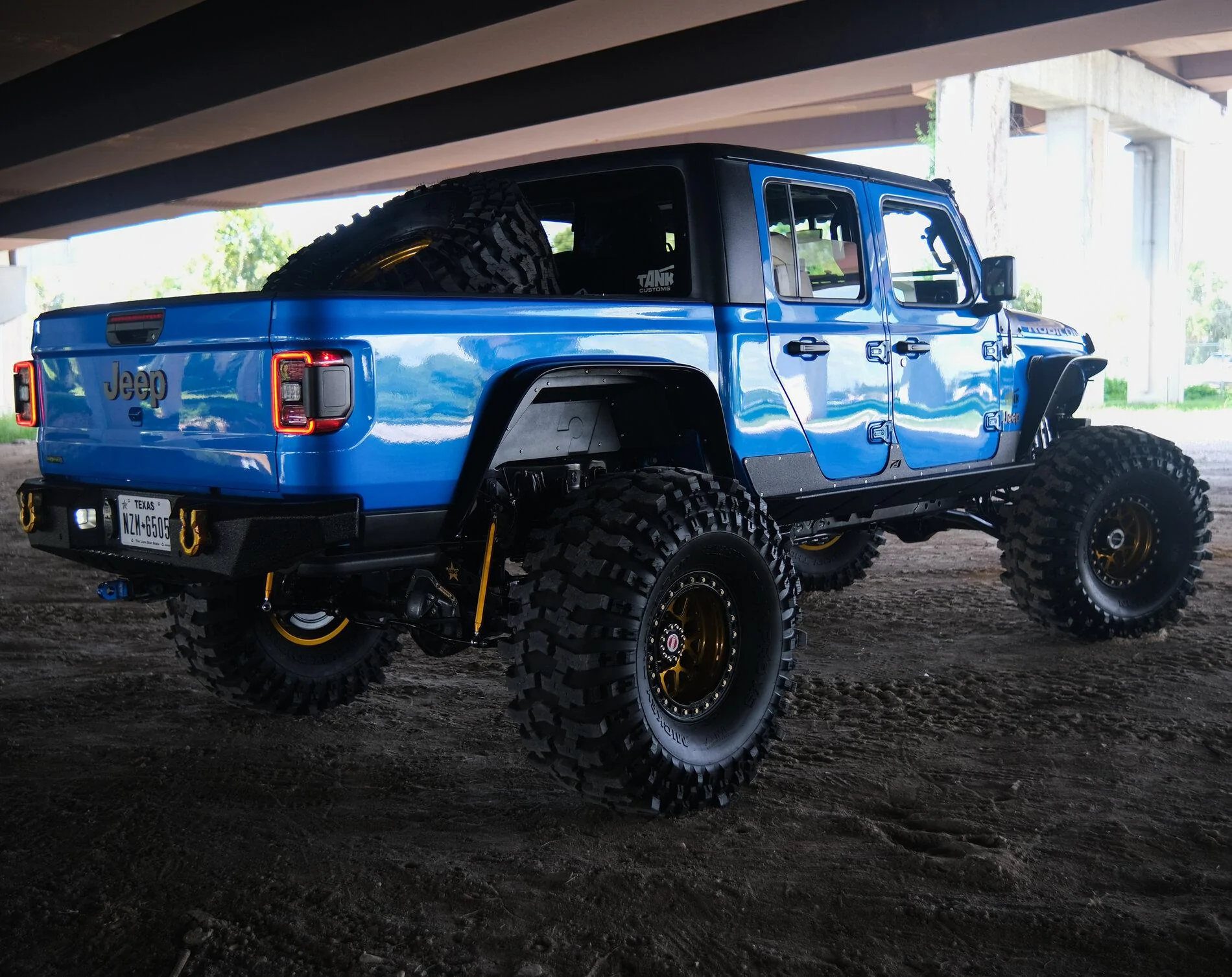

We removed the factory bed, chopped approx 10” from the frame and the new shortened bed is off to paint.
Jeep Gladiator You’re my boy Blue (Diesel JT Build) 21A0CCAC-CB7A-4097-8454-9B20E5505CF0
Jeep Gladiator You’re my boy Blue (Diesel JT Build) CA1051A8-513E-402F-BA75-D66F827C4615
Jeep Gladiator You’re my boy Blue (Diesel JT Build) BD86A893-704C-4DE8-8FB4-1C6C8049A6F4

Could you elaborate on why the fender lights leave a lot to be desired? I love the look of those as well as the road armor ones that you used on your last build. But I know you have said in other threads that you had a lot of issues with road armor. Also if you're switching to the motor built fenders are you planning to sell the ones currently on the Jeep?
TTEChris
TTEChris
May 17, 2017
504
1,731
Houston, TX
tankcustoms.com
2021 JTD
Jeep
The lens cover didn’t fit very well, and looked/felt very cheap. The running lights were closer to blue than white. So much so a car cruising next to me at night would have a blue hue. Other than the light the fenders fit and looked great!
Fitment was ok on the Road Armor fenders, I just had issues with the company itself.
Motobilt fenders are half installed. My bed should be back from paint this week, so hopefully I can install the rears. I sold the KBD fenders shortly after I removed them.

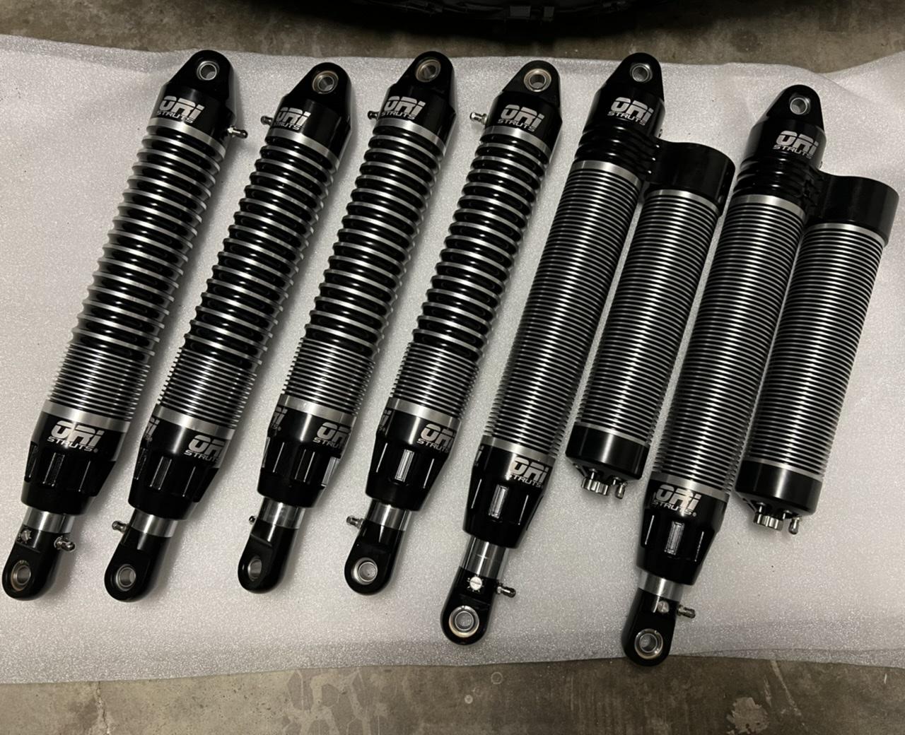

A little update to my build, was able to source a set of ORI’s(without waiting 13-14 months)
