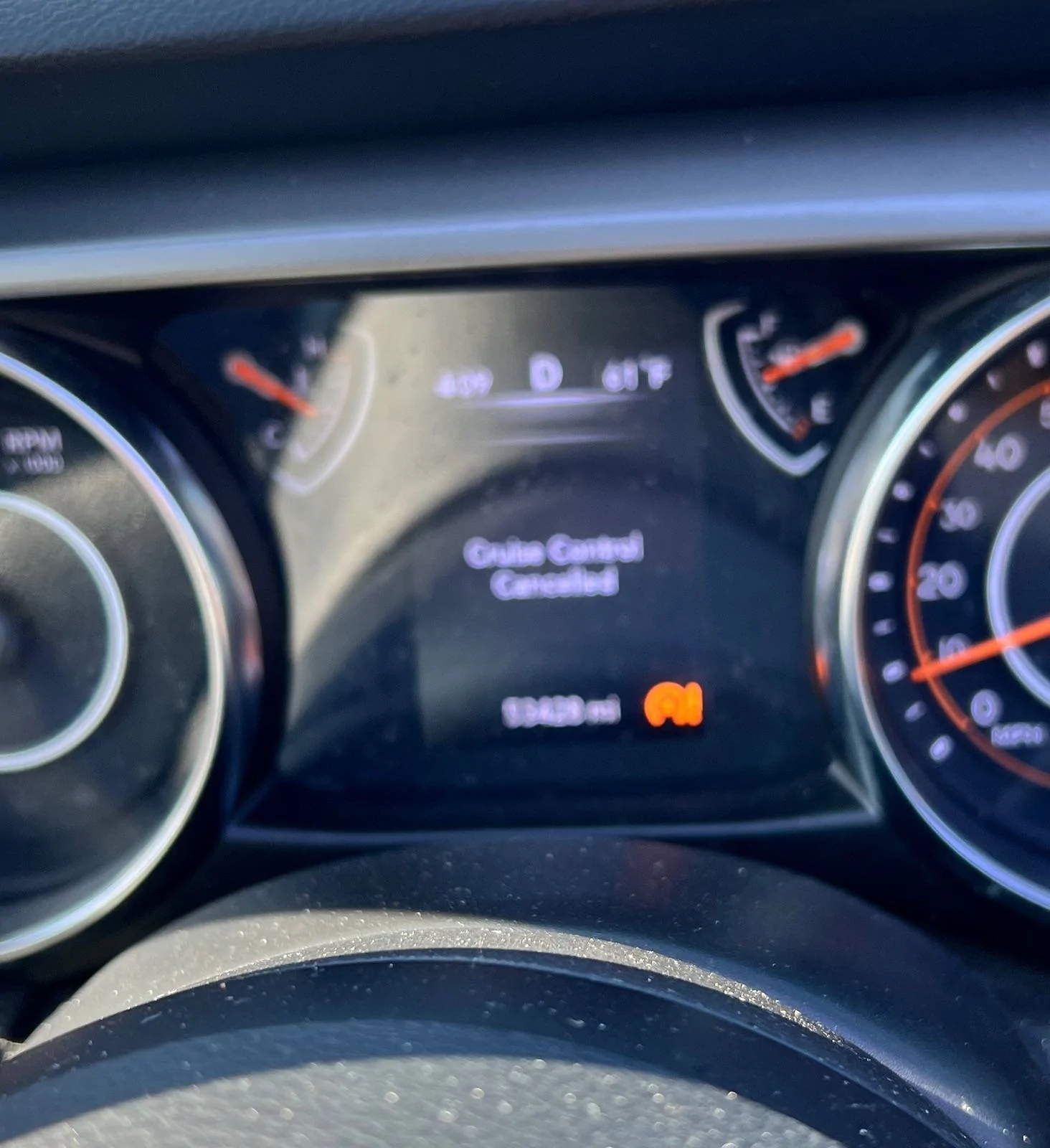

“Cruise control cancelled” every 2 minutes while trying to use cruise control now

Not ACC, i don’t have that installed on my jeep. It doesn’t act like it was cancelled because i pressed the brakes or turned it off vis the CC button. It kicks me out like theres some issue. Steering wheel hasn’t been taken apart before but i’m leaning towards the issue being in there because the lights on the steering wheel for the buttons have flickered a few times

Ok, you are eyes on it, so I will defer to what you see.

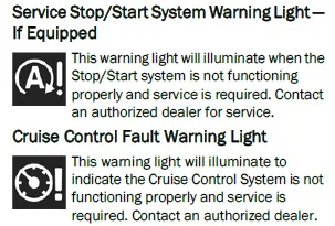

Just the owners manual shows the Start/Stop warning light to not be enclosed on the bottom like your picture shows. May also be different since you have the base cluster.
A better picture would be needed - but if he says it looks like a speedometer, it would be the lower.
The pic is really hard to tell for sure - it does look open on the bottom.
But only he can actually see it unless a clear picture is obtained.
He can use your perfect example and compare next time - knowing exactly what to look for and the difference between the two.
If it's the upper -it's going into self-preservation mode due to voltage issues.
If it's the lower - it's then a cruise issue - but if he's not using ACC, if it's standard cruise, there's no sensors involved, only the brake pedal "switch", clock spring and steering wheel buttons, otherwise, the cruise exists in the PCM if I recall.
Yeah it’s definitely that second light at the bottom. Haven’t had any problems with the start stop at all
