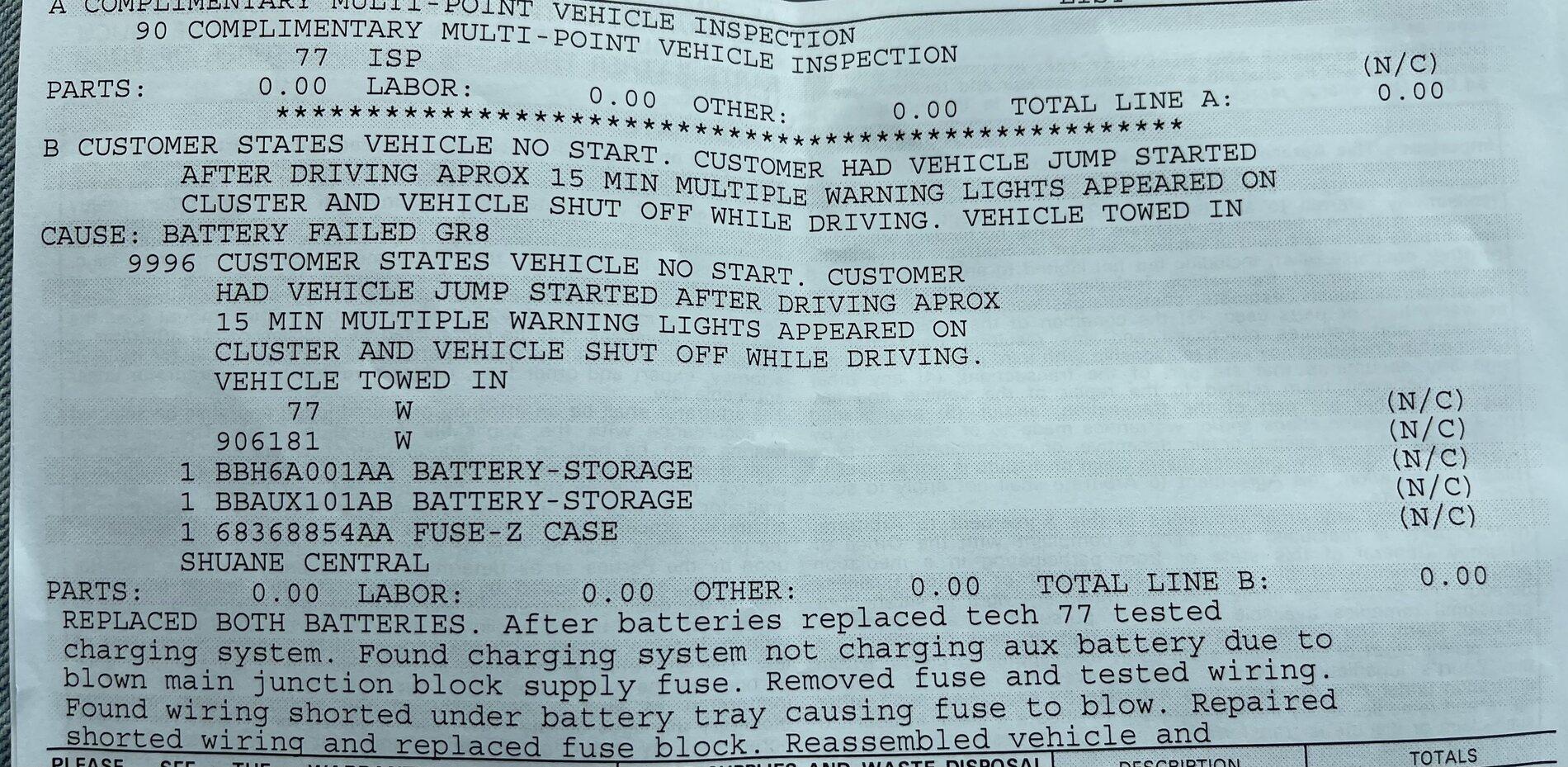

Dealership called today. Truck is all fixed up! They were busy yesterday and didn’t get a chance to call and tell me what was wrong with it but they called today. Both batteries were replaced, charging system wasn’t charging due to blown fuse and bad wiring. They fixed it up and ALL was covered under warranty! Truck is back home and I’m on my way back to work! Alternator was fine. Glad I didn’t spend the $1,400 at other dealership

You mean they wanted to REPLACE an ALTERNATOR that wasn't even bad - all due to a dollar's worth of fuse???? Really?
And batteries - not surprised. My wife had her 2018 Jeep batteries replaced under warranty. Dealership didn't even flinch, told them the symptoms, they fixed it and said "we've seen a lot of that lately".
Holy cow! Buy that tech a meal or something.
Yeaaa my mind is blown. I can’t believe that it was the batteries. I can’t believe the difference in the diagnostic. My mind is blown. I told them I appreciated them very much. My faith is restored. Not with original dealership though. Never going back
40,503
54,023
I was blown away at this situation - I always - always - diagnose before assuming anything.
First find out what the ROOT of the problem is, THEN find the cause of that - the second shop did just that. They performed BASIC troubleshooting 101. Is the alternator charging - and you test that at the alternator (depending on the system).
I had a MIL light come on a week after I put the 4.0 in my little car. I looked at the volt meter (it's got the rally pack gauges and console) and the voltage was low. No wonder the PCM was hollering. They don't like low voltages.
I checked and gee, the alternator seemed to be working. So I checked basic stuff. It had two 60 amp fuses handling the charging system. Replaced one of the fuses and that was that.
It hasn't blown since - so either it was ready to go (PCM, PDC, engine and harness came from a very wrecked Jeep - MAYBE the accident caused an issue) or I did something during the process of marrying the Jeep wiring harnesses into my original Eagle harnesses, who knows. But I systematically went through troubleshooting processes. That's what the first dealer should have done. You had to have it jumped -why? Those batteries will run a vehicle for a while if good. So test the batteries.
OK, it's not charging - check fuses, check as per their service procedures for these systems (smart alternators) - don't look at it and say yuk, this is messy, obviously this is abused.
Apparently your second dealership hires people capable of looking beyond dirt and doing real honest-to-goodness TROUBLESHOOTING and diagnosis.
