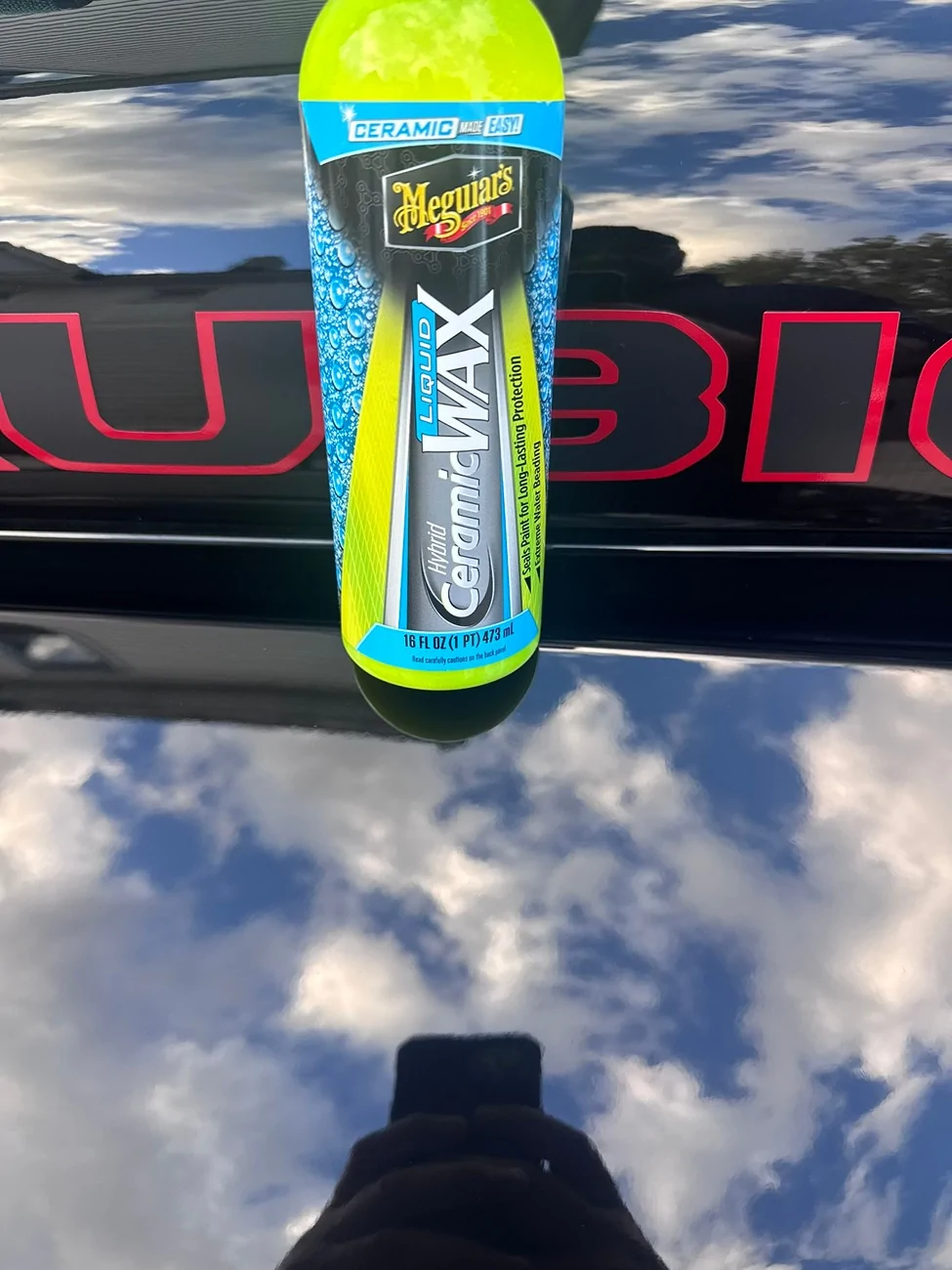

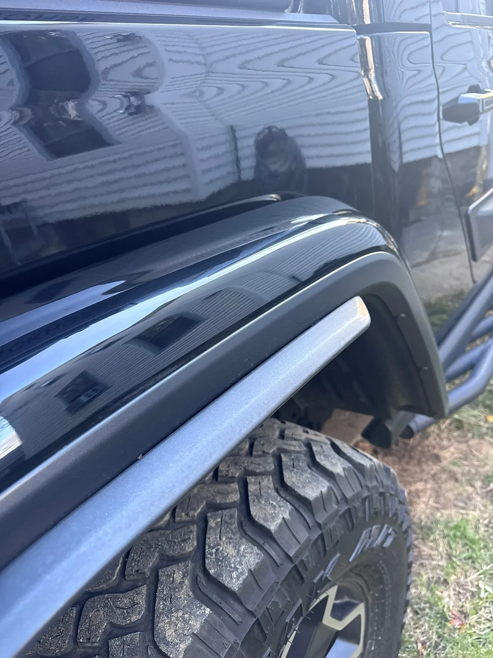

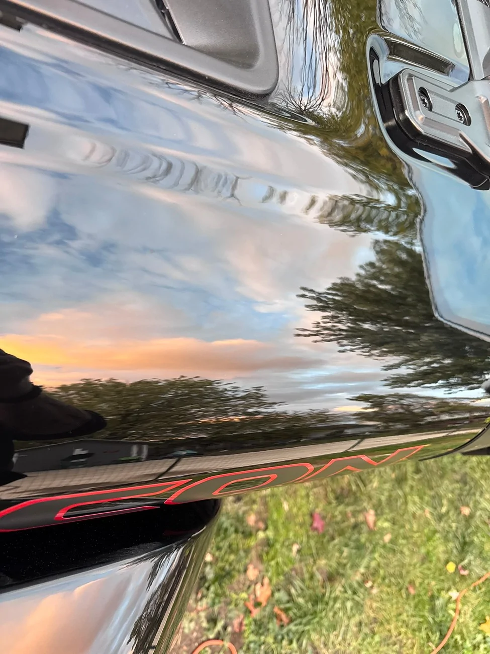

and now here is after waxing.
IDK how well it will hold up, but i will be using the meguiars Ceramic QD spray between washes.

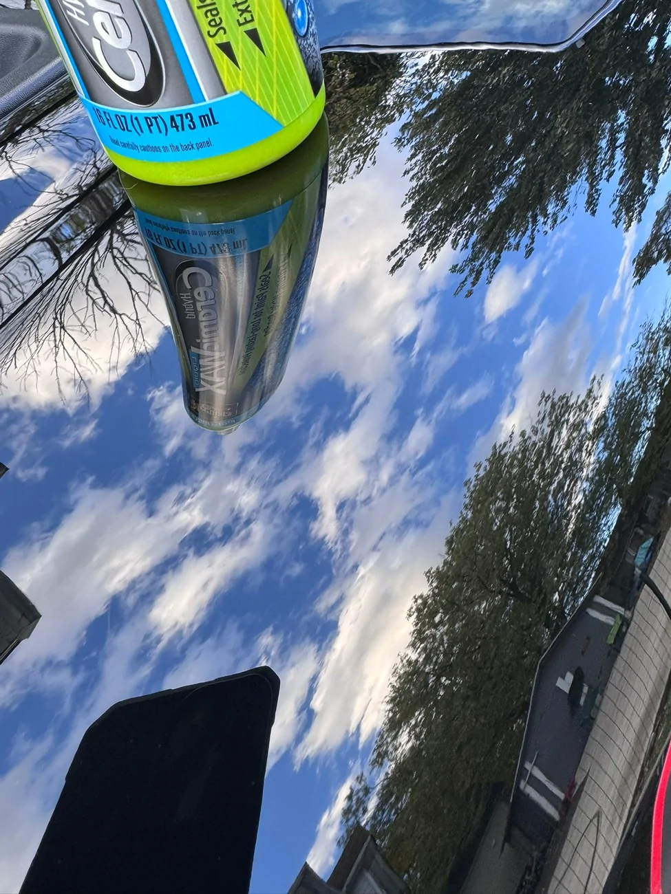

most of what is in the pics is the reflection of my paint. Look closely.
Jeep Gladiator You'll like this.  Paint correction and polishing results with ceramic wax! IMG_6718
Jeep Gladiator You'll like this.  Paint correction and polishing results with ceramic wax! IMG_6719
this is a reflection, look at the bottom right to see
Jeep Gladiator You'll like this.  Paint correction and polishing results with ceramic wax! IMG_6721
Jeep Gladiator You'll like this.  Paint correction and polishing results with ceramic wax! IMG_6720
another reflection, look bottom left.

Jeep Gladiator You'll like this.  Paint correction and polishing results with ceramic wax! 1761539221365-mk
I'll take some pics of the paint in sunlight for you tomorrow. Its just like you see in the pics. smooth and mirrored.
