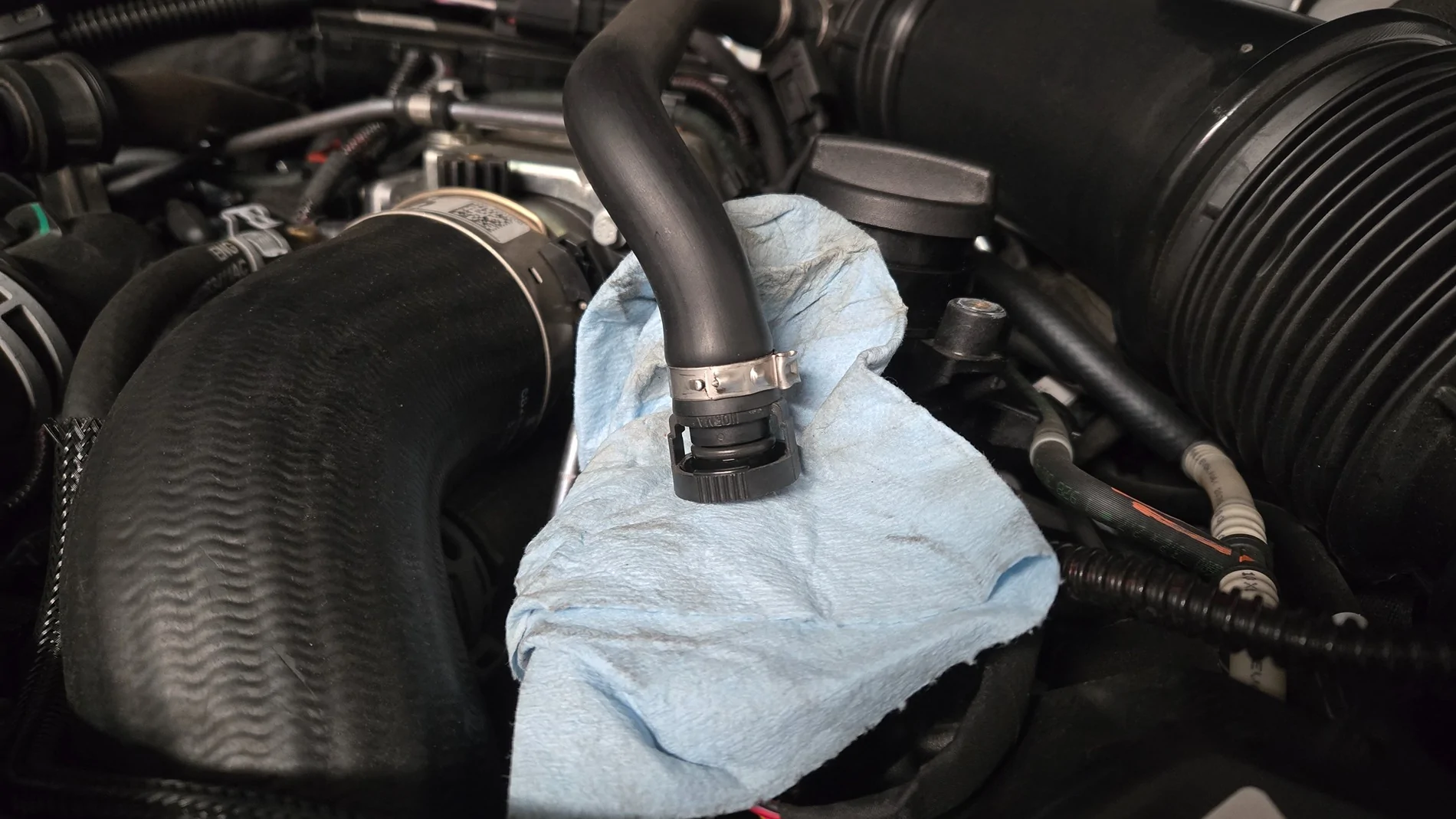

All you have to do is make one cut on the PCV line to splice their hoses. I believe some of the videos they reduce length of one of the hoses but I did not find it necessary.
To make the cut, you install the top hose on the Oil Separator into position and undo the PCV hose from the block end toward the front of the vehicle, then gauge the new hose and the existing hose with each other and make the cut right where they would meet. It has enough slack to accommodate additional length introduced by the connector.

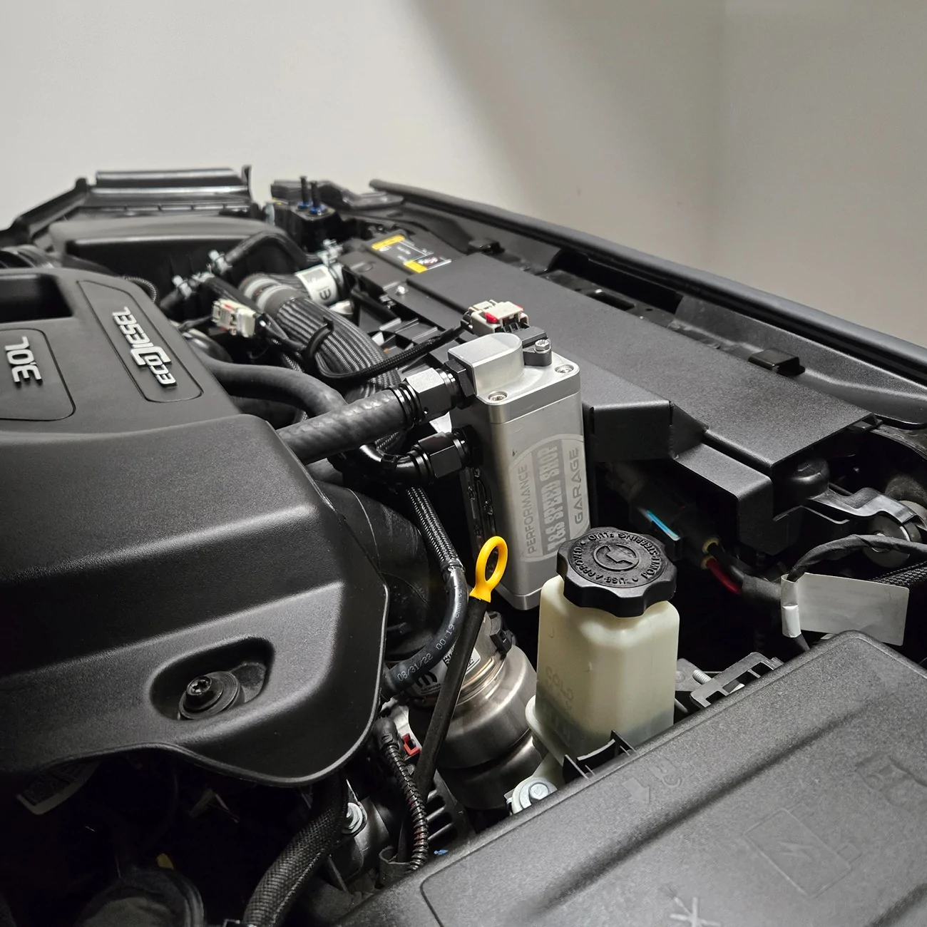

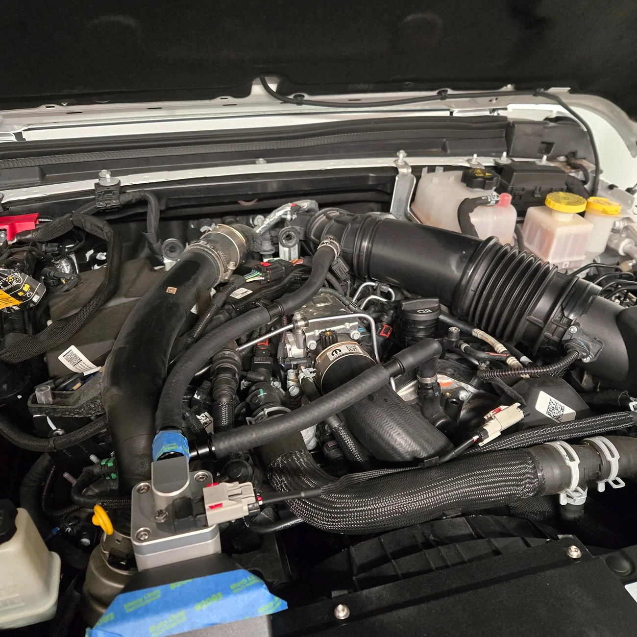

Jeep Gladiator EOC Oil Separator Install 1000049775
Jeep Gladiator EOC Oil Separator Install 1000049776

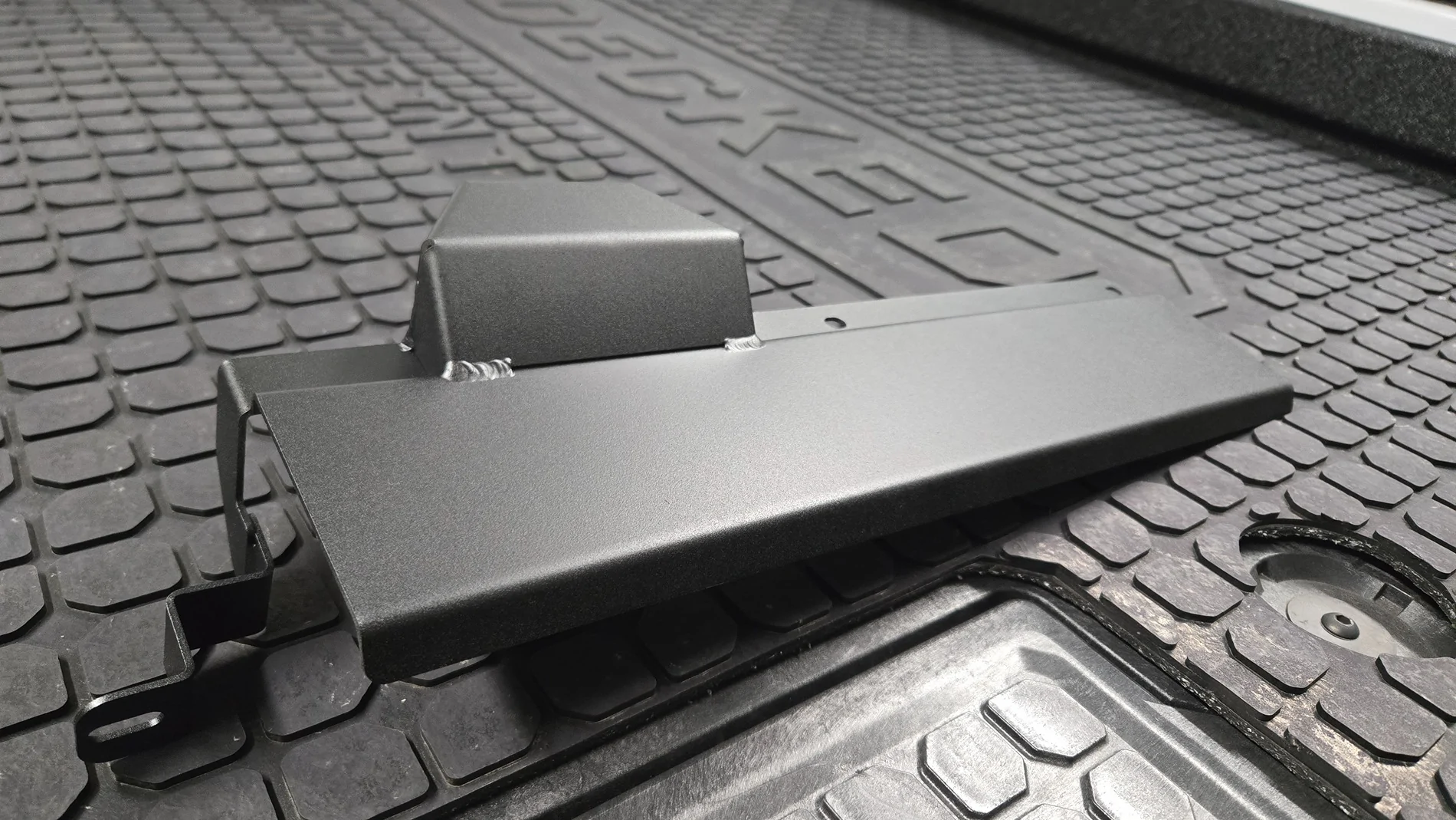

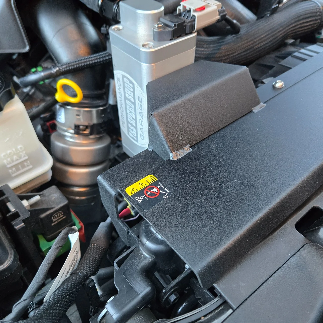

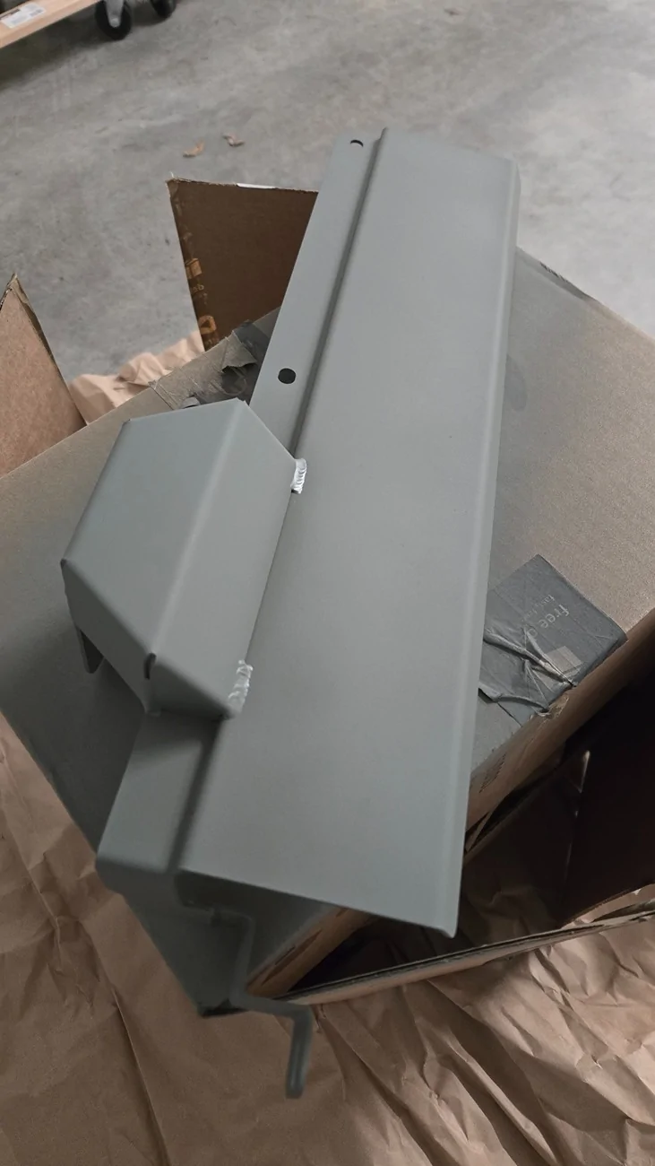

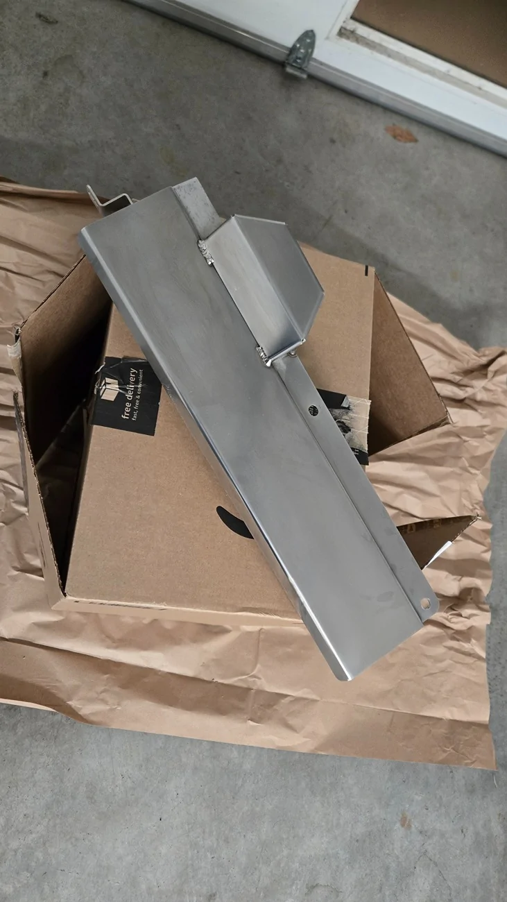

I ended up painting the bracket to make it little more OEM.

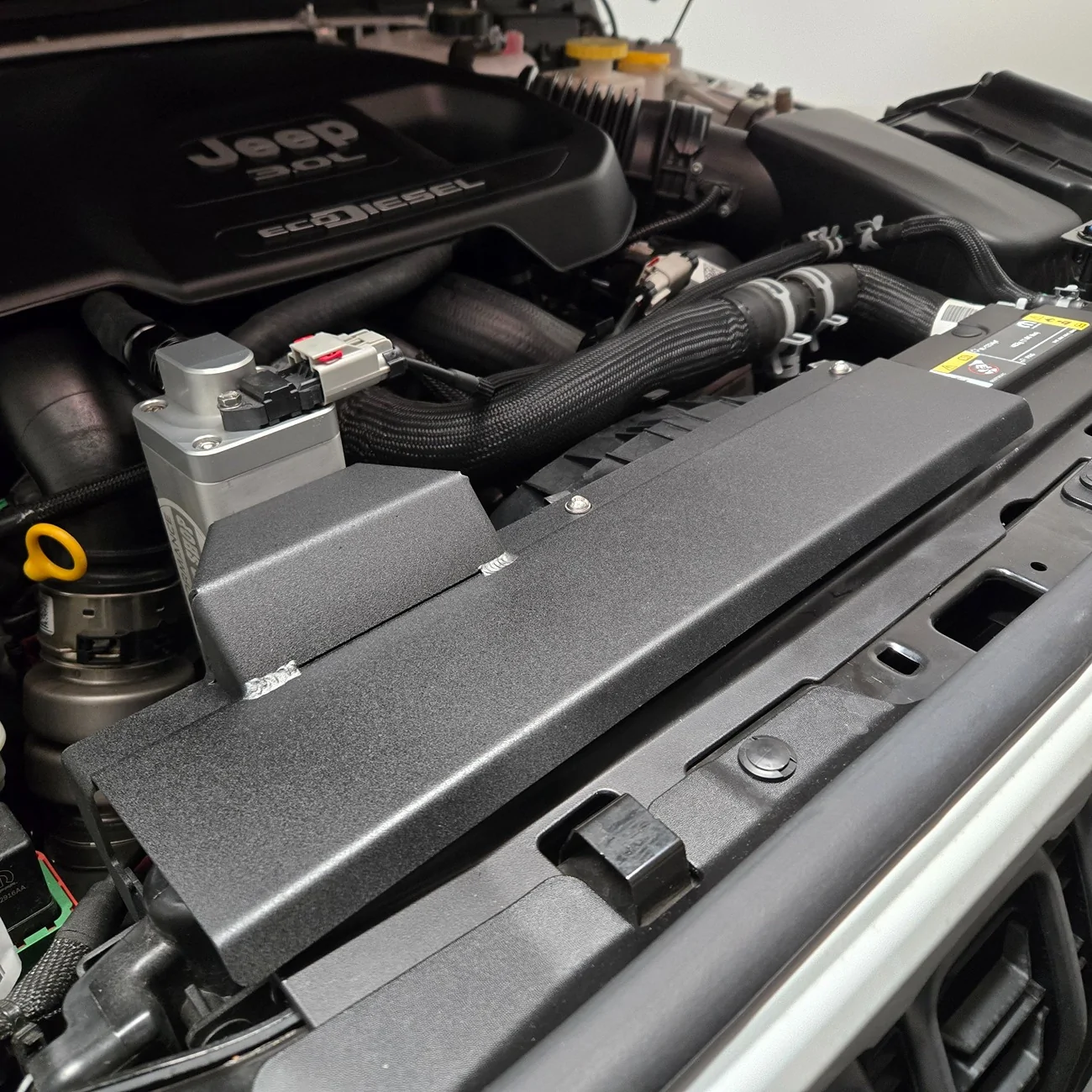

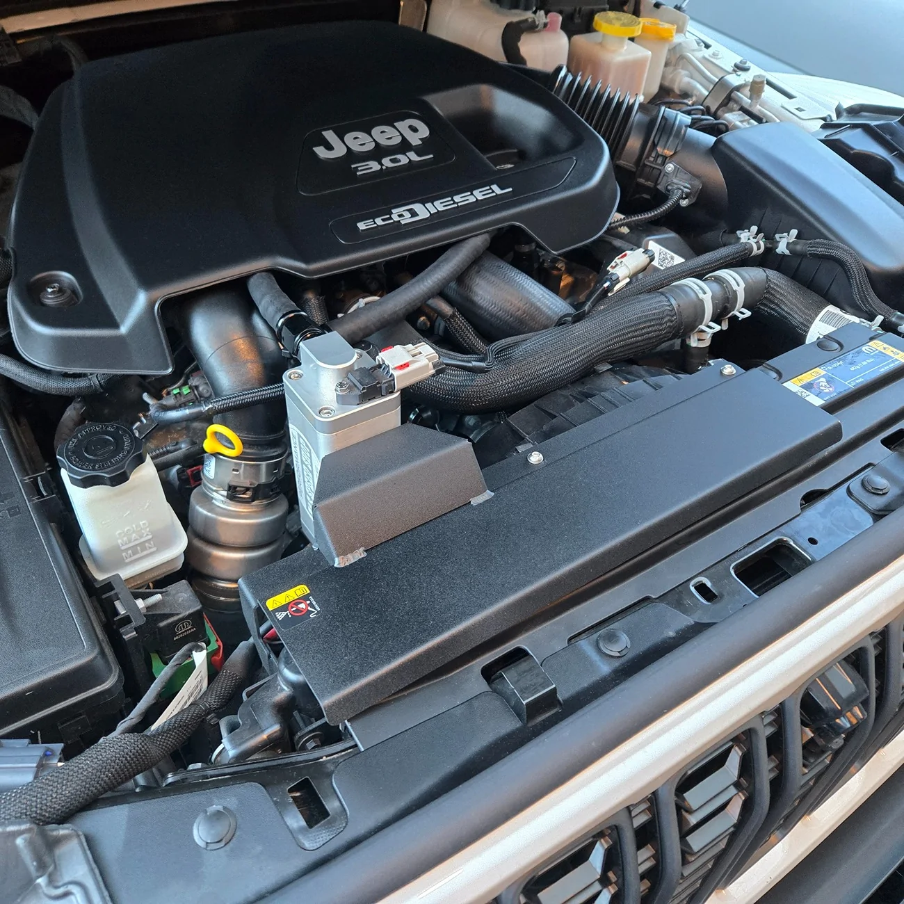

Here is the completed install.
Jeep Gladiator EOC Oil Separator Install 1000049864

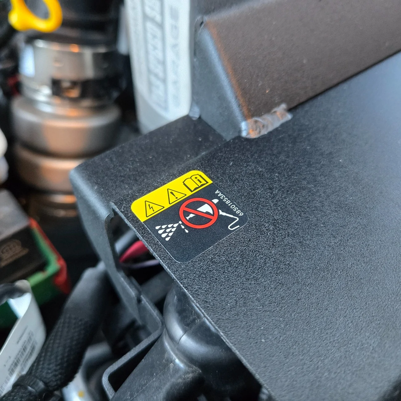

Overall, good quality of parts and things lined up well. I believe one of the videos from YouTube pointed out the bracket rubs the radiator, I did not find that issue with my case.
One thing that I had to do is the radiator mounting bolt has fender washer built in. This washer was too large to be reused so I had to cut part of the washer to clear the mounting bracket.

I've been thinking about doing this. Let us know if you get any CEL's. A few have reported getting them.

Great job painting it to match it looks awesome!
I must be getting old. I love OEM look. Used Rust-Oleum self etch primer and textured paint.
Put on several hundred miles since the install. No CEL.
That's what I want to hear. :like:
