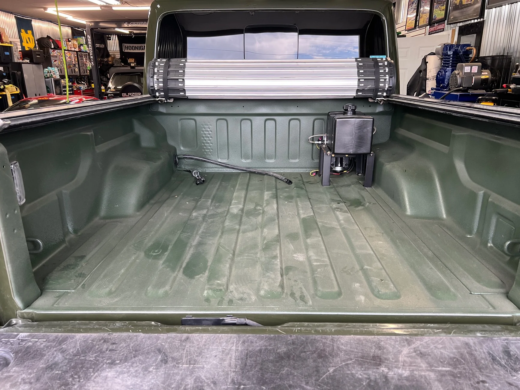

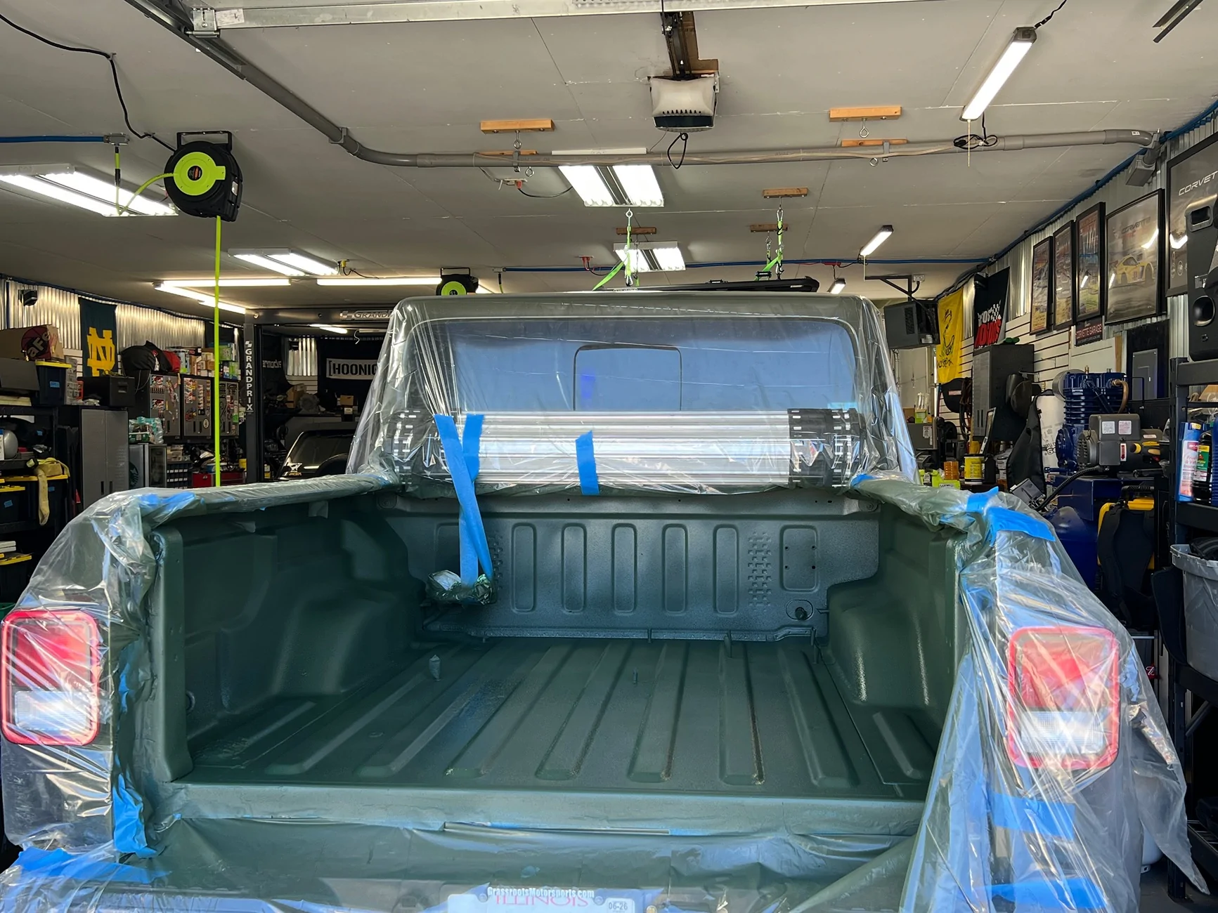

Sprayed a barricade DIY bedliner, it was $153 shipped, found a 10% off coupon code. Did the sarge color to blend into the truck, still drying but I’m happy with it. try and not sweat into it while spraying it…..ugh. Sanded with 80 grit on a da sander, then a wpie down with acetone, use to work in a shop that sprayed liners and this is the same method we used.
https://ruggedrestore.com/pages/barricade-sprayable-bedliner
Jeep Gladiator Barricade DIY bedliner spray applied IMG_7395

can we get a cured and cleaned photo?

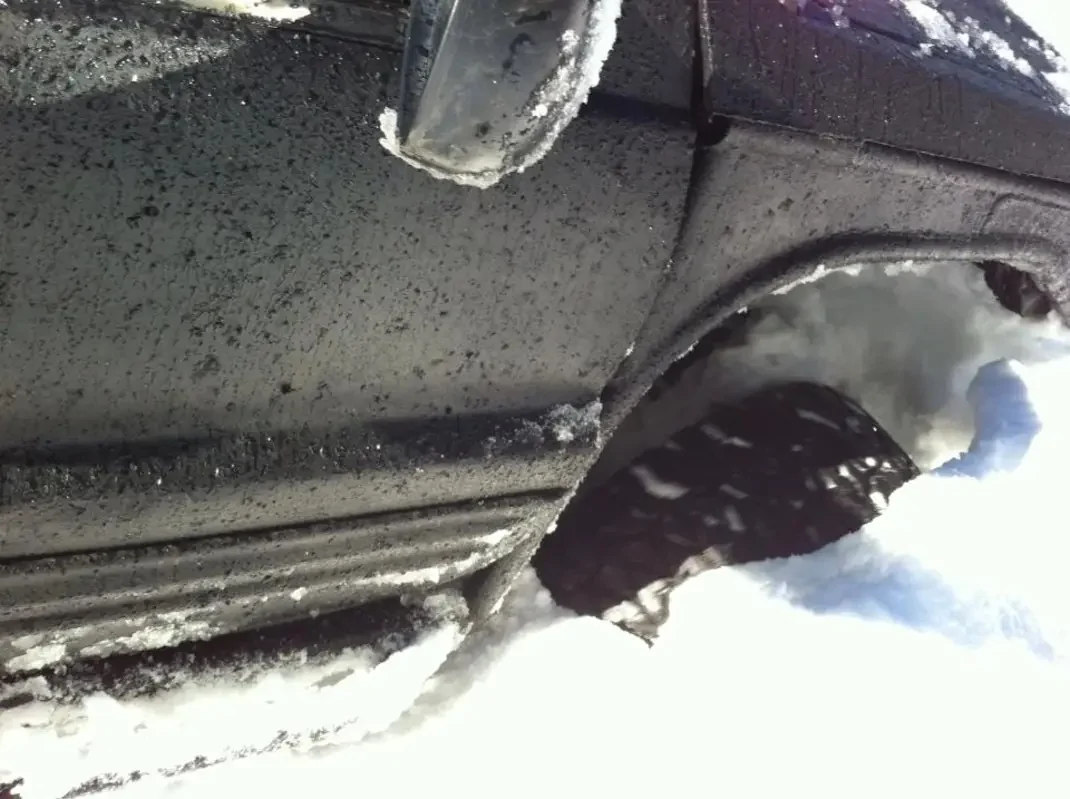

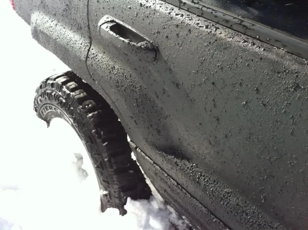

Found a pic of the old WJ on the rubicon. Bedliner is great for a trail rig.

Set pressure around 60 psi, happy with the results. i was looking for function over perfection. Sorry no pretty photos available, hauled some grass, leafs and branches to the dump today so this is what I got for after photo.
