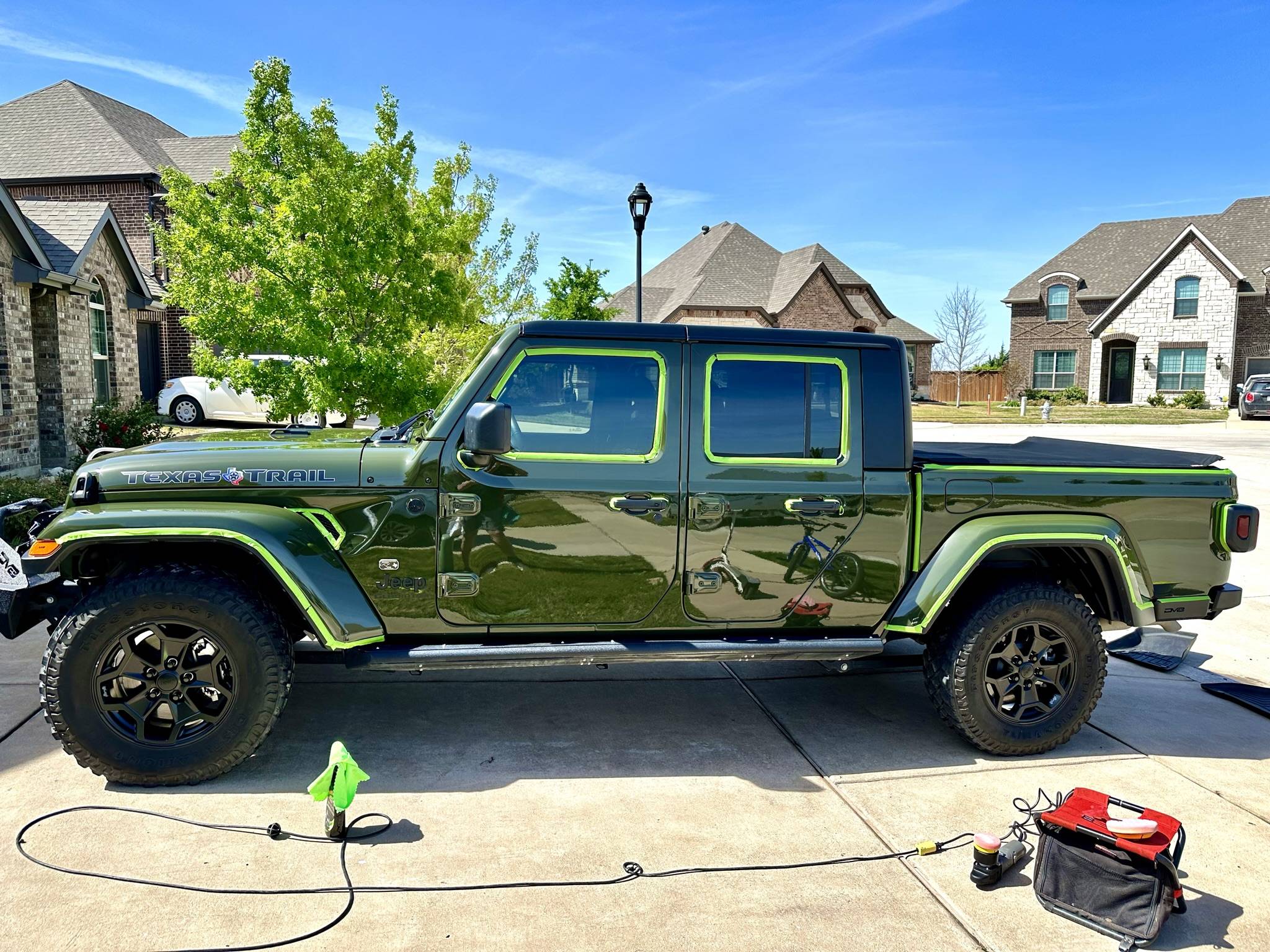

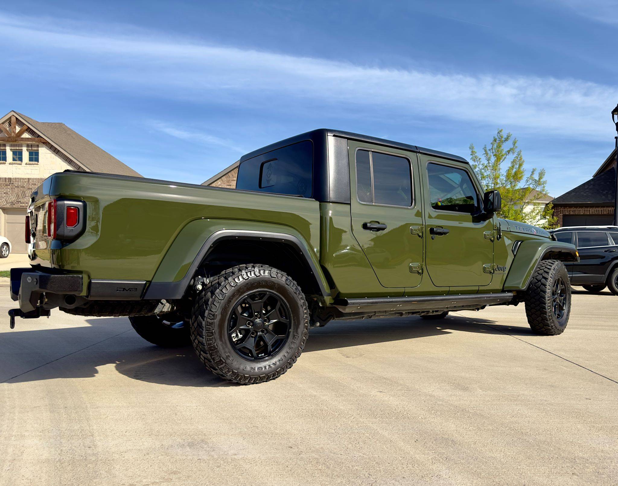

My wife is fortunate not only to own a JT Texas Trail but also the fact that my hobby is detailing and I do it for fun. I spent right at 10hrs on it this past Saturday. You'll notice I had to tape off all the rubber and plastics before doing an all in one polish/wax. For those that are curious, here is what I did and what I used.
Exterior:
Undercarriage wash
Wheels/Tires/Wheel Well Detail
Wash (Rinse, Foam Cannon, Rinse, Hand Wash)
Iron Decontamination
Hand Dry
1 Stage (All in One) machine polish/wax
Clean Glass
Dress all Vinyl/Rubber/Plastic
Interior:
Vacuum
Pet Hair Removal
Wipe Down all Interior Surfaces
Clean all leather/vinyl seats
Dress all Interior Vinyl/Plastic
Treat all Leather Seats
Clean Glass
Products Used
Exterior:
Chemical Guys Maxi Suds II
Superior Products Dark Fury
Stoner Invisible Glass
Superior Products Aqua Gloss
3D Speed
Interior:
Superior Products Pink Perfection
Superior Products Leather Cleaner
Lexol Leather Conditioner

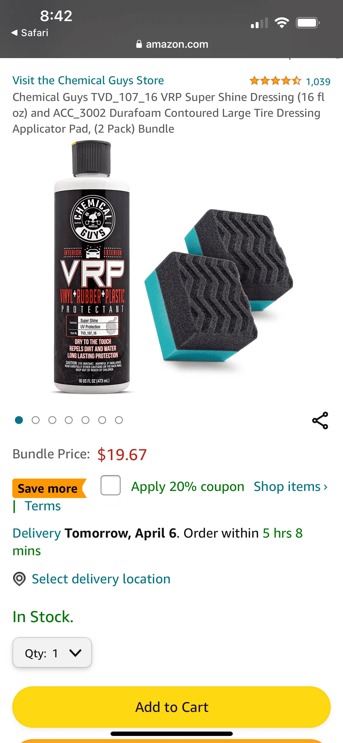

I like chemical guys foam washes, but using their tire spray and its streaky, not good. Any ideas on good gloss tire sprays?
Don’t use their spray, the VRP is best used with an applicator to keep the mess down. Also works well on fenders and roof.

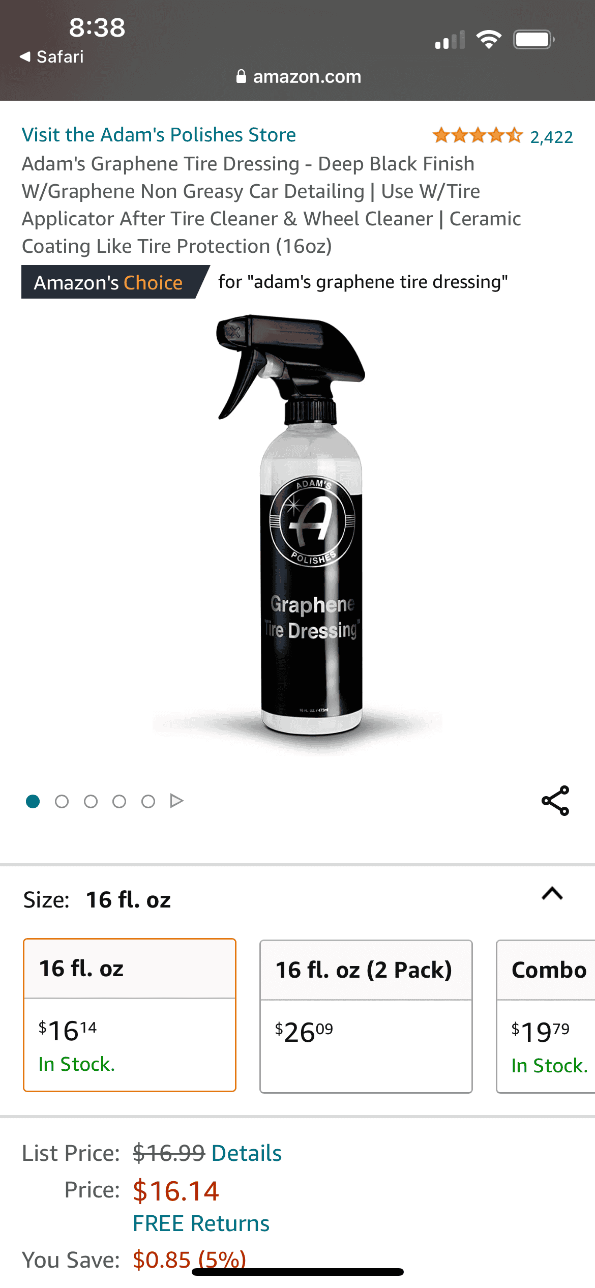

Jeep Gladiator 10hr Detailing Results 1D9C1691-7168-46D8-A087-EA157BB1AB04
This one has been one of my favorites for quite some time, Adam’s products are becoming more and more popular and therefore easier to find.

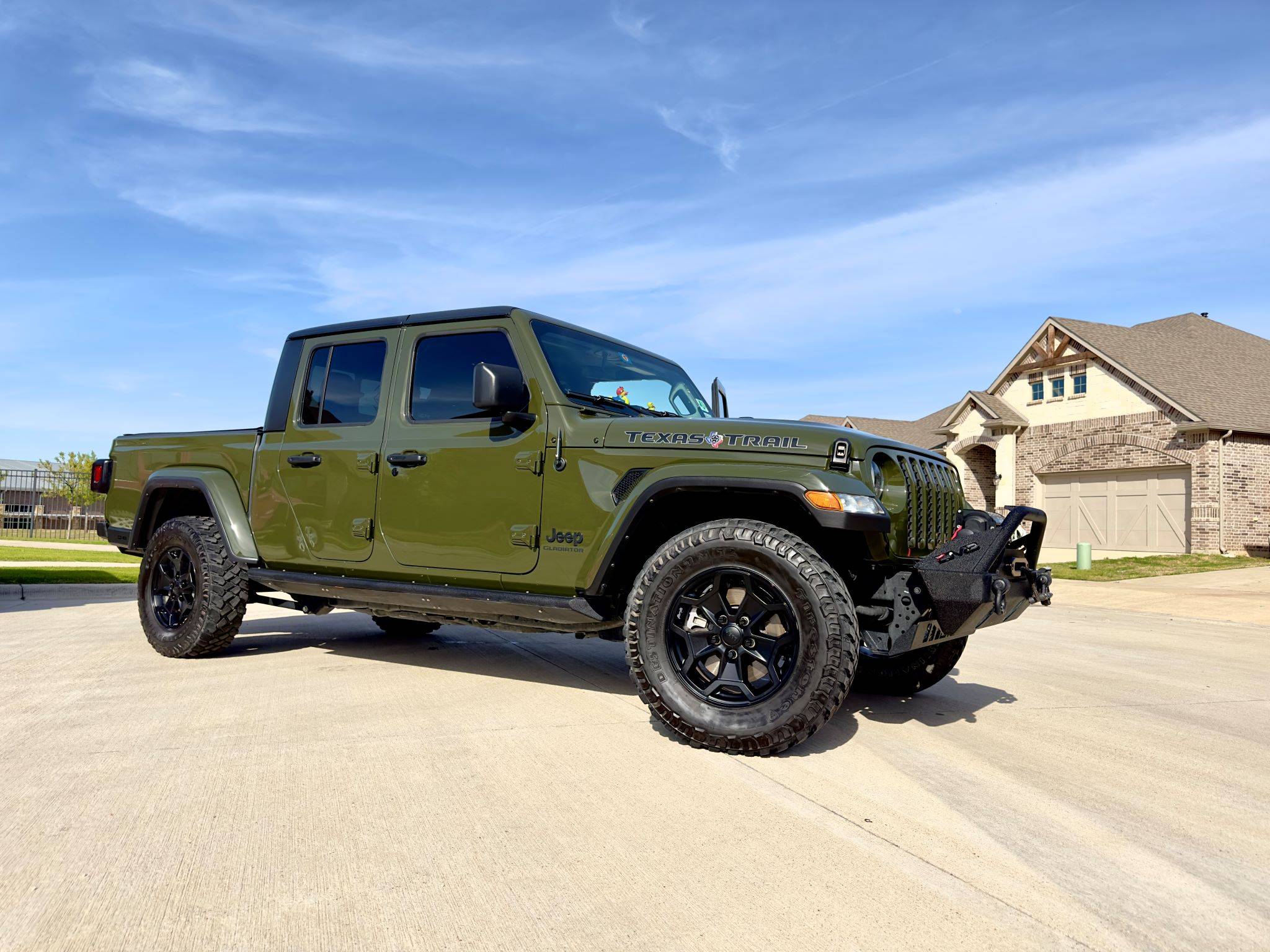

Looking great, I love how sarge green's yellow tones come out when polished. I've found no need to tape when using Menzerna's line of polish (no fillers or silicone, near zero dust or white residue) which saves a ton of time. Also, if you clay before polishing your pads will last twice as long and any ceramic, sealant or wax will adhere better while providing more visual depth. It's astonishing the amount of contaminants clay pulls out beyond a great cleaning and thorough IronX treatment.
I perform a similar process bi-yearly and it promptly gets dirty again. The difference, and the reason I put in the full day's work every other year is that I can foam cannon & pressure wash it back to showroom condition in under 10 minutes. Weeks baked-on KY clay can't stick to modern ceramic when hit with pressure.
Really nice work!
Yes familiar with clay bar, I’ve done it a bunch.. This was not the permanent coating just yet. It needed a light polish for scratches from wheeling so I just went with HD Speed. Once that coating were off, I’ll assess the clear coat and do a clay bar and ceramic. I just prepped with iron decon this time.
What part of Texas do you live in, and how much do you charge lol
Fort Worth and I don’t do it much for hire. I don’t have enough time. When I do have time, I’m doing one of ours or I’ll offer to do it for free for someone just to get a car to detail. Every now and then I do one for money. Just enough to pay for my equipment and chemicals. I’d charge $300 for this much of a detail.
