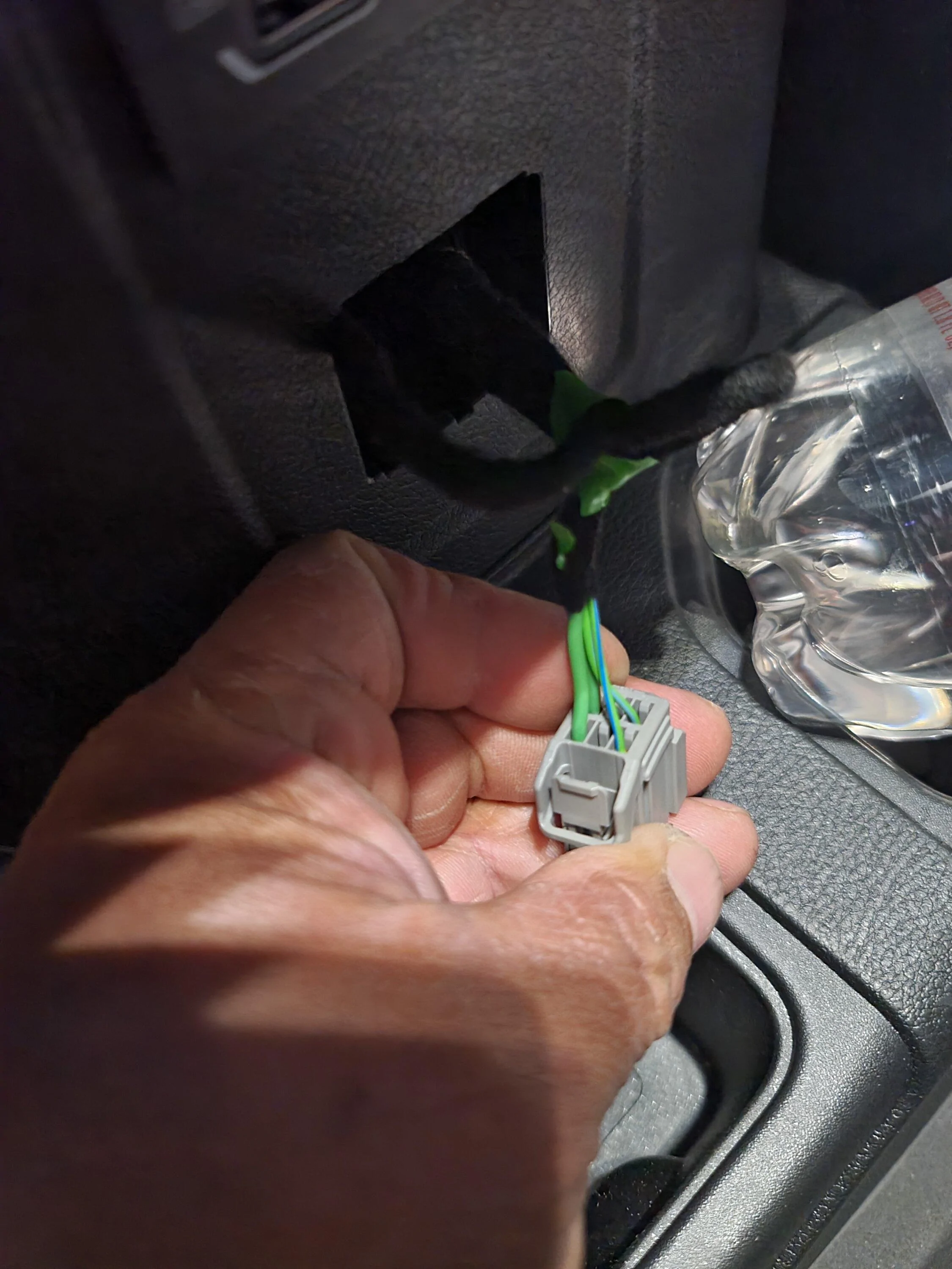

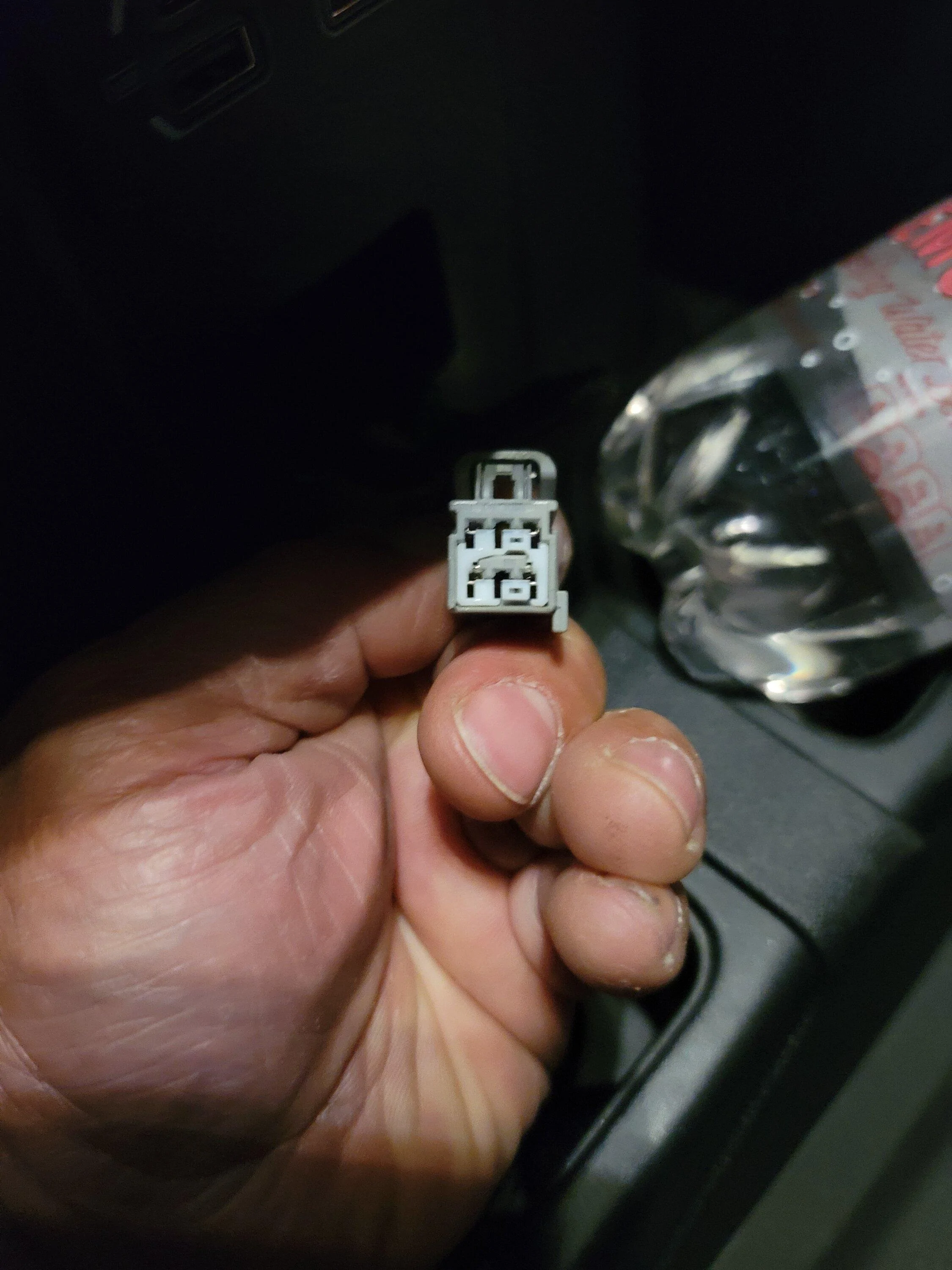

Hello new to the forum. Ok i need help i kind of don't understand this. So my gladiator didnt come with the 110 in the cabin. The wires are there to hook up the outlet. But there is no fuse brongs to put the 30 amp fuse. Can any body help.

Some of the wiring may be there. There's no connection for the fuse because there is no inverter to provide power for. The wiring harness for each truck is customized based on the factory options ordered.

So how hard would it be to put the inverter and put the prongs for the fuse. One more question does that mean that there isnt a inverter for the rear 110 thats is blank.

If there is no outlet in the cab, there is no inverter installed. If you want an inverter, the best thing is to buy one that matches the size you need and install it. The factory installed inverter is only 400 watts total, is installed under the dash, and is shared between the two outlet locations.

You cannot add the factory outlet or switch unless you have the factory inverter already installed under the dash. You could buy the outlet that goes in the bed and then wire it to a separate inverter that you install.

Yes, the single factory inverter feeds both 110vac outlets, if installed. If the factory inverter is installed, there is one outlet on the back of the center console. If the Trail Rails in the back are ordered from the factory, that option includes the outlet in the bed with the switch on the dash, but only if the inverter and outlet are installed in the cab.
