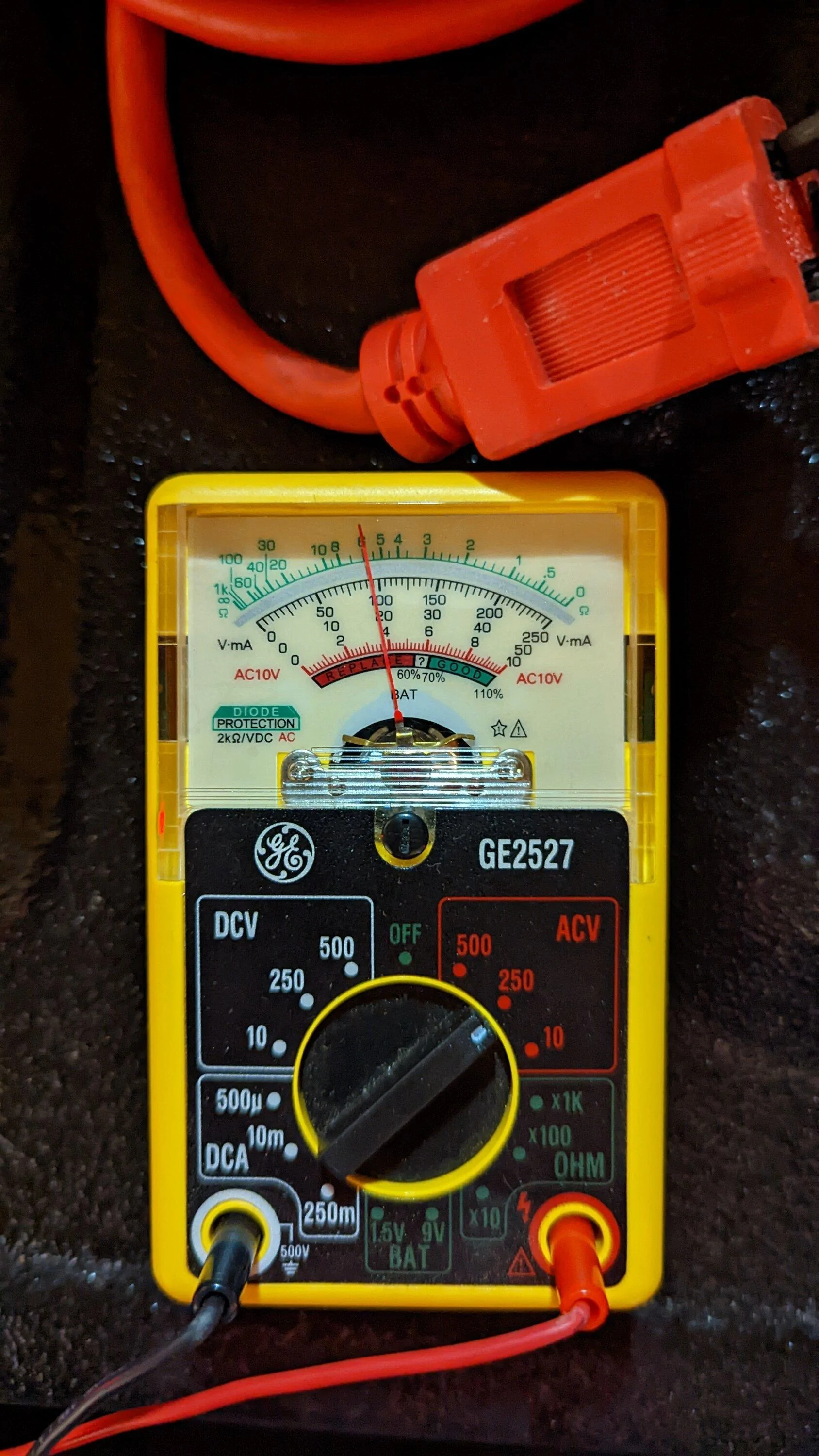

21 Mojave at idle.

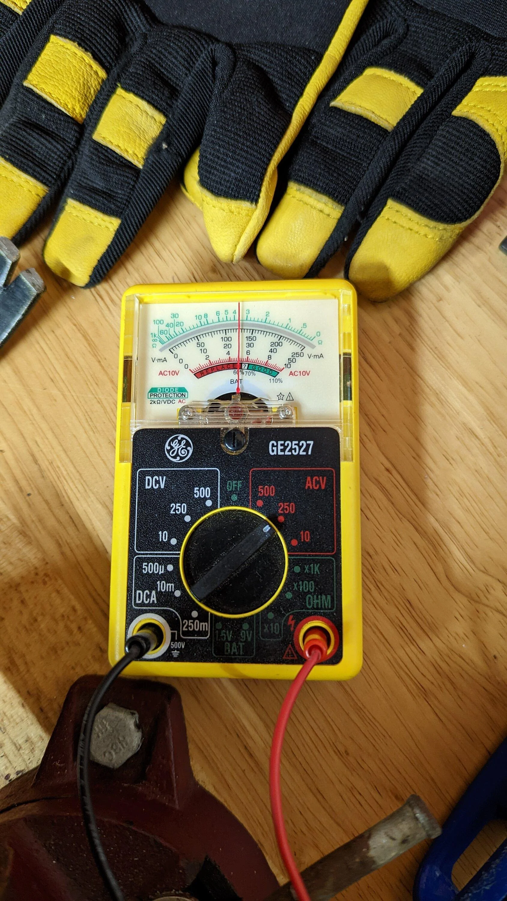

Same meter on garage current.
With no load, be it at idle or higher RPM - it shouldn't matter as the truck's system voltage is still going to be whatever it is. The inverter voltage should be regulated regardless of the input side.
That's well under 100 volts - low, IMO. (and that's no load, I assume)

No load. 10 foot extension cord to make it easier to get to.
I never planned on relying upon this outlet for anything anyway, but they should at least deliver the advertised voltage of 115.

10' cord won't give any voltage drop when you are only using a meter so we can assume that's what it is right at the outlet.
Not even 100 volts. Wow.
They have a problem with the inverter they chose.
Don't know who makes it, but the voltage should be regulated to that 115 up to the rated capacity assuming adequate supply to the input side. (and a running truck will be at 12.6 volts minimum even when the PCM decides to conserve energy by cutting alternator output. They aren't going to let it drop below that. )
